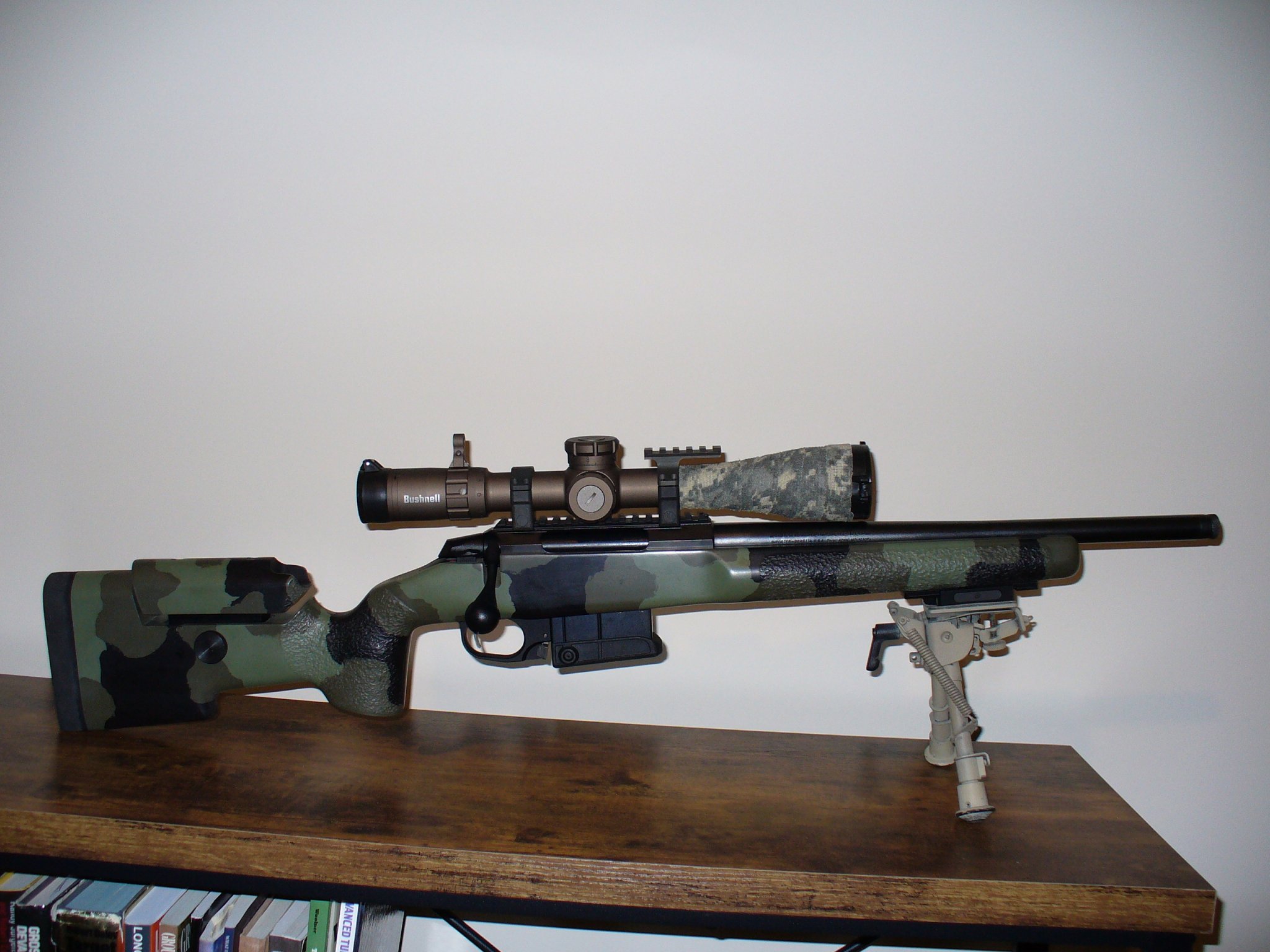

Nice chassis, is that the Spuhr?

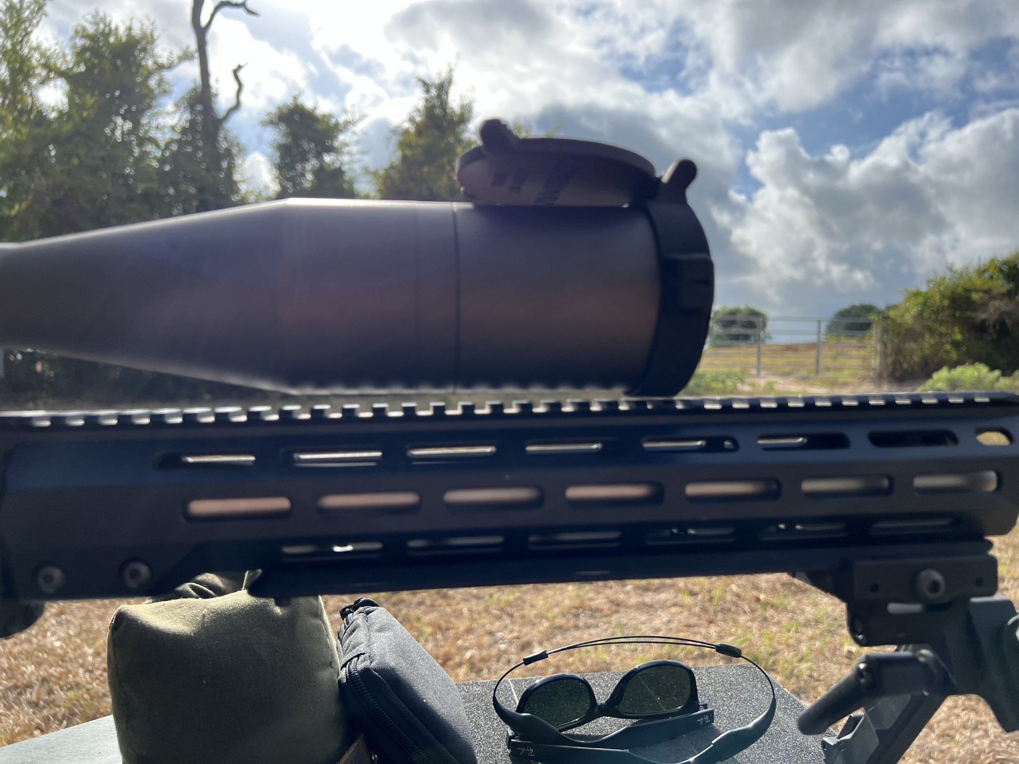

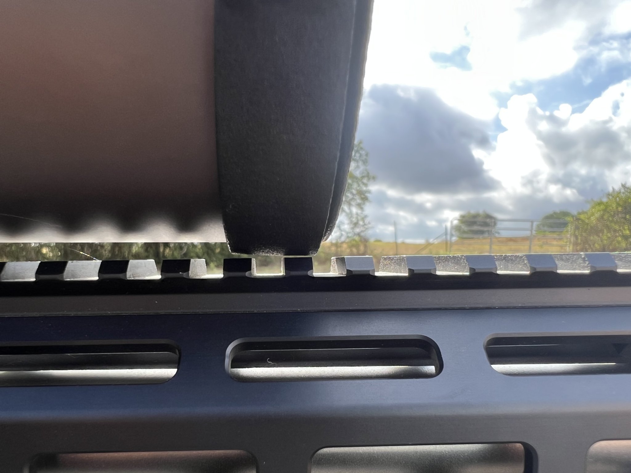

@Bevo Nice. What height ARC mount did you need to clear the handguard with the 50mm bell and caps? On 20moa cant?
Boomer Sooner
Just of note, I have 50mm obj as well and 1.5 20moa cleared for me on factory chassis but was so tight that I couldn't thread the front cap on (hinge would hit the rail).
I doubt an optic with 56mm would've worked and the 1.5 kinked my neck after 2 full days behind the gun. Definitely happier with the 1.18 on my new chassis.

The photo is a 50mm bell and 1.5" height?

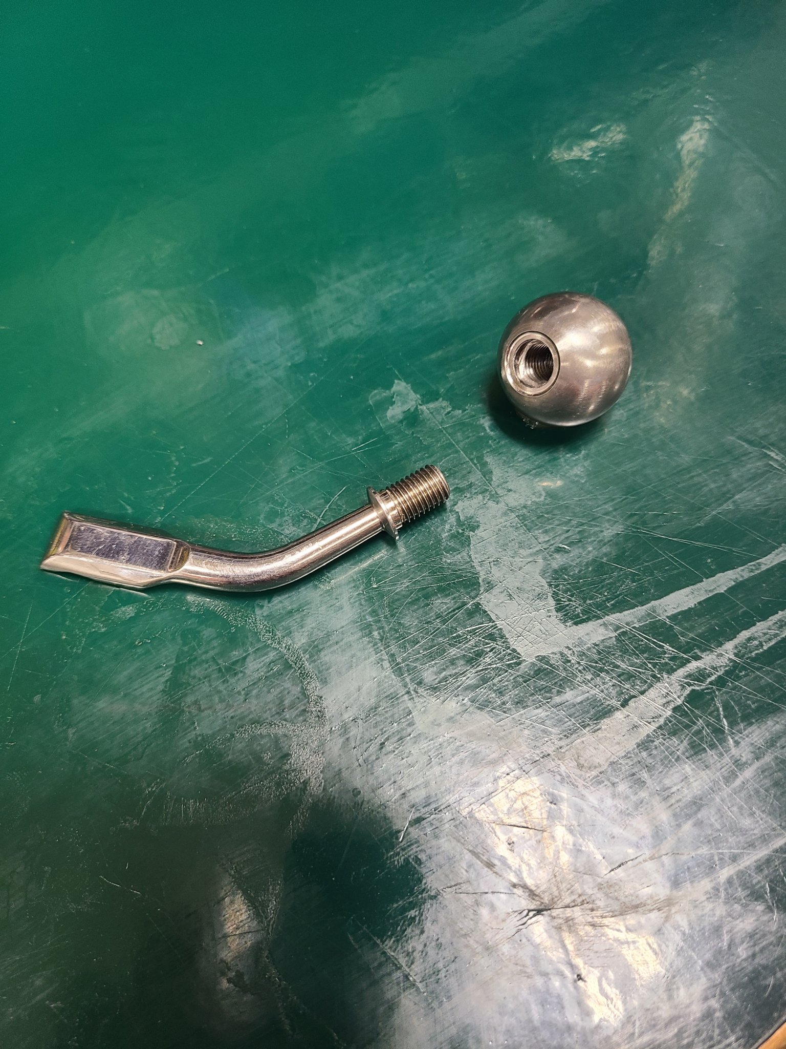

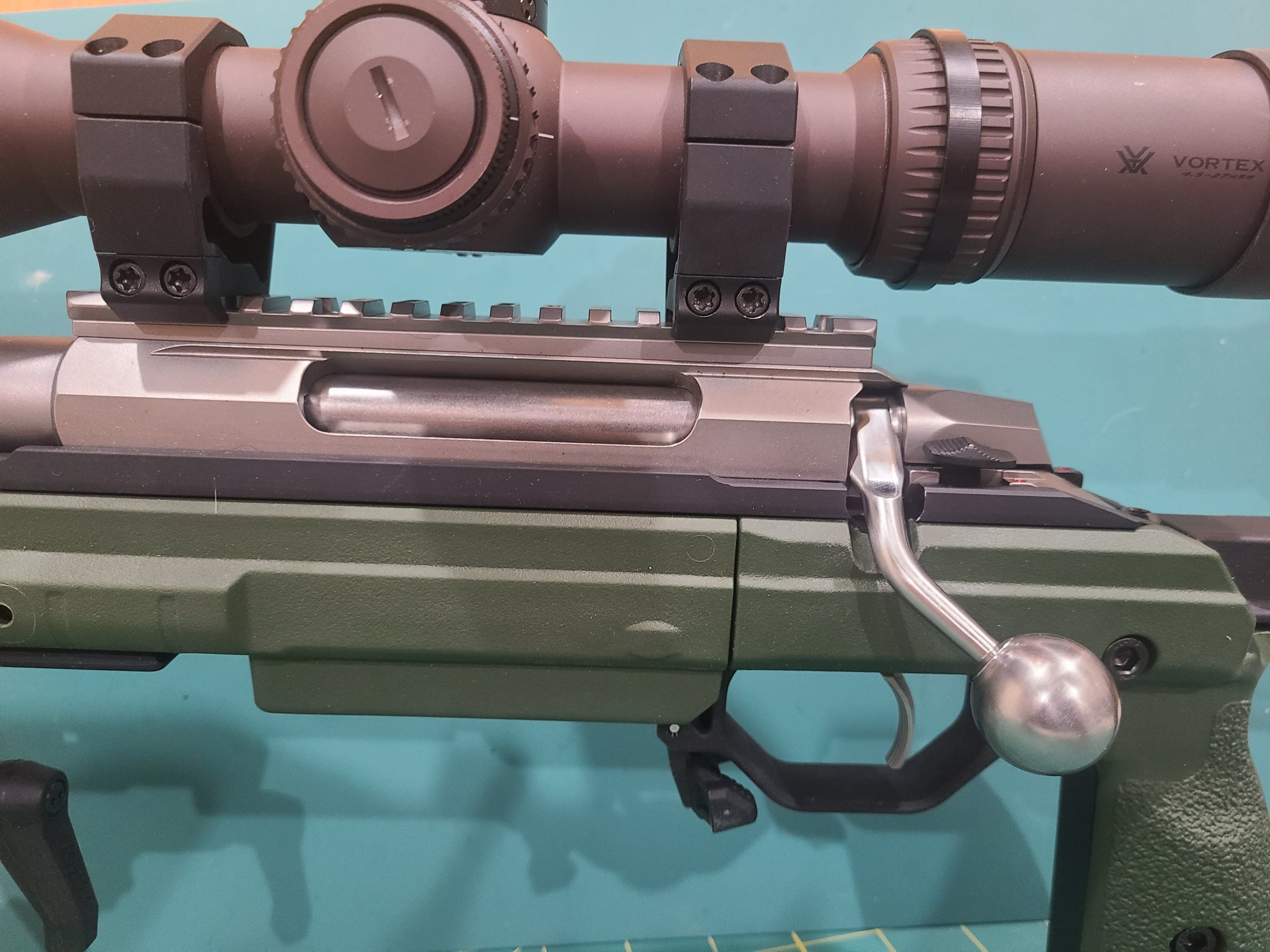

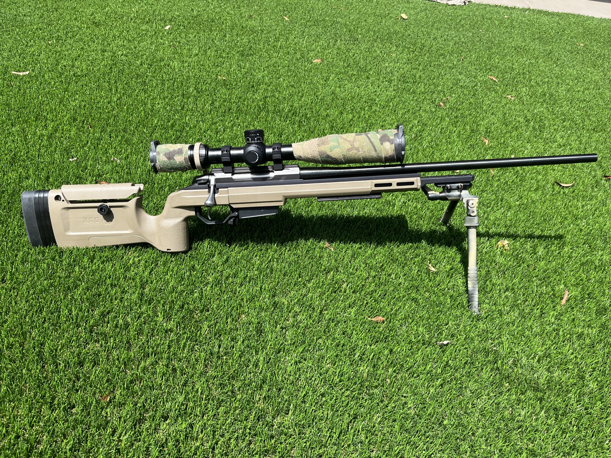

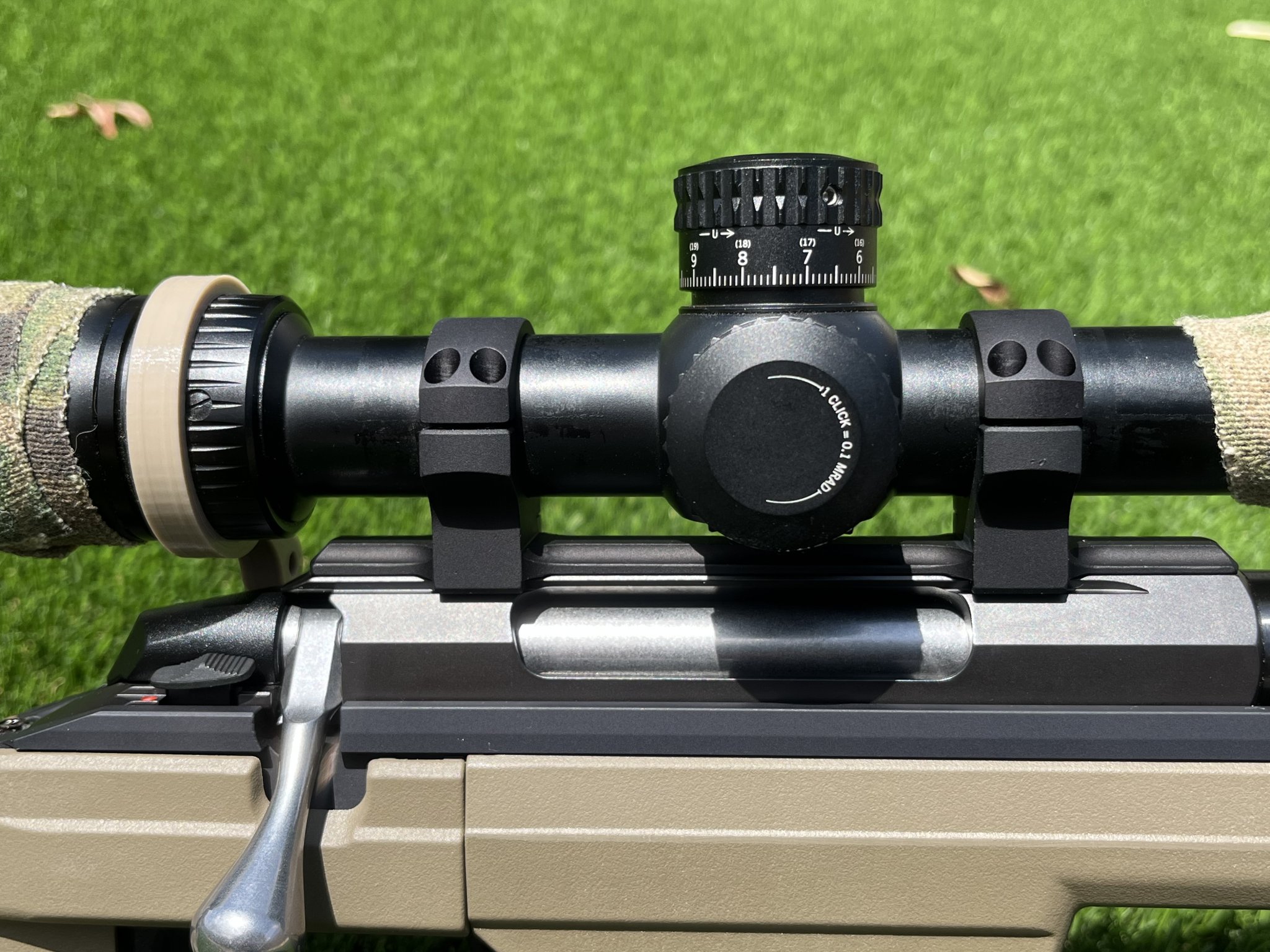

I have wanted to have the knob on my Sterk swept handle to be titanium. My rail is already a Murphy Precision 20moa titanium rail and I have the titanium Sterk shroud.
Asked @cannoncrossfire (he is Sterk) for details on the shroud April of last year before I bought it and a few other questions about the handle since. 6al4v for the alloy, aluminum balls are red loctited on, and 5/16-24 thread.

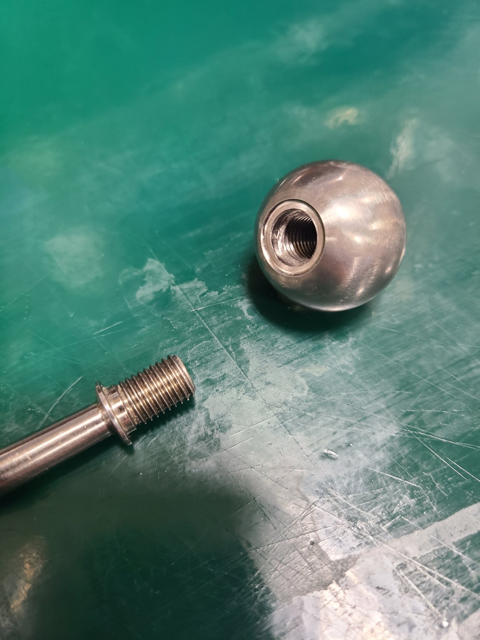

Process of removing.
Heated with a torch to 500°f. Used infrared thermometer to tell.

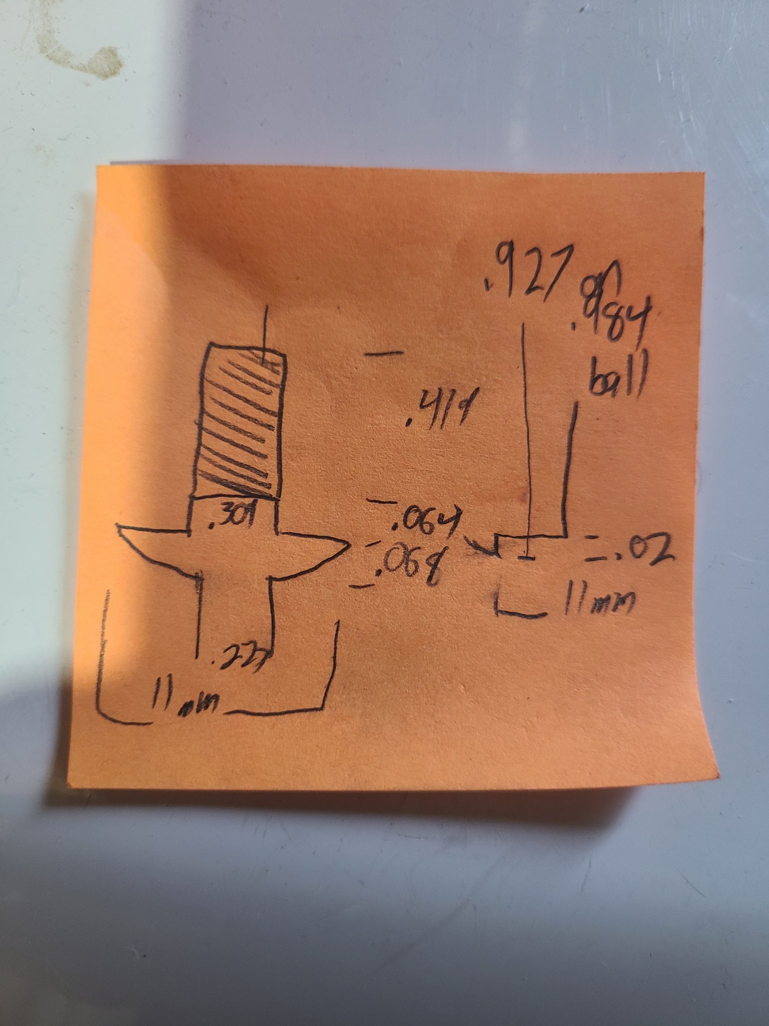

Notes on modifications needed. Relevant info is an 11mm counterbore that is 20 thou or so deep and enough counterbore in the threads to accommodate the unthreaded section under the swell. Not much can be done about that in manufacturing other than a thread relief which takes another tool when it's being made. Sterk bends the handle after it is machined.
Was able to finally find a 6al4v titanium 1" diameter bolt handle from Anarchy Outdoors. SBK-POL. Upc 791617484610
Needed the 11mm counterbore in it to which I was able to use a lathe (with too big of a boring bar) to cut it. It also didn't have a tailstock chuck to drill out the thread relief.
I used a very very nice NSK Rotus IM301 air grinder with the IH300 head (about $1100 for an air powered 30,000rpm grinder) with a carbide burr to higbee the thread far enough that I was able to get it together. No I don't have one of those at home. Used $450ish.

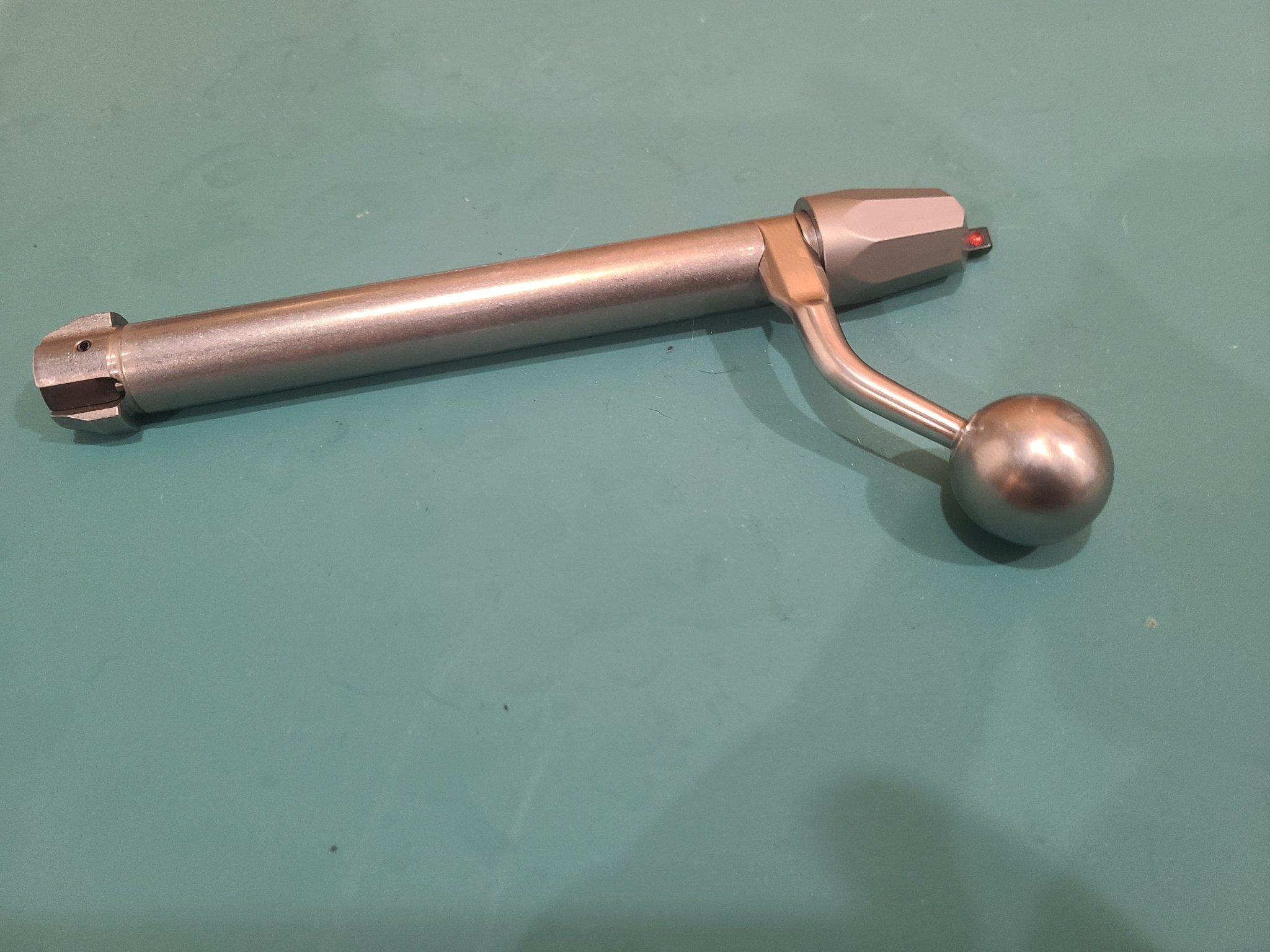

Assembled.

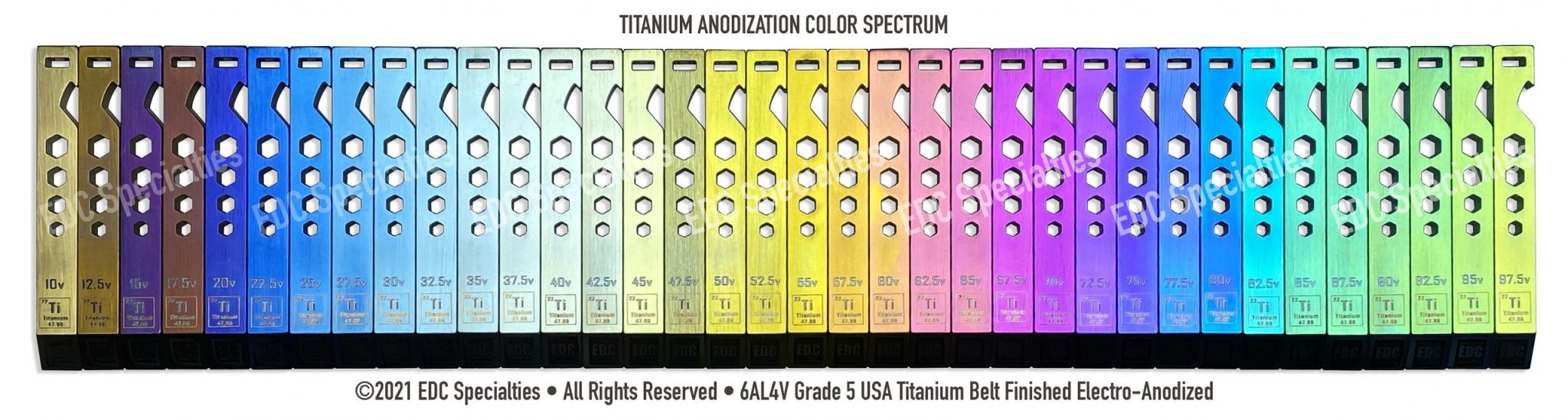

Part of the reason to go for titanium is because of why the heck not? I'm lefthand and left eye and everything has to be modified/ special in some way why not make it unique? Working towards having a one of a kind Tikka. Other reason is that titanium is color anodizable as well. Will send it out to get done at some point but not sure on the color yet. Some possibilities below.
Nice work @LeftyJason Titanium is a bugger to machine, so I applaud your work to modify. Don't forget folks that Titanium is still heavier than aluminium, so it's not a 'light weight' option haha. You can also heat Titanium to colour it, but it will go through colours very quickly as you heat it so it can be tricky.
