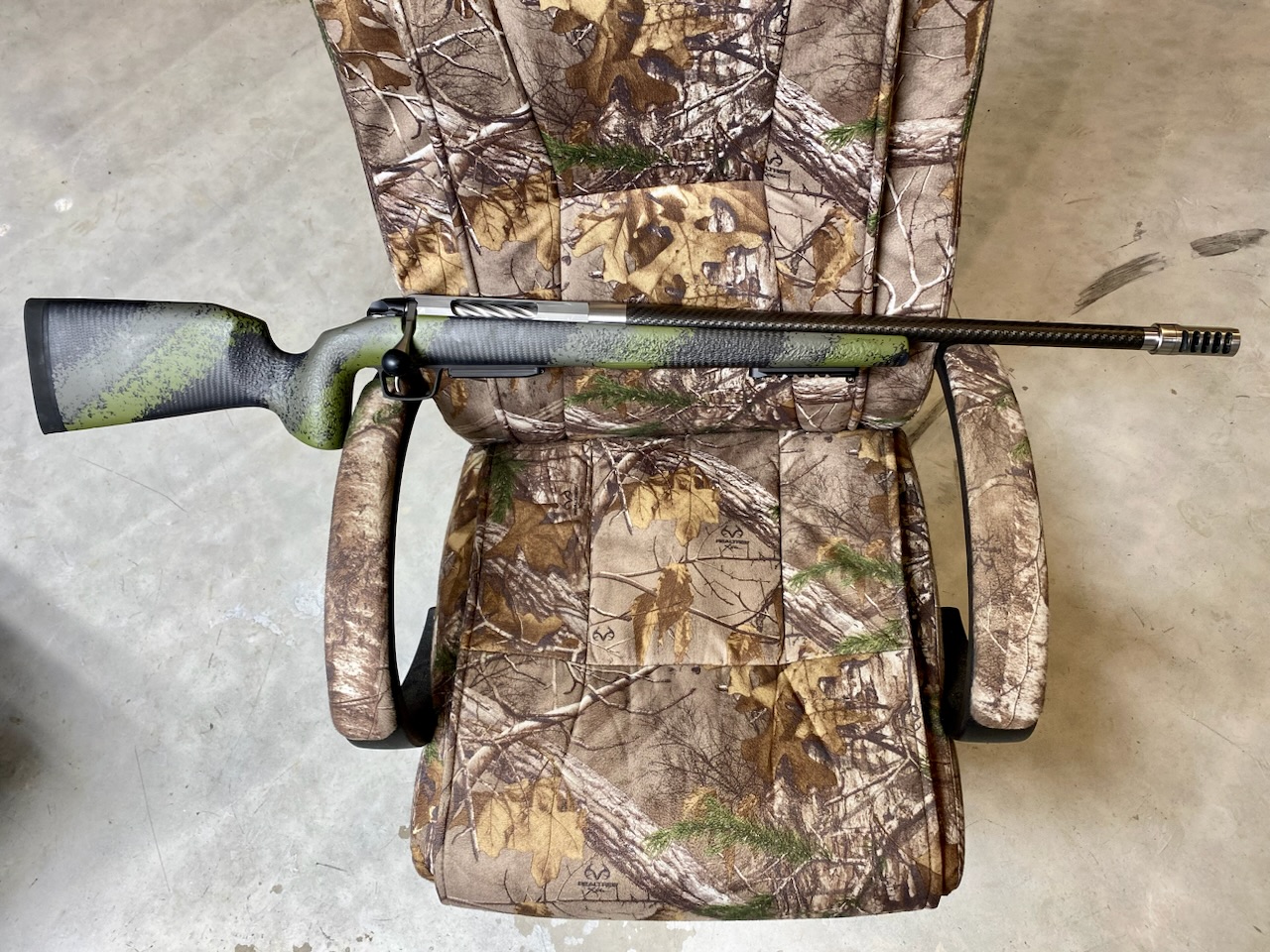

Almost done with this project. Got it back from the smith yesterday. Just need bedding and cerakote. Tikka stainless magnum action, mountain tactical bottom metal and billet LA mag, benchmark ibex carbon stock, benchmark carbon 22” barrel, piercision titanium brake, cambered in 7 saum.
Just a question - what do you think about step by step transformation of stock Tikka to more lightweight yet precise and accurate shooting Tikka by replacing the stock for beginning and then rebarelling it?

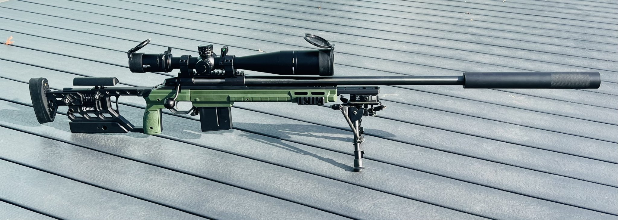

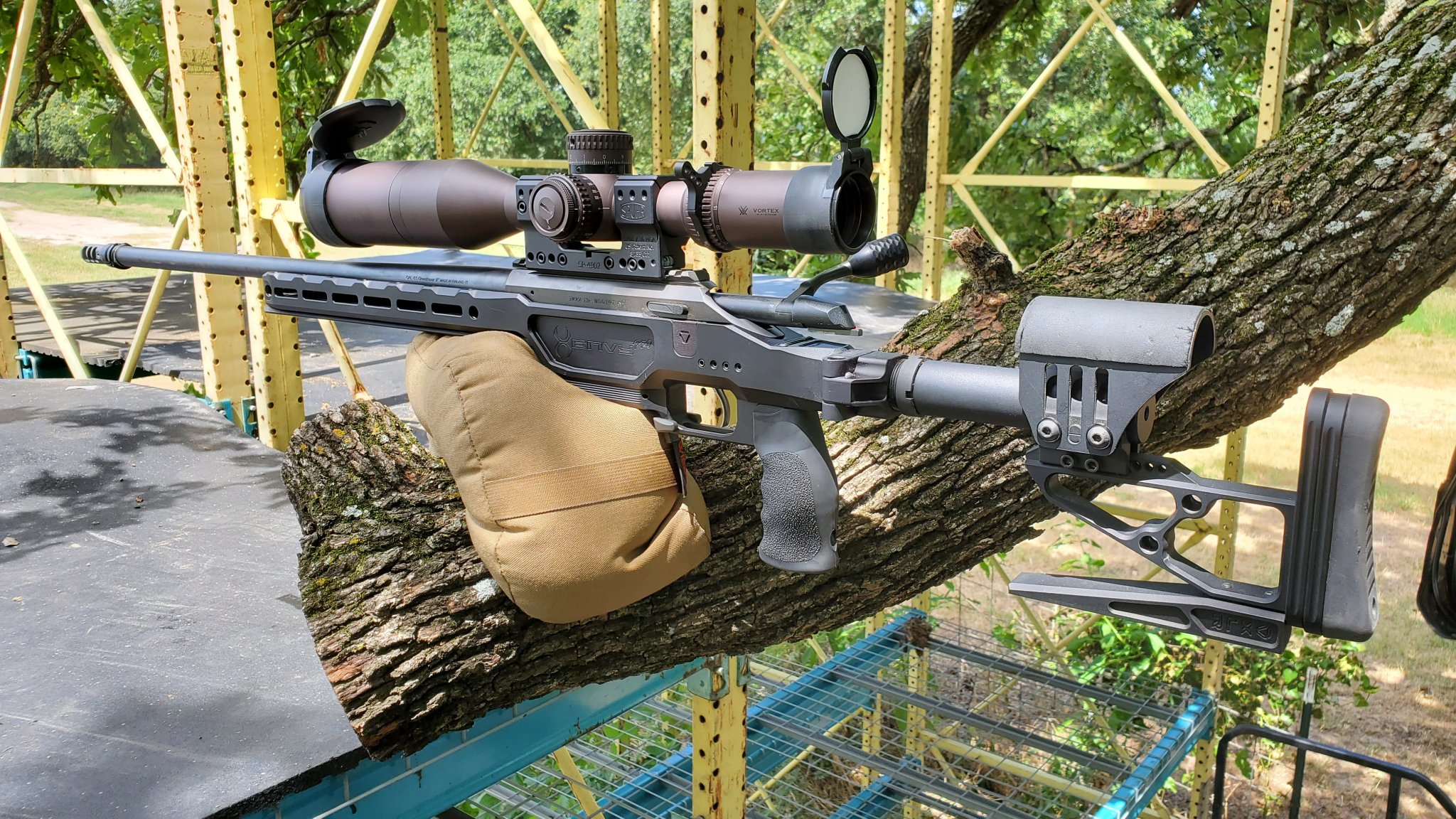

Tikka t3x CTR:
Vortex Razor gen ii 4.5-27x56
Spuhr 9mil one piece ring base 34mm
Ergo Vertical Grip
Dead Air Keymo suppressor Mount for a custom form 1 titanium suppressor
XLR Envy chassis
Replaced bolt throw lever with an acorn
Factory trigger set at 1.3 lb
I think that's it for the upgrades. I have hit the 1700 yard plate with this rifle multiple times. I've had a note card at a thousand yards three times back to back. The performance of this rifle has impressed the hell out of me and I definitely recommend one.

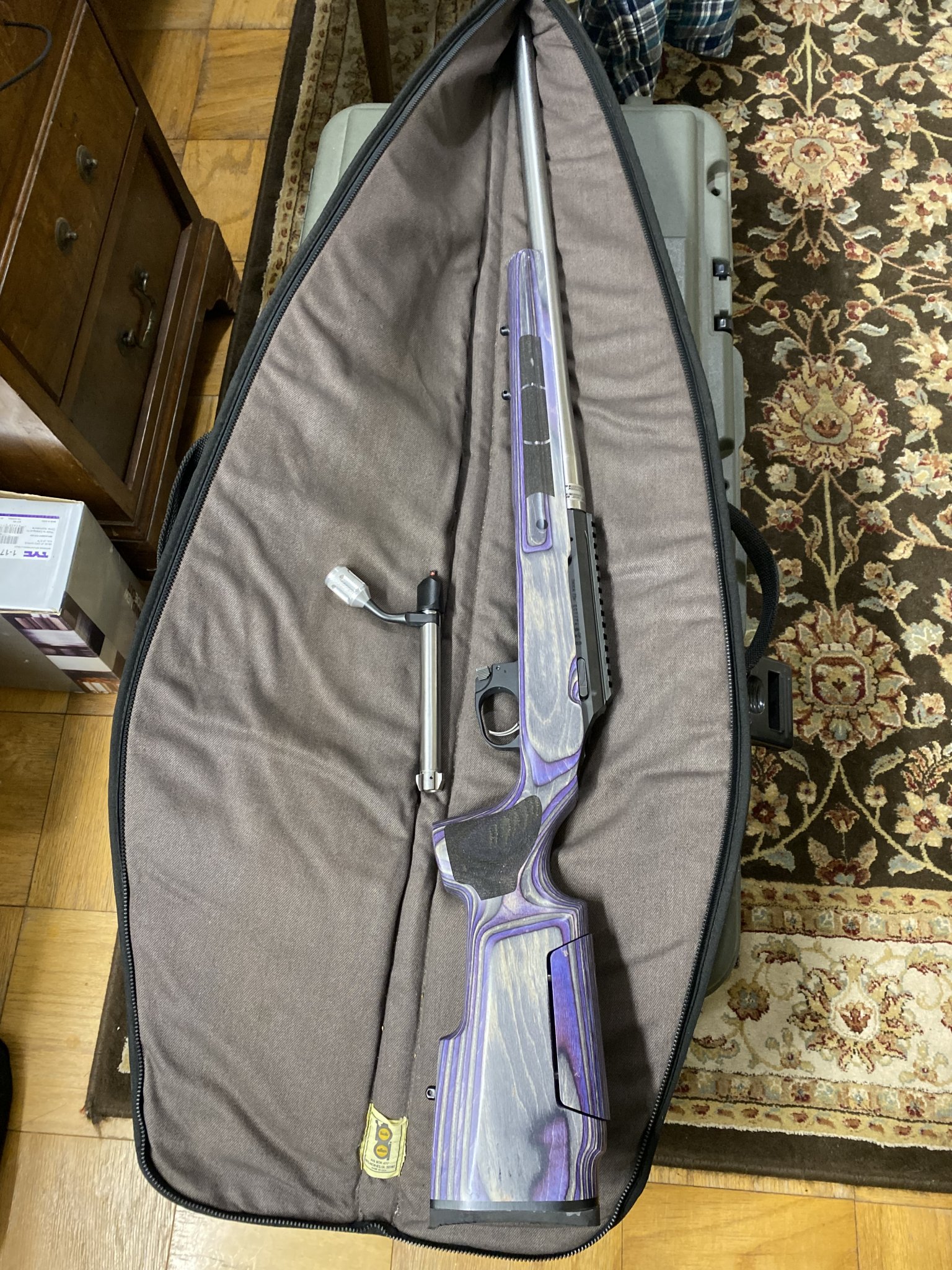

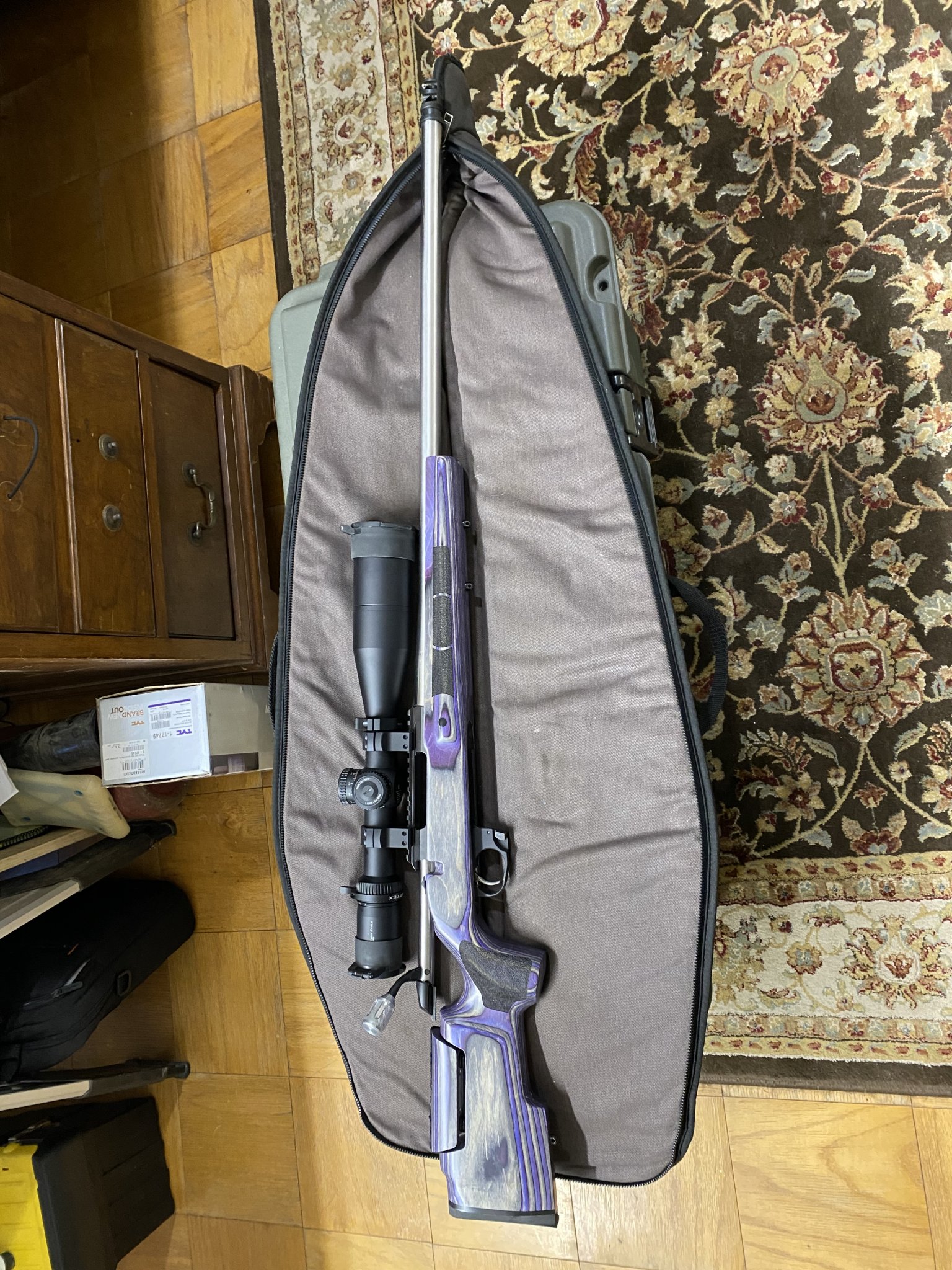

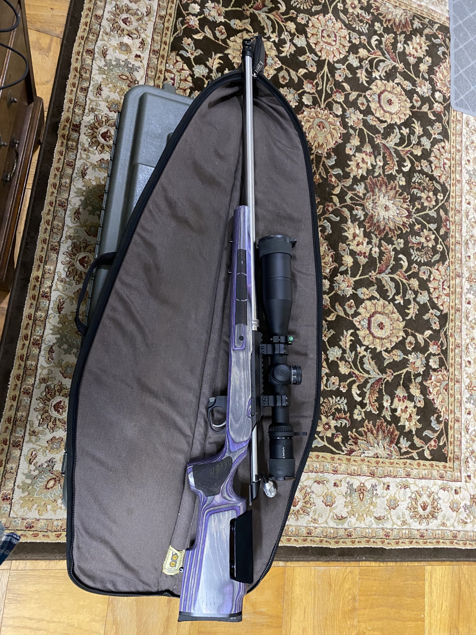

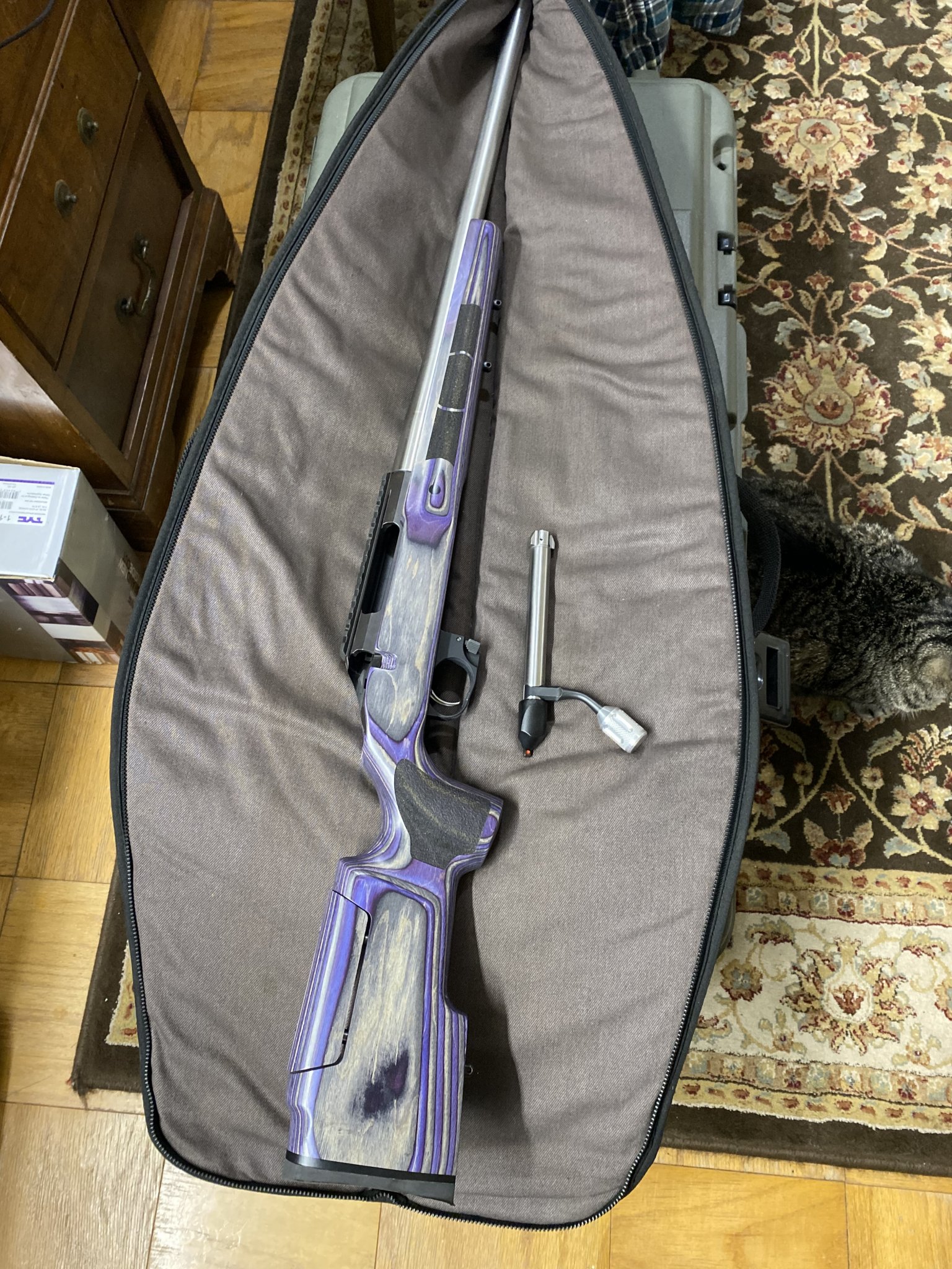

Built this in the last couple of weeks on a 30/06 Lite for my girlfriend as a Christmas present.
She really enjoyed putting rounds on steel at Precision Rifle Expo with the Sako TRG 22 A1 and the Tikka T3x Tact A1 at 500 yards.
I had a couple take off 6mm Creedmoor barrels and put a Boyd’s laminated Varmint stock on it once I got the '06 barrel off.
I had a spare bolt handle and knob as well as a CTR Scope Pic Rail in the spares box that got pressed into service.
It gave me an excuse to upgrade the scope on my T1x based NRL22 rig…
I think she'll like it.
