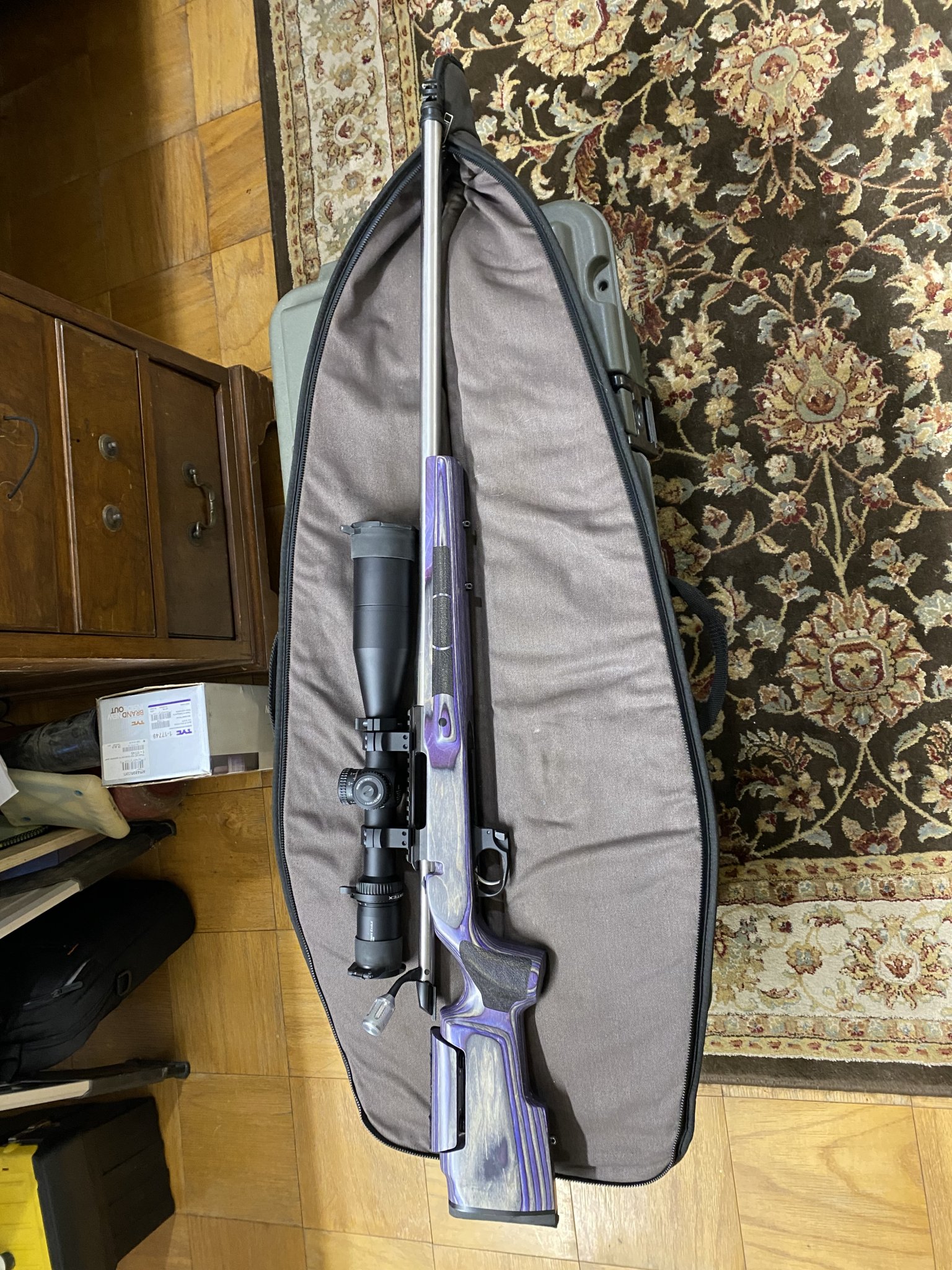

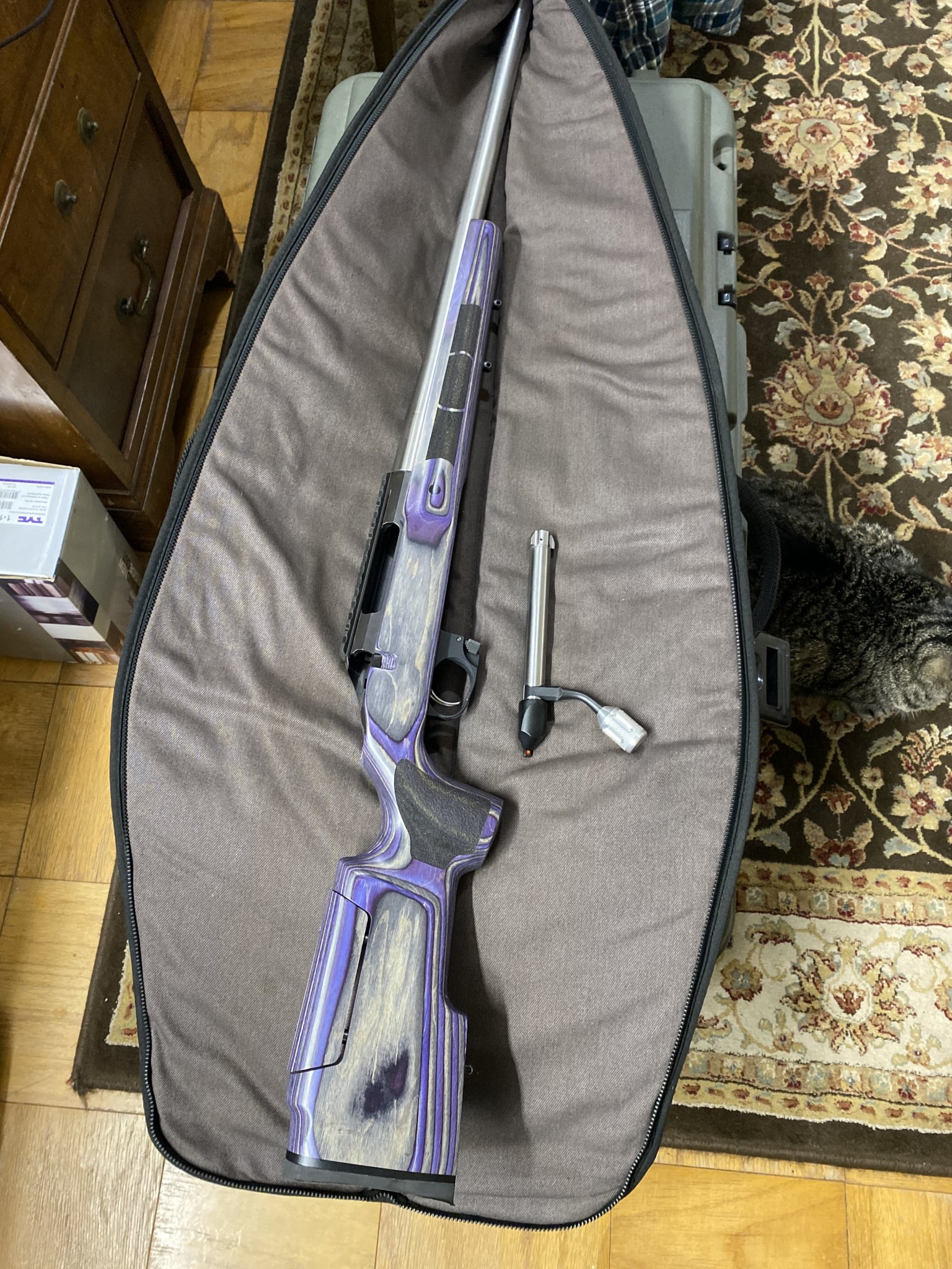

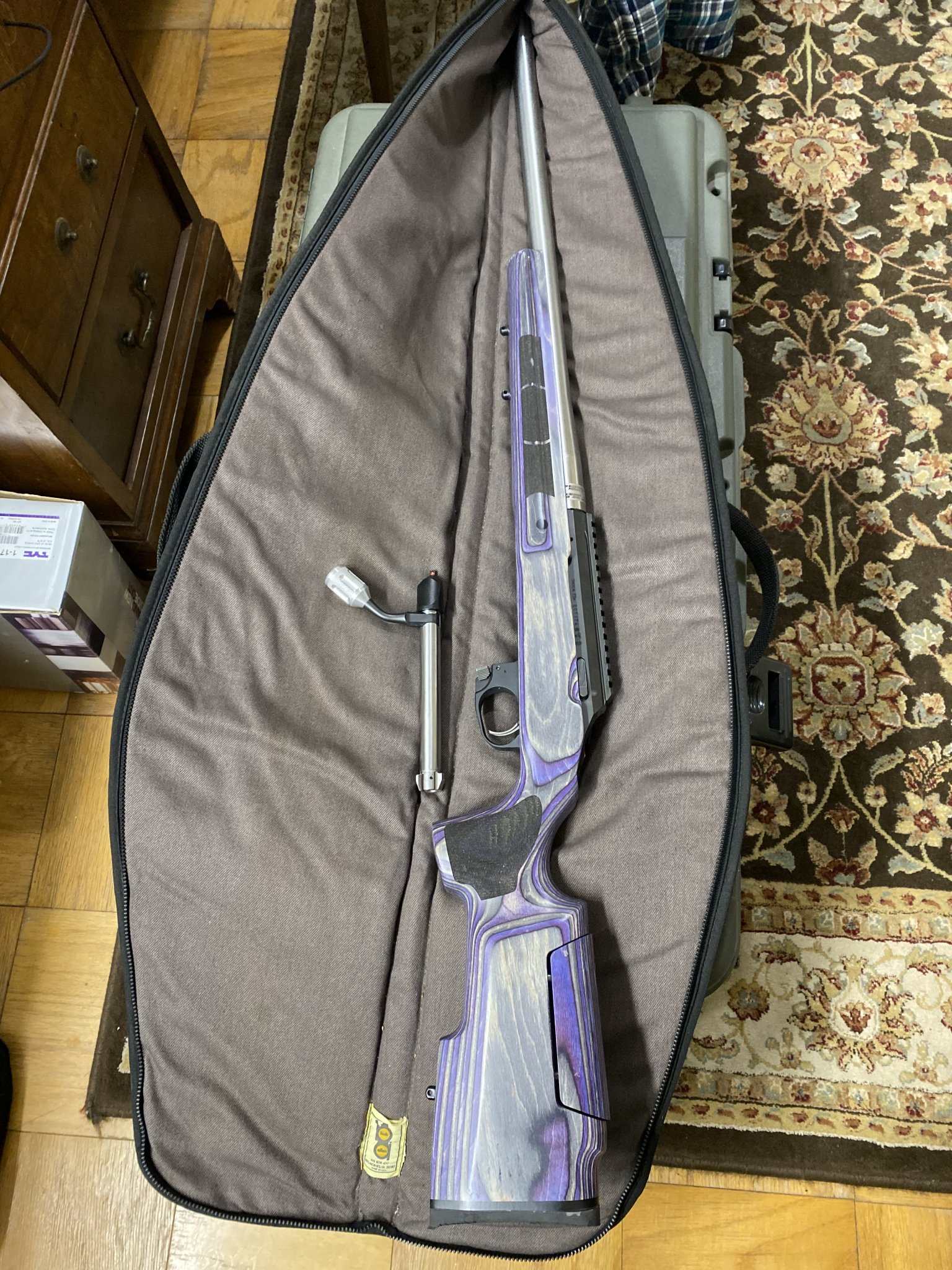

Built this in the last couple of weeks on a 30/06 Lite for my girlfriend as a Christmas present.
She really enjoyed putting rounds on steel at Precision Rifle Expo with the Sako TRG 22 A1 and the Tikka T3x Tact A1 at 500 yards.
I had a couple take off 6mm Creedmoor barrels and put a Boyd’s laminated Varmint stock on it once I got the '06 barrel off.
I had a spare bolt handle and knob as well as a CTR Scope Pic Rail in the spares box that got pressed into service.
It gave me an excuse to upgrade the scope on my T1x based NRL22 rig…
I think she'll like it.
View attachment 8028206View attachment 8028207View attachment 8028208View attachment 8028209

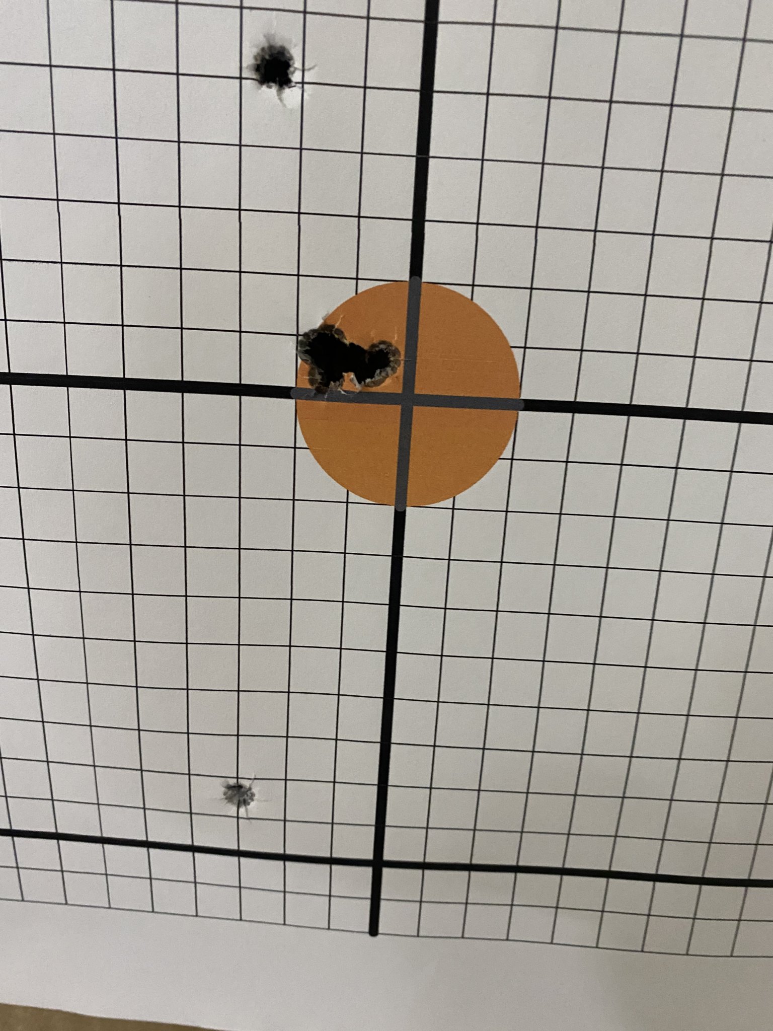

As a follow up:
The girlfriend loves how “Her Rifle” turned out.
I zeroed the rifle this morning in 20 degree weather and shot a sub 3/8” 6 shot group at 100 yards in switchy 7mph cross winds
with Norma Gold Target ammo

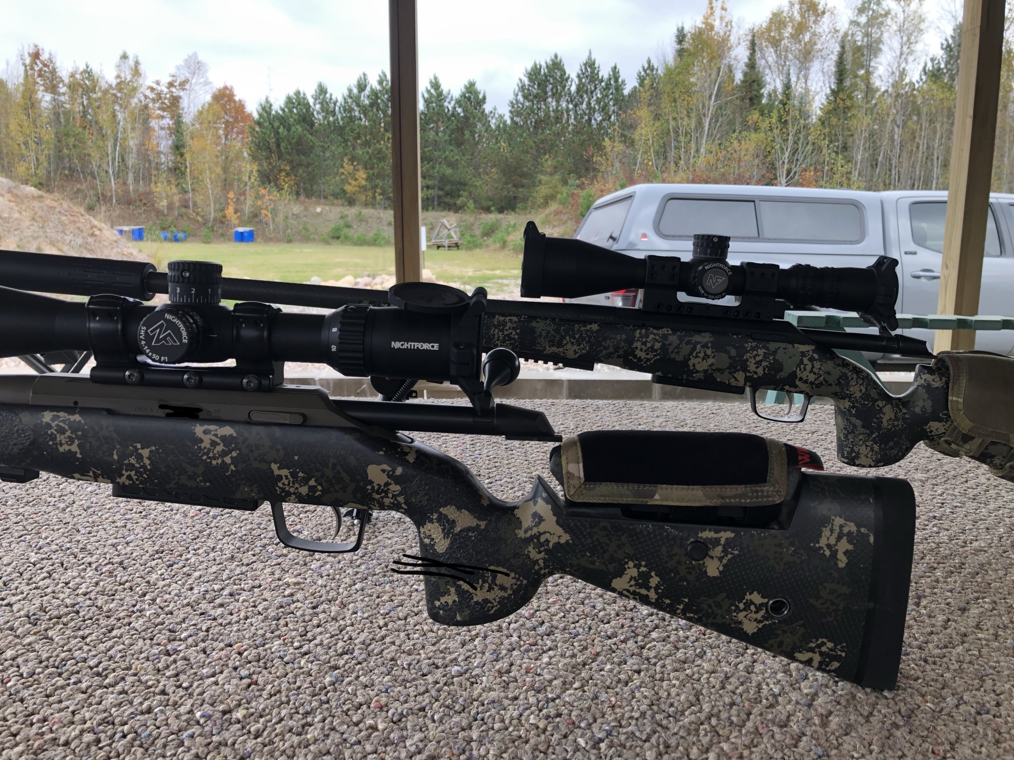

@Lawnboi: what height are you using on those Spuhrs?
The hunting model (which I no longer own) was a 1.18” 30mm mount. Any heavier or a barrel and it wouldn’t have cleared a 50mm scope bell. Factory lite contour fwiw.
The other is a 1.37”, 30mm with 7mils of cant. Iv now got two of those both with nx8s in them. They fit any barrel contour Iv used including ones with 1.25” diameter shanks. Really like the full size spuhr. They have been good to me.
Reactions: Dobermann

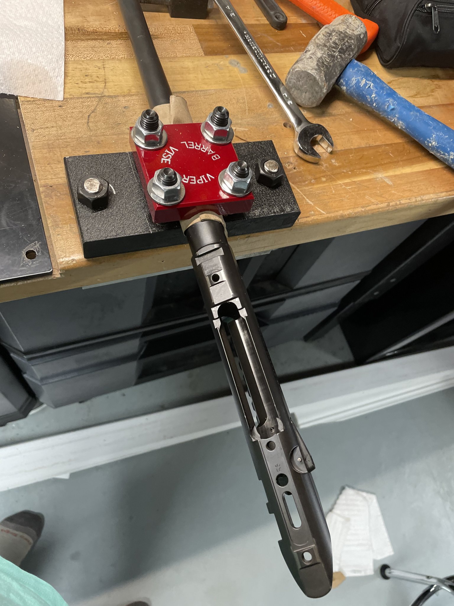

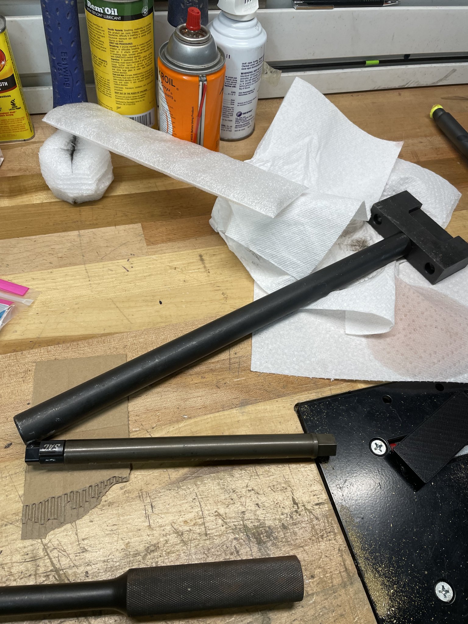

So after reading a ton on hear about how hard it was to remove a barrel I just completed it this morning. It came off way easier than I thought.
I used a viper vise, wheeler action wrench jaws flipped to the flat part, and 3lb sledge hammer, table is bolted to wall and is very sturdy.
1. Put a foam ear plug in the chamber and filled up with kroil in the action let it set overnight.
2. Tightened the shit out the the barrel on the vise. Used a paper towel roll to help grip the barrel and keep it from marring.
3. Tightened the action wrench slightly behind where the thread stop on the receiver.
4. Three hits with the sledge hammer on the handle action swings loose.
Maybe I got lucky but I wonder if people are not tightening the vise down enough and making sure everything is very solid “vise, table, wrench” before trying to remove the barrel. I was ready to put a torch on it and use freeze spray but did not need to.

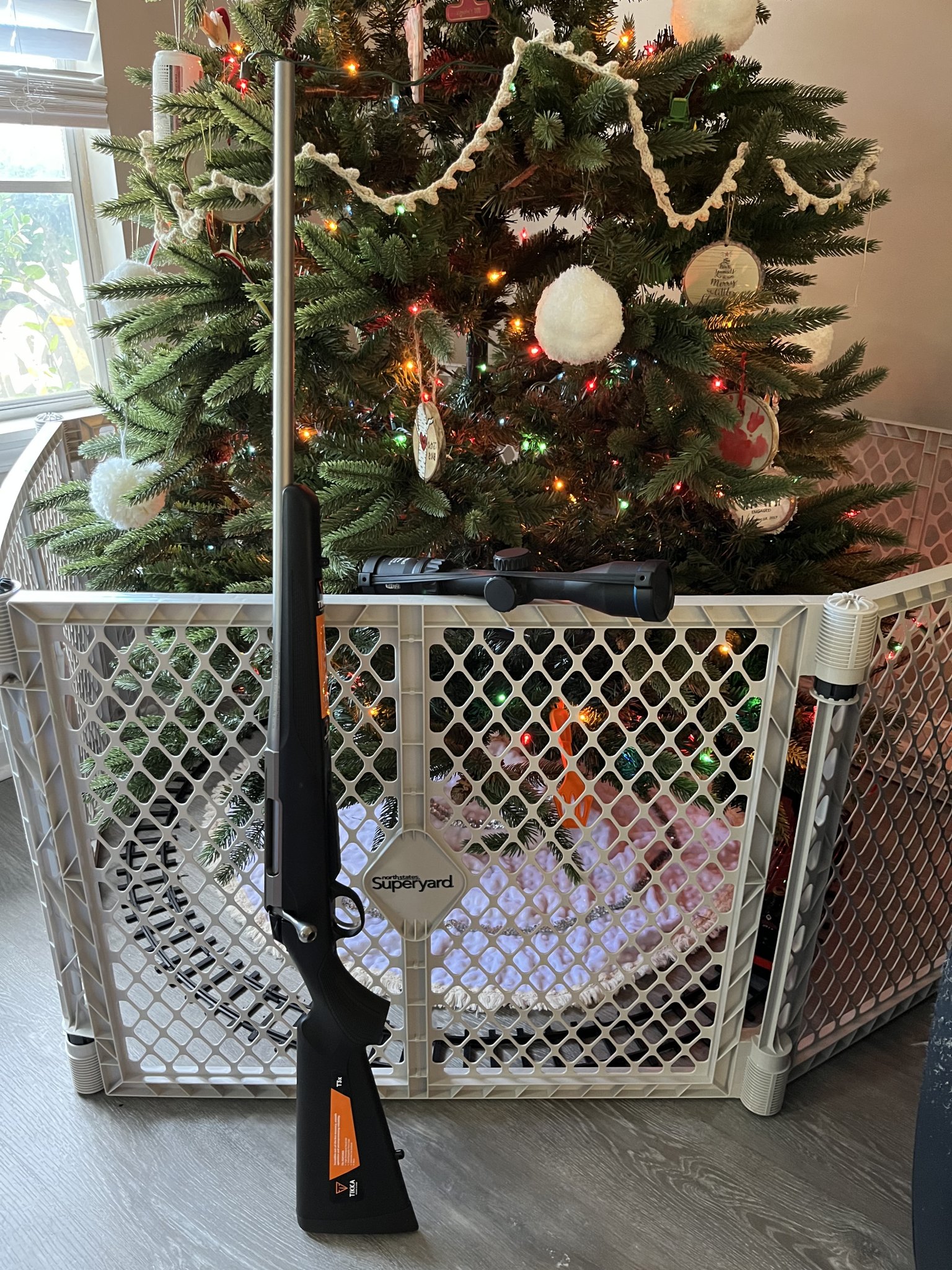

Just a plain T3X in 6.5 Creed and a Minox Optika 5 2-10 were under the tree for me this morning.
Just waiting on the Talley’s to arrive and some ammo and we will see how she shoots.
Seeing those gates up brought back some fond memories . A new Tikka rifle and scope is great, having twin toddlers to share xmas with is priceless. Congrats !

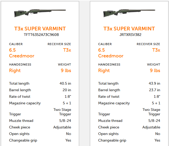

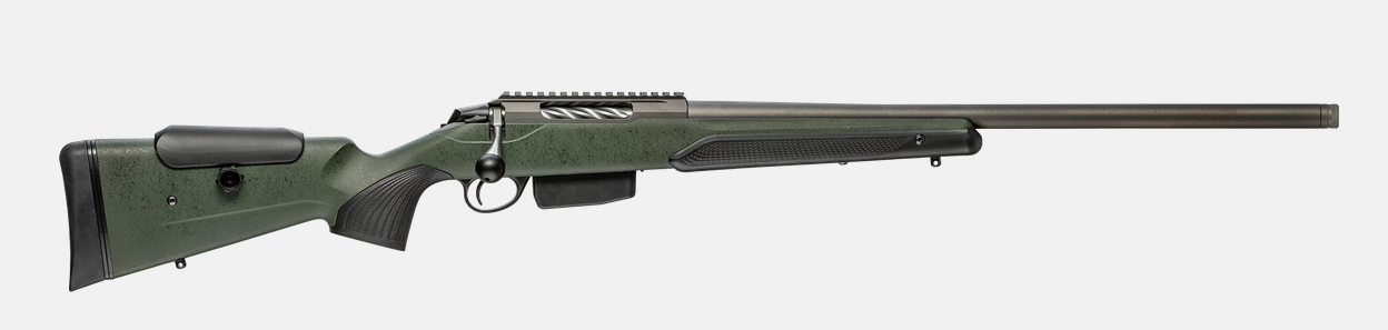

Apologies if this has been posted before, but ...
I was cruising the Tikka Selector tool, thinking over options, and noticed that the new Super Varmint ... has a two-stage trigger:
Tungsten Ceracote, enlarged bolt handle, Pic rail, heavy varmint profile barrel (choice of 20 or 24" for 6.5 Creed), and 5/8-24 threaded ... Could be a great option for a barrelled action!
(Especially as Tikka are currently only showing three models as having a two-stage trigger - the Super Varmint, Arctic, and Tact A1 - and the second two of those are clearly specialised platforms/not the best candidates for aftermarket stocks.)
And, zooming in, it *almost* looks as if the Pic rail is integral on the Super Varmint. I can't tell for sure, but that would just add to the goodness...
Lots of cartridges available; here's the specs on the two 6.5 Creed models:
Seems incredibly unlikely they are making a 1 off reciever with a built in pic rail and also deciding to keep the dovetail cuts under it.

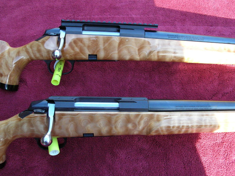

There was a company from Norway making a rail that bolted on but also slid onto the dovetail rail. It looked amazing. Sadly they folded. No one had picked up the mantle.
Maybe something Near could look into as they make the Sako 75/85 rails that slip on the dovetails.
