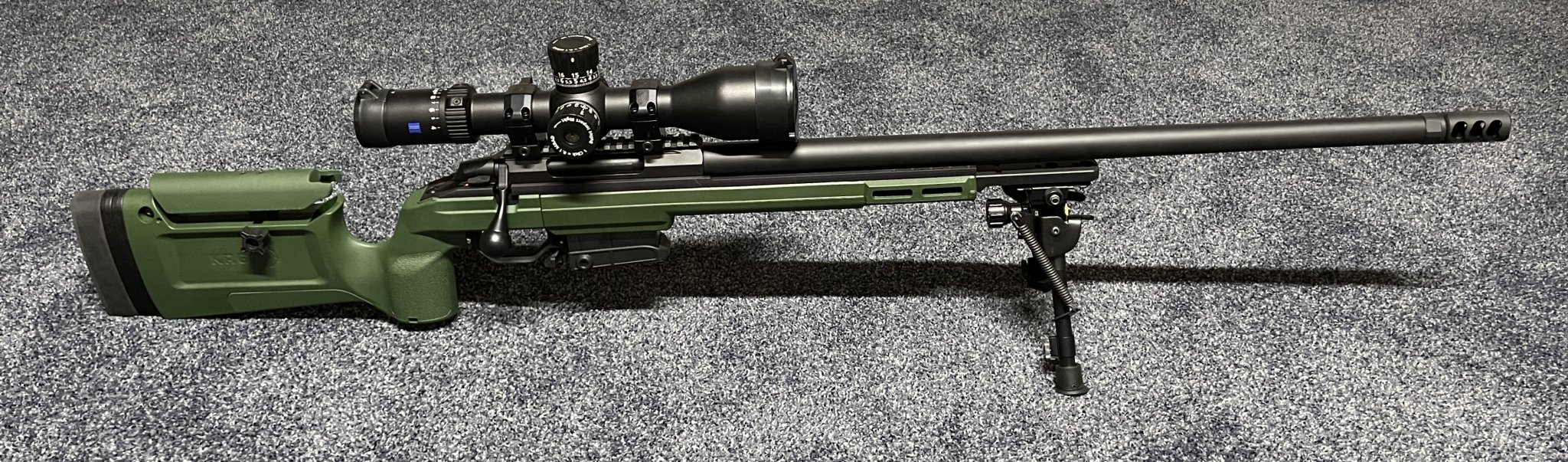

Finally got the Arca rail mounted up today. Need a different scope mount and decide what to do about mags - either inlet for bottom metal/AICS mags or run the Waterman extended COAL mags.

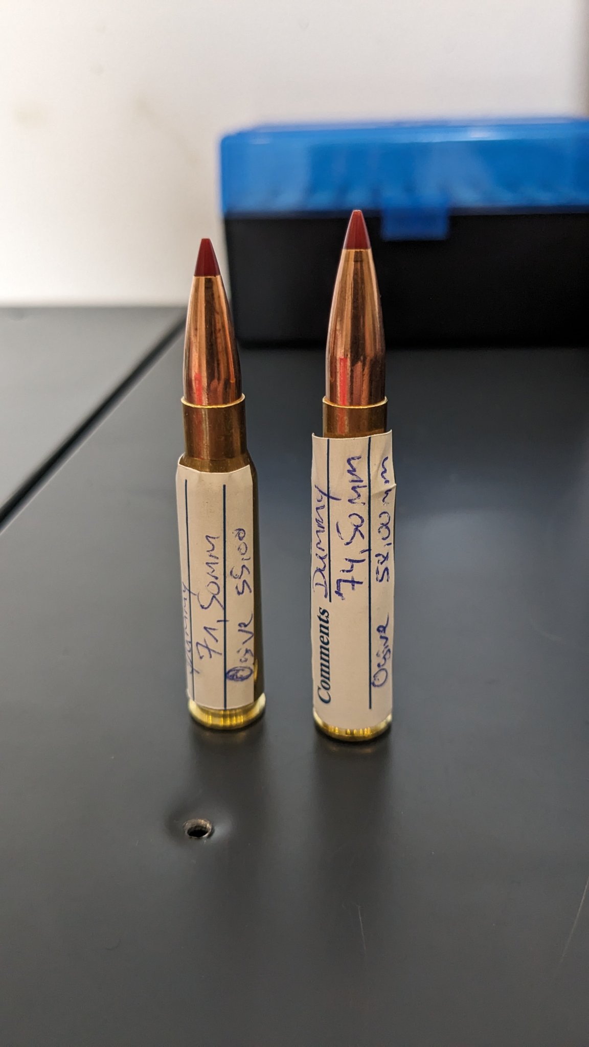

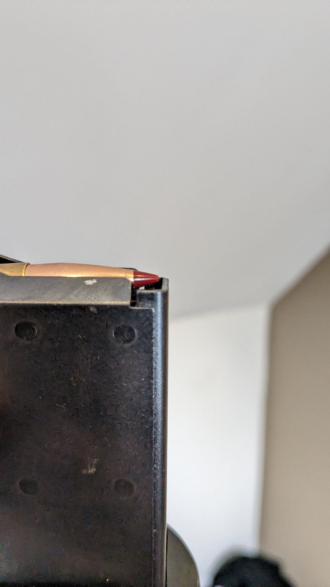

Trying a new load for CTR.
My old one was VV N140 39,9 grains, ELD-X 178, Brass 51,00mm OAL 71.5mm, V0 = 724m/s
The new one will be:
VV N540 42,8-44,2 grains, ELD-X 178, Brass 51,00mm OAL 74.5mm, V0 expected to be round about 810m/s ( mag max lenghth is 75,12mm). ( test of loads within next two weeks )
Pretty fast powder for that weight bullet.
I had really good results with N150 for 175 Scenars, tried some loads with N540 as well, but didn't get the same consistency, and ran into pressure much faster.
Don't have N550 in my closet currently, think that would be close to optimal.

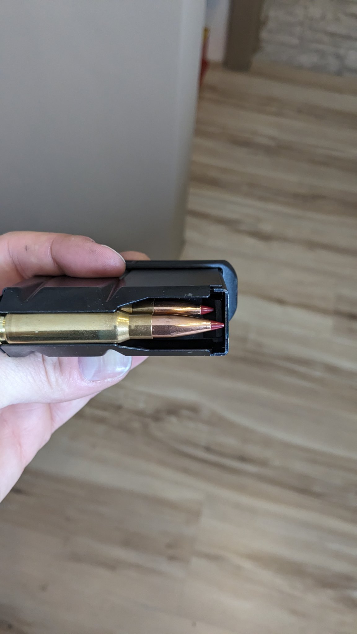

As you know, i am a big fan of KRG.

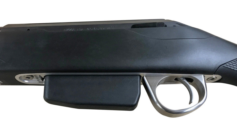

So i received the kit, that i was able to modified with 2-parts the AICS chassis to eat to CTR/TRG magazine.
Job took about 15-minutes.
I have tested it now few times, and i just love it.
Need to find a TRG magazine now, just love the way this type of magazine works.
CTR magazine is not as good quality as TRG, no matter some one is saying, they are not the same magazine.
I have had few TRG magazine, and you can tell the difference when you hold them, CTR is made of not that good quality steel.

I have should recorded the change, now it is done, but for sure i could do it again, it was not that difficult job to do.
TRG magazine material is better than CTR, the steel is better, and on CTR the mag bottom is plastic, TRG only thing is plastic, is the follower.

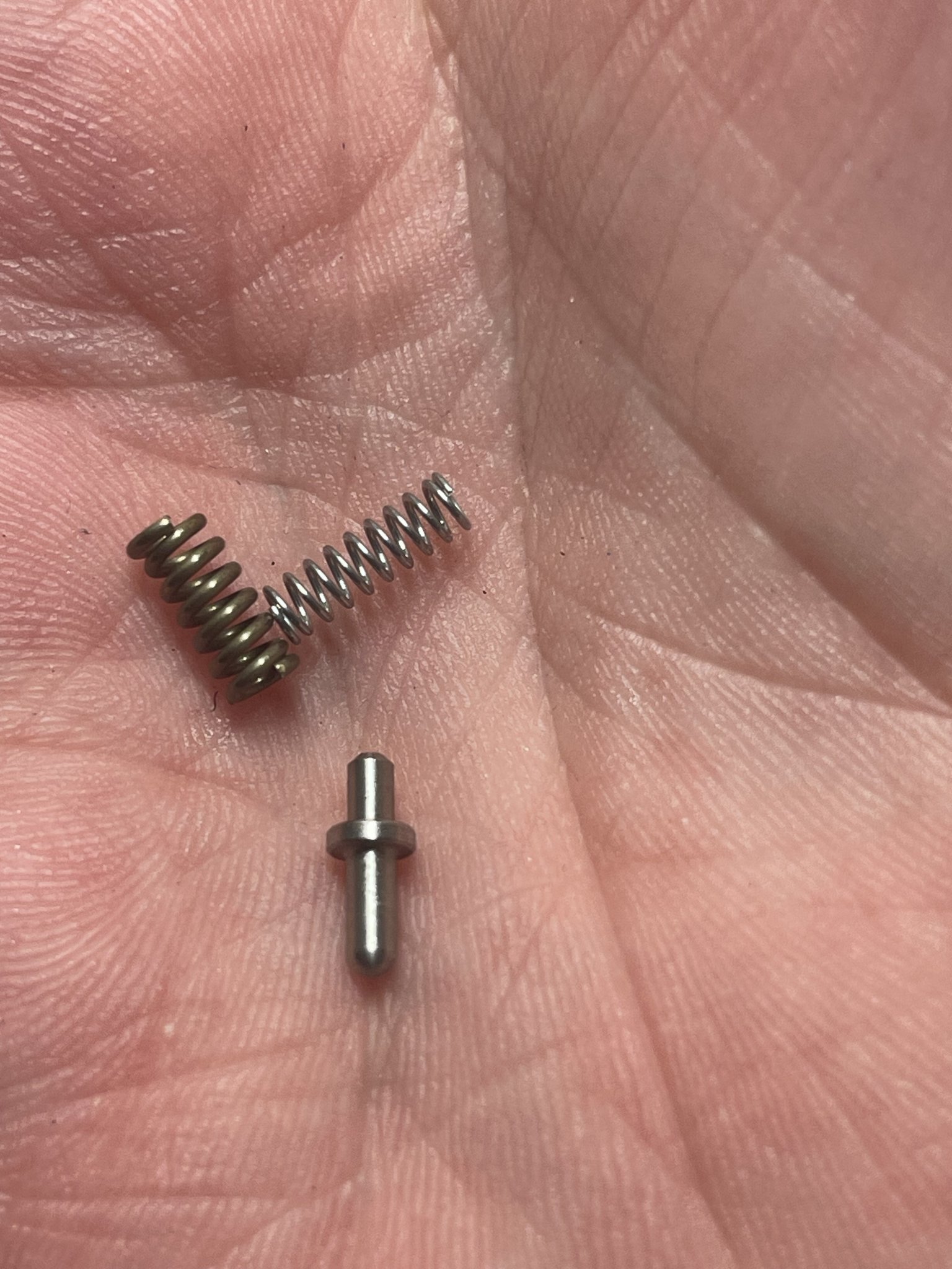

I stripped my TAC A1 down last night to swap the rail, install a YoDave trigger spring and swap the grip afterwards.
That YoDave spring is capable of insanely light pull weight. I wound up pushing it up to the upper end of the adj range with the YoDave.
Then I stripped out one of the friggin Torx screw heads on the rail. Too aggravated to work on it any more tonight.
Gonna get after it over morning coffee tomorrow.

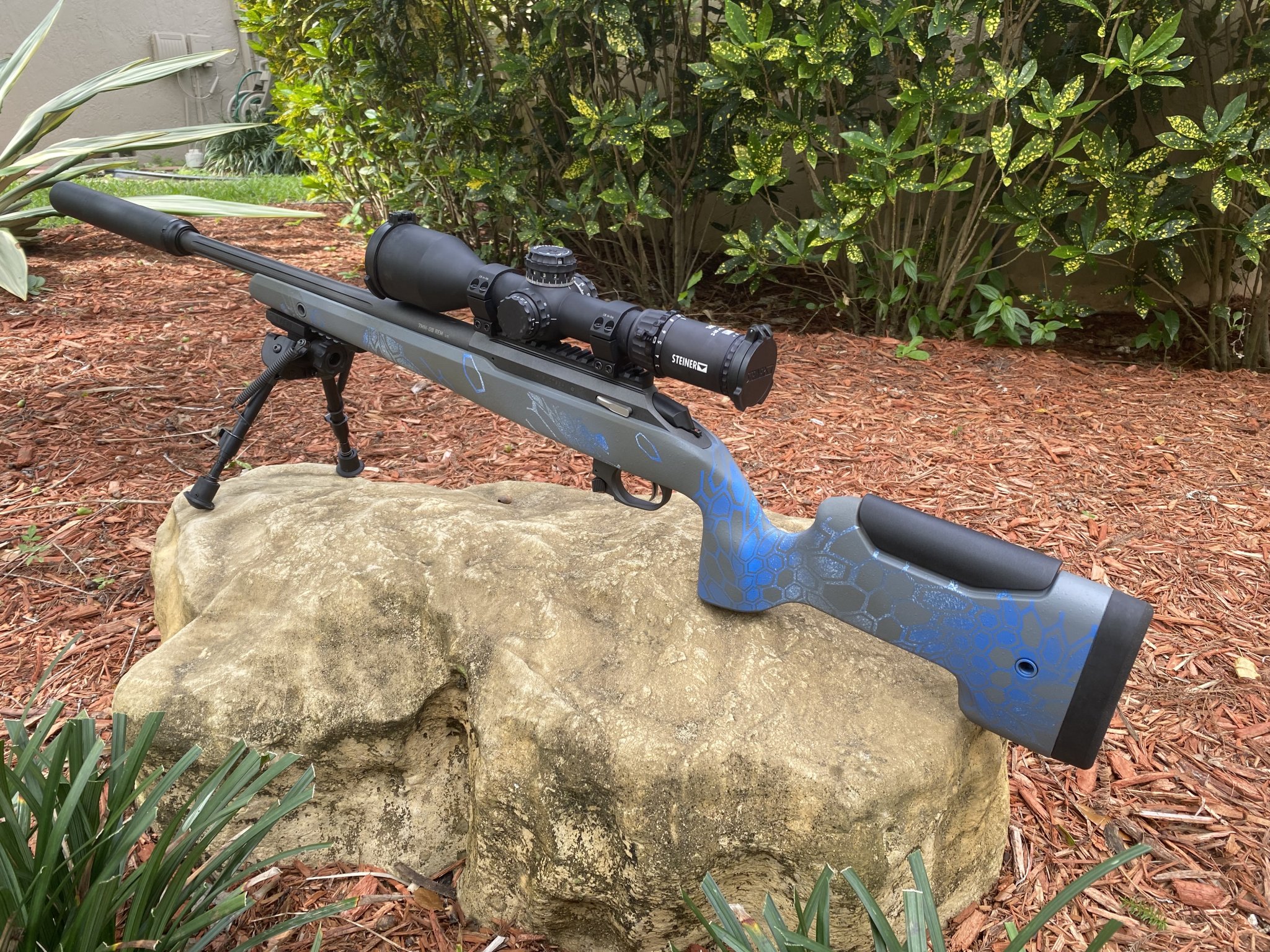

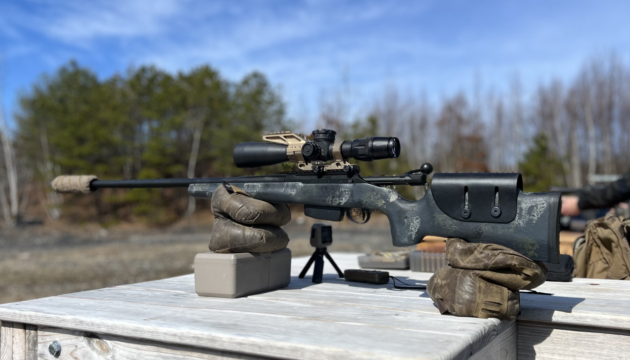

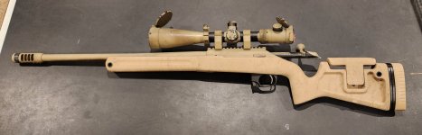

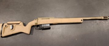

Last night my Grayboe Phoenix showed up for my CTR in 308. I was really impressed with how it fit up getting the barreled action on the stock. The factory bottom metal fit up nice and tight, dummy rounds fed and cycled smoothly. I threw on my old Vortex PST gen 1 6-24 ffp and just need to get this zeroed. I can't begin to describe how much I like this stock more than I do the KRG Bravo I had it in prior to this. Best part was that when I weighed it with scope and empty mag it came in at 10.8 pounds. This rifle is going to be used as an all around backup for competitions, backup for hunting trips, and a primary rifle if I go to Mammoth again in 2025. It's a little heavy for a hunting rifle and a little light for a competition rig, but it's accurate enough for both and will eat 308 all day. I just need to give the whole setup a quick dusting and touch up with the krylon so it doesn't look all mismatched.

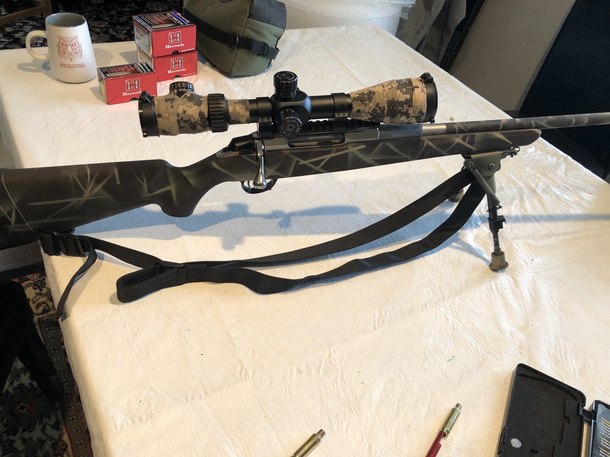

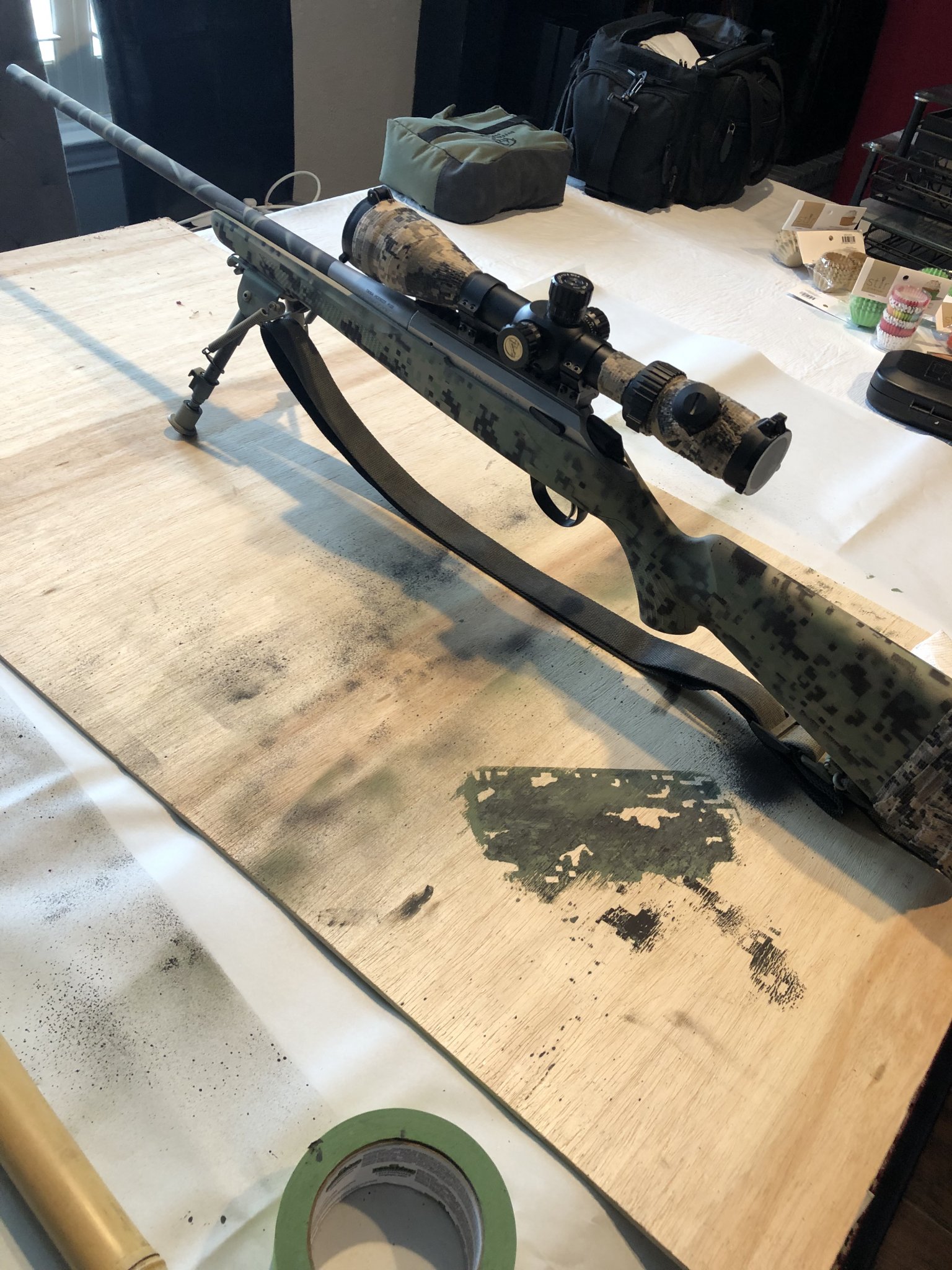

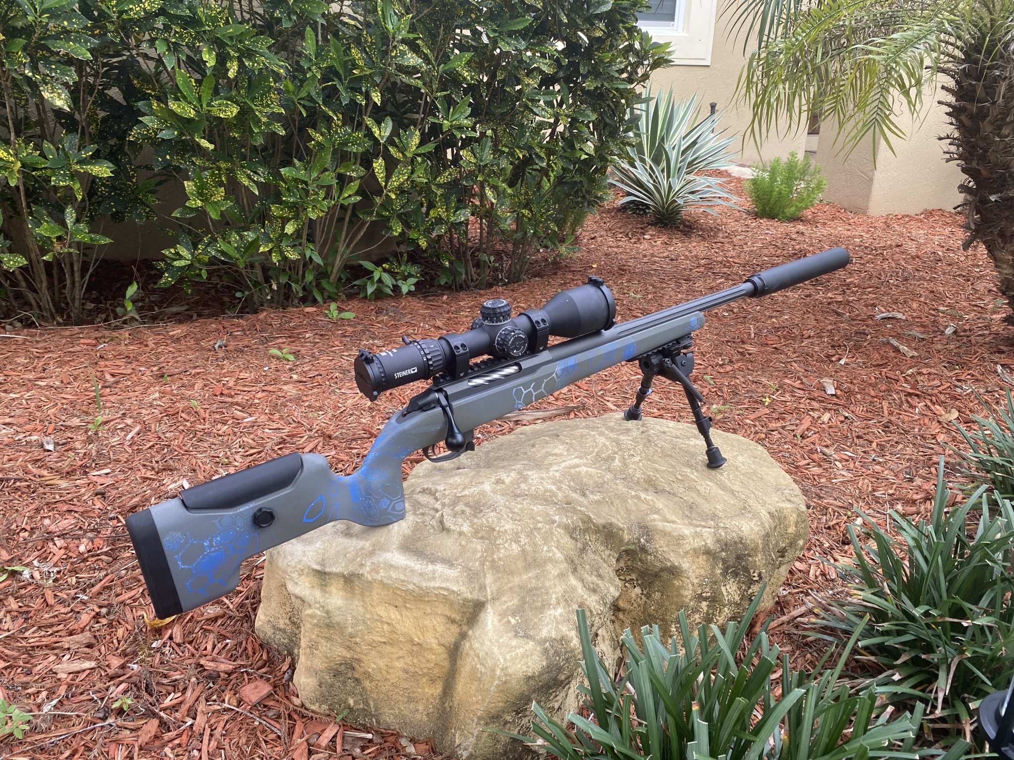

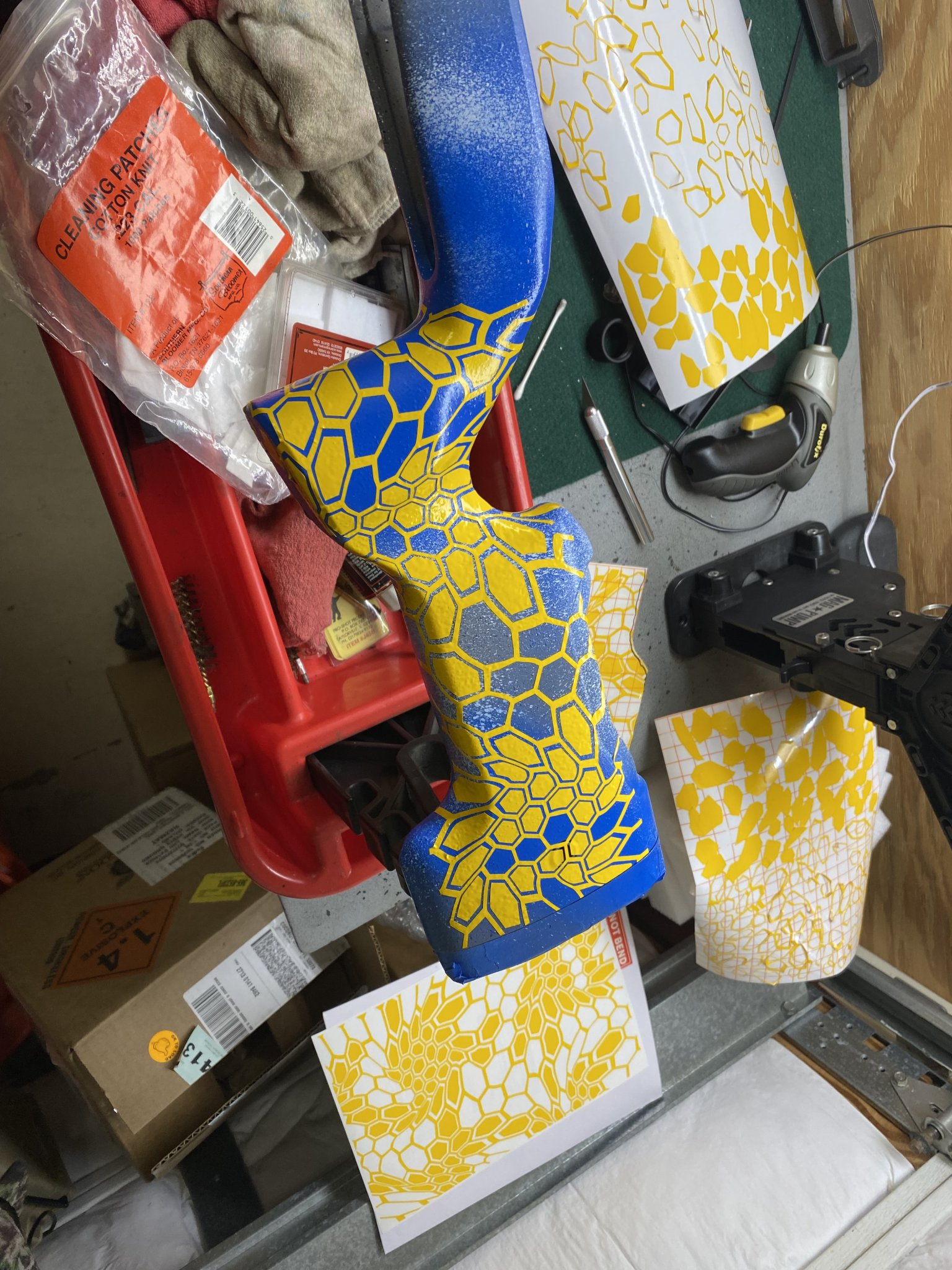

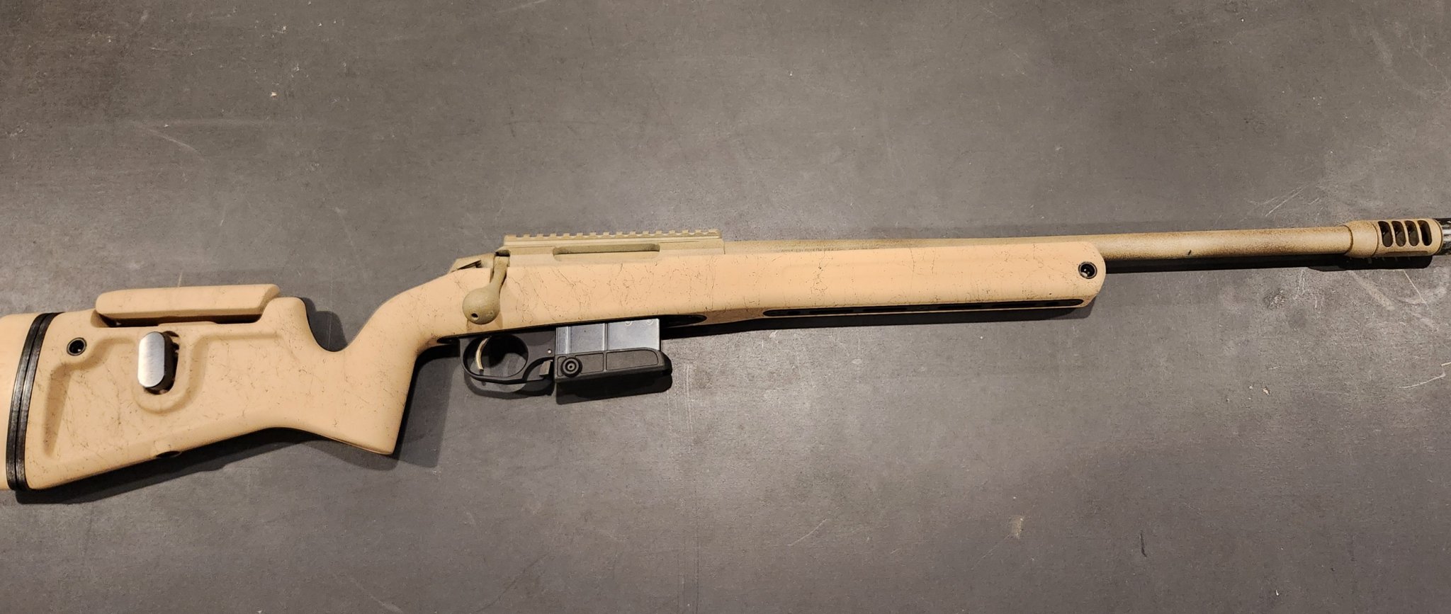

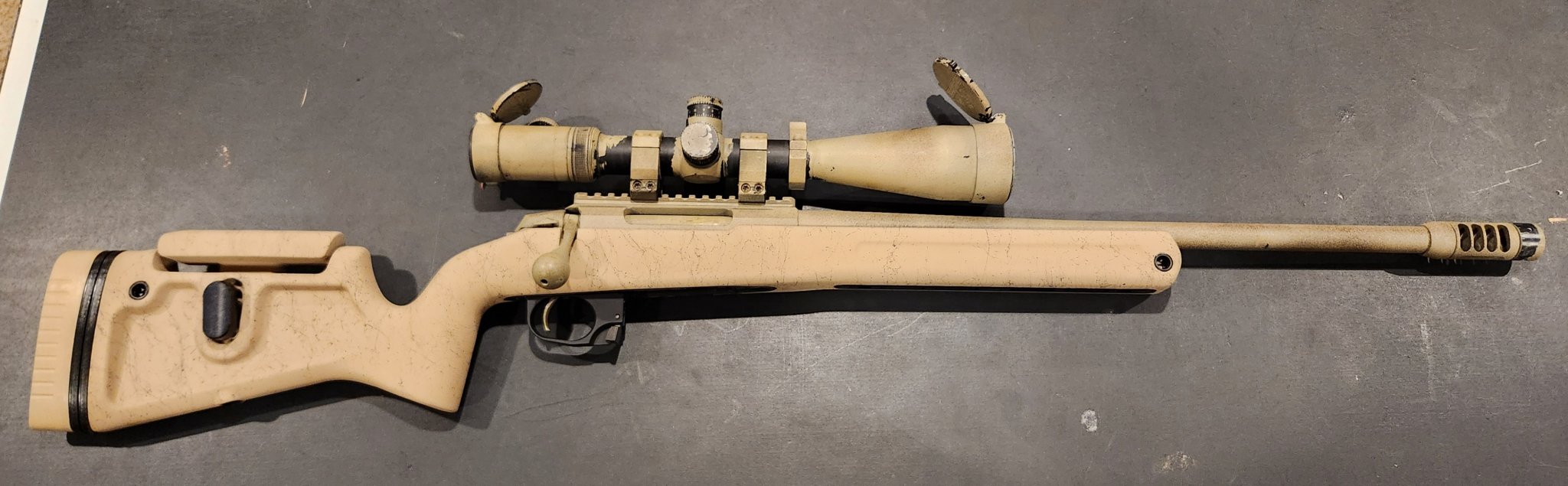

Well... I took a shot at blending all of the different colored items together and I think it turned out half way decent. I no sooner got done and realized that I had forgotten to put the bipod on the stock, so I've got one more spray paint project to look forward to. I already knew the rifle shot well in the factory stock and KRG Bravo, but this new Grayboe is the final home for this barreled action.
Reactions: Bbracken667
Interesting result. I went with a digital camo which was more difficult than I originally envisioned lol. Turned out pretty good. The advantage to painting your own is that you can change it up whenever you want to.
Reactions: teddy12b
