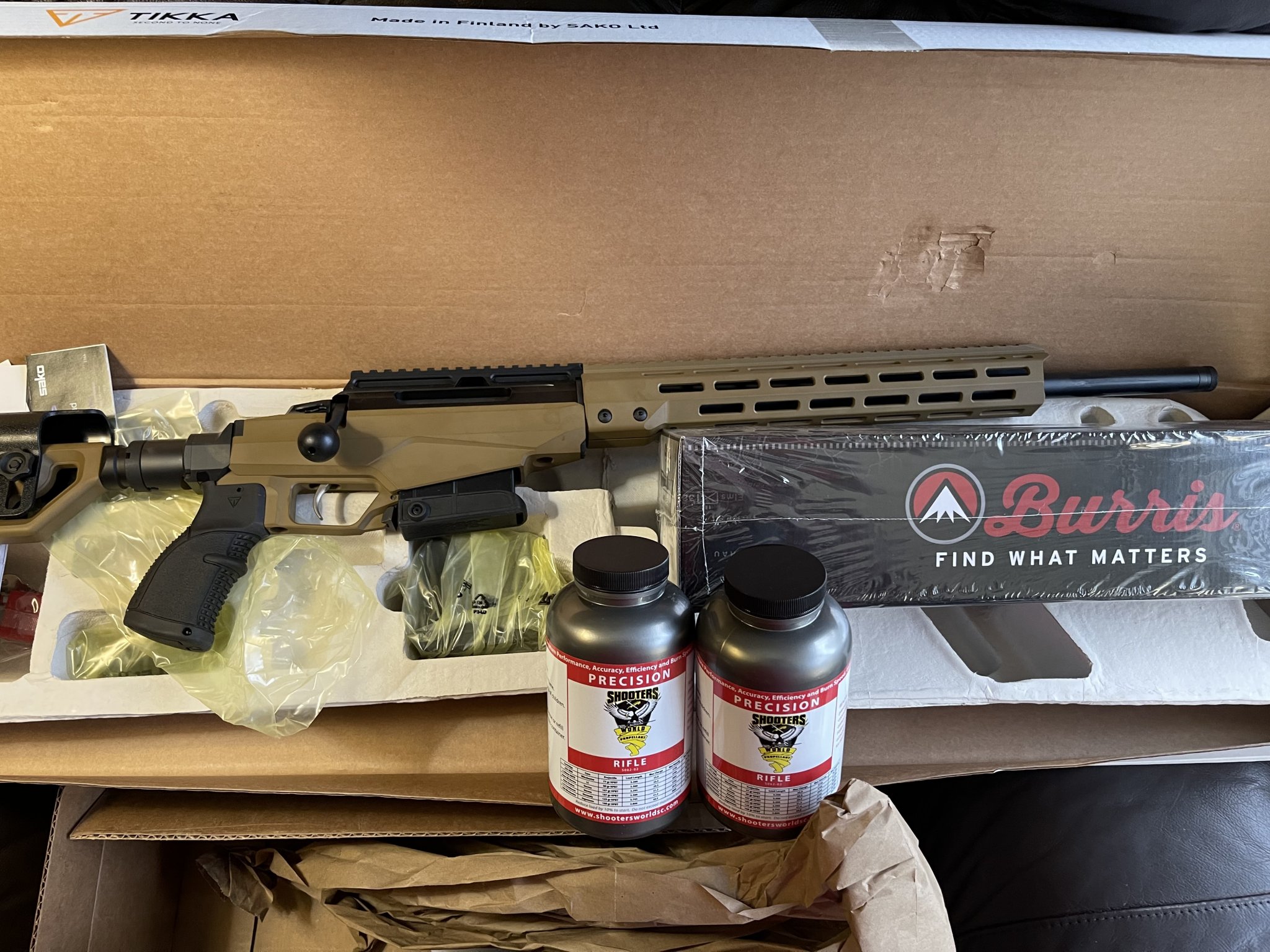

Picked up some Horandy ELD match and a lead sled to hopefully get it completely dialed in.

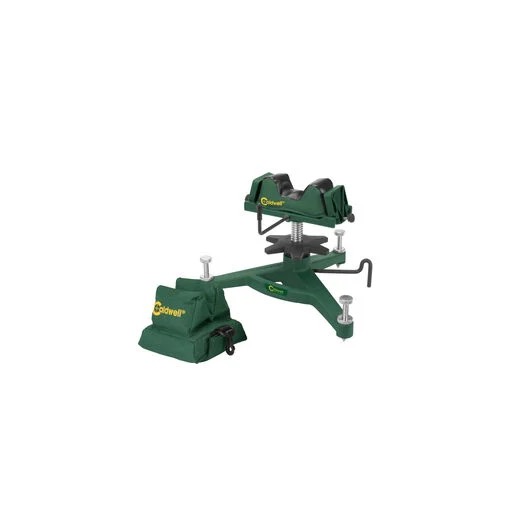

I don't know if it makes much difference, but I had purchased a Caldwell shooting rest (so not a "real" lead sled?), not something that gets weighted down. My intention was to use it to assist in getting as close to a "perfect" zero on the Tikka and my AR. I did also think of it as being handy for cleaning, so a dual purpose purchase.
The way I figured it was, get the zero right and make sure my equipment is on point using the Caldwell rest, and then when I start shooting with a bipod or free hand I'll know where MY skills are lacking, rather than questioning whether or not my zero was on.
Or is that a silly way of looking at it? And that's a genuine question, not me being snarky
The Caldwell Lead Sled that I am accustomed to have a pocket that provides a firm rear stop for the rifle.
It transfers all of the recoil into the rifle.....hammering it.
I've seen wooden stocked magnum sporter weight hunting rifles have significant stock damage from these things.
Now, the free standing Caldwell shooting rest that allows a separate rear bag that supports the stock is fine as it allows the rifle to move with the recoil. Your body absorbs the recoil more than the stock.
Will give you a wrong zero when you are in the field, as recoil affects your point of impact, and you will not deal with recoil the same as with that lead sled or similar.

So I had bought this one thinking that because the stock would still be shouldered that it would be more acceptable? I do plan on getting a bipod for the rifle at some point here. My thinking was that if the front is just resting on something extremely stable (even more so that a bipod), and the gun is free to recoil back and transfer most of that energy to my shoulder, that it would be an easier/more accurate zero without "hurting" the gun or optic.
Thanks for taking the time to write that all out, I'm still absolutely brand new and reading up on the basic fundamentals. I'm still clueless on body positioning, etc..
That should be much less damaging than the Lead Sled models.
I'd probably place some type of cloth or towel between the rear rest and the stock in hopes that it would allow the stock and easier movement under recoil by making that rear less "grippy"

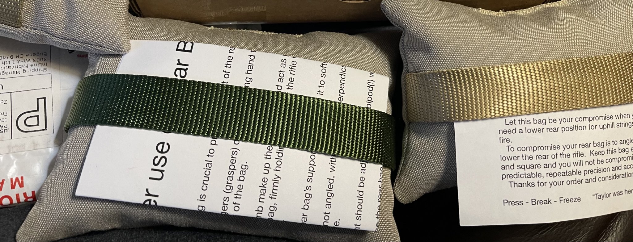

Recently picked up some of those very rear bags from The Guru. :)
Picked up the small-medium-large trio.
Looking forward to getting the to the range and giving them a test run.

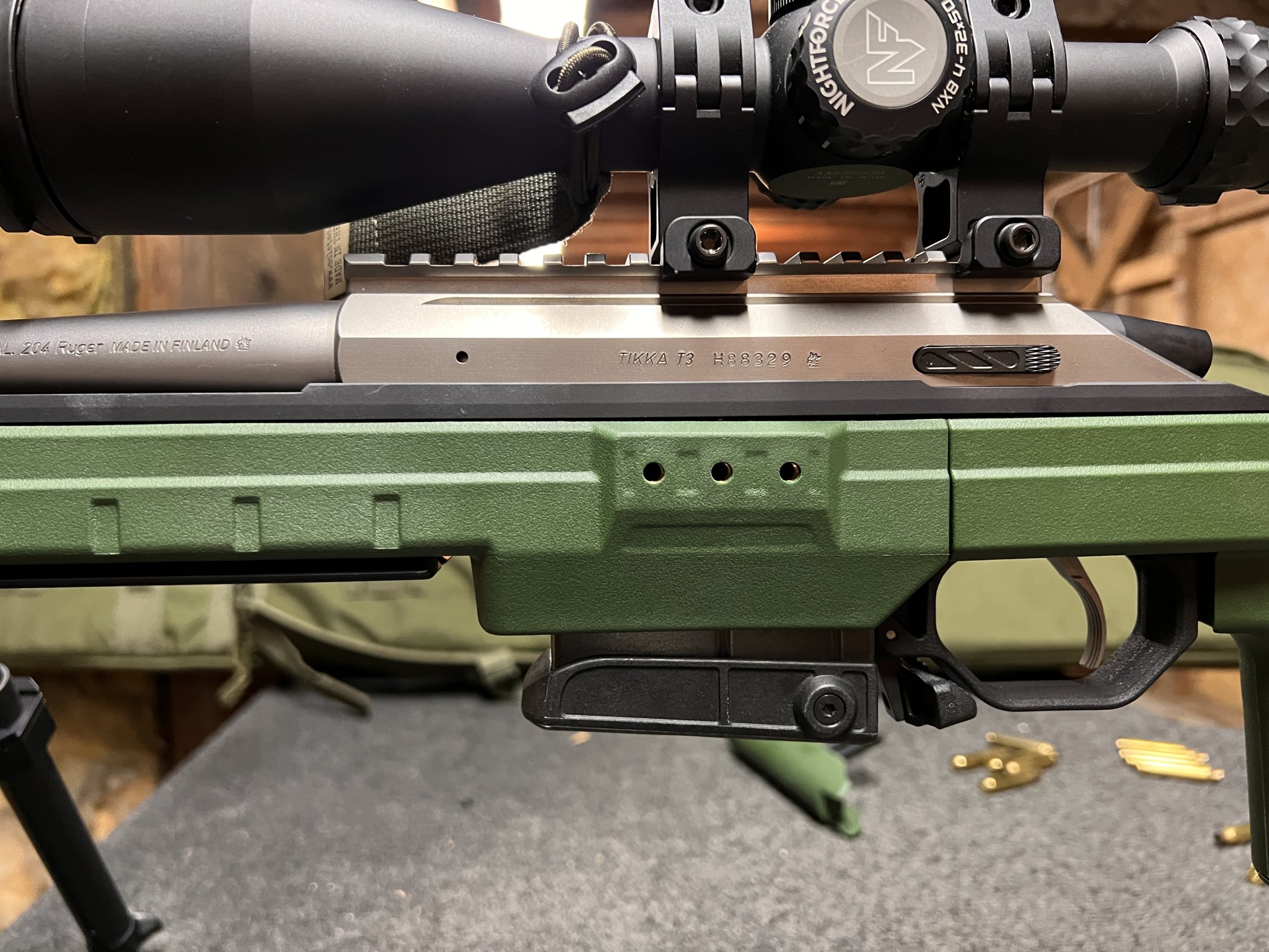

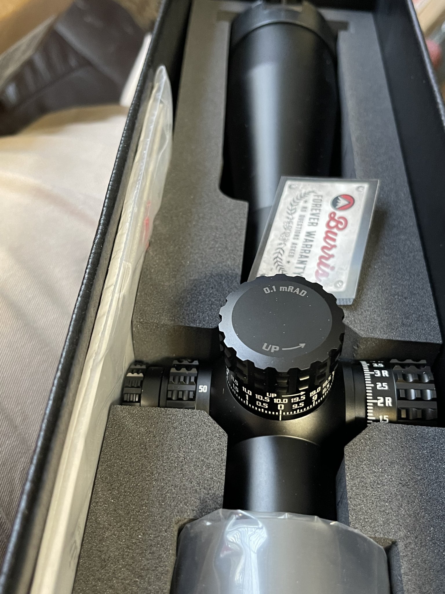

FFL called me this afternoon to let me know the TAC A1 had come in.
Before I could get out of the driveway......the glass for it arrived.
Picked up a couple pounds of SW Precision Rifle from my FFL when I was there.,
Today has been a great day off work. (y) (y) (y) (y)
Gonna grab some dinner and then get the rifle on the bench to adjust the trigger, install a rail section, brake and mount the scope.
I have a trigger spring on the way for it, too.

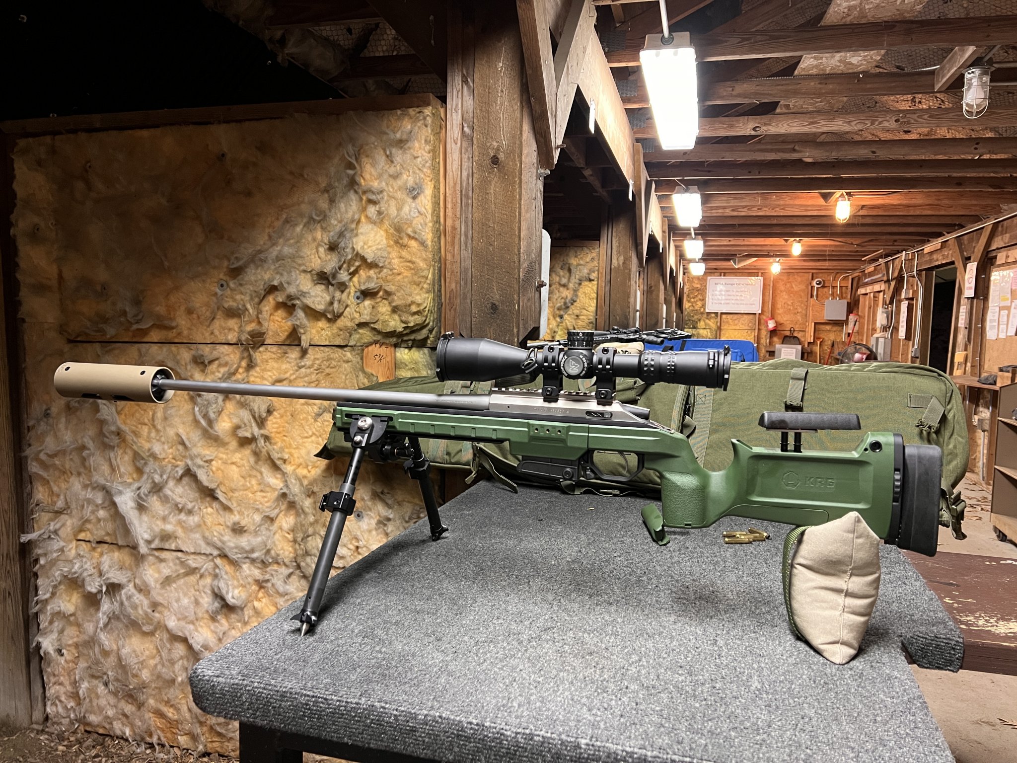

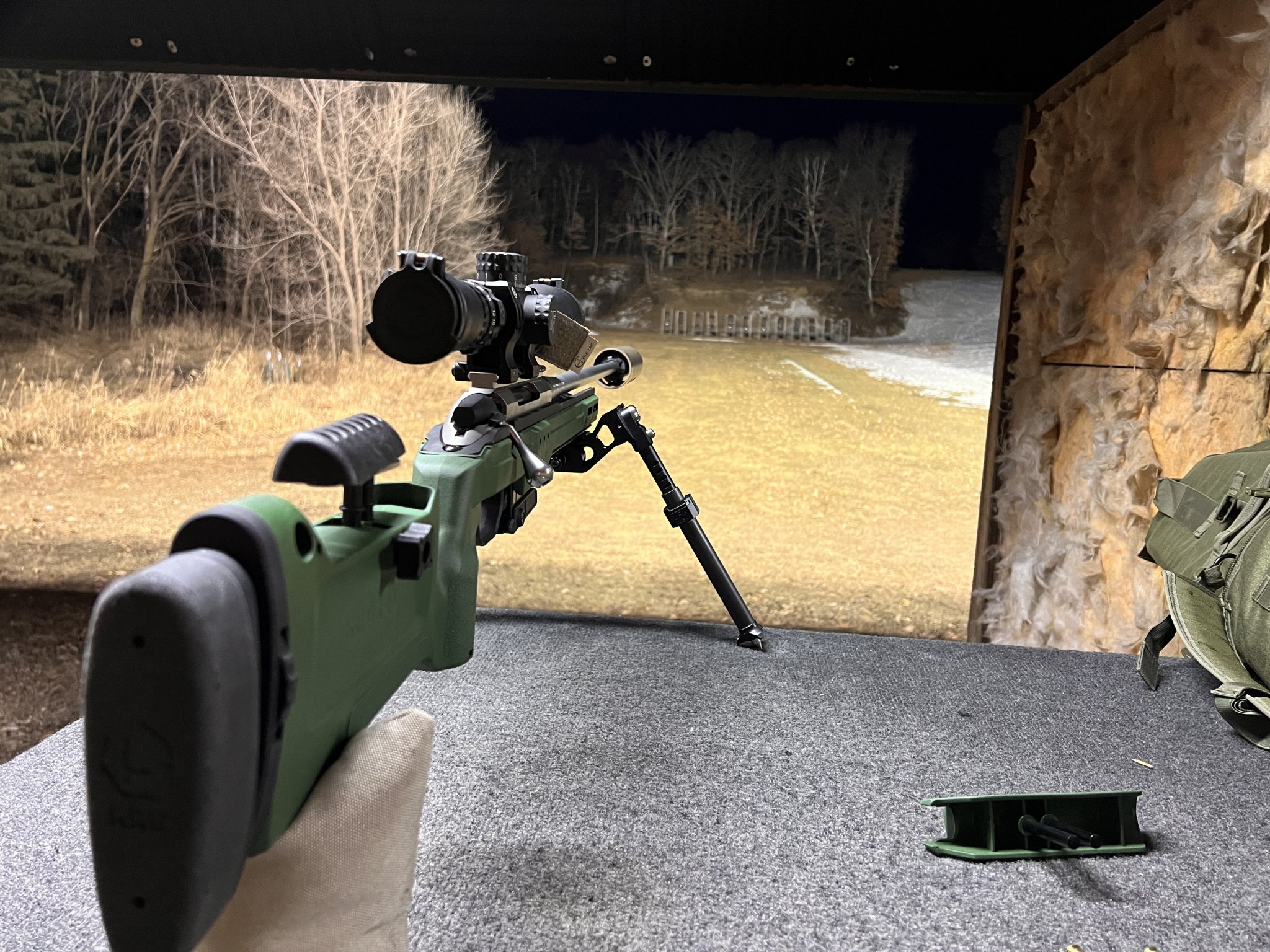

Well, got my Tikka .204 CTR-mag only Bravo today in Sako green. Surprised as hell to discover I got a version 2!!!
Yeah, that’s my angled W3 cheekpiece on there. Love it. Gonna have to get a clone for the Bravo.
Man, CTR mags are the shit for the 204. Beautiful feeding, way better than AICS on my R700. Often couldn’t even tell when I picked a round up. Only had time for 15 rounds 😢 so this is preliminary, but I didn’t have a single hitch.
Can’t wait until KRG releases their updated Midas trigger. If it’s like my two-stage Bix I might just ditch R700 pattern rifles altogether.
That’s the factory 22” sporter 204 barrel on there. Picked this puppy up used off of GB. It was shooting weird in the factory laminated stock. It would shoot 32gr vmax Hornady factory ammo about .8 MOA, but inconsistently, and 40gr sorta poor. I’d sometimes get wild flyers, like +2moa.
Anyway, I’ve ordered a heavier 204 barrel from bugholes. I’m sure it'll shoot better. Might keep it at 22” as well for more of a walk-around gun.
If this skinny barrel turns out to be a shooter I’ll try to save it when it gets taken off. Maybe I’ll have a switch barrel Tikka?
I tried eight 204 rounds in the 10 round 223 CTR mag and it was fine. I think nine will get sketchy as the nose tends to pop up.
For someone like me who basically only shoots small calibers, the Tikka mag situation alone is super compelling.

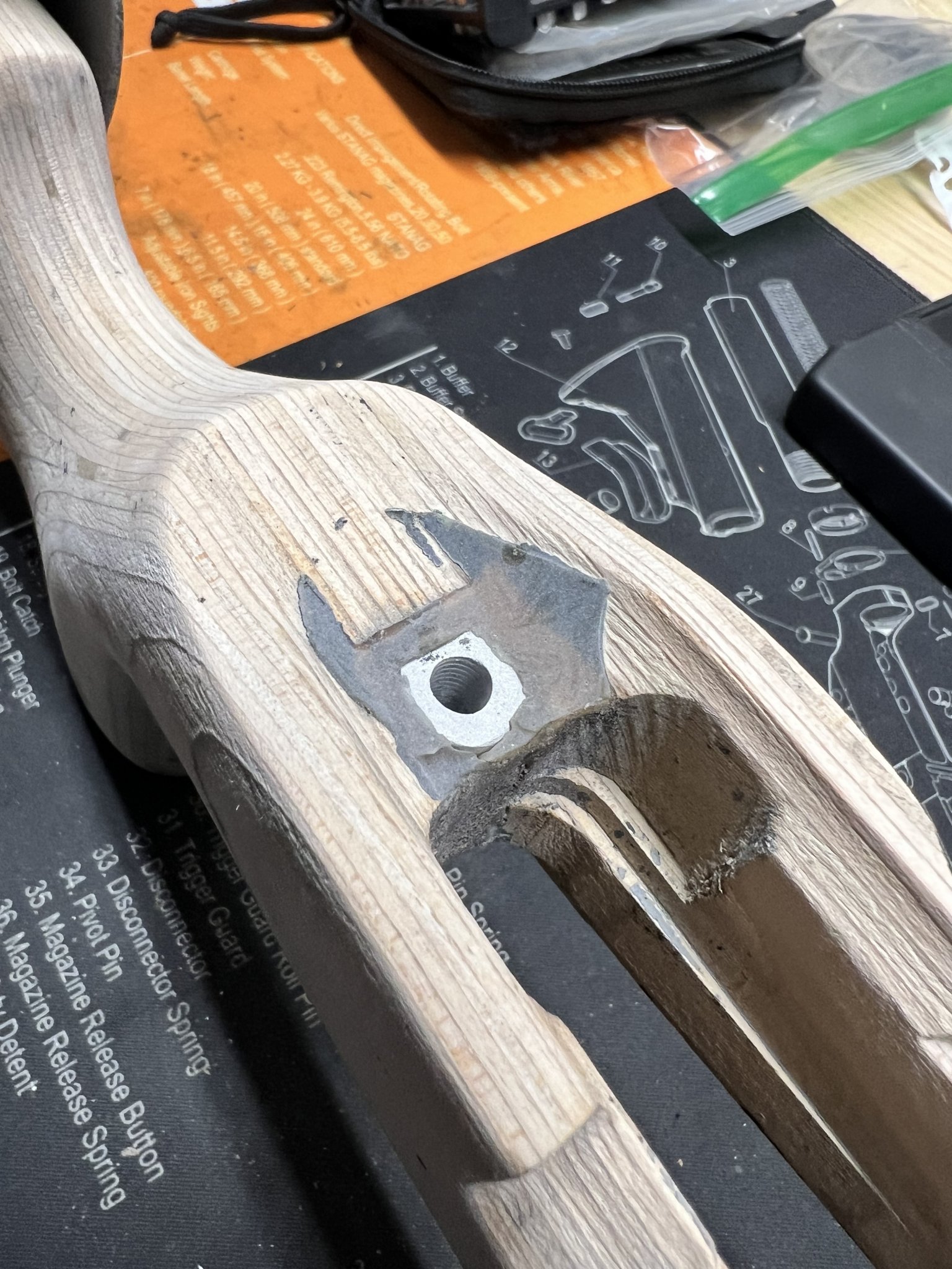

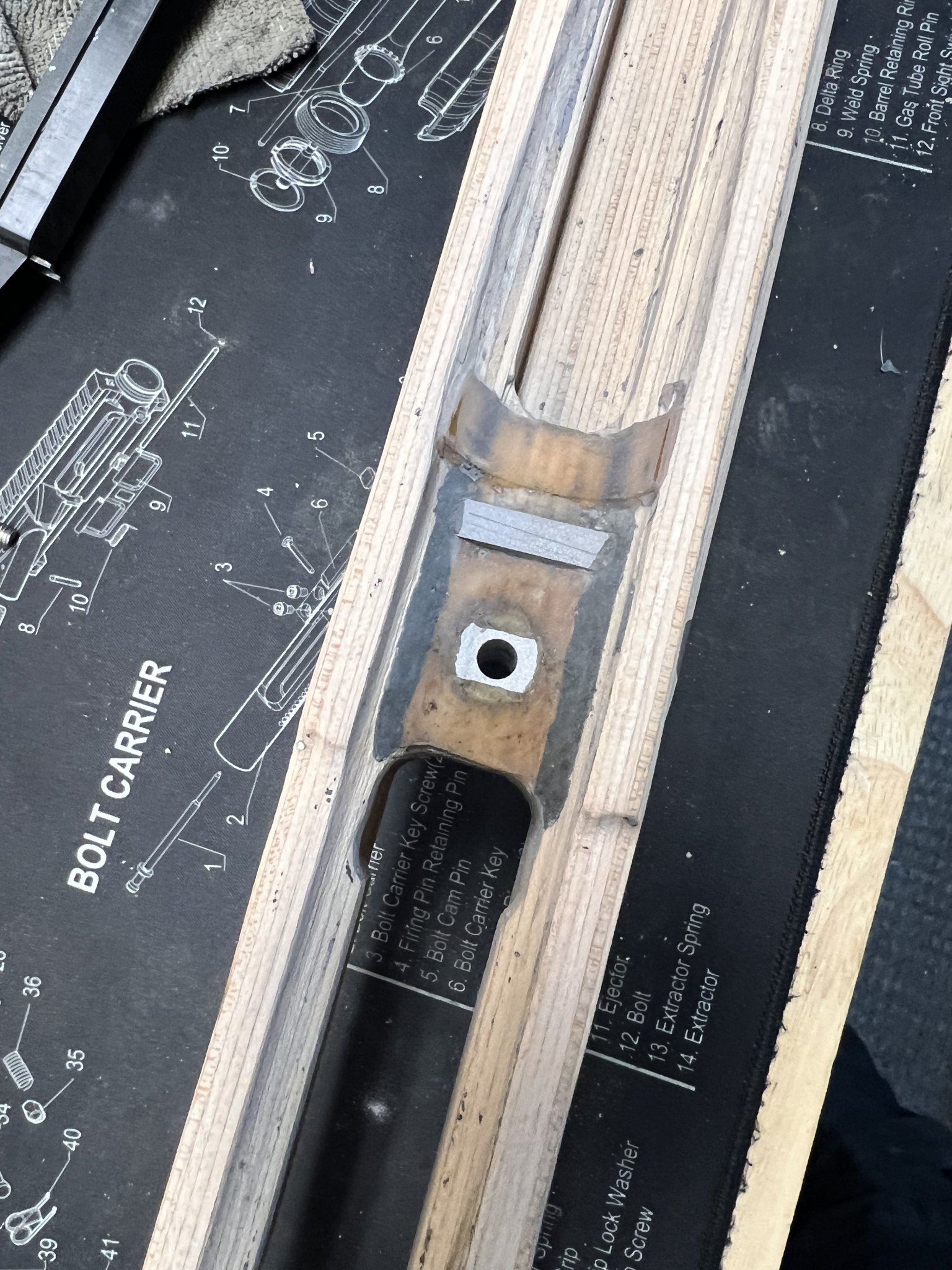

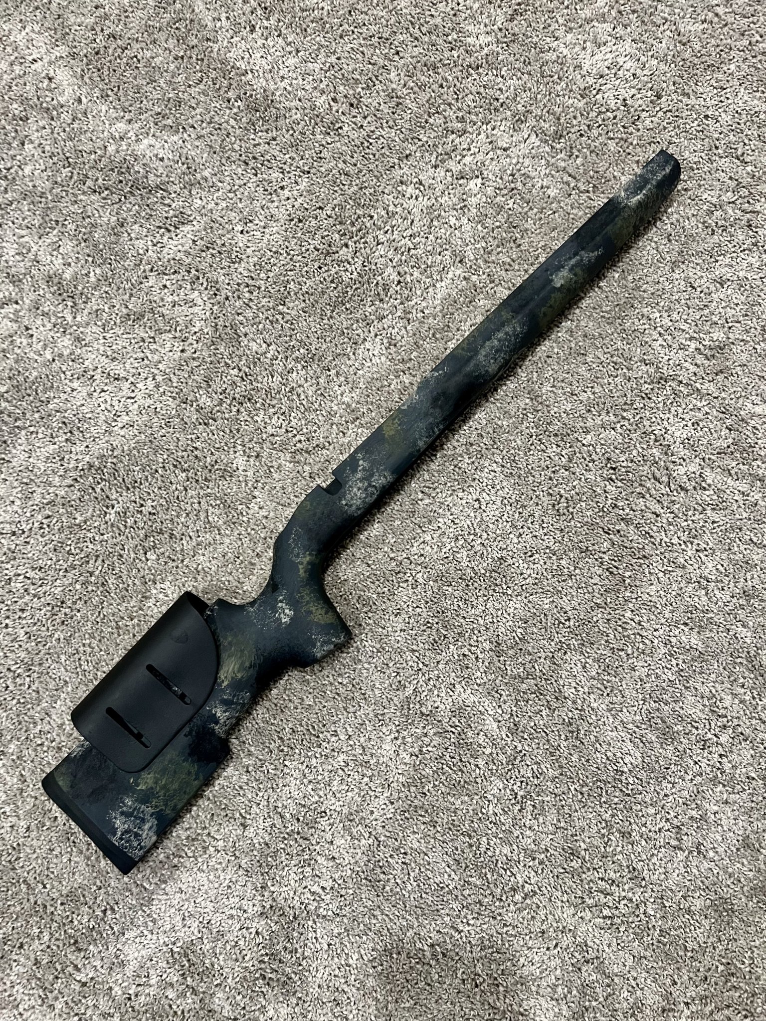

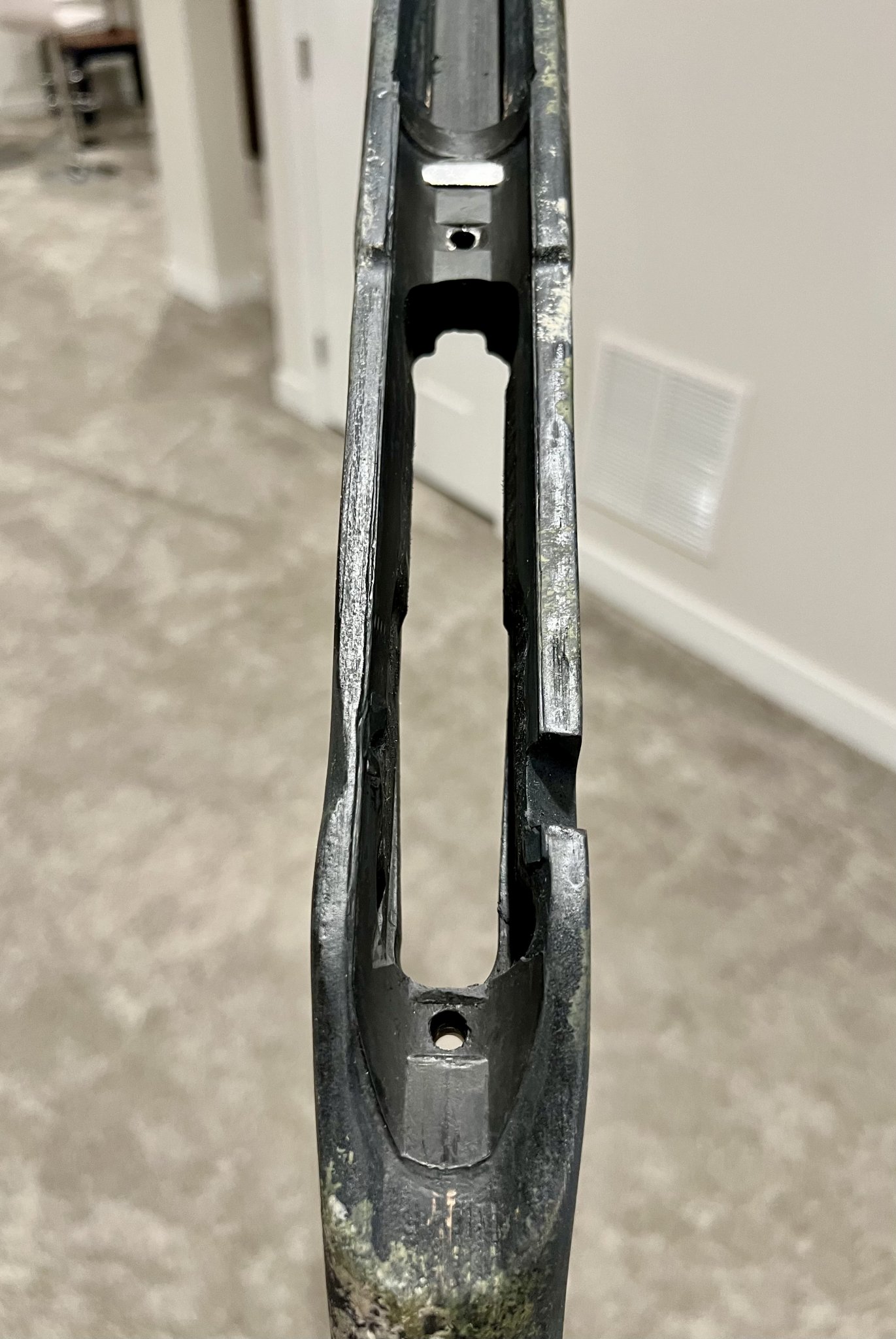

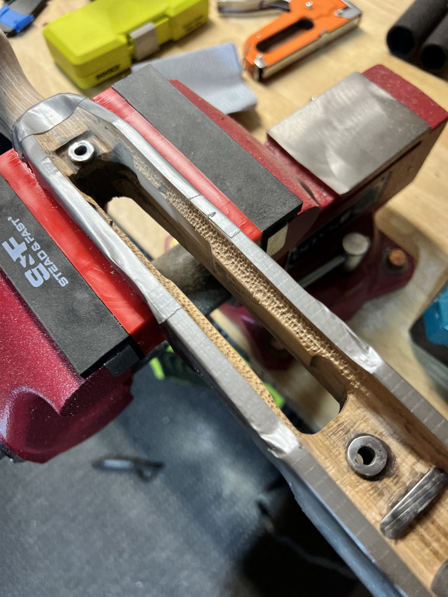

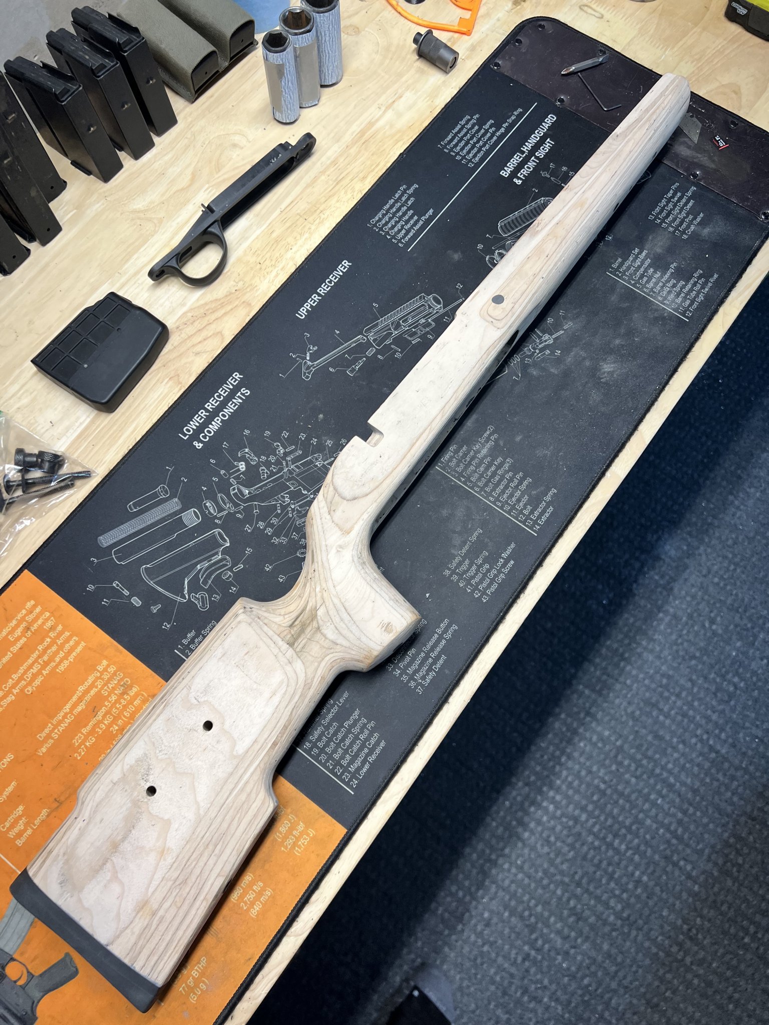

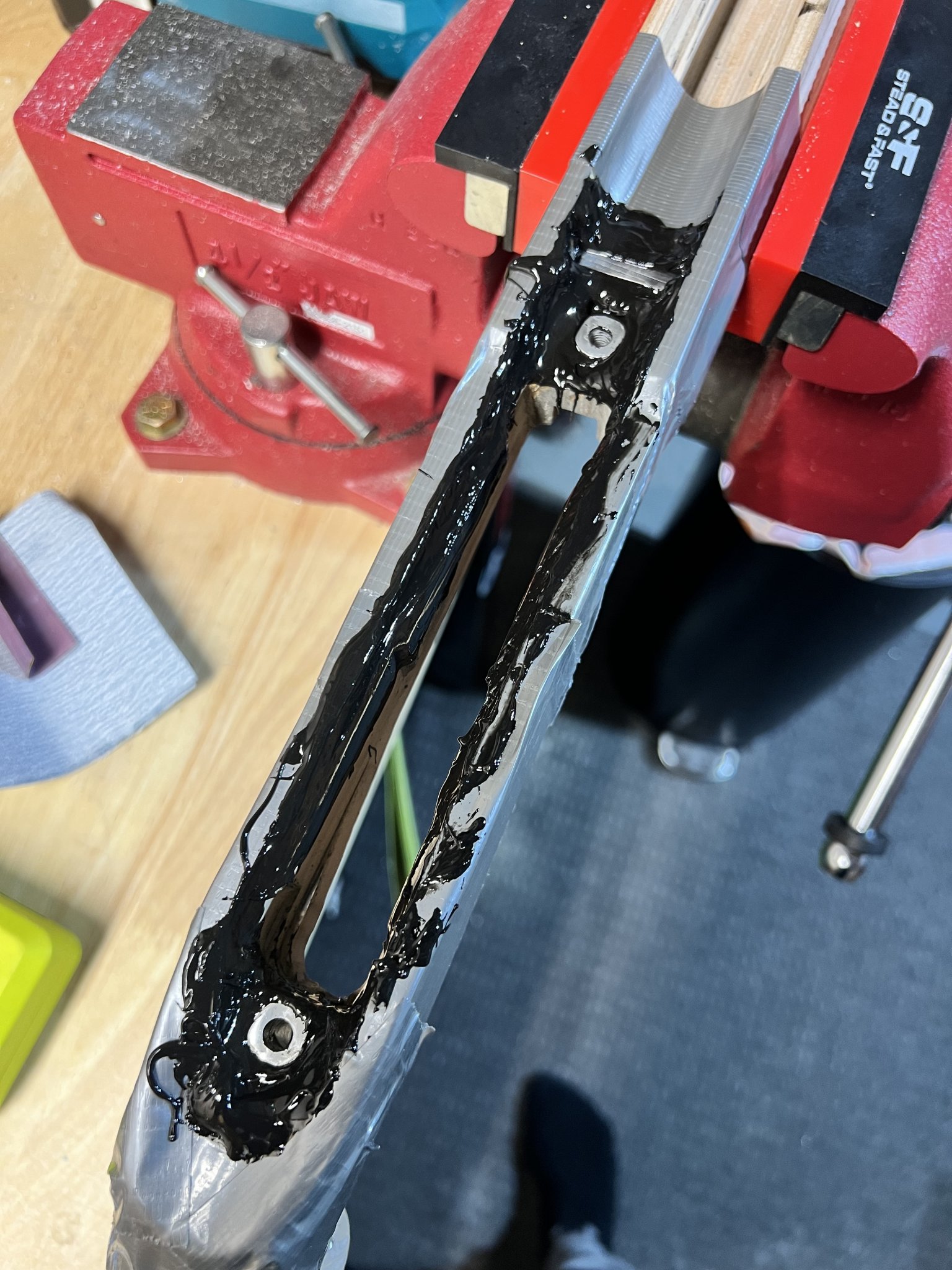

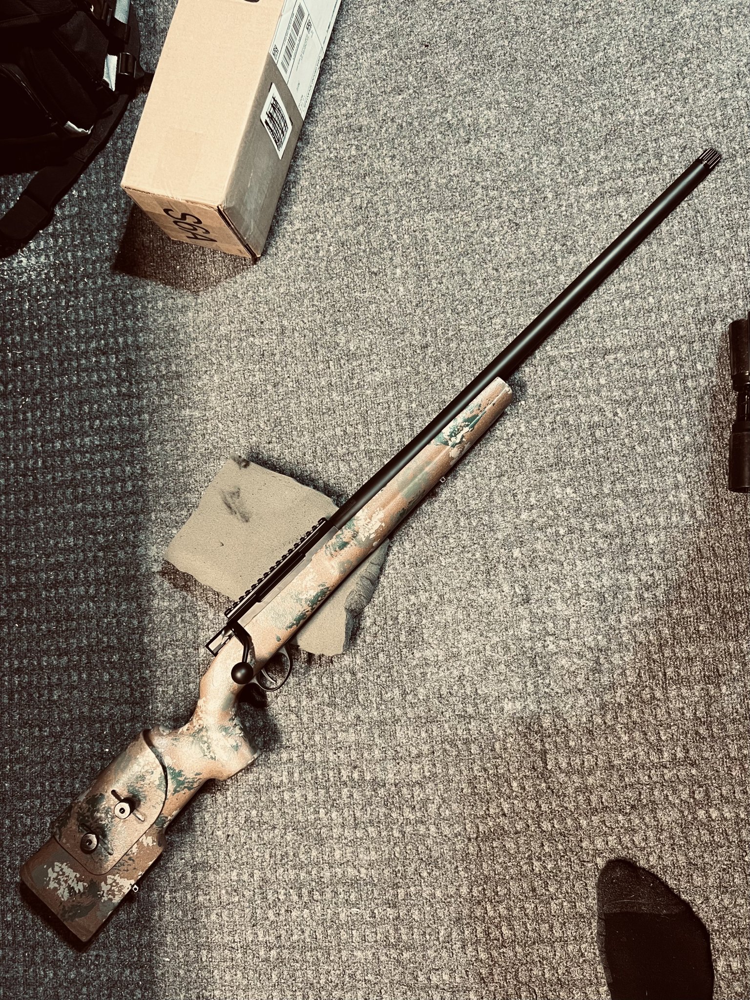

Brought the pro varmint back to life. I’ll never fault anyone calling me a dumbass for putting this much work into a Boyd’s stock.
Not the prettiest gal when I got her…
Sandblasted to see what I was working with:
Cleaned it out, opened up barrel channel, re-installed pillars and prepped for new bedding:
MarineTex fun:
Fresh paint and all cleaned up:
Waiting on an SRS Arca rail and then she’ll be done. Super cheap and turned out way better than I imagined. But only a temporary home until I can get my hands on an ATX chassis.

Picking up my first Tikka (looking at the T3X CTR in 308), getting in to some precision and long range shooting. I have a hunting back ground that I have taken mule deer and elk out to 450ish yards (mostly using 300wsm, & 30-06) out of Model 70's and M77 in featherweight models. Really liking the Tikka, any thoughts and inputs on starting out, are much appreciated.
