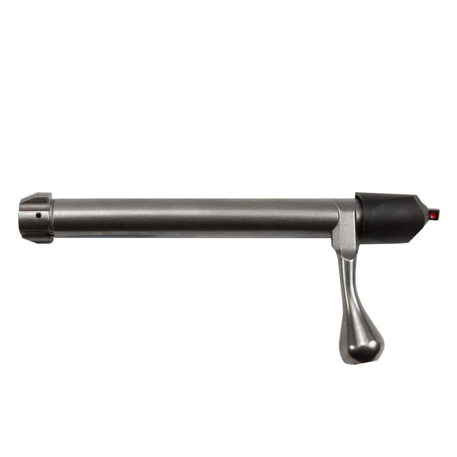

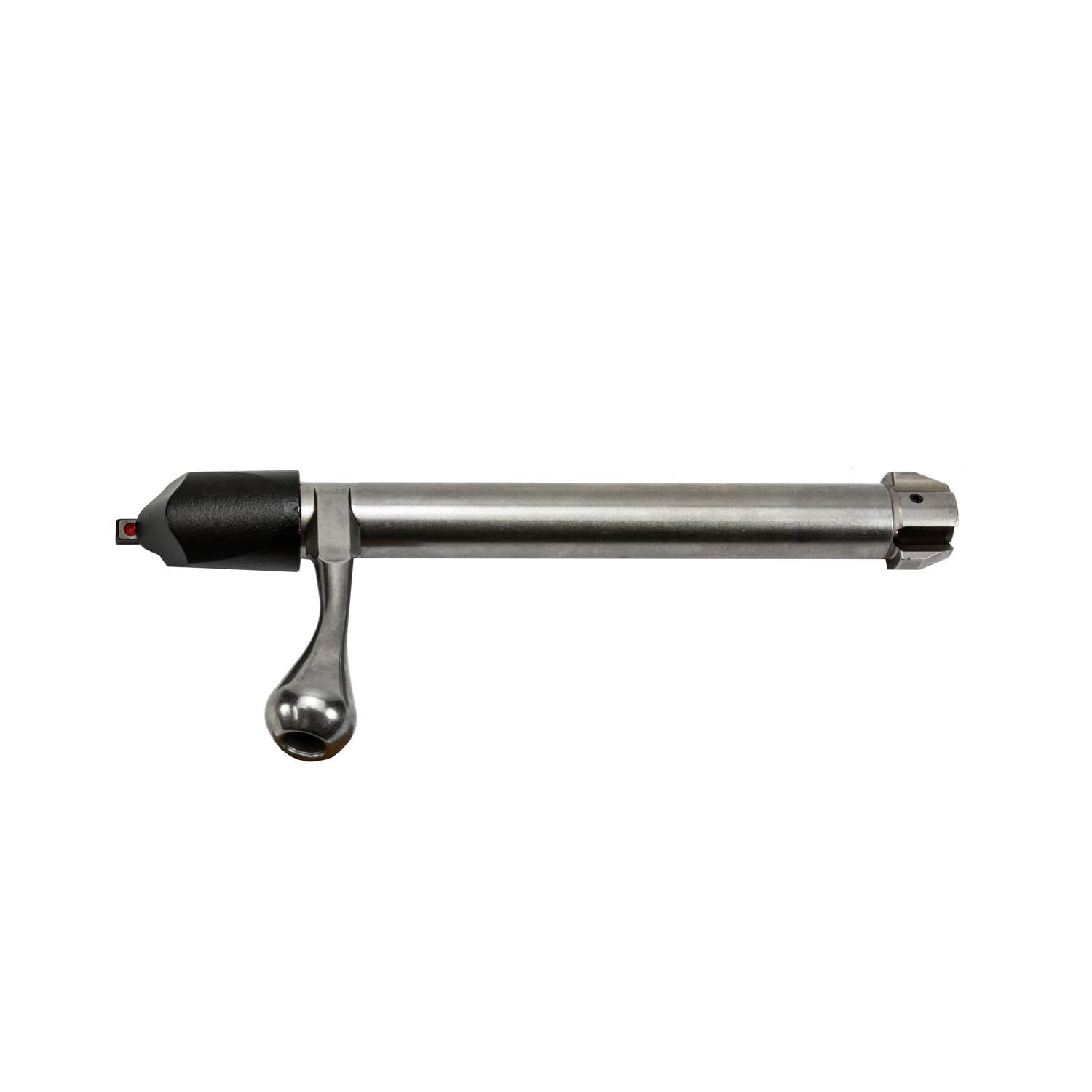

Where / Who would I contact for the availability for a replacement bolt for a T3X. I want a LH bolt with a .223 head to replace the bolt with a .308 head.
Thank you
Too bad you’re not a righty:
During a cursory search I didn’t see a left-handed model in stock. In fact, their 9.6 (.223) model for lefties seems like it has the wrong description?

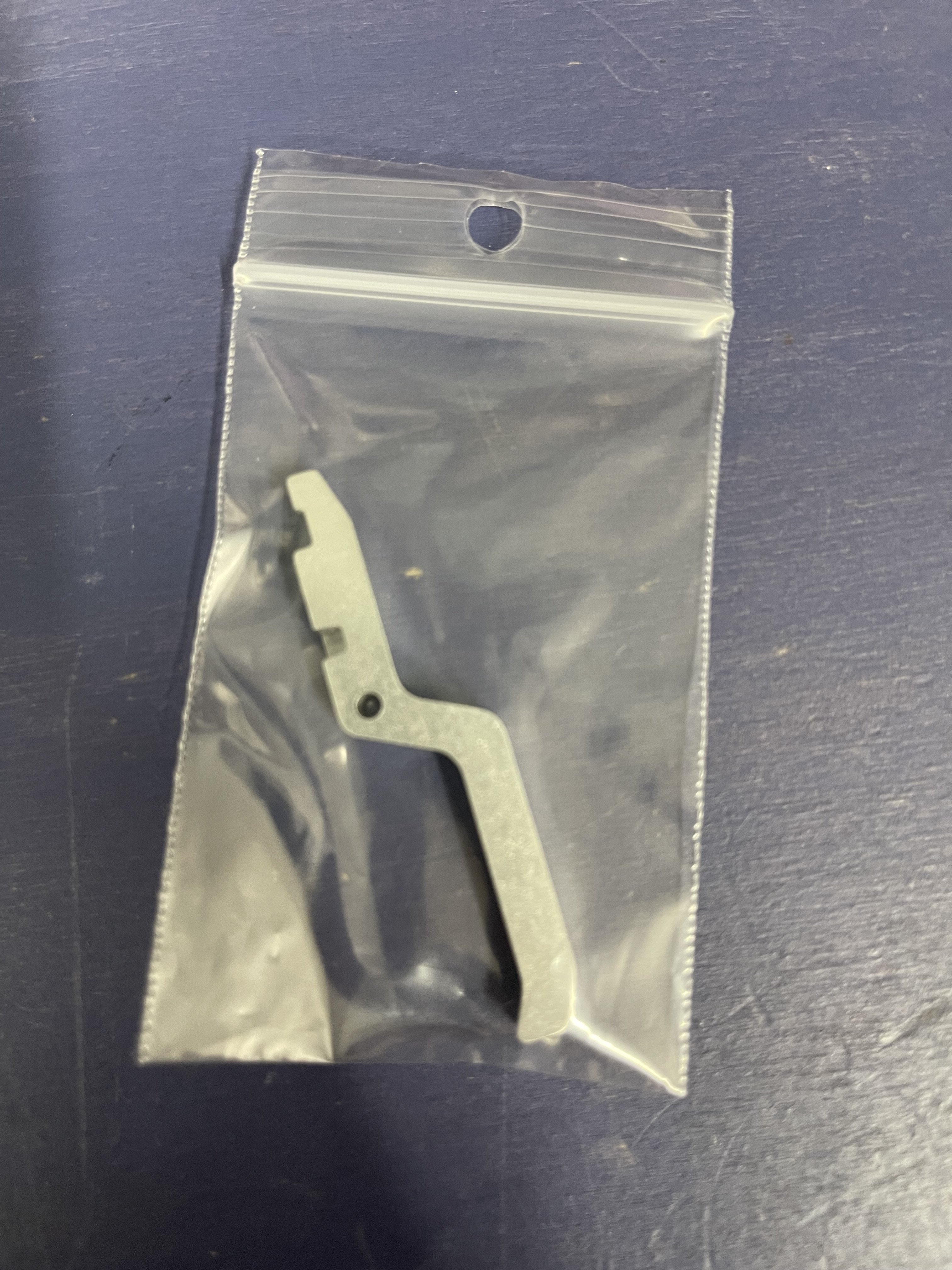

Just posting for those that may be looking for one. Rusty nuts designs has these flat triggers for the tikka. Got one for all my rifles.

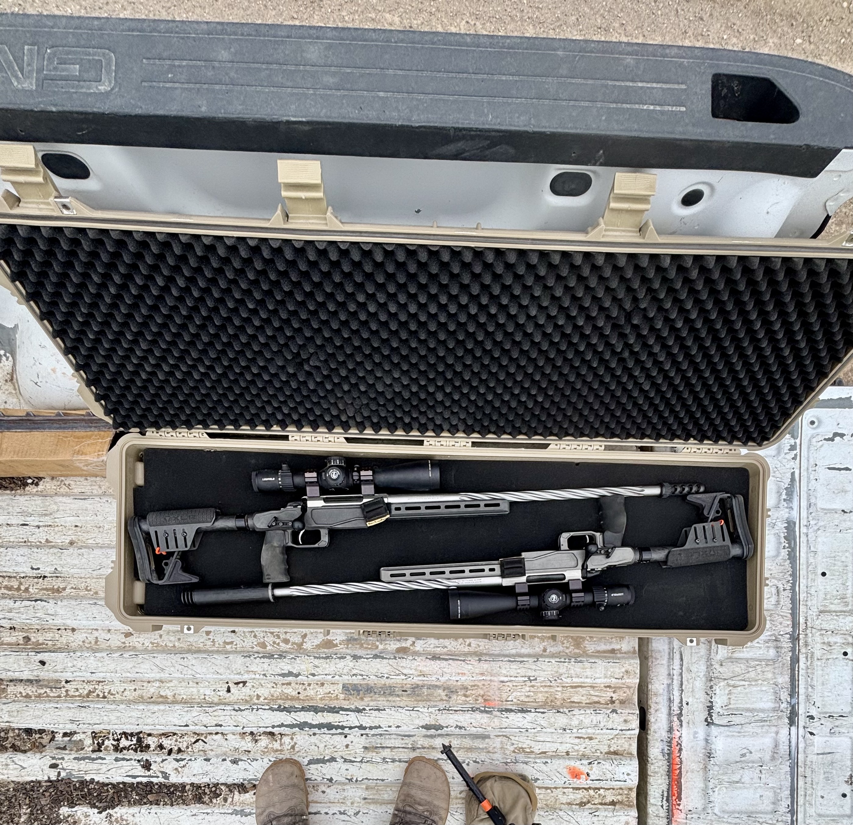

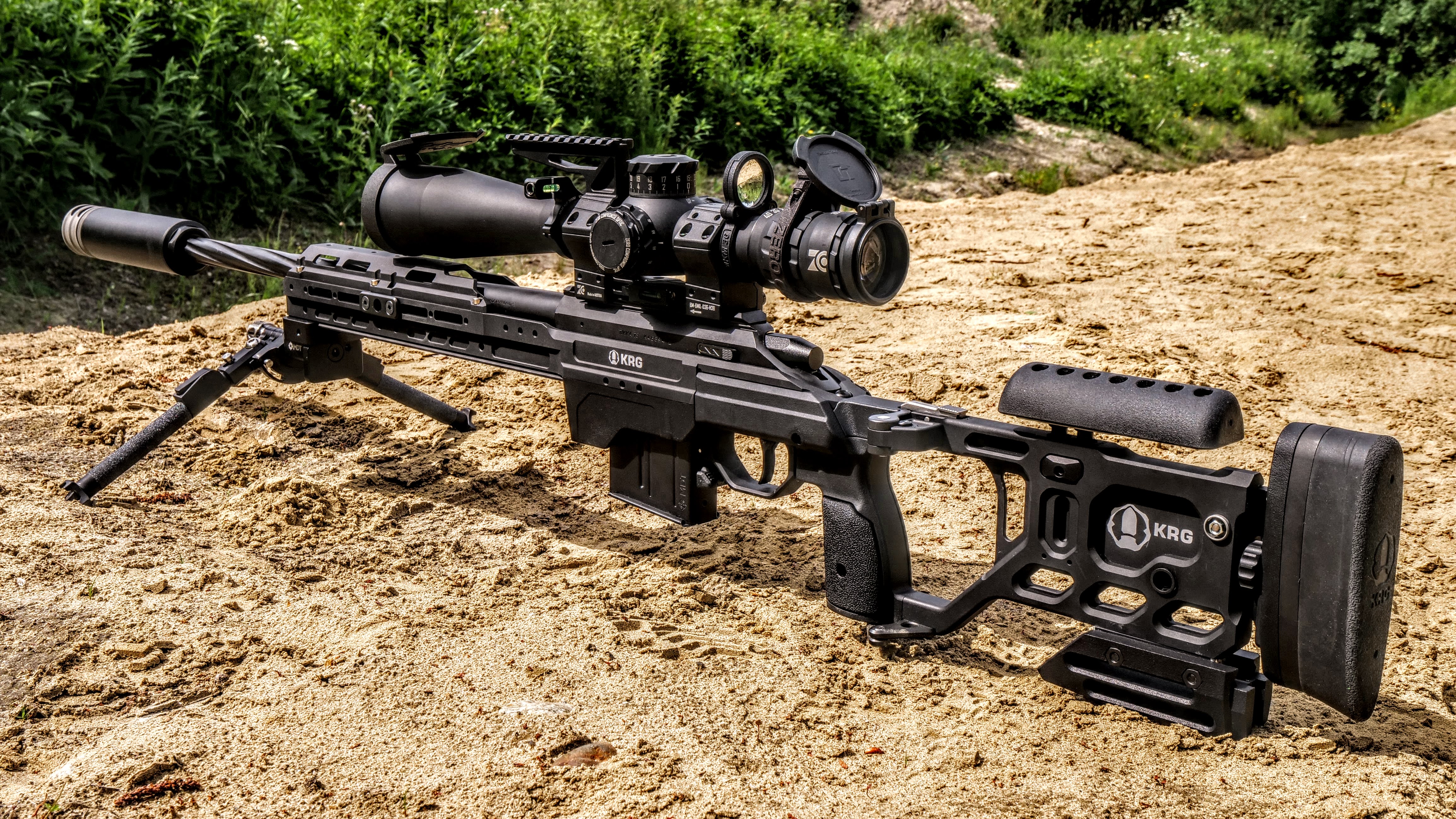

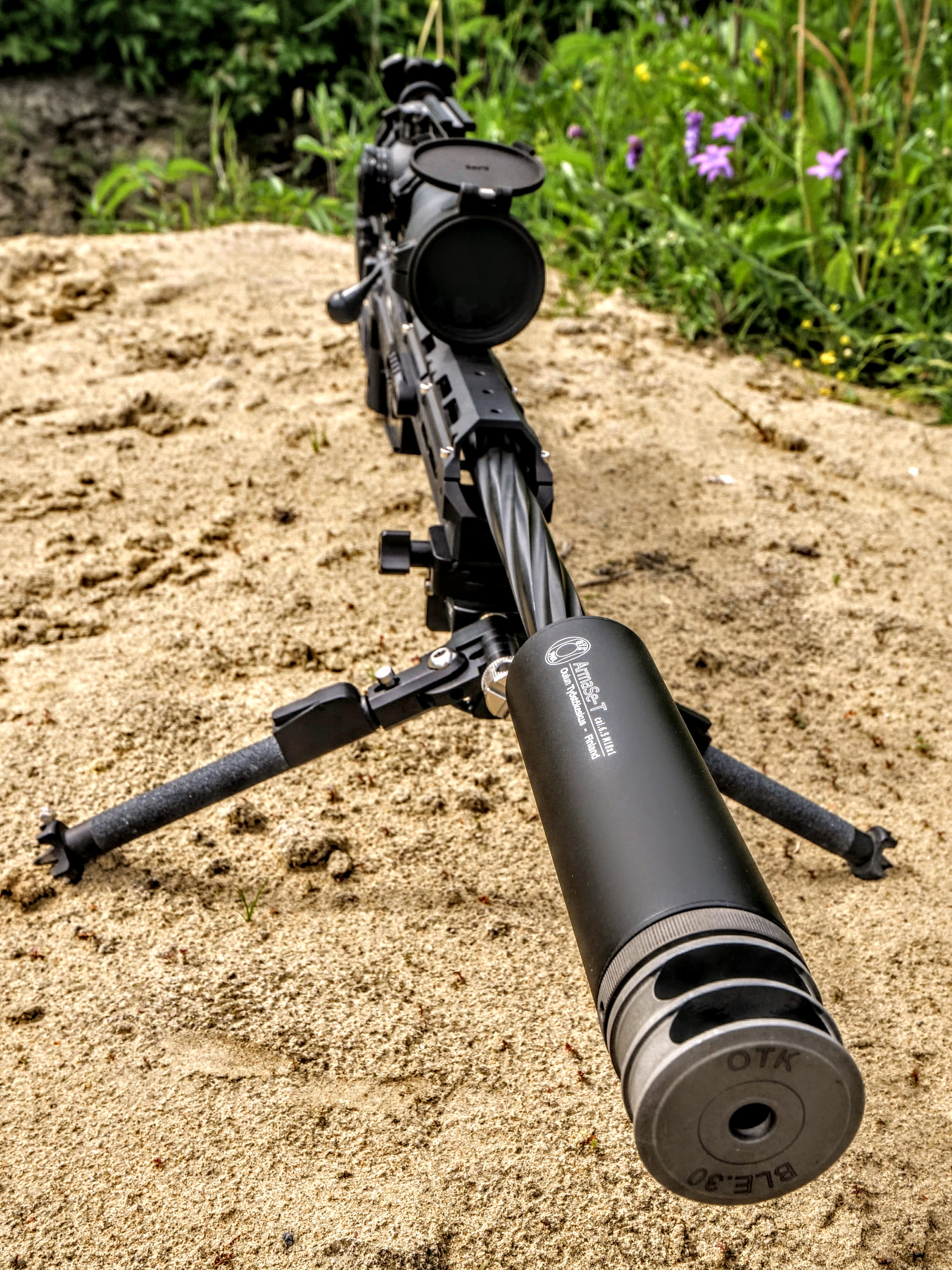

This is not a Ase Utra suppressor.
It is another Finnish company, Oulun Työstökeskus ArmaSe-T.
It is a proto version with a muzzle brake, not a production model.
So not only not available to us (both us and USA), but super not available to us.
Shouldn't the brake be rotated (unless there are no ports on the bottom)?
