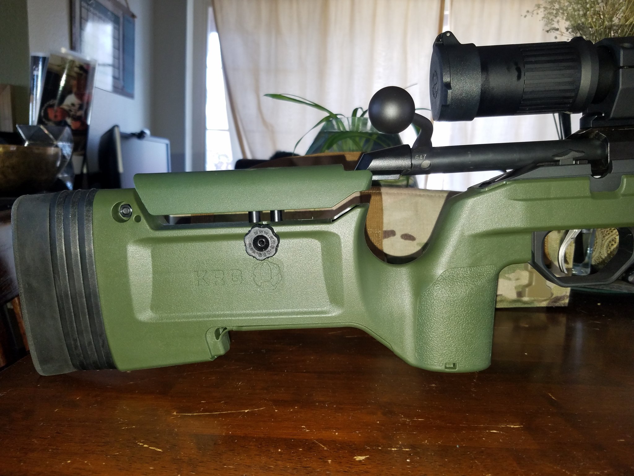

for a few of the questions i got about the bolt hitting cheek rest:
this photo shows the highest i could set the cheek rest without the bolt hitting
This shows the cheek piece moved up a bit more and the bolt hitting it now
my solution, i could probably run even lower rings but i am going to get a weibad cheekpad to raise the comb without moving the cheek piece up. note this is a .308 sa

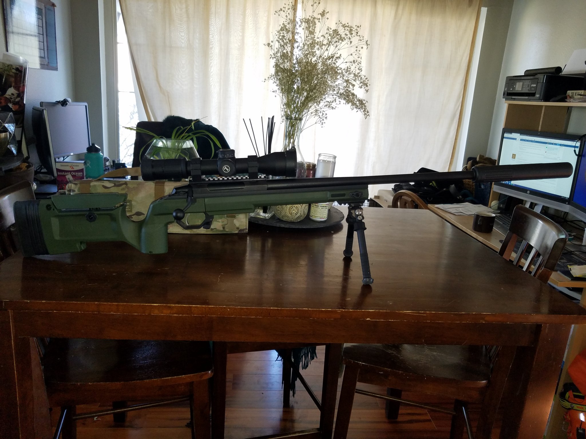

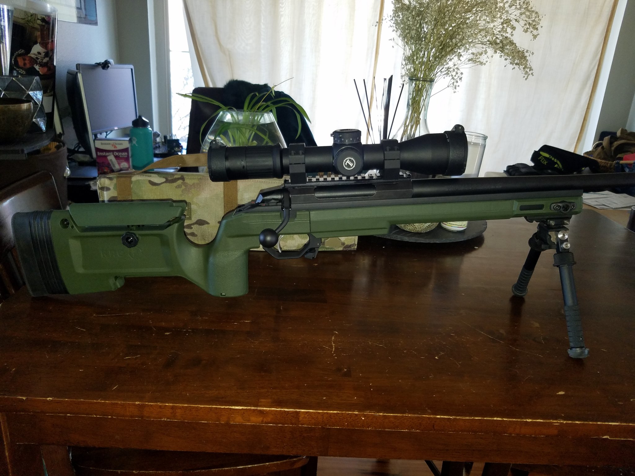

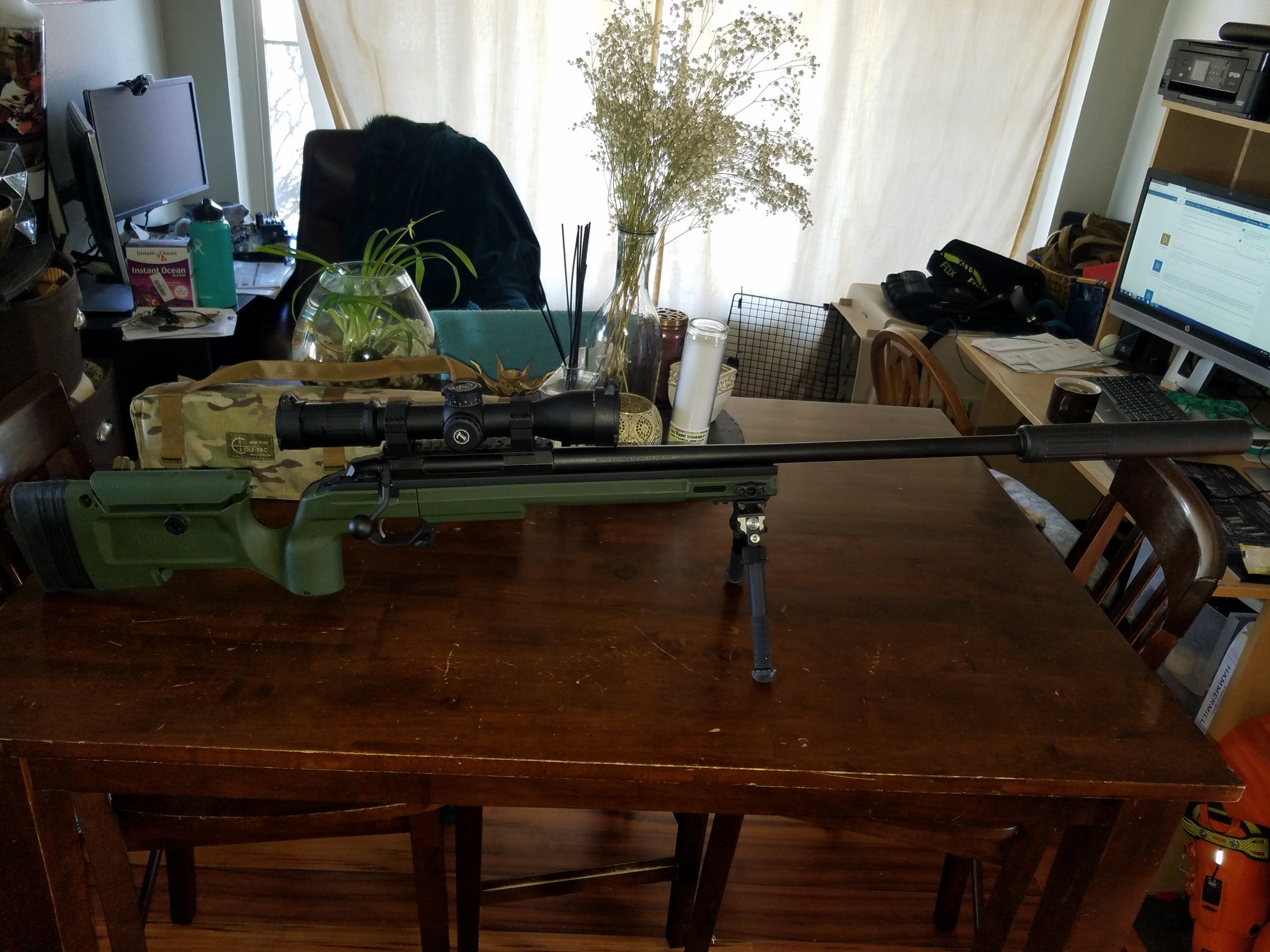

and here is another post to finally put my rifle in this thread.
specs are:
.308 T3x CTR
KRG Bravo sako green
Leupold Mark 6 3-18 h59
20 moa mountain tactical scope base
seekin precision rings
AAC 762 SD, will some day be an AE30
weight: 12.5lbs with suppressor, ~ 11lbs w/o

One unseen positive to this is that you can dremel out the cheek riser to provide the exact amount of clearance required specific to your bolt stop spec. Possibly the only negative regarding T3 actions is a non bullet proof bolt stop. I've never had this issue with hard use and I put that down to my bolt just kissing my cheek riser on an AI style Wombat Ordnance chassis. I'm actually happy to hear about this. I have a Bravo on order in Australia and I'm looking forward to trying it out.

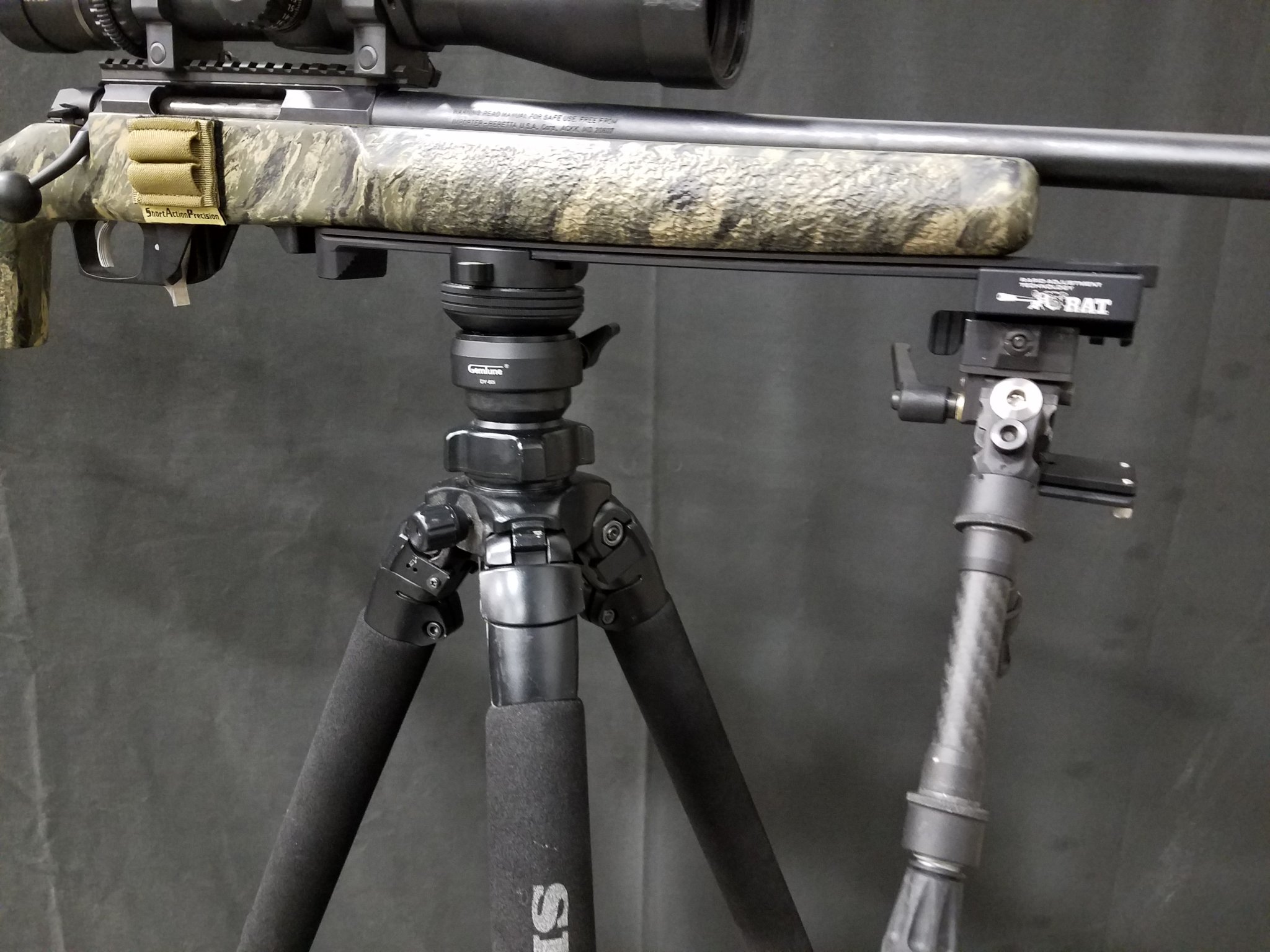

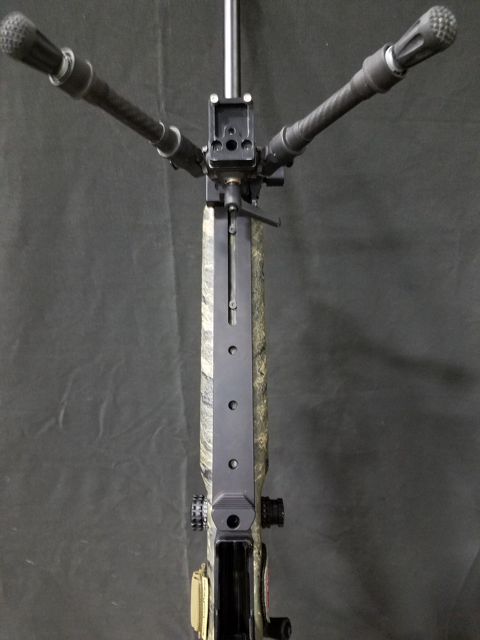

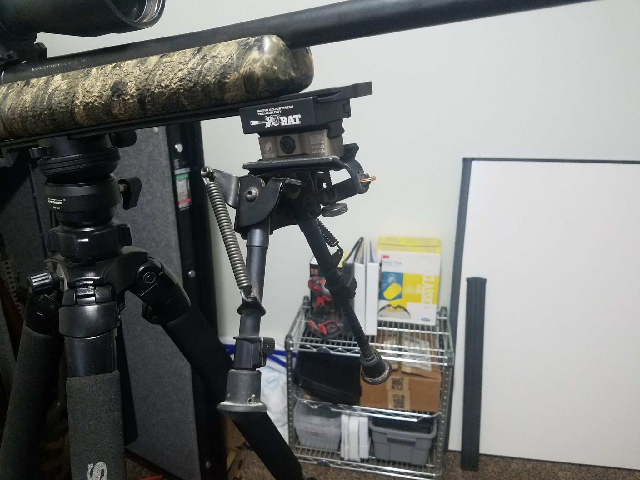

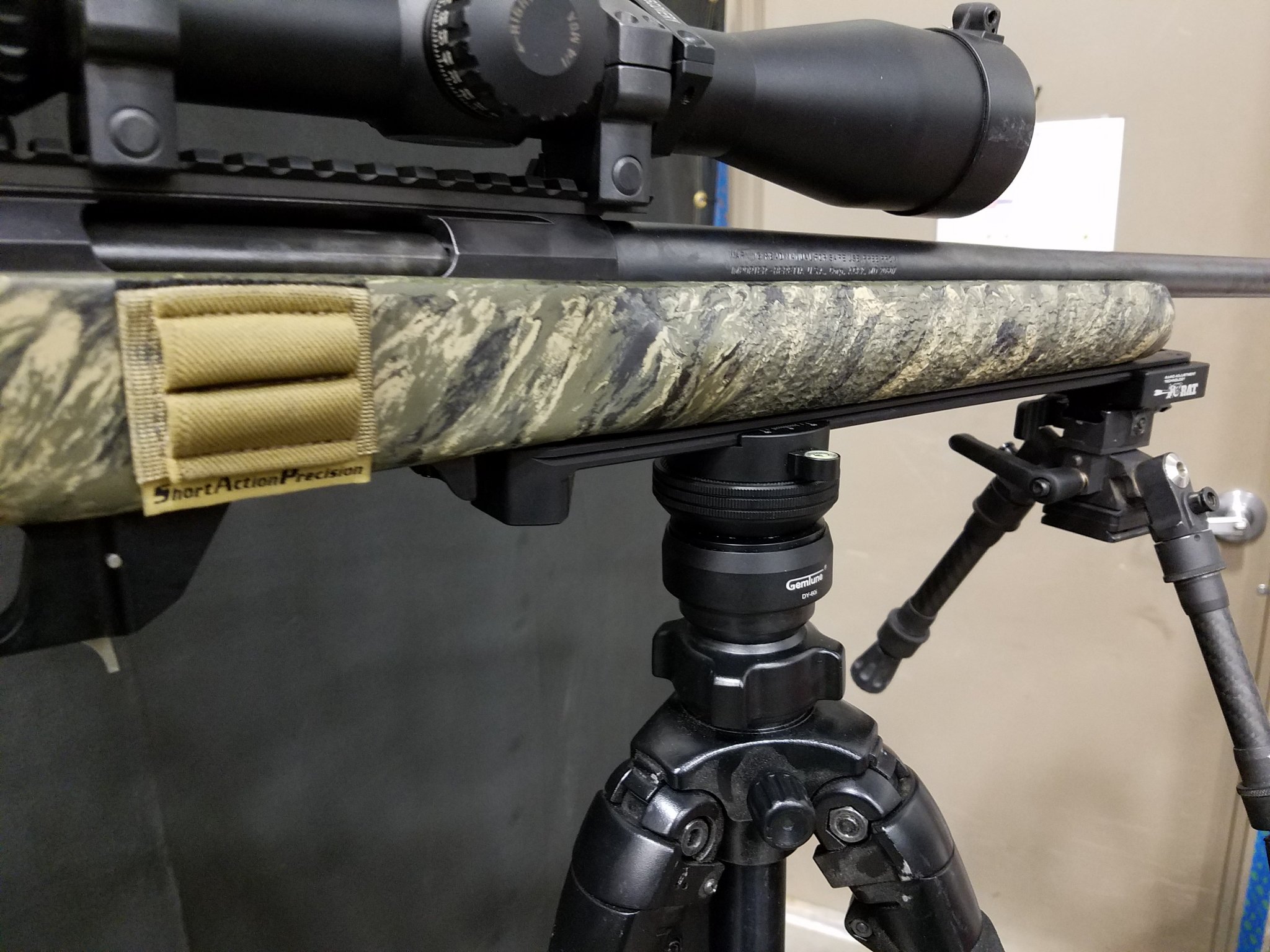

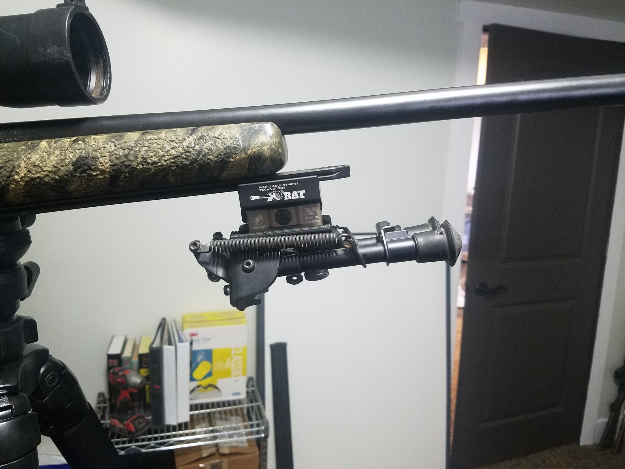

Just got my Area 419 Arca rail installed and had a range day with it. Overall I'm really pleased with it, and the MPA RAT pic rail makes swapping bipods a breeze. I highly recommend it.
