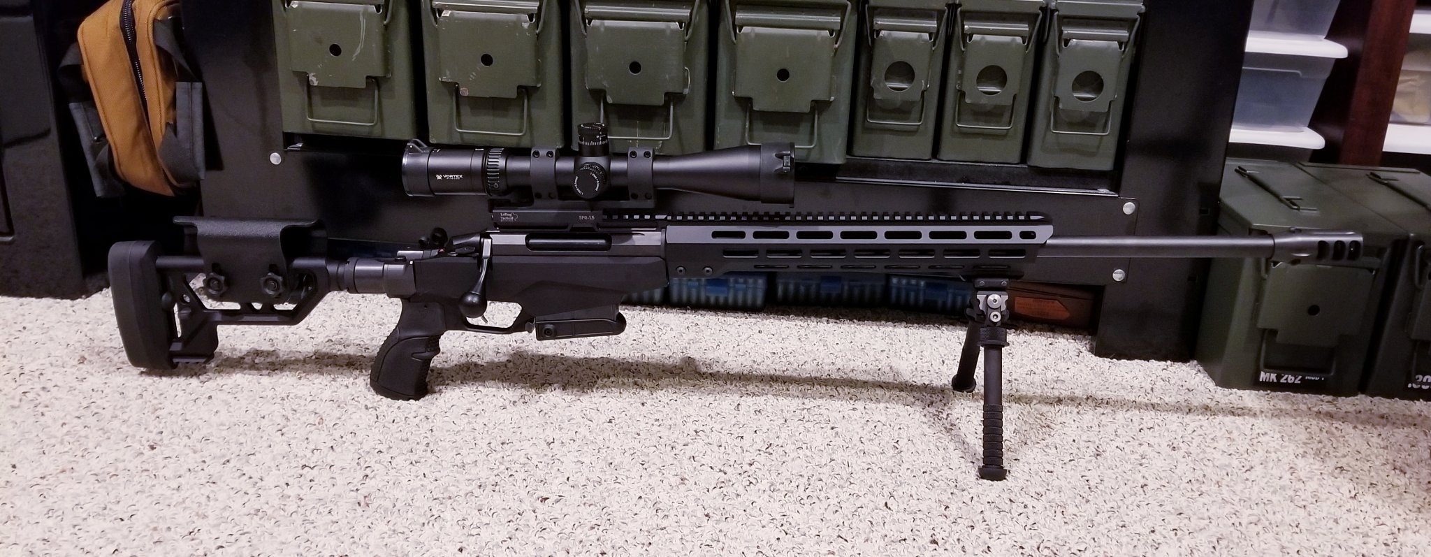

24”CTR in a KRG Bravo. So far I’m loving the chassis, I own a couple Whiskey 3’s and several X-rays but I am preferring the Bravo at this point.

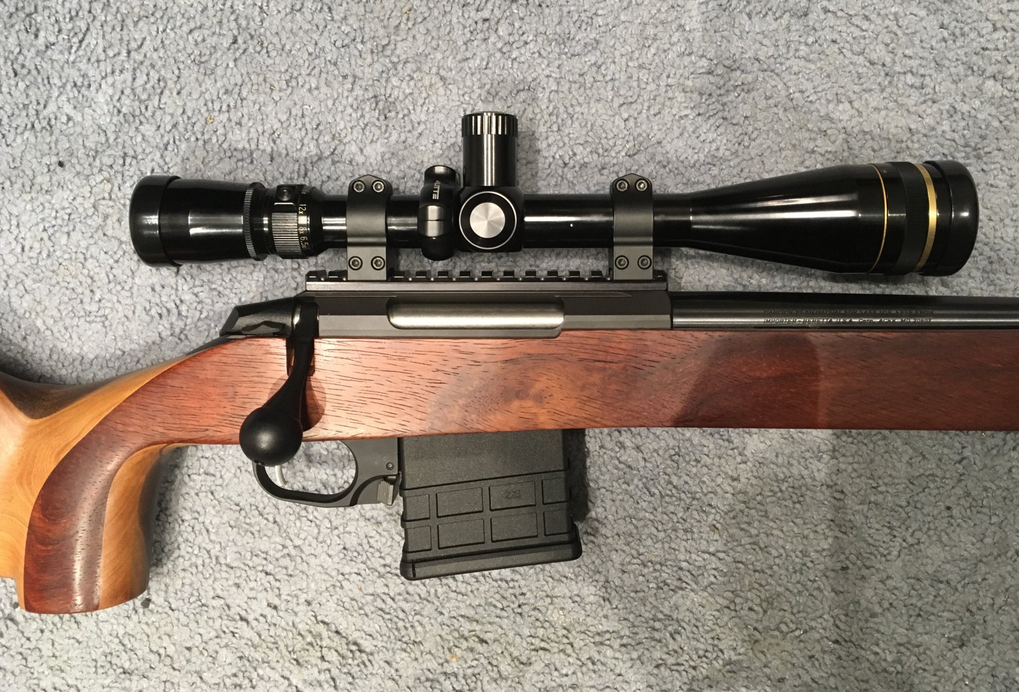

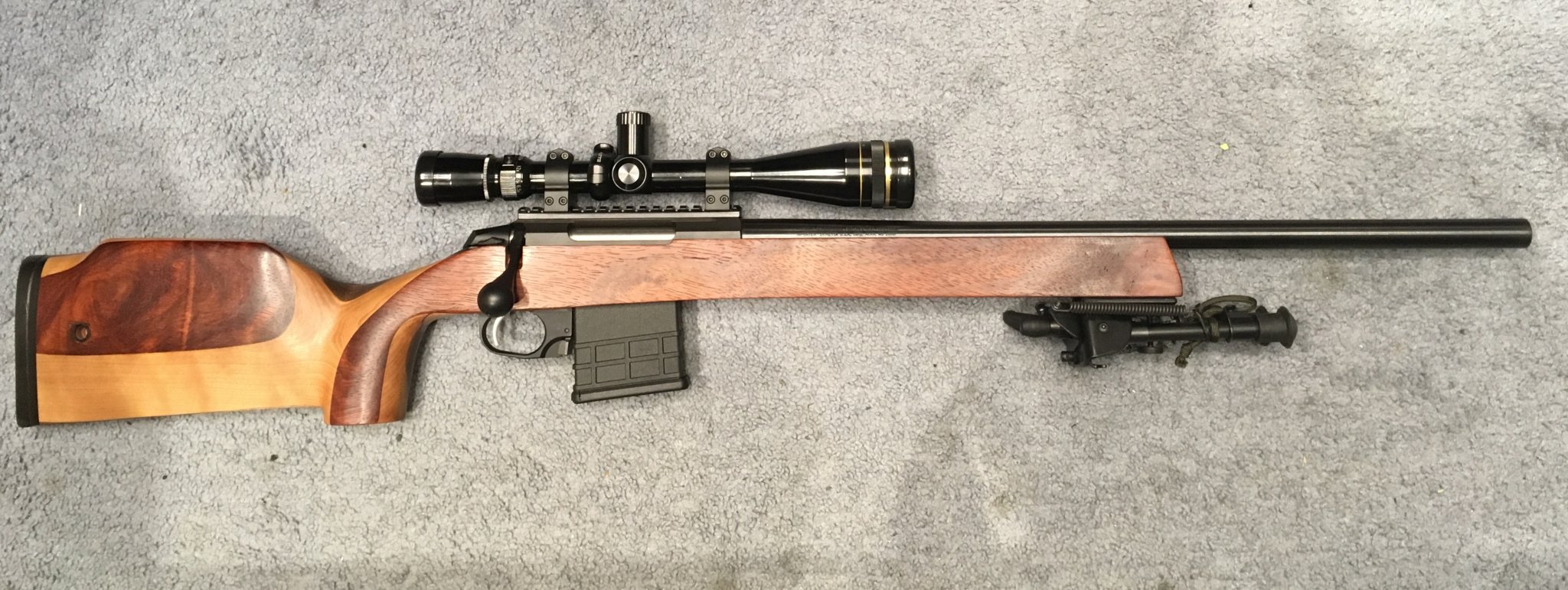

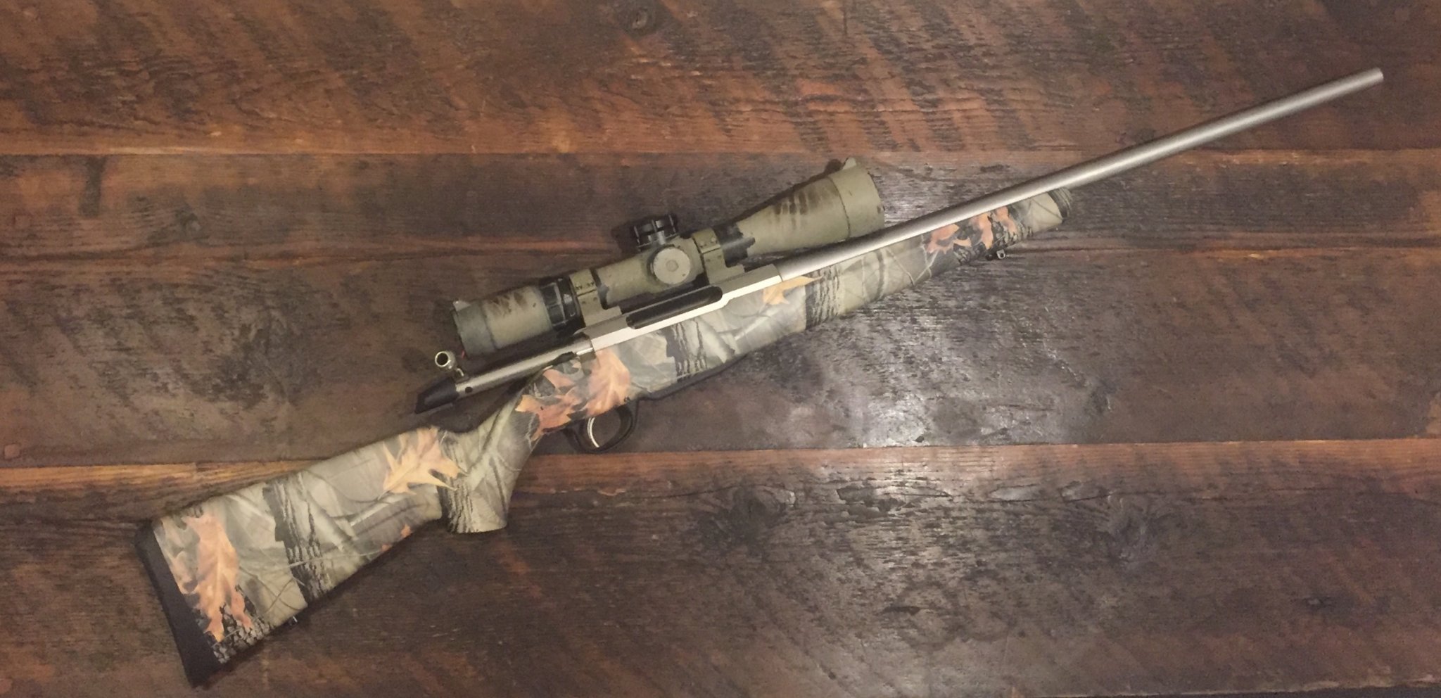

Latest Tikka project. .223 Varmint with the 24” 1:8 twist barrel. Built a custom laminated stock: walnut, cherry and Jamara. Inletted for CTR bottom metal, bedded with Marine Tex. Converted to use MDT 223 magazines, allows 2.5” OAL, SMKs currently used. Added a Mountain Tactical rail and a CTR bolt handle. Currently likes 24.5gr Varget withLC brass and CCI450 primers.

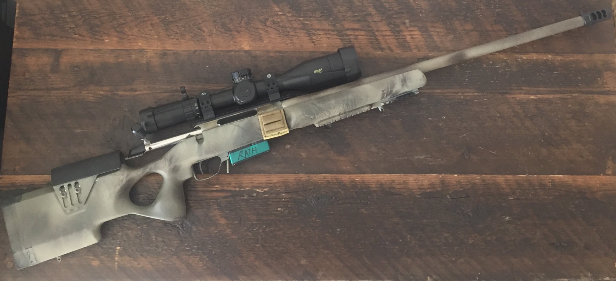

I'm new to the forum. Just purchased a T3x! Got rid of the stock, and I am now in the process of building it out on a chassis. The longest range I have access to is 500yrds, so I'm looking for a 0 MOA rail off of a CTR preferably black. Willing to pay $40.

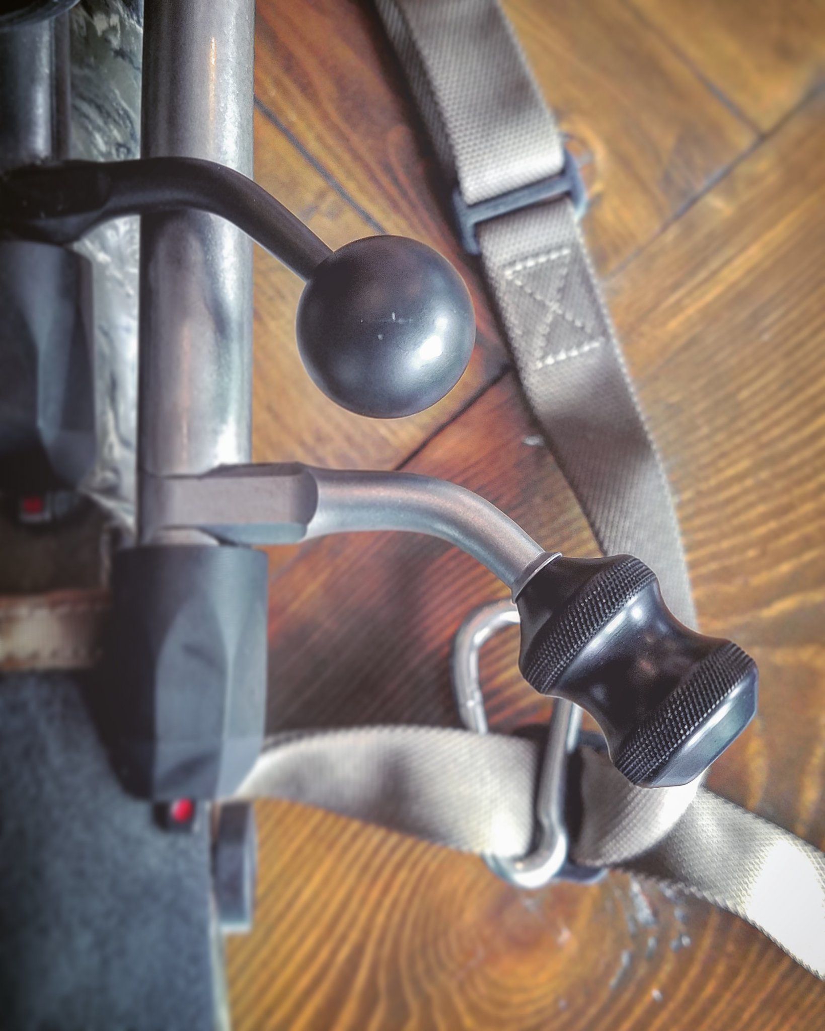

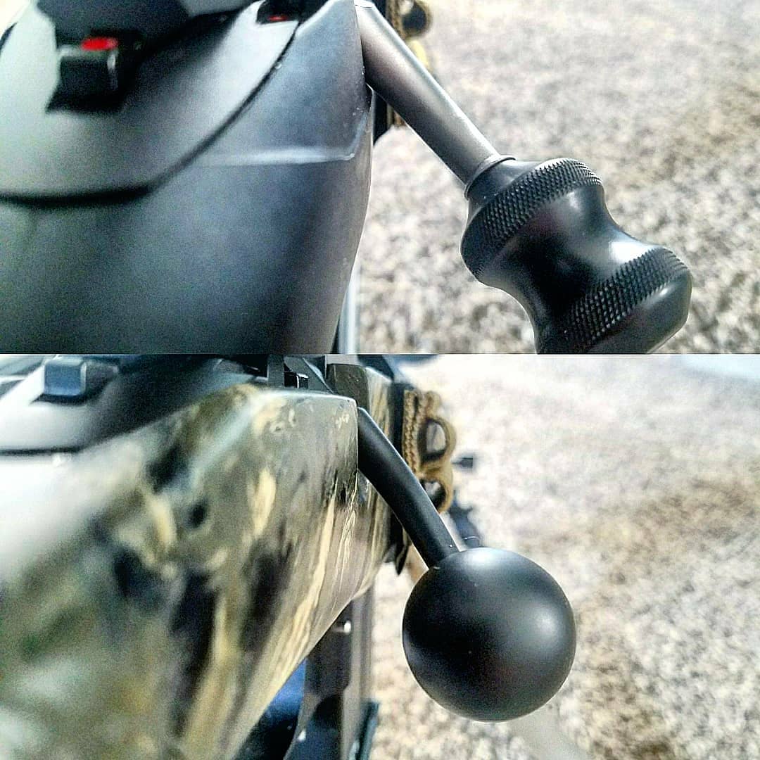

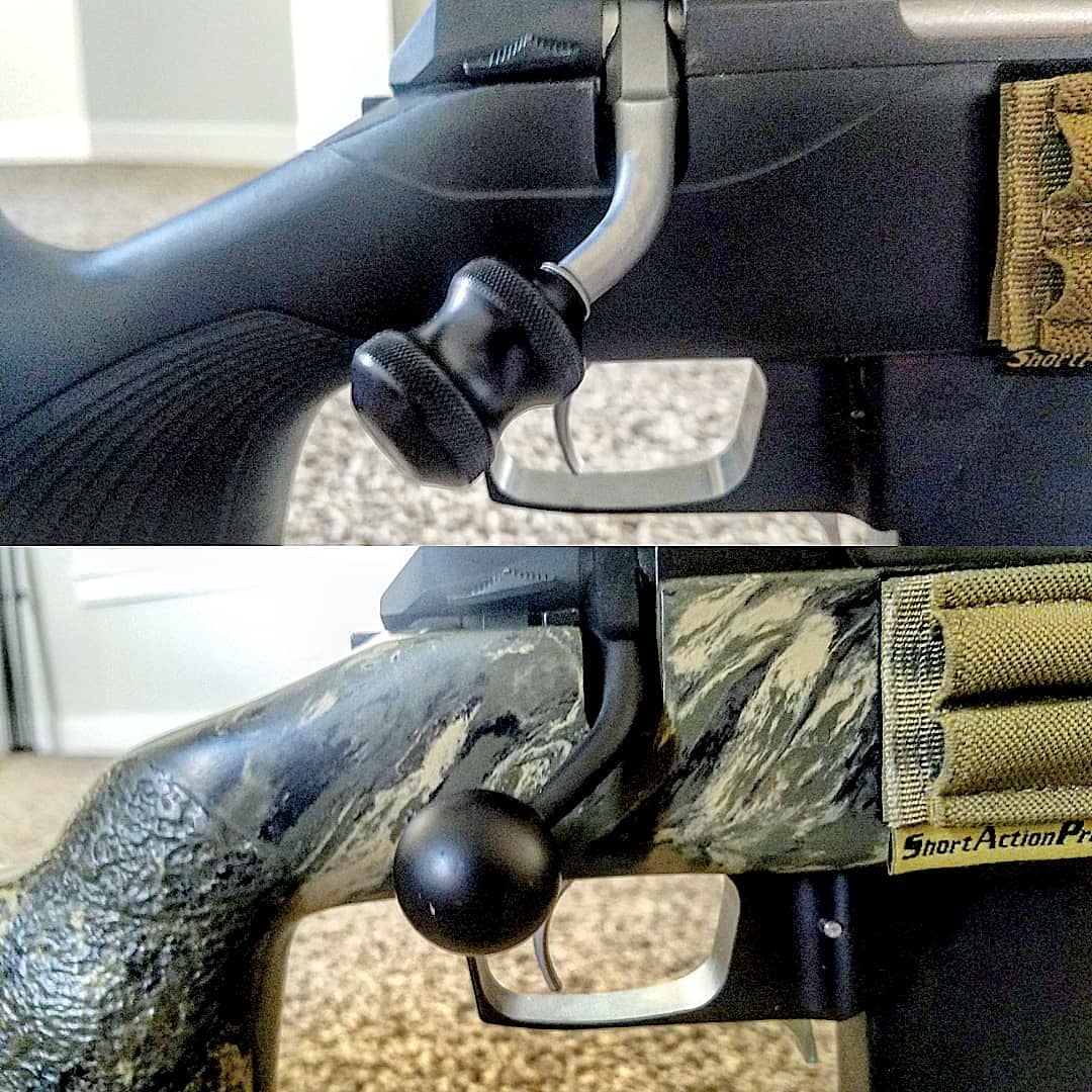

So, this review has been a long time coming, too long in my opinion but oh well. A few months ago, I received all the swept bolt handles Sterk, Anarchy and Glades. You guys may have seen the pictures as they came trickling through the thread. After a few months of playing with them I feel I can give a good review on them.
I will be upfront and say the glades didn't make it past the first month (hence the short write up). I didn't feel their "swept" handle was much more than the factory and the rounded knob also didn’t offer much more than the factory tactical knob. Therefore, I removed it and its sat since. I feel that it didn’t suite what I was looking for in a swept handle/rounded knob combo. With a $60 price tag, I can see where it appeals to some people since you get both the handle and rounded knob.
Another thing to note with the Glades. On the threads that the knob mounts to is forever long so you are going to have to cut it down if you are wanting to use any other knob with their handle (I have also discovered this on my CZ455 handle I have from them).
Next up was the Anarchy outdoors bolt handle with the PTG rounded knob. The bolt handle has potential but the PTG rounded knob left a lot to be desired. It was too small and looked awkward given how thick the Anarchy handle is, after I installed the Glades rounded knob it made a huge difference. But I recently purchased the Area 419 finger grooved bolt knob (pictured attached to my Anarchy handle) and can’t say enough good things about it.
Appearance wise, the Anarchy looks unfinished with its bare stainless steel (although they do offer a black cerakote handle now) and some tooling marks. However, they were generous with the tolerances on the dovetail going into the bolt body so it did make for an easy install when compared to the factory bolt handle. Being that it’s at $40 for bare Stainless and $46 for Black, it’s very well priced. They do also offer a discount if you buy the handle and knob combo, they do not however offer a rounded bolt knob at this time.
Last but not least is the Sterk. I will be honest and say I have the most time running this bolt handle/rounded knob combo as it is on my primary match rifle. I have nothing but good things to say about this guy. With the sweep it puts the rounded knob right where it needs to be. The fit and finish far surpasses that of the Glades and Anarchy handles. Also noting that if you get on the list soon enough he has a list of cerakote colors to choose from. The only difficulty I had with the Sterk is that due to the cerakote and tight tolerances, it did make for some trouble installing it into the bolt body. However, its not a negative in the slightest.
Sterk handles are worth what John is asking for them. Of the 3 options, they are the most expensive coming in at around $76US, but worth every penny. The reason for this is due too the amount of machining that goes into each handle, as each one is CNC machined and sanded/polished by hand . With only doing 2, maybe 3 batches a year you have to keep an eye on his facebook page to secure your spot.
I have been asked by several people just how the Sterk and Anarchy handles differ from each other. I took measurements of each handle going off the top of the safety and from the side of the stock as I feel these are both some what equal spots on both rifles. The Sterk, from the safety is 1.5” from where the handle meets the knob, and came off the stock at .5”. The Anarchy, from the safety is 1 3/8”, and came off the stock at .75”. Doesn’t seem like a lot of difference but when you play with them both, it is a vast difference.
Both handles are a good option, you can’t go wrong with either. But if I could only have one, I would have to stick with my Sterks.

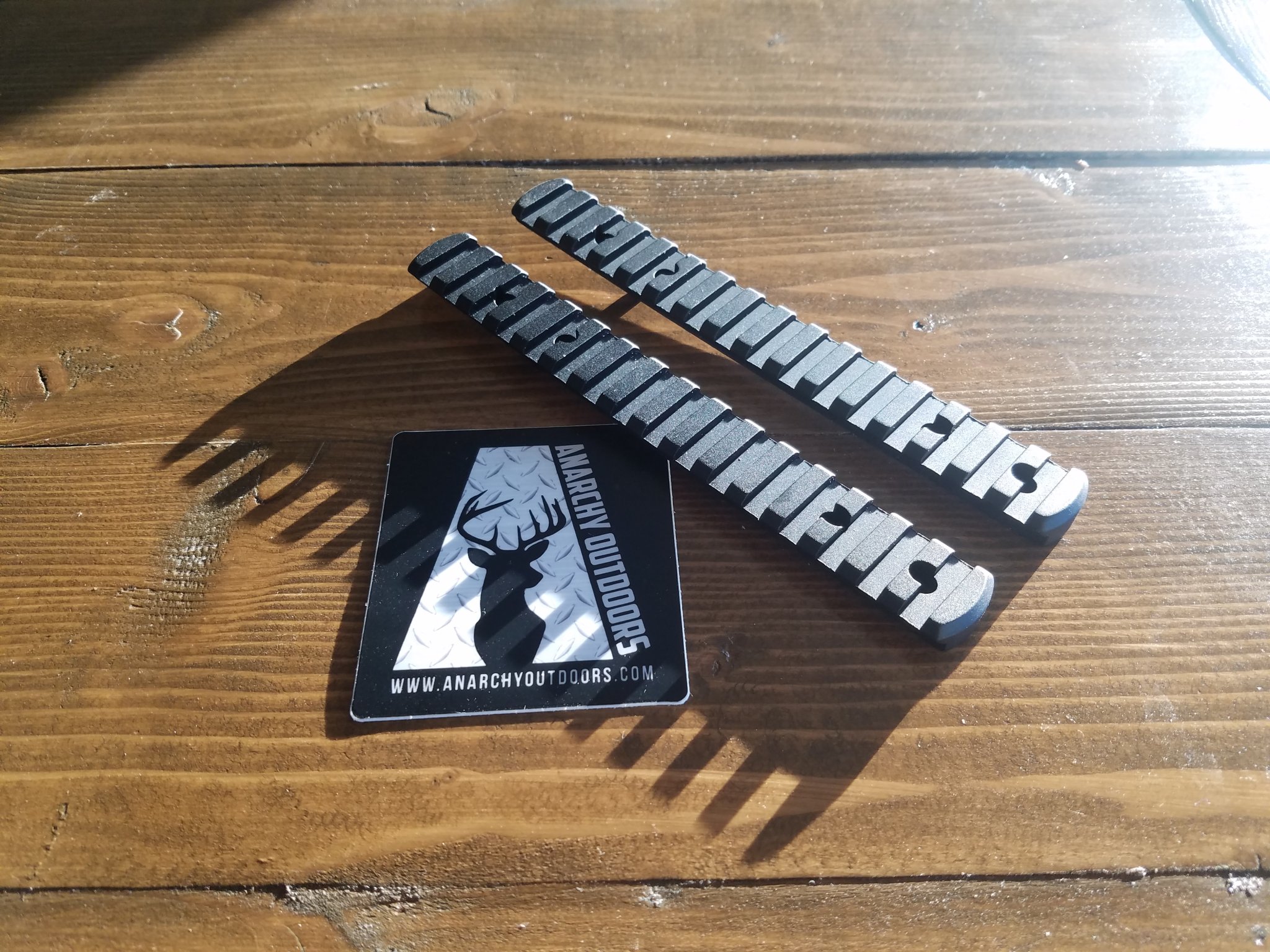

A while back, Anarchy outdoors sent me 2 of their scope rails for me to review. Its taken me awhile to get this review out but here it is.
Anarchy Outdoors has just recently began playing in the Tikka aftermarket world. Starting with the introduction of a swept handle, and now offering 2 scope rails. They offer both a 30 MOA/8.74 MIL or a 40 MOA/11.66. Made of 7075-T6 Aluminum, they are extremely rigid and don’t offer any flex. They come with the integral recoil lug so no need to worry about your scope shifting during recoil. Made to 1913 Picatinny specifications, I didn’t have any issues mountings a variety of scope ring brands, too include Warne, Vortex, Seekins, Leupold, and Steiner.
Finished in a Type lll Hardcoat anodizing, after repeated mounting and dismounting the were little too no visible chips in the finish. Looking over both rails, all the finish is evenly applied. No sharp edges were present, also no machining marks could be found.
Talking with Aaron with Anarchy, and a few fellow members from the Tikka forum on snipershide, a few concerns were brought up. First, a few members expressed how they could not get their scope to mount to rail securely. Aaron expressed that there were a few from the first batches that were produced under spec, and has been corrected with all future batches. Second, unable to zero the scope once it has been mounted to the rail. I didn’t have this problem with either of the rails sent to me for testing.
For this review, I used my Vortex Razor Gen1 mounted in Vortex/Seekins matched rings. The scope rail I used before testing was a Mountain Tactical Elite 20MOA extended rail. The Gen1 Razor has 125MOA of internal adjustment. With a 20MOA rail, I was able to use 78MOA of the 125 which with my current 140RDF load could get me out too 1690yds with only dialing. Once I mounted the 30MOA up and got it zeroed I could get an additional 9.5MOA of adjustment. Taking me from 78MOA, to 87.5MOA and out to 1780yds without dialing. With the 40MOA rail, I got an extra (and I was surprised by this), but I got the full extra 20MOA of adjustment. Taking me to 98MOA and 1870yds.
Overall, I’m very pleased with the both of these scope rails and highly recommend them. Fit and finish is great and the price, being at $50 for either the 30MOA & 40MOA they come in right at or below the prices of other rails. I will however, give a slight edge to the Mountain Tactical rail and they do offer the extended rail, 17 slots over the Anarchy’s 16 slots. However, it is a $90 difference for one extra picatinny slot, but you do get a steel base and not aluminum.
Don’t hesitate to pick one of these up, and also check out what other products Anarchy Outdoors has to offer for Tikka rifles!

The mountain tactical gen 2's are $10 more for an anodized aluminum rail (same material as the anarchy).
The mountain tactical gen 3's are the $90 more but you are getting a 17-4 stainless steel rail (stronger material, more of a pain to work with).
You are correct and I did go make that adjustment in my review.

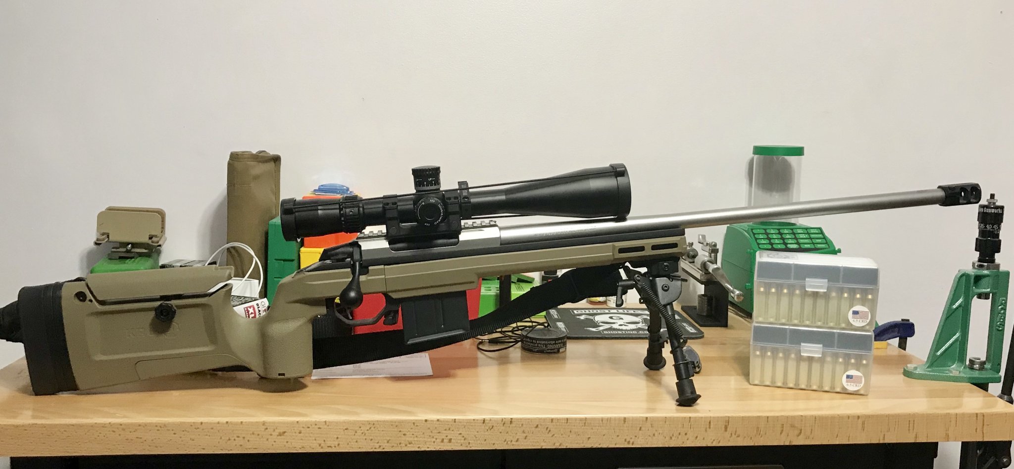

Finished my tikka 6.5 build. Bought the Tikka T3X CTR 20" stainless in 6.5cm and dropped it in the Cadex Competition Lite chassis.
-Factory T3X CTR 20"
-TBAC Ultra 9
-factory 0MOA Tikka rail
-Spuhr 20MOA 1.5" rings
-Vortex AMG
FYI I barely had enough clearance with the 1.5" height spuhr with the AMG if anyone is building something similar. Cheers
Very nice ? I am debating on SS vs Blued CTR and I have the same chassis and like the looks of your set up ??
Thanks man. I actually ordered a blued CTR and the SS showed up so I figured I would just cerakote it when it went in for re barrel but after getting it all together I kinda like it. I set this up for practice and a back up match rig but it has been hanging in there with rigs that I've got a ton more money into. You wont be dissapointed.
Currently running H1000 producing 3140fps/105gr Hybrid and no pressure whatsoever - not sure re barrel life but will be happy to stay sub moa to 2500rds. My previous barrel went south at 1900rds with H4350/115 dtacs.
Thanks for the info. I've been debating switching to a 6mm caliber and I like how available brass is and everything is for the 243Win.
