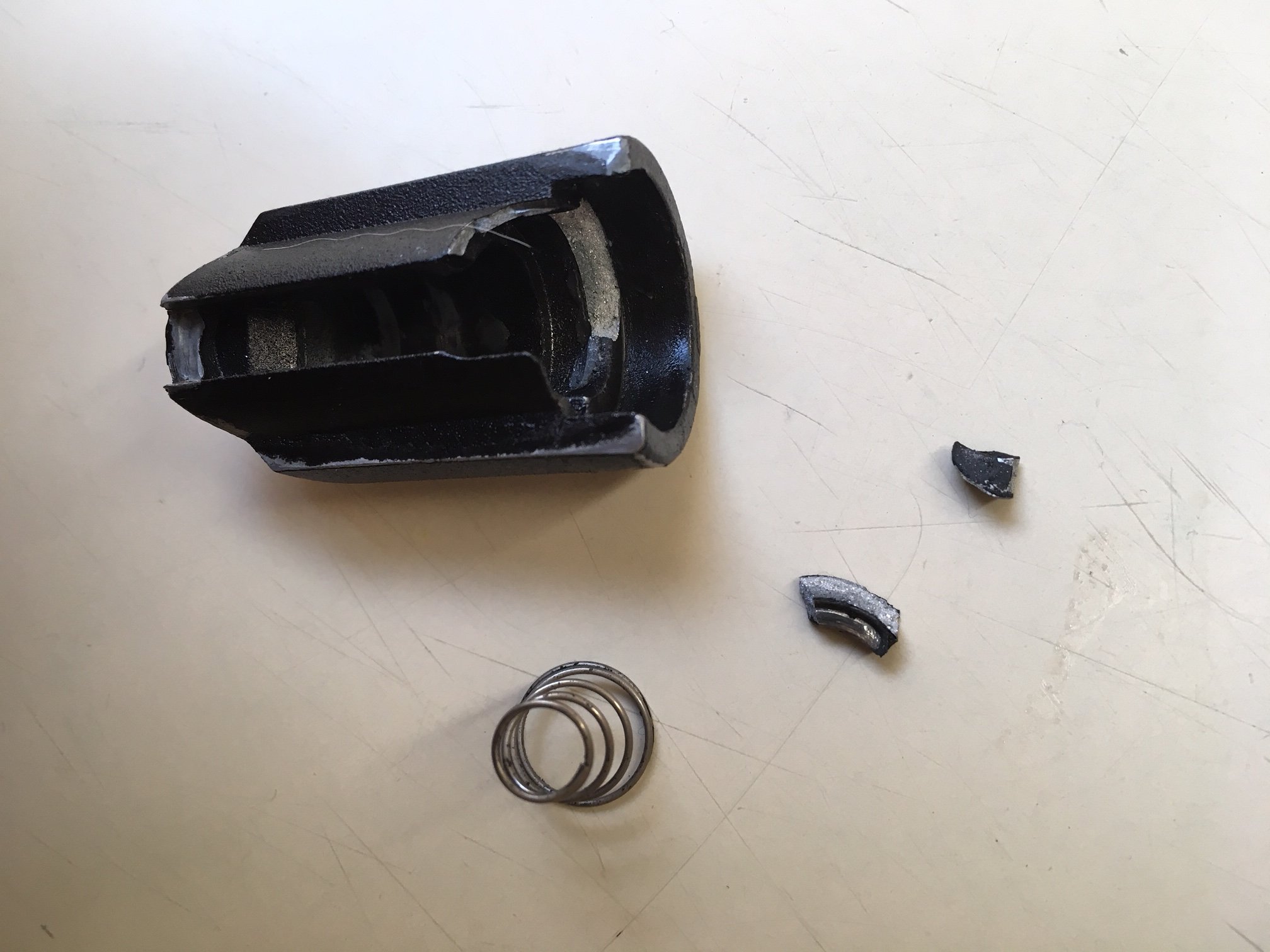

Metal bolt shroud from my Tikka CTR broke today. Has this happened to anyone else?
I have seen Broken Shrouds from the T3x. Its 'alloy' NOT Aluminium/Aluminum. Big difference because Alloy is a mix of metals - could be tin, lead, zinc, ally. The T3x shrouds are diecast - not machined. I use Titanium because its the strongest material for its weight. Even machined aluminium shrouds break - ive got photos from customers. Sterk.
Reactions: leeb10 and coltm4
Looking forward to you completing this current batch and getting the shroud and swept handle slapped on.
Yeah the stock T3X bolt shroud never gave me confidence as it was obviously a cast part and there were wear marks in several places with use. Didn't realize how much resistance was being induced by the shroud though: the bolt feels noticeable smoother without it on. Have also never comfortable with the bolt shroud spring they include on the alloy parts and not the polymer T3 ones.
