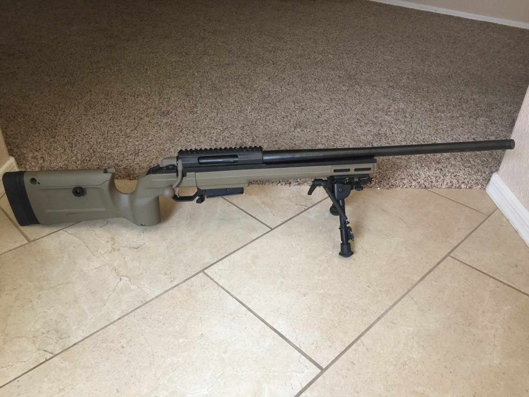

Looks great, show us from the other side with that handle! haha

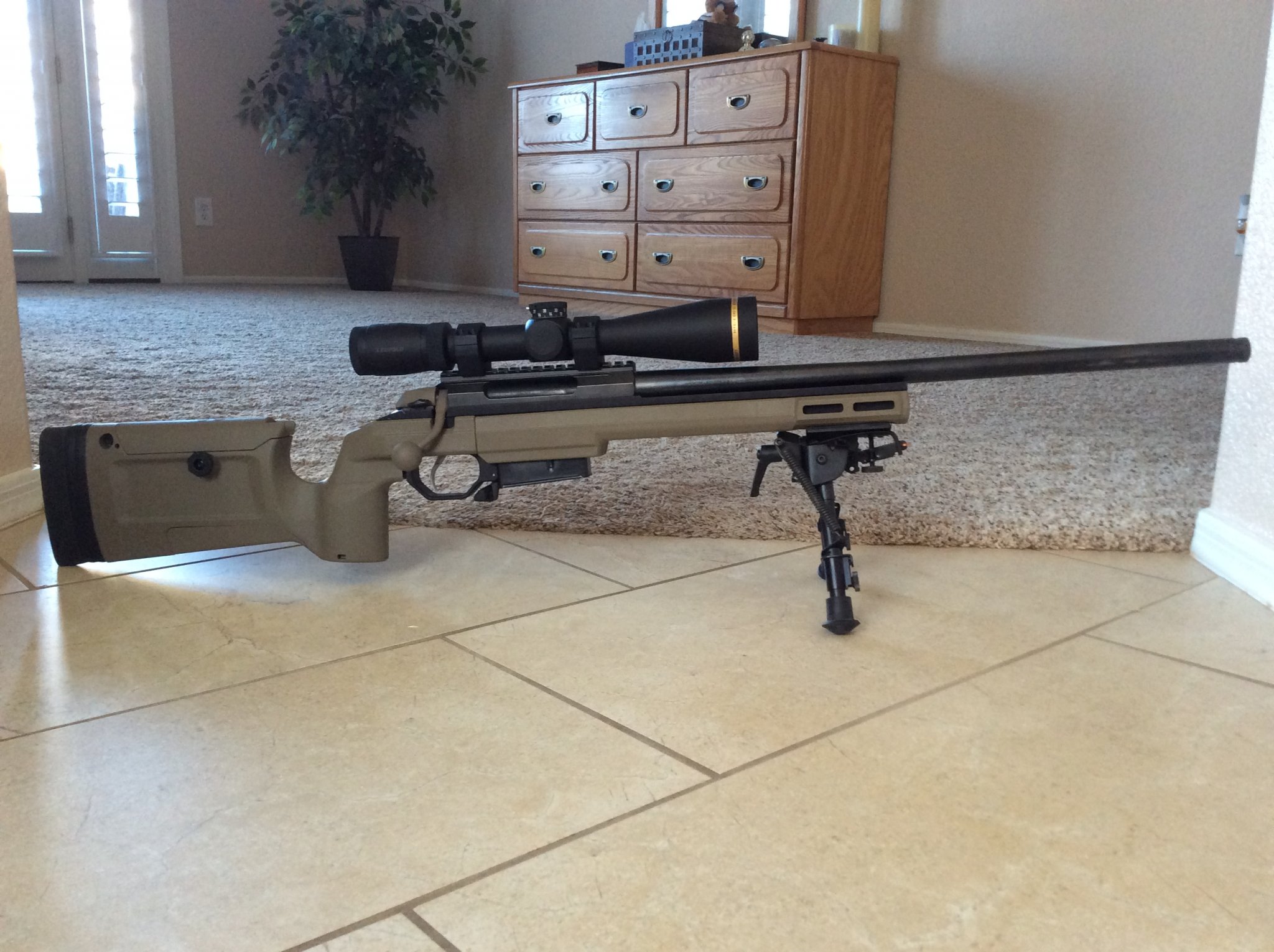

Here it is without scope so you can see the Sterk Bolt and Shroud. I will try and get one with the scope as well.

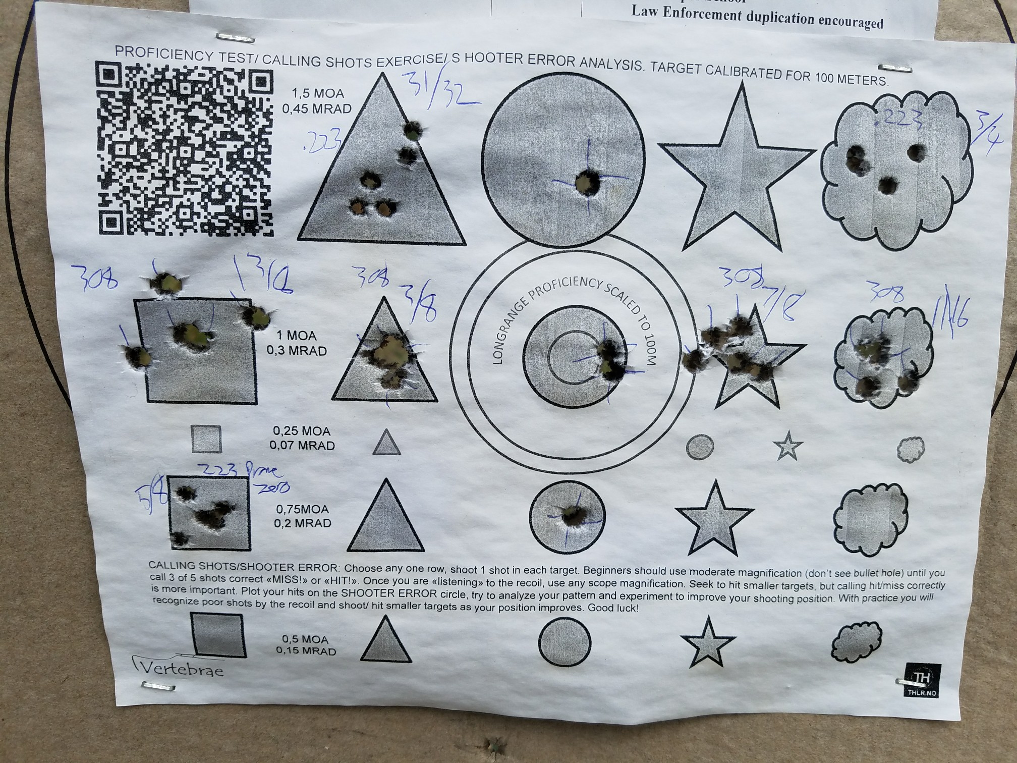

This target is in another thread on tripod shooting, but the bottom left group is a 5 shot group, including the cold bore, with my lite .223. Also, I had just reassembled the gun, and was shooting to check zero. Is the group as big as it is becasue its 5 shots, or did the lite barrel heat up? Stupid good gun. My .223 varmint will be here tomorrow, and I have a 6.5 on the way as well. I think that will be the end of my Tikka buying for the foreseeable future, but they are so good, who knows?
