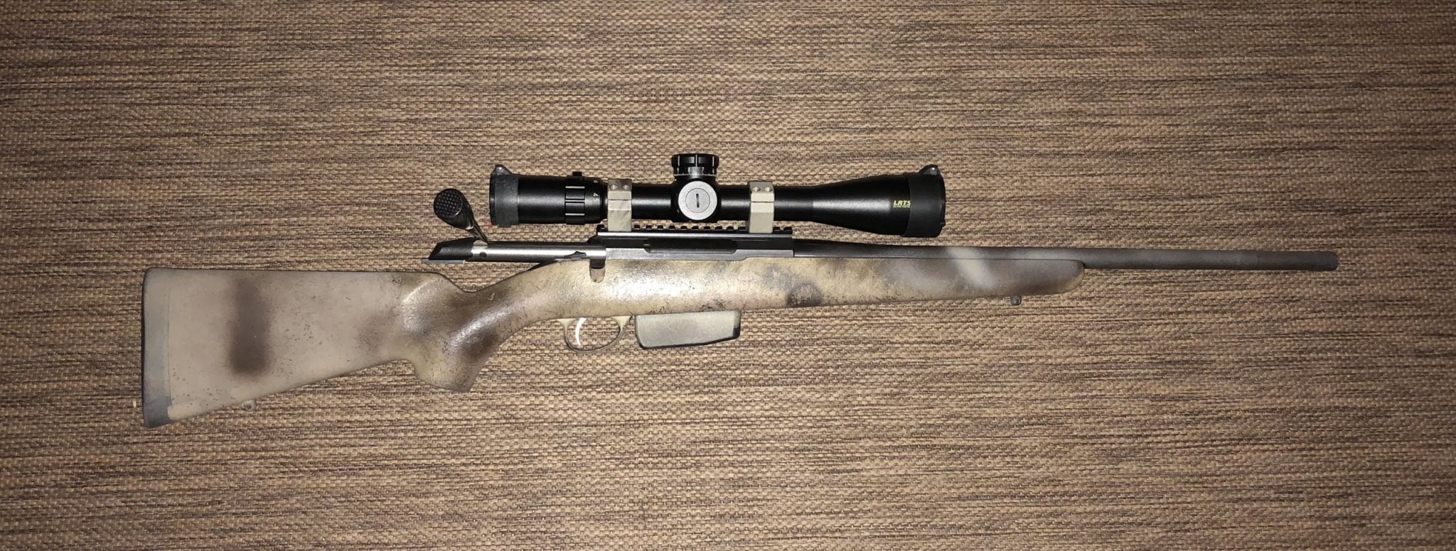

Started life as a Tikka T3x Lite LH in 308. Zero rounds down the pipe, off to the machine shop to get rebarreled in 6.5CM. MDT ESS chassis, Harris bipod and a Razor HD scope. Carbon fiber accents and an Omega 300 on the end. View attachment 6926485

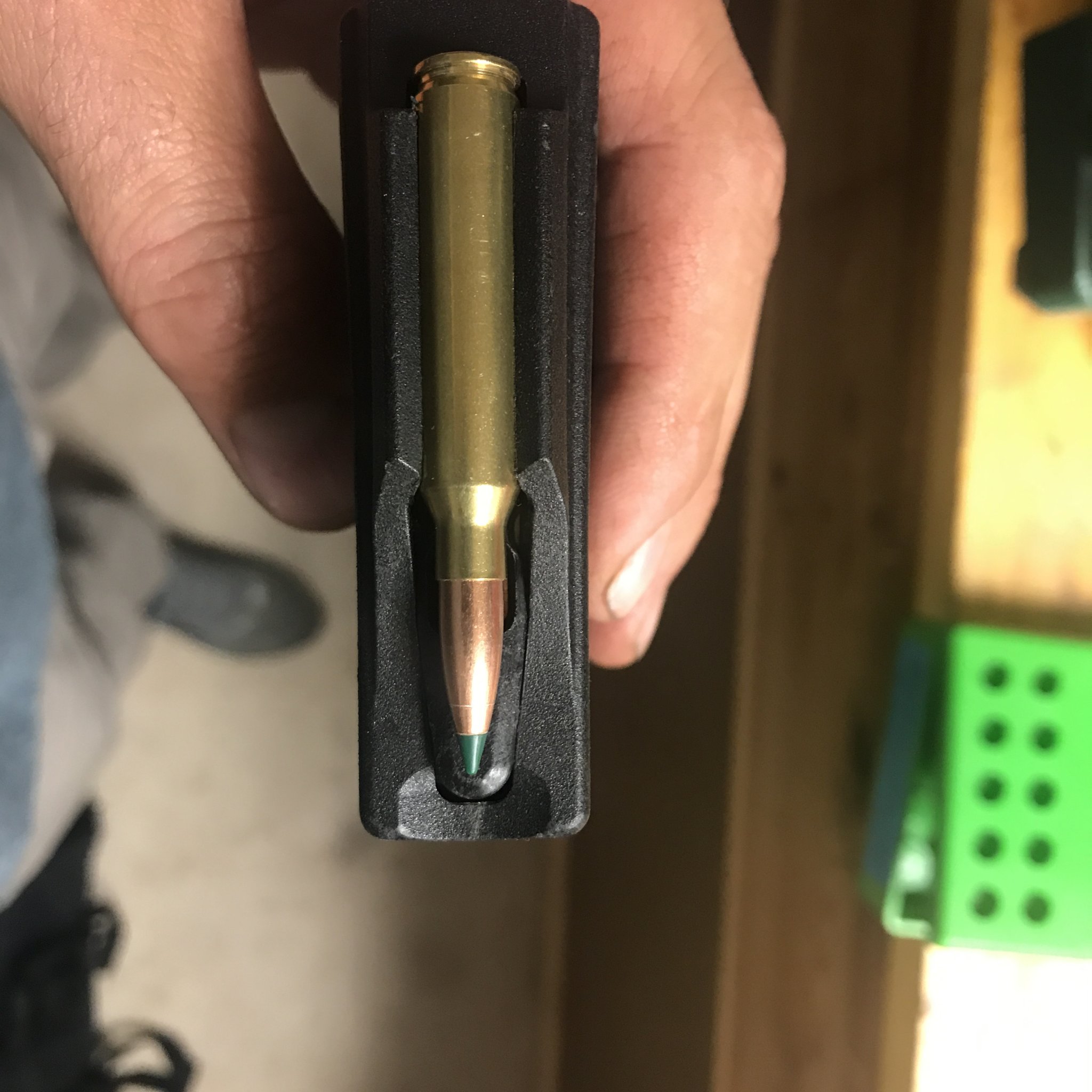

223AI, factory barrel rechambered. My load is 2.41" OAL, mag is 2.562" plenty of room.
Ok. If you were replying to me, then I'm not sure the 223AI is relevant. My questions had to do with a long SA cartridge like 6.5 CM. I wouldn't expect to have to mod anything for a 223AI.

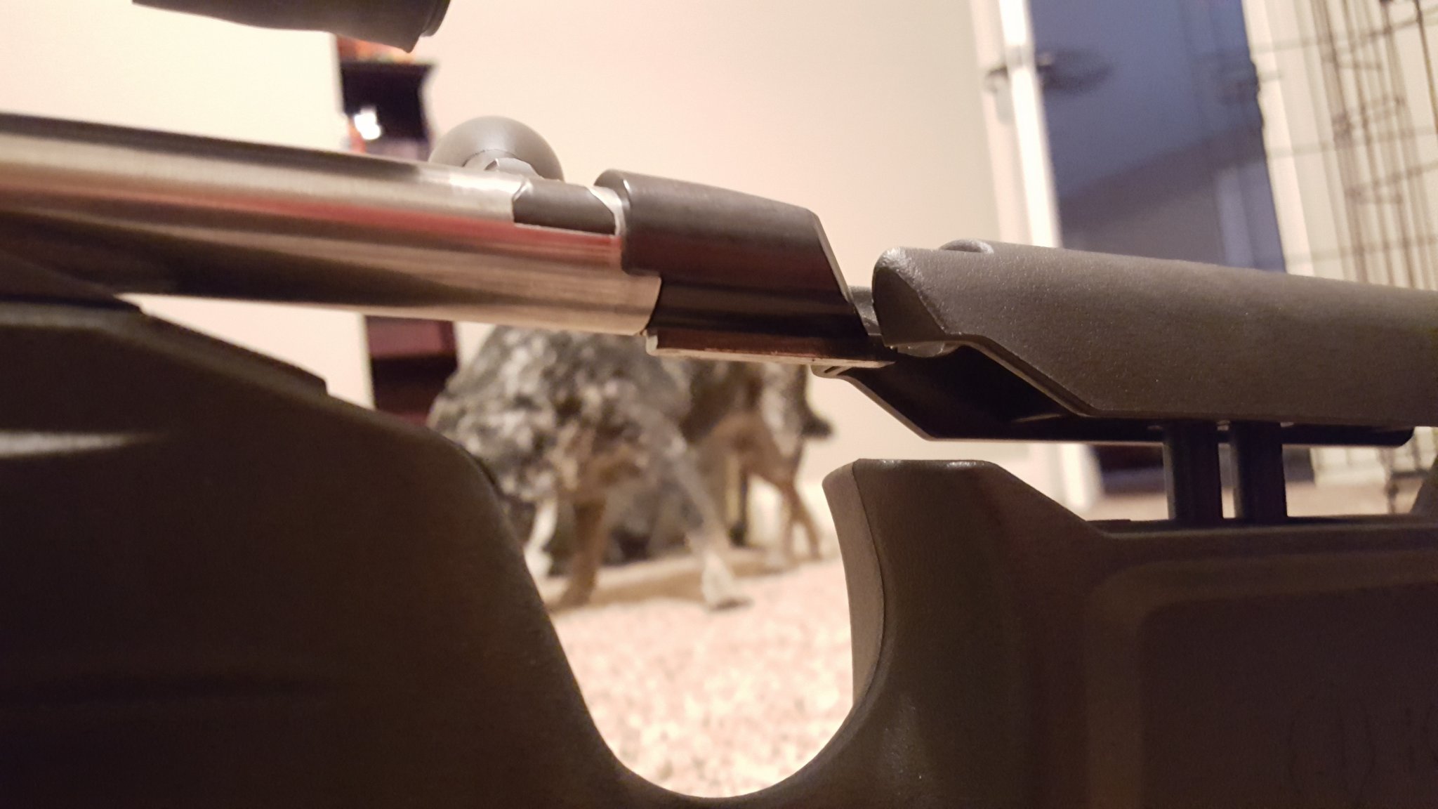

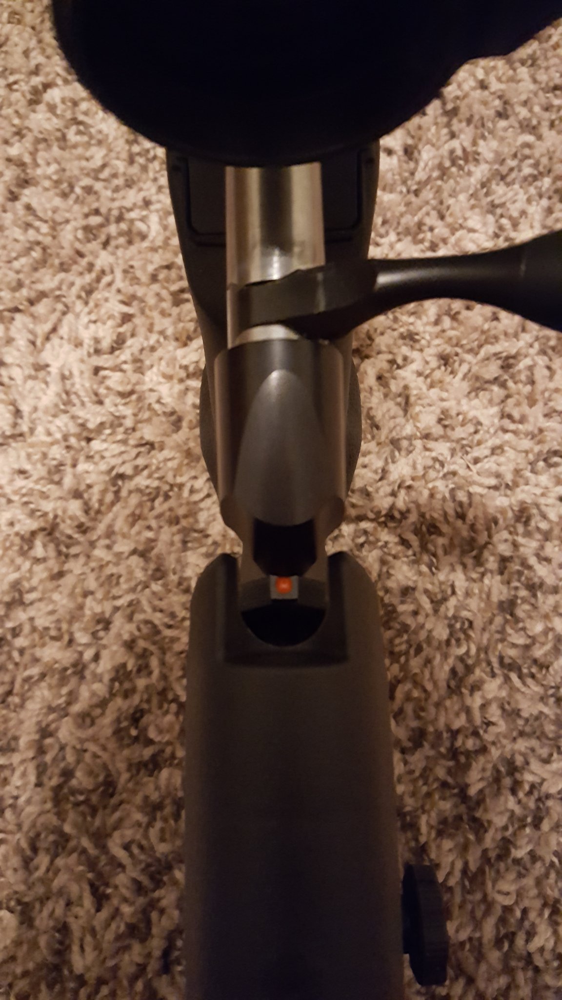

Finally got around to emailing KRG this week about the Tikka specific cheekpiece and they sent me one for free. The new one didn't come with the posts attached so I had to drill a small hole in the top of each plug, drive a small screw into it, and pull it out with pliers in order to get at the screw to remove the posts and move them over to the new cheekpiece.
Now that the cocking indicator on the bolt doesn't hit the cheek riser I got the Bravo dialed in perfectly-and I mean it is perfect. Finally done with this build-guest appearance from Riley the Heeler in pic #2

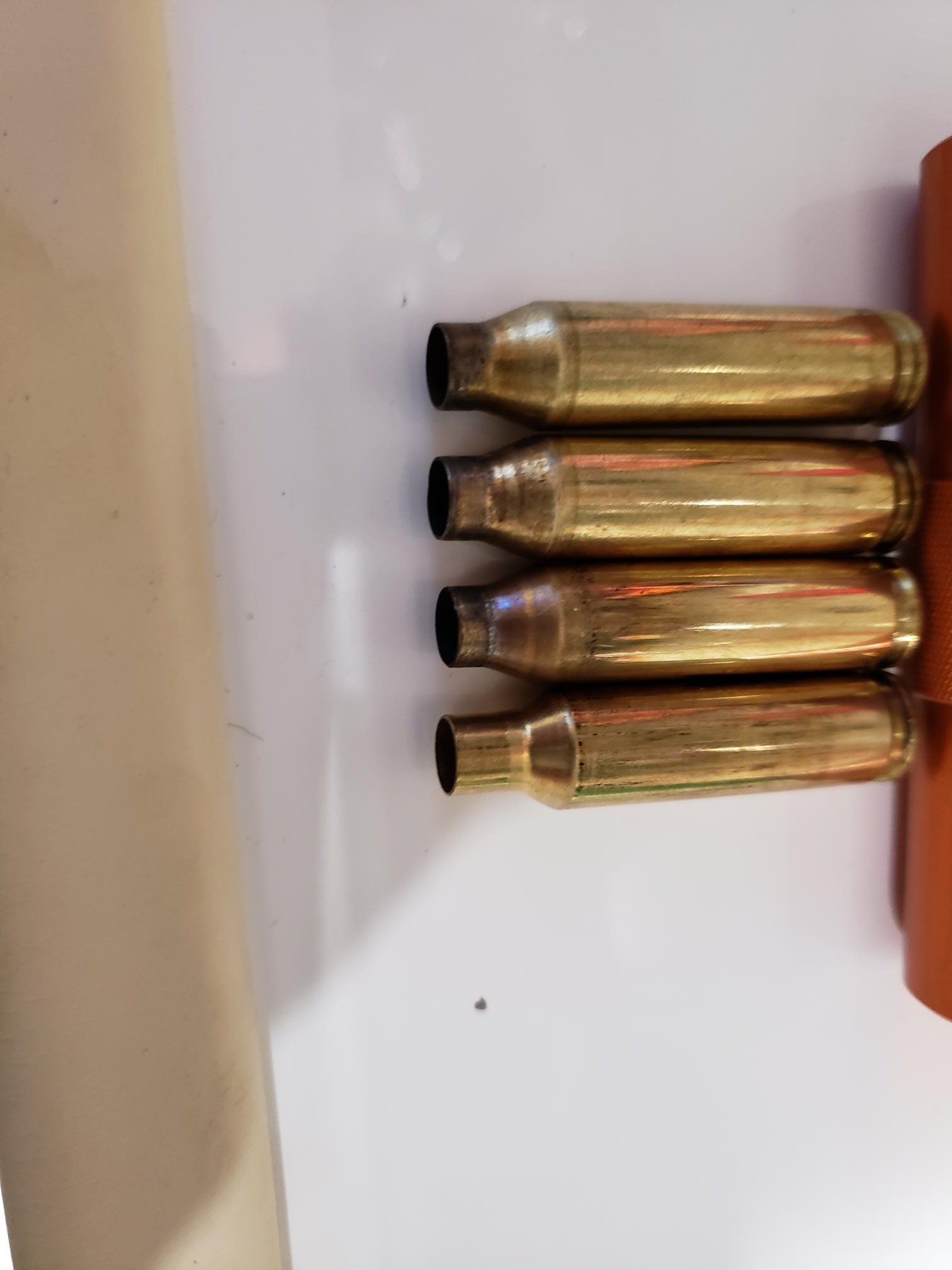

Hello, my first time posting here. Got a Tikka T3x Tac A1 in 6.5 CM last week and shot it for the first time over the weekend. Out of the 4 factory ammo tested, 3 of them shot 5 shot 1 hole group at 100 yards. I have been a gas gun shooter and this is my first bolt gun and some of the things are new to me. I noticed a couple of things:
It was somewhat difficult to close bolt on the 2 Hornady ammo (140 and 147 ELD-M), no such issue with Federal GMM (130 Berger and 140 SMK). Why is that and should I be worried about shooting more Hornady ammo?
Also, looking at fired brass, the shoulder swelled a lot, leaving very little neck. I have never seen that in a gas gun. In a gas gun, the case measure bigger after firing but the overall shape still looks the same as before firing. Is what I am seeing normal?

That doesn't sound normal at all. Can you post a picture or two of the brass? New and once fired. Could it be you were accidentally given a 260 instead of a 6.5 creedmoor? The left side of the barrel by the action should be stamped with the caliber and you'll be able to see it with the help of some light through the handguard.

HaysKSFirefighter was right on, it was indeed 260 remington. I guess I checked out too fast. Funny thing it shot 6.5 CM factory ammos so well. Thank you both for helping solving the mystery, I'd never have thought to double check the caliber.

Checked out too fast ?
Your lucky you didn't check out permanently.
I would not try shooting that .260 until you have a very good smith inspect it for damage....
Reactions: Changed
Dude you’re lucky it didn’t split the barrel into 4 pieces and blow up in your face, it could of been bad, but glad you’re ok, for future references if the bolt don’t close somewhat easy somethings wrong
Reactions: Changed
What :O Quite wild! I would still love to see how does look like 6.5CM brass shot from .260 rem side by side of unfired brass (6.5CM and .260 rem).

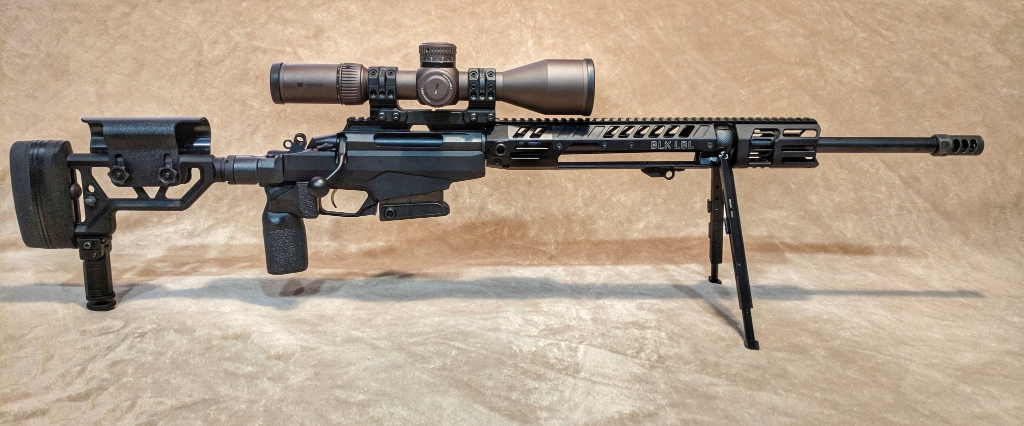

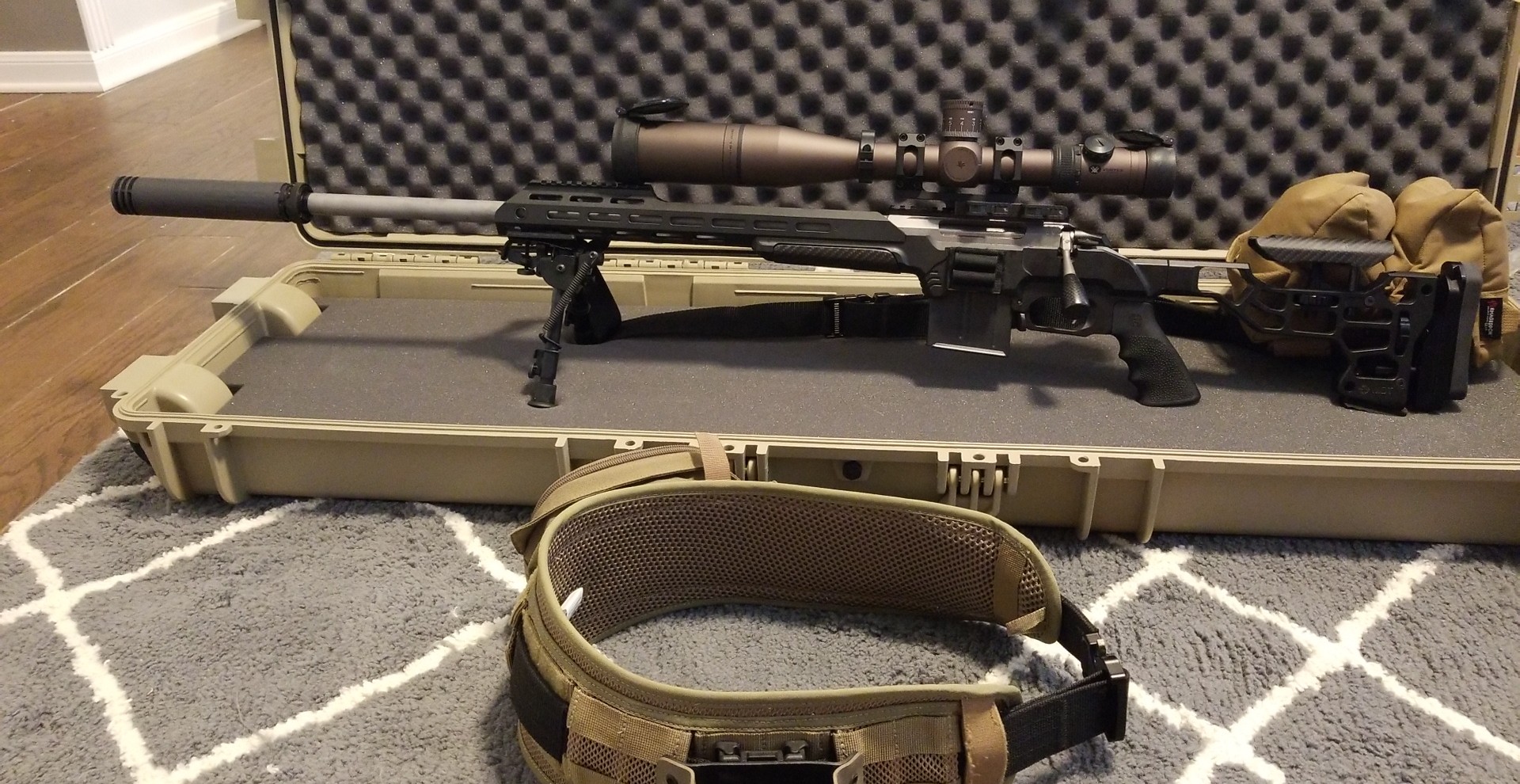

Here's my Tac A1. Got a killer deal on it a couple months ago, but it's my first bolt gun ever (and the first rifle I've owned since the 90s), so I also had to buy EVERYTHING else. Knew ahead of time that I'd need a scope, sling, bipod, and mat, but it turns out that when you're starting from scratch you also need a whole lot of other stuff: Vise, tools, a rifle-length cleaning rod and bore guide, rifle targets, new ear pro that doesn't get pushed off your head by the cheekpiece, a bigger range bag to hold your pistol gear AND all your new rifle paraphernalia, more ammo storage, more gun storage, more accessory storage, etc, etc.
Fortunately, I discovered the Hide right around the time I bought the rifle. Got equipment info from the forums, and some really good deals as well.
Anyway, the gun. I still haven't fired the thing, but I've got almost all the pieces together and I'm really looking forward to going out and finally starting to learn how to use it.
Tikka T3x Tac A1, 6.5 Creedmoor
Vortex Razor HD Gen2, 4.5-27x56
Spuhr SP-4603B
CTK monopod
MPA EVG grip
Sterk bolt handle
BLK LBL integrated bipod (looked interesting, couldn't find any reviews, so I'll try it and write one)
APA Little B brake
Still waiting for scope caps and a sling
Well the fired 6.5 CM brass look more like 260 REM brass after firing. Here is the pic.
And the 100 yard 3 shot groups from 4 different factory ammo, 2 hornady, 2 federal GMM. No trouble closing bolt on the Federal. These are 6.5 CM ammo shot through 260 Rem chamber.

Man you got incredibly lucky as has already been mentioned. Happy I could help, though I was hoping I was wrong! This goes to show the strength of these actions, but you really need to have it checked over by a smith before firing it. If you've seen an action blow up and the damage it can do, it's something you don't want to mess with...all kinds of bad juju. That being said, if it's good, the factory Hornady 130gr 260 ammo has been fantastic for my 260 Tikka's, Prime is great too on that front!

I'd say nil damage done, just like fireforming for improved cartridges. You've probably just invented the next big 6.5 chambering, short neck 260 Rem. Just get a reamer ground with your name on it, I hear it may be the next wonder cartridge in PRS circles next year lol. In all seriousness you should have stopped after the first round and sought the advice of someone more knowledgeable, lesson learned I hope. Had you managed to chamber a shorter version of some 7mm, 30 cal etc round you may have given yourself a permanent reminder of your carelessness.
Reactions: MarinePMI and JayB
I once grabbed the wrong box of ammo at the range and loaded up my M1a with 8 mm Mauser commercial FMJ... The shoulder of the case prevented it from chambering.
Visually everything looks fine. I even used a bore camera to look at the chamber. I scheduled an appointment with a local gunsmith to have it checked out. I just ordered some Lapua 260 Rem brass and another T3x TAC A1 in 6.5 Creedmoor, double and triple checked my order this time. Thanks again for solving my puzzling mystery. I also checked out Prime site, why would they charge $5 per box more for 260 REM than 6.5 CM? That makes no sense. Extra 2 grains of powder cannot possibly account for the price difference.
WOW!
Wrong ammo through a gun...and lots of it! And it shot like that? My mind is blown - just glad the gun wasn't.
I know right? Wrong caliber and still shot 1 hole groups using factory ammo.
Multiple caliber system Tikka Rifle :ROFLMAO:
Come to think of it, maybe a removable steel chamber insert is all it takes for the same gun to shoot all 6.5 calibers -- 6.5 CM, 260 Rem and 6.5x47. Shall we call it the "Tikka caliber conversion kit"? Okay if there is ever a patent on this, this message serves as evidence of "prior art".
In retrospect I certainly should've stopped after the first round. However I didn't know better. I had no trouble chambering it, and the impact was off by only 0.2 mil in elevation and windage from my existing scope zero. The only thing odd to me was the fired brass. Coming from gas guns I looked at it and thought -- do all bolt guns do this? The only other people at the range were some yahoos doing mag dumps with a 10/22 and it was a long drive for me to get to the range. On gas guns the calibers are always printed on the receiver usually in obnoxious color. I did not see one on the Tikka and did not think about double checking. Lesson learned for sure.
?this needs to be sent to beretta/sako for advertisement! Tikka still shoots 1/2 moa with wrong ammo! lol
I didn't measure it but 1/2 MOA was the worst group of the 4 ammo I tried. The other 3 all shot jagged holes.
