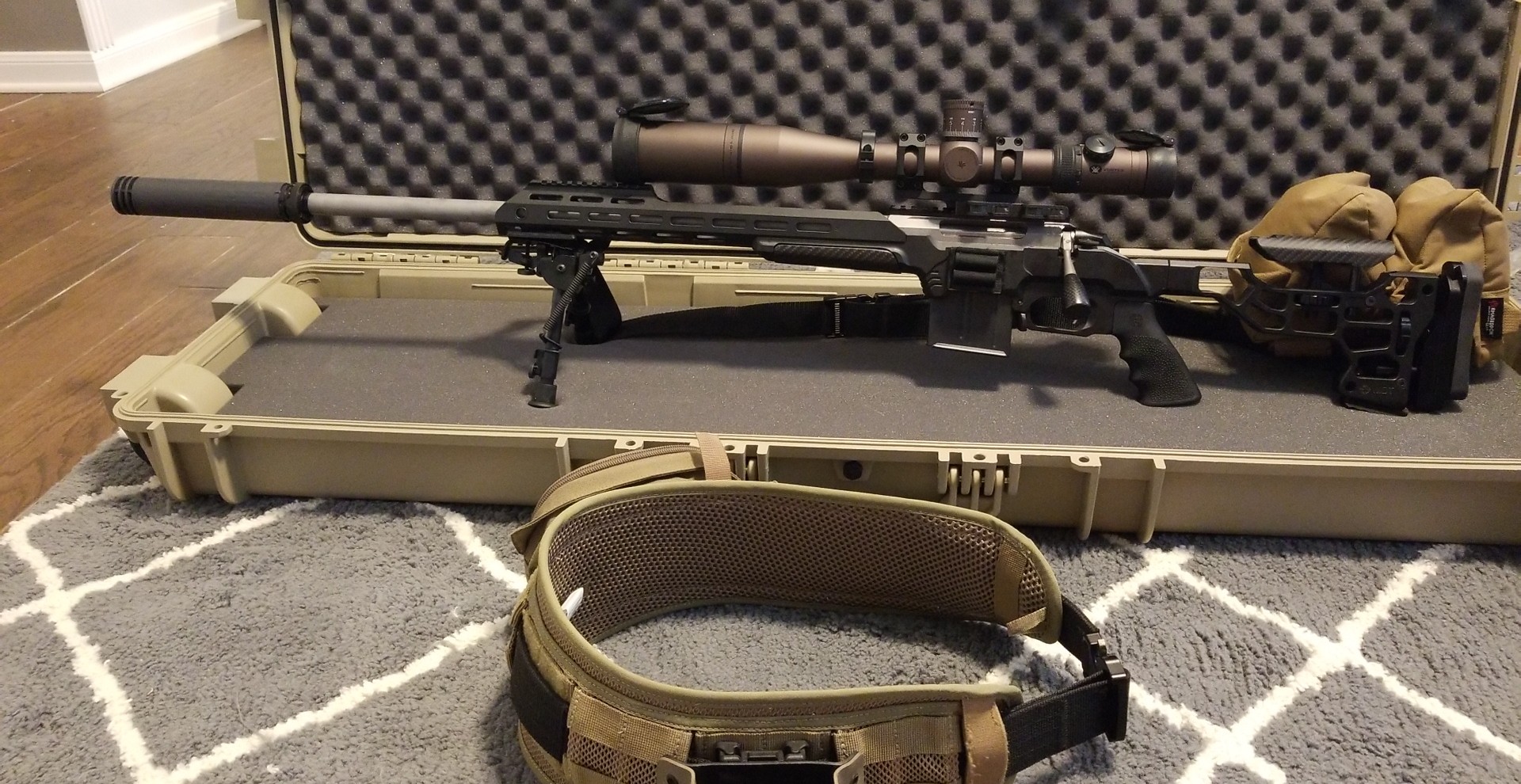

Finished my tikka after a couple years. Got the last piece of the puzzle today. Bushnell lrhsi 4.5-18, also installed the sterk handle a couple weeks ago and the pvc data card yesterday. Absolutely loving this tikka!!!!

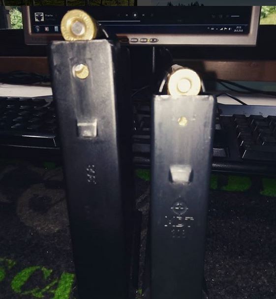

Lots of bad reviews on Accurate mags scratching up brass bad and not feeding well...?
Every metal mag is going to scratch brass. The only way to avoid it is by using MDT/Magpul mags but I haven't had great success with them in my Tikka's. I only run accurate mags and have never had any problems with them. I've had issues with my bullets being to far seated out and not feeding properly but thats not the mags fault. I can fit 12 rounds into my Accurate mags with no extension and have them feed flawlessly.
The scratches can be resolved by using a file, and rounding the edge of the feed lips. Metal (steel) mags are stamped, and the stamping process can leave the edges with burrs that will scratch the brass. Just hits the lips with a small file, and round the edges. Problem solved.
I feed them one at a time anyway benchrest shooting but tried the Accurate mags in myCTR / Bravo and saw it scarring the brass and I was wondering if people filed the edge over and if it helps. Thanks I’ll have to try that.
I had that same issue when i got my first Accurate mag, i think that is bad crappy magazine, why they do not take care of those magazines on the factory.
Anyways, use a fine grit paper and a little bit soap and water, and water grinding paper, and do the lipst of the magazine smoother.
I used 320 paper and soap+water, and those lips are like Angelina Jolie lips now, smooth and soft, and do not scarring the ammo any more.
MDT AICS magazine does not leave any kind of marking on the brass, and it is cheaper, and smaller, even though you go with the 10-round.
Reactions: Lunchbox27
No offense, but having run quite a few local club matches, the MDT mags tend to give the most problems. Some chassis just do not work well with them. Just a single perspective (mine), but it is what I have seen over and over again; especially when conditions get dirty or gritty.
I'm not bagging on them per se, just saying that they are what they are...a relatively inexpensive AICS compatible solution.

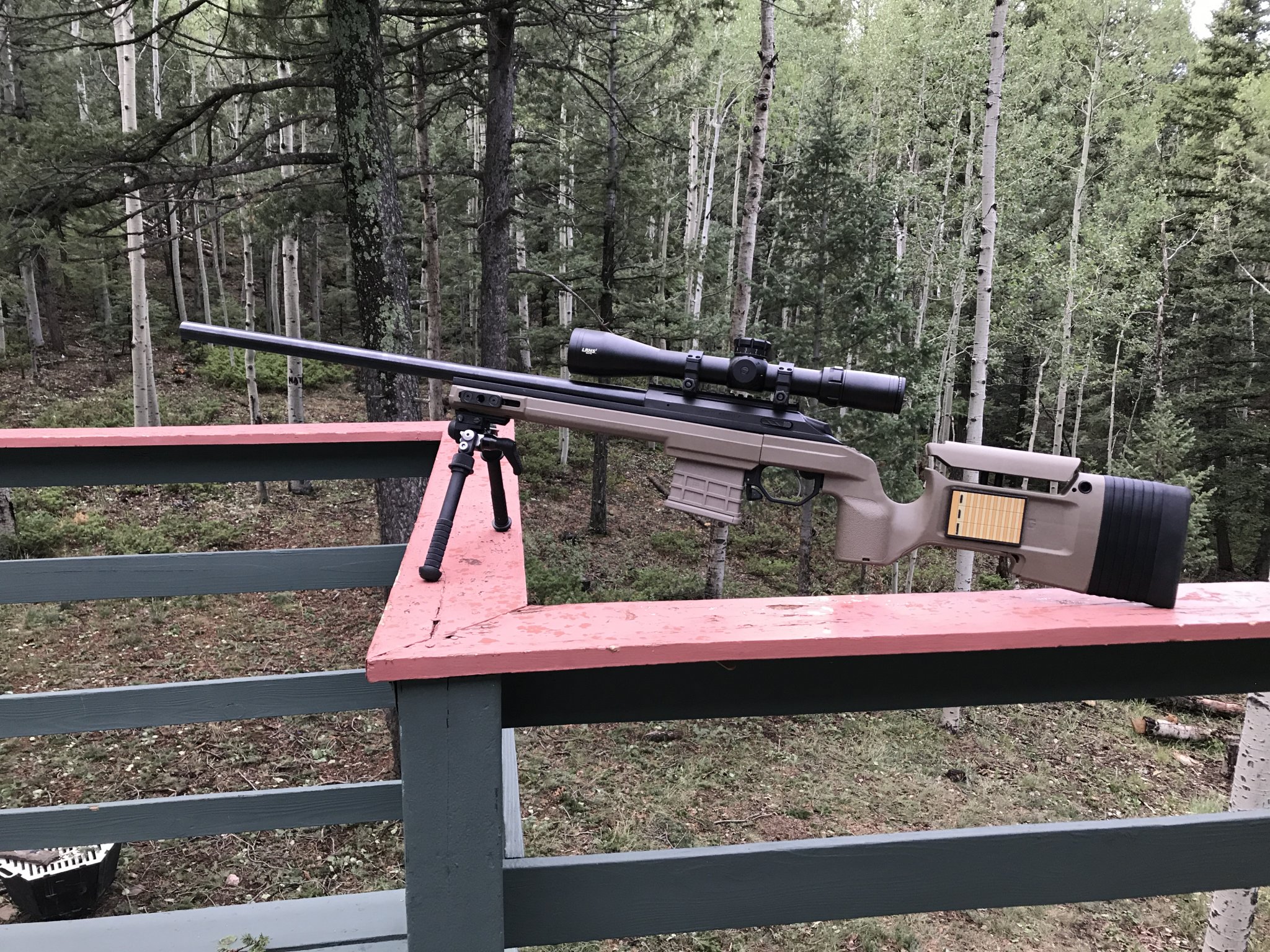

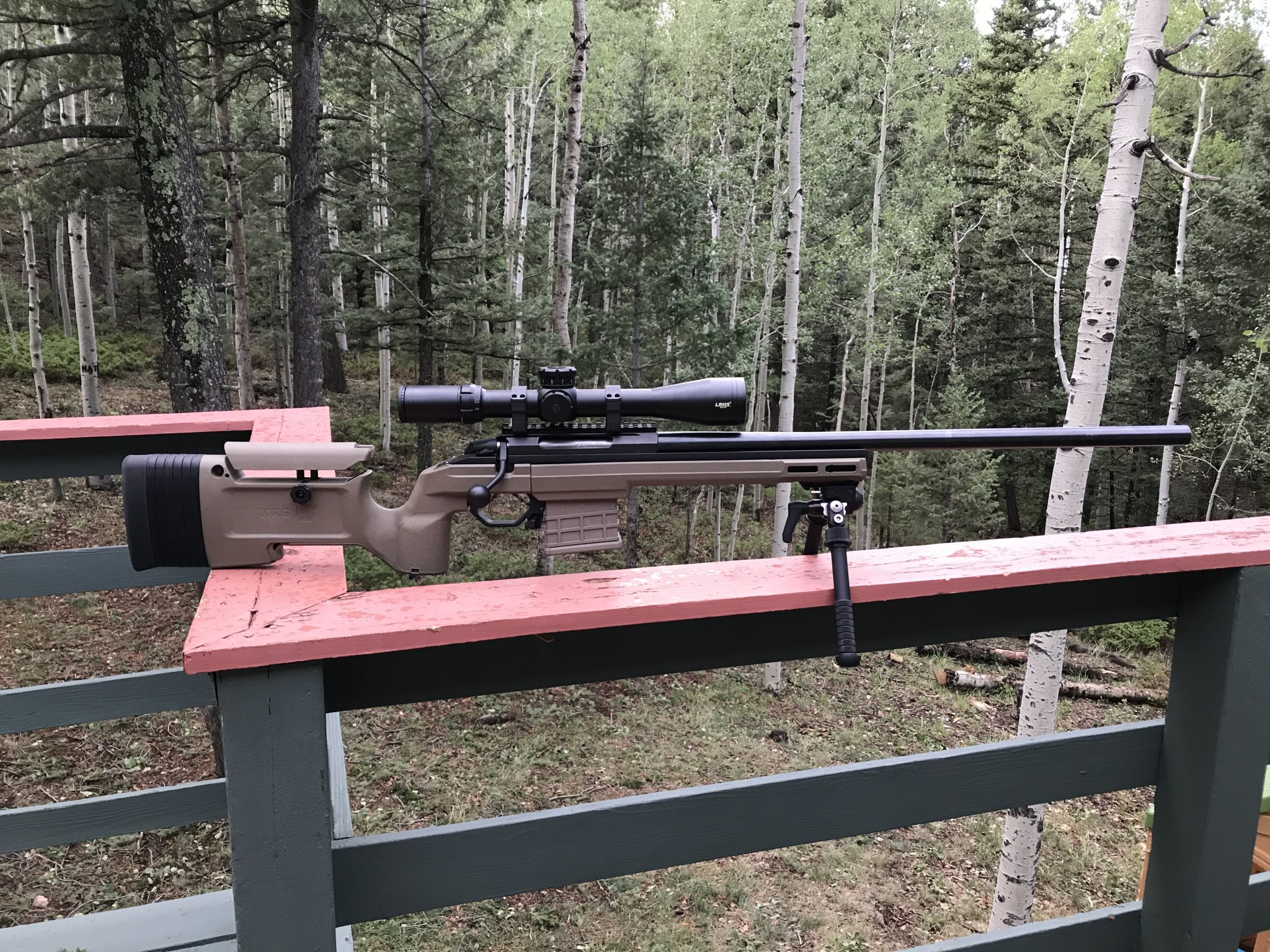

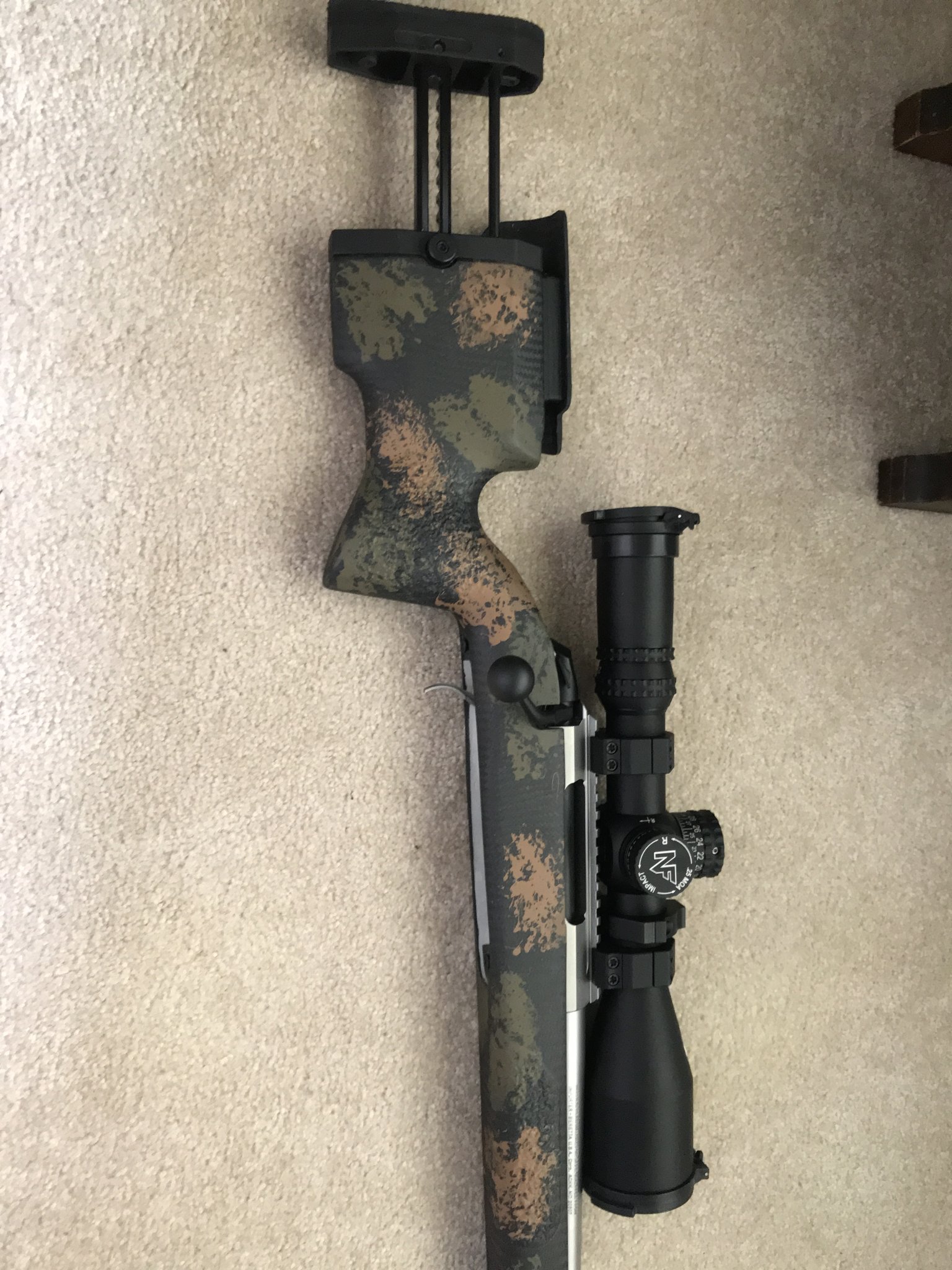

24in CTR in 6.5 creedmoor, Vortex Viper PST 4-16x50 FFP, seekins high rings and Harris Bipod. My first true dedicated long range bolt gun and not just another hunting rifle.
Great looking rifle. What does it weigh?

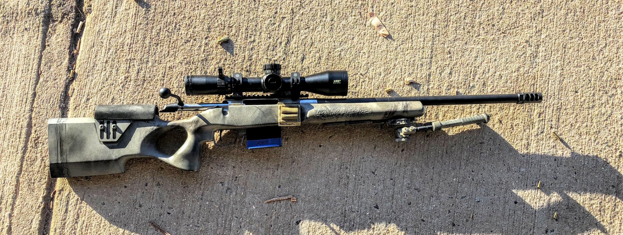

Some bottom metal and a little cerakote and back to shooting! Manners knocked it out the park! Huge thanks to them.

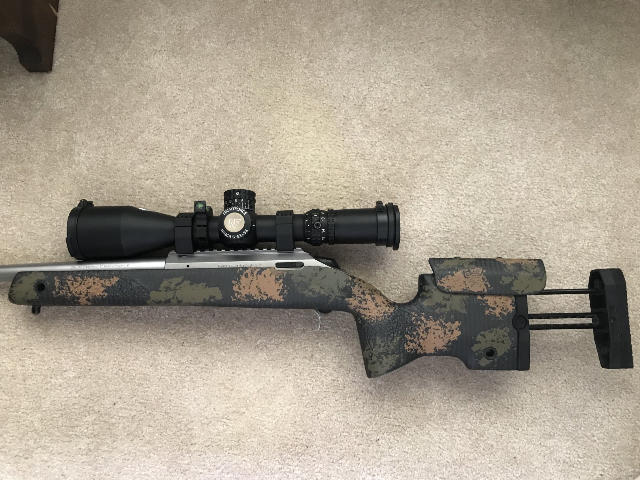

New DBM will be in tomorrow and I can’t wait
I have been waiting for this comparison! Thanks for the picture, sir!

What stock is that? Looks good.
Sorry, this is the best photo I have. Rifle shoots super well.
Action, Bolt & handle and trigger - Tikka T3
Barrel / chambering - Maddco 1/8" in 6XC
Stock - Manners
Scope - Bushnell XRSII
Rings - Vortex Matched (easy way to find Seekins rings in Australia)
Magazine - using original Tikka T3 bottom metal (plastic) with 2 different after market 10 shot magazines
