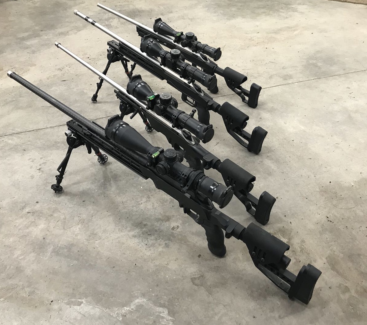

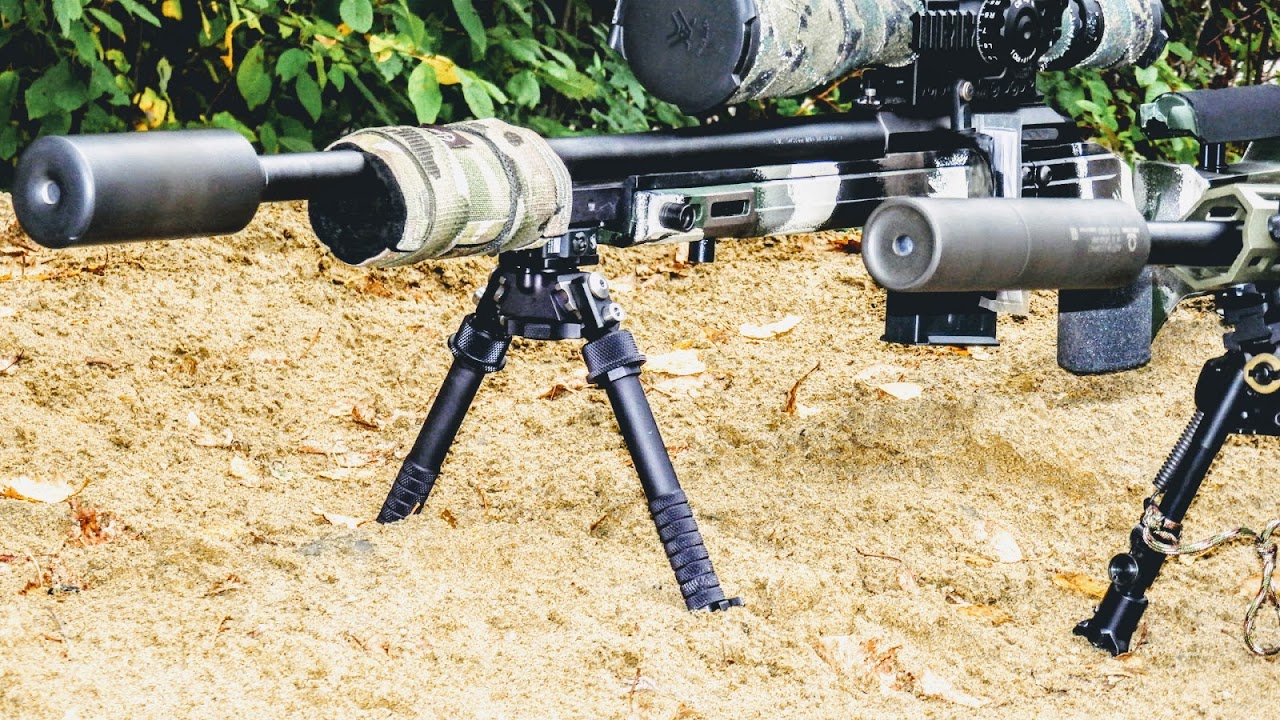

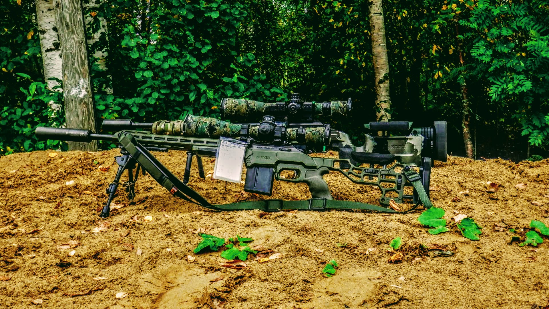

2 x Tikka T3X CTR.
1=260rem
2=308win.
Green OD is MDT ESS.
Behind is KRG Bravo.
Both has Kahles K624i scopes.
Both has Sterk swept must have bolt handles, is some one is wanting, i am selling 2xctr original ones with 120$.
Front one has Vortex precision rings, and behind one has Spuhr.
Both has Ase Utra supressors, front one it is Jet-Z and one in the behind it is SL5i.
Bipod in the front is Harris, with the Hawkhill awesome feets, behind it is Atlas PRS with the superd riflestick grapplers.
Both scopes has MKmachining throw levers, Gen III has the great parallax wheel, i would like to get that for the Gen II also.
Rifle sling you see, is 3HGR sling, very good slings from Finland, this one is made with 2-point attachment points.
Dope card holder is DIY;).

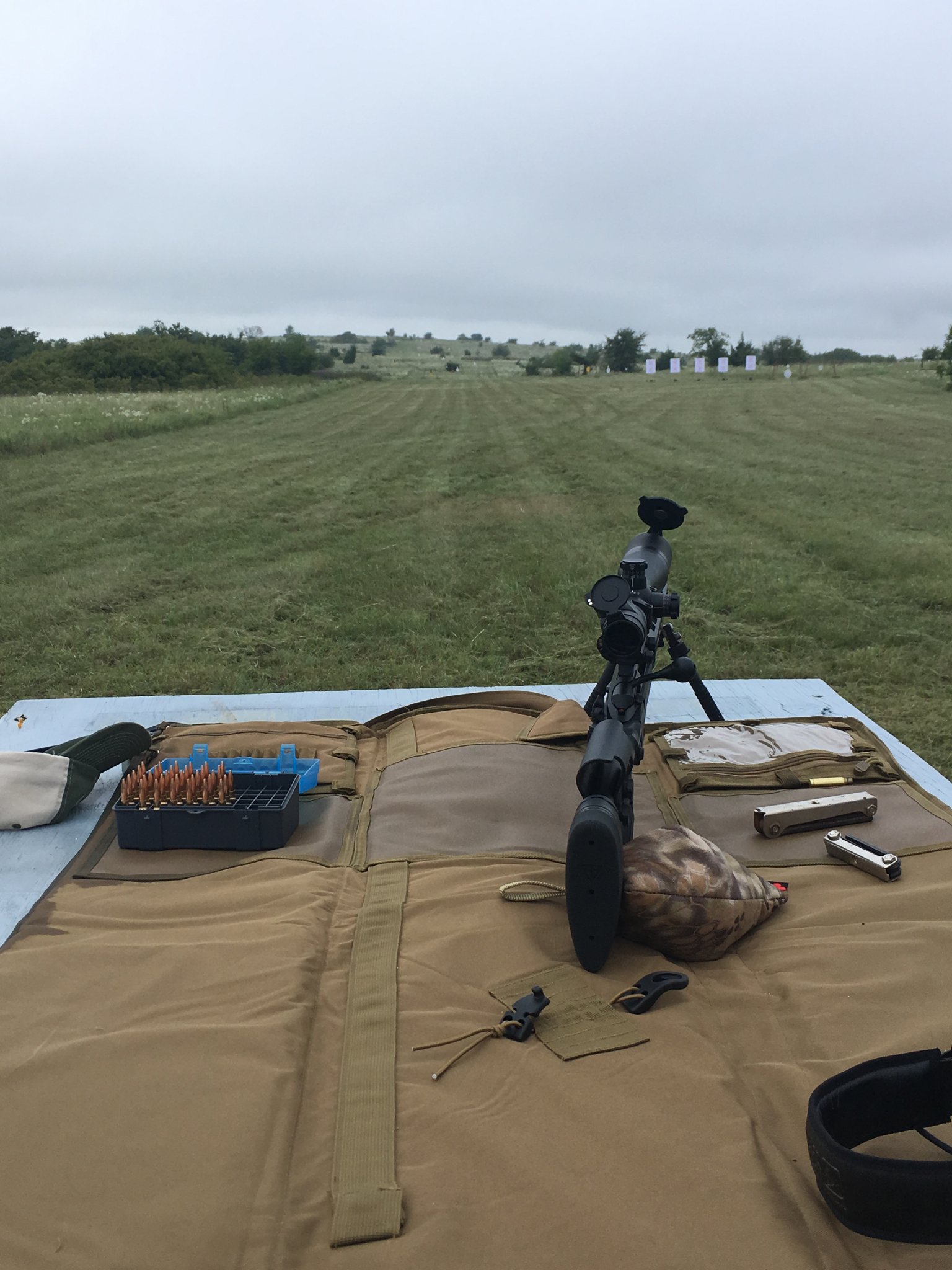

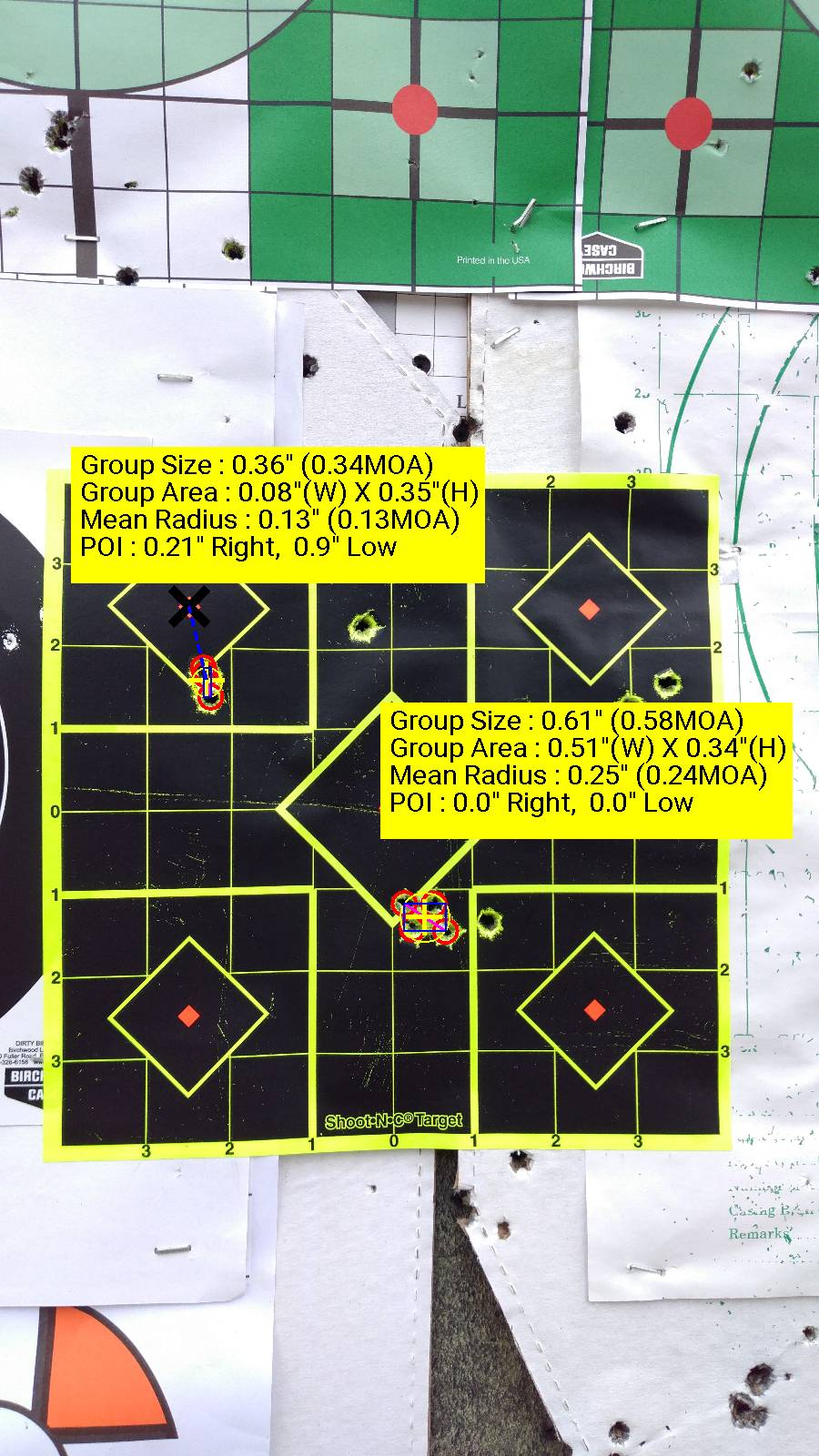

Took the Tikka T3x to the range today. 6.5 CM, Burris 5-25x50 XTRII, KRG Bravo, and Lil Bastard. I cleaned the barrel last night, then oiled it with Valvoline Synth motor oil. Ran a few dry patches down the bore and called it good. Took 5 different boxes of ammo to see which non lead would shoot best as deer season is just around the corner. Shot Hornady Full Boar GMX, Barnes Vortex TTSX , and Remington w/ Barnes TSX BT, all at 100 yards. The best group was the Remington at 1". Did not expect the Remington to out shoot the others. Shot some Federal Gold Medal w/Berger, 1". To be honest, I was doubting the Tikka`s ability to shoot small groups like others here have stated. THEN, I loaded the magazine w/Prime 130`s. Never shot prime ammo before. I shot my best 5 shot group of my life. 5 shots went into a 5/16" hole. I went over to my buddy and asked if he saw my group? No, he said. I said look at it. He looked at me and said ok. We got a call to clear the line so new shooters could put up targets. We walked to my target. One ragged hole, a small hole. Brought the target home and measured it. 5/16", hot damn Maybell, I am in love.

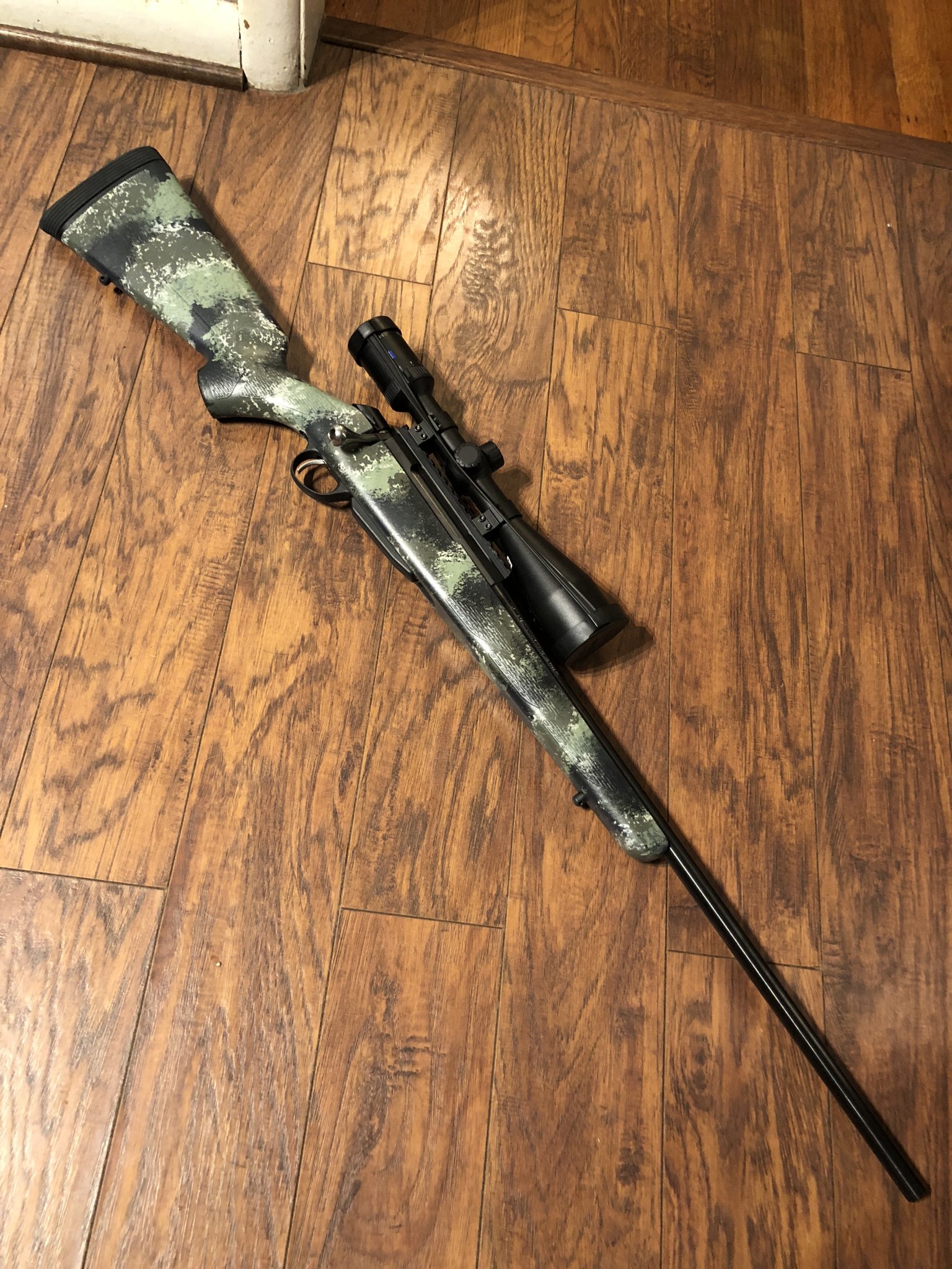

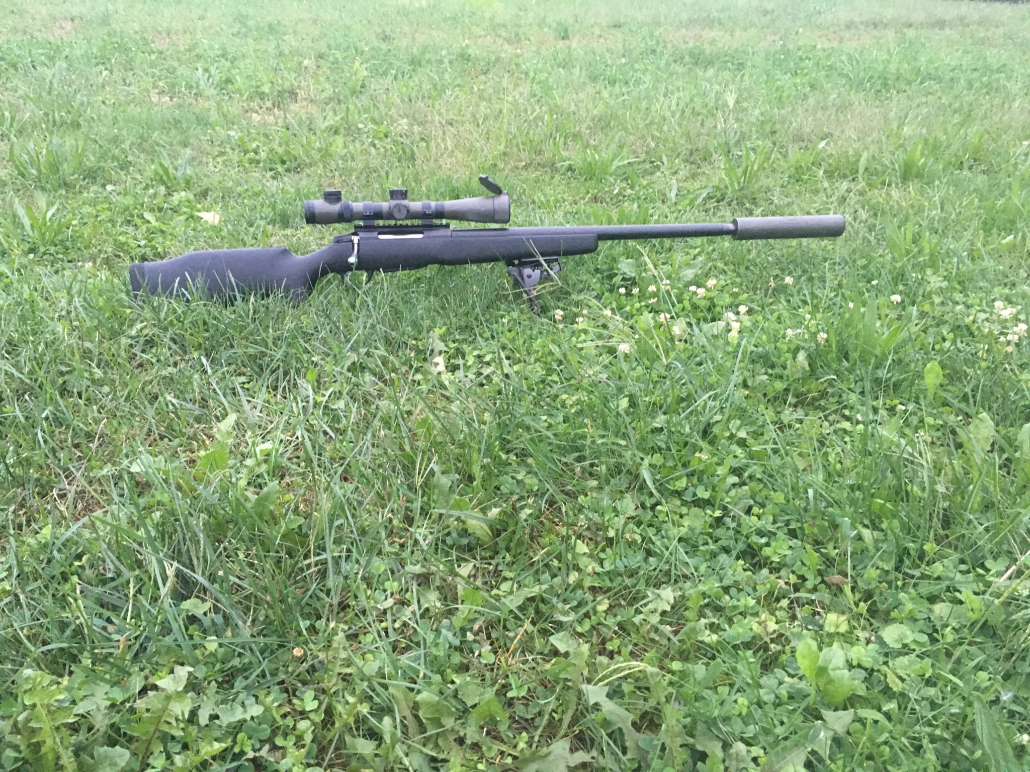

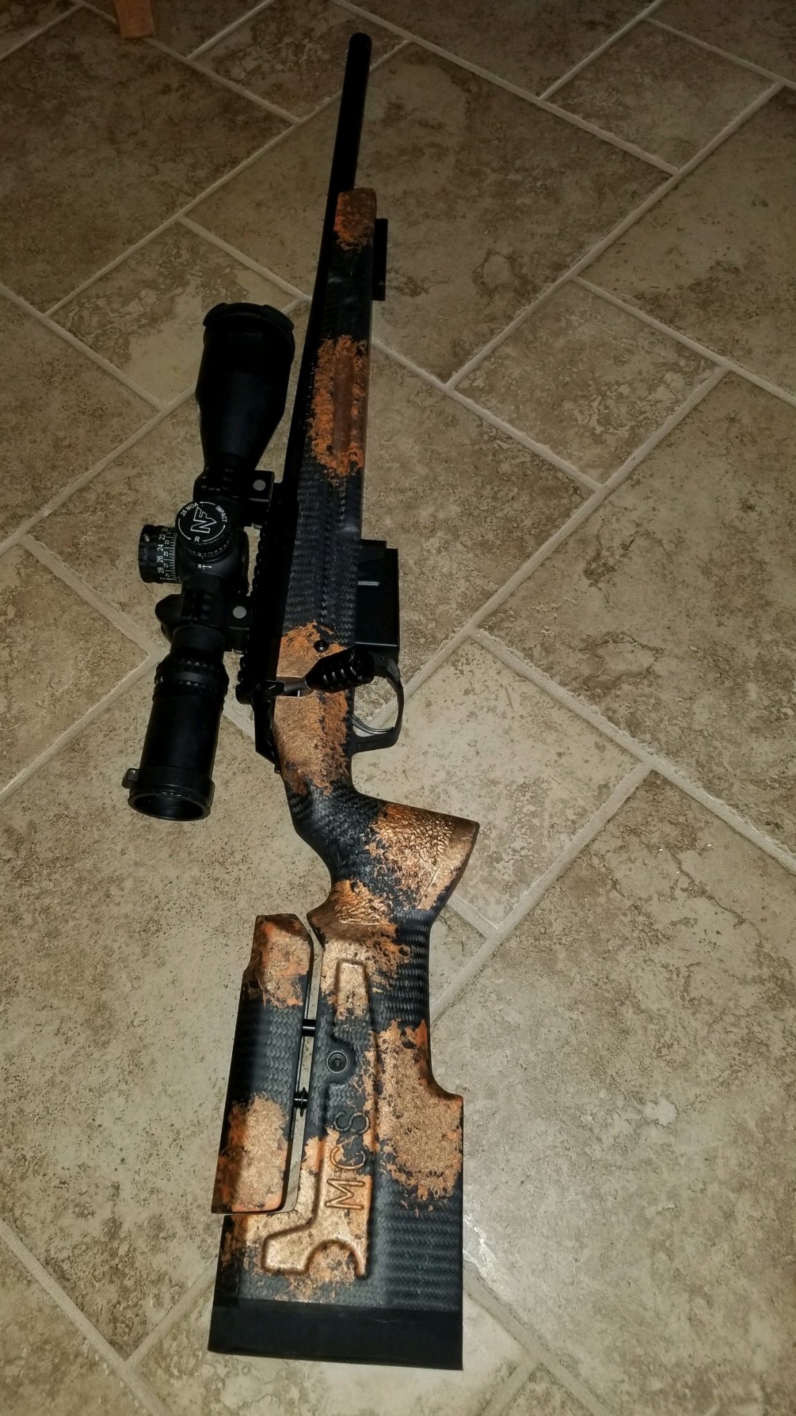

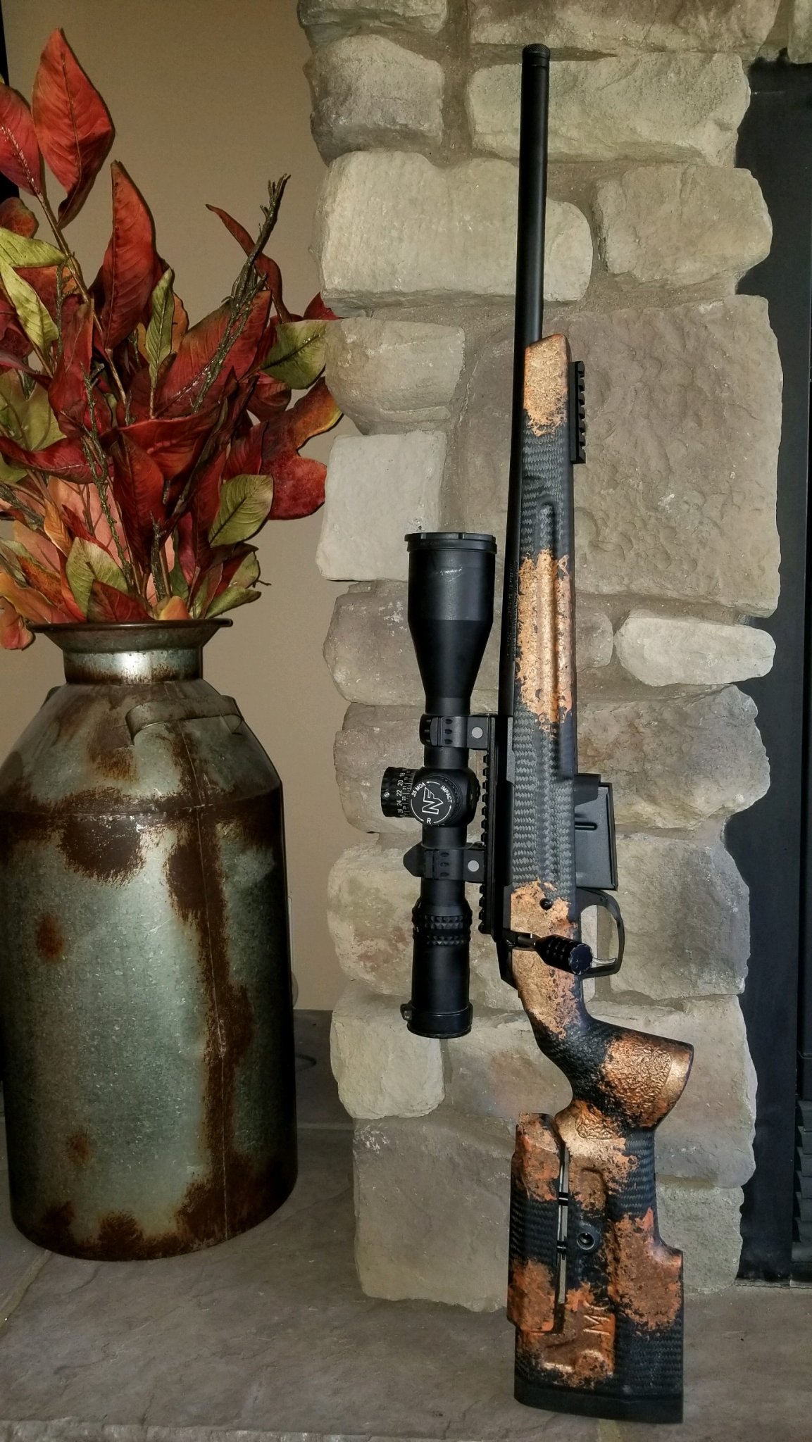

Hey Y’all! So I have decided that the Tikka t3 sitting in my safe shall become my 6.5 PRC. I have the barrel, I just need to find the stock. I’m leaning toward a McMillan Game warden, but Manners is always an option. Anyone have any thoughts or even a lead on the matter?
This is the rifle as it sits now. It wears my first ever stock paint job.
Help a brother out!
Reactions: viking78
From my recent experience, McMillan (3-4 months) will be faster than Manners (6+ months).

I like that stock paint job, I’m about to do a blued t3x lite 223 myself so I may copy your color scheme...
I have a McMillan Game hunter edge on my CTR with 17” barrel. I like the look and feel of it, that rifle is about 10.5# all up with a can now in that stock. I like the high non adjustable comb and cheek piece, but of you don’t like cheek pieces the game warden might be the way to go.
https://mcmillanusa.com/product/game-hunter-tikka-t3-t3x/
A Manners eh1 would make a nice handle for a tikka build also

I run Mcmillan stocks on all my remingtons and tikka's. I've bought manners in the past but I've returned them all after I received them due to barrel channels not cut straight, DBM inlets not centered, paint missing in alot of areas. Not bashing Manners as my buddy has never had any issues with them, just sharing my experiences.
