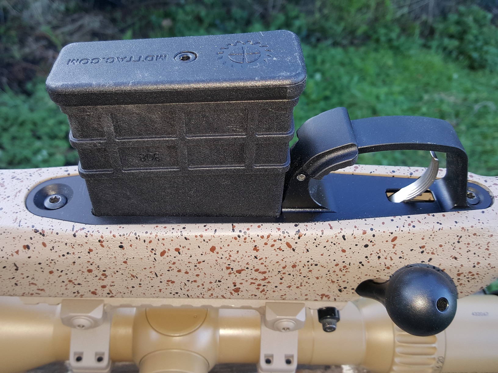

Has anyone tried the MDT polymer mags in their tikka yet
Plastic 223 and 308 work fine with a T3, at a push even work in the CTR floor plate.
I use Atlasworx CTR footprint AICS or the older Atlasworx AICS type floor plate.
edi

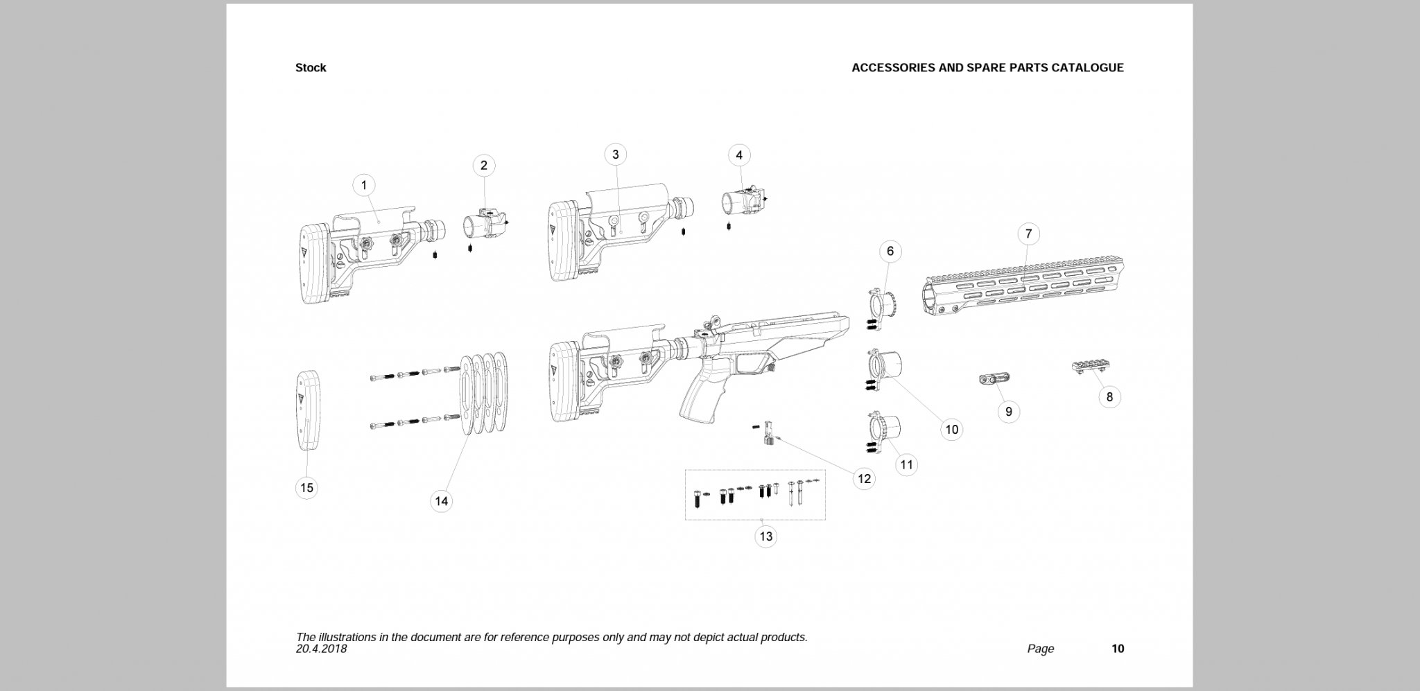

Can anyone tell me if this is a barrel nut on a Tac A1? Part # 10, Had a friend buy a chassis from a guy here on the hide and didn't get the # 10 item. Was told you could drop a Ctr barreled action right in the tac a1 chassis.
That's just the sleeve that is used to attach the hand guard to the body of the chassis not a barrel nut.
The Tac A1 uses the same barreled action as the CTR

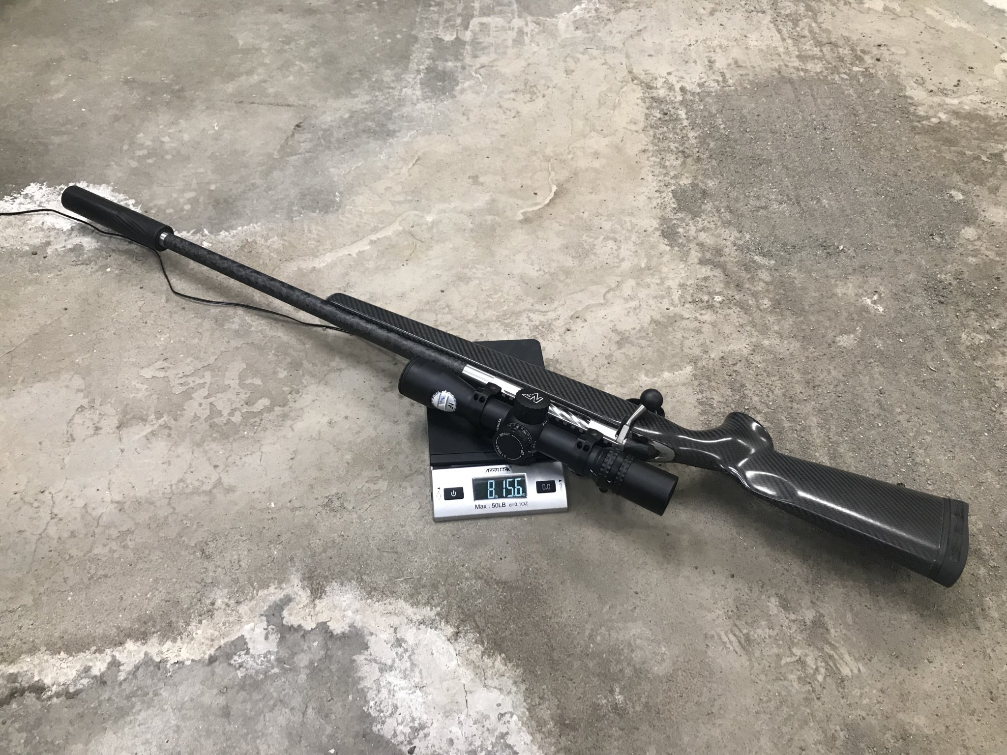

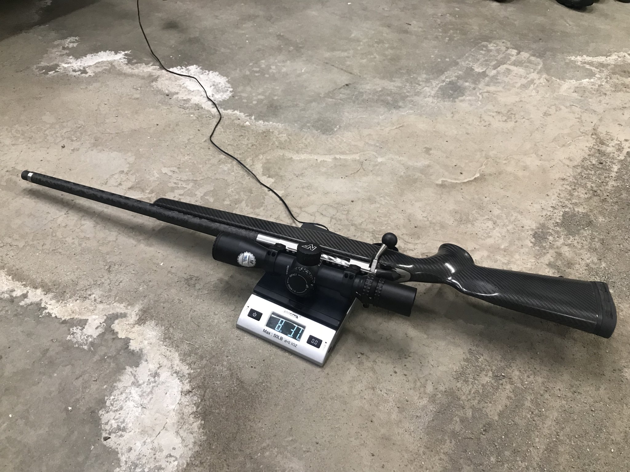

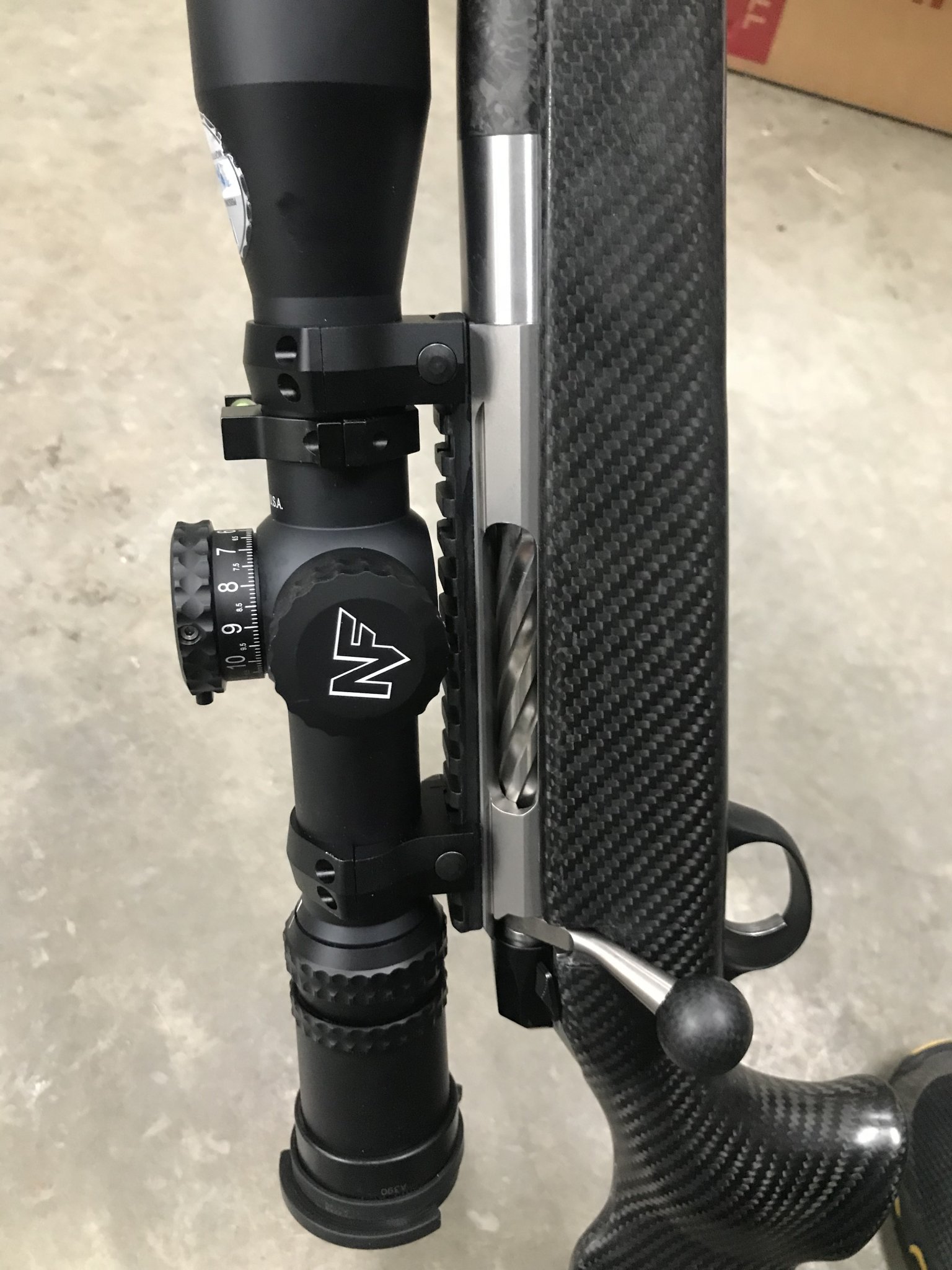

Well it’s all done...for now.
Just one 6 pounds even with a 20 moa pic rail, just under 8.25 pounds with 4-16 NF ATACR, and just under 9 pounds with an TBAC ultra 7 on there.
After barrel break in initial load work ups showed it likes 212 eldx with a nice flat node around 2860 fps which isn’t to shabby from the 22” proof barrel.
Bare rifle:
With the NF 4-16 on there:
And of course to SHHHHH the beast :)
