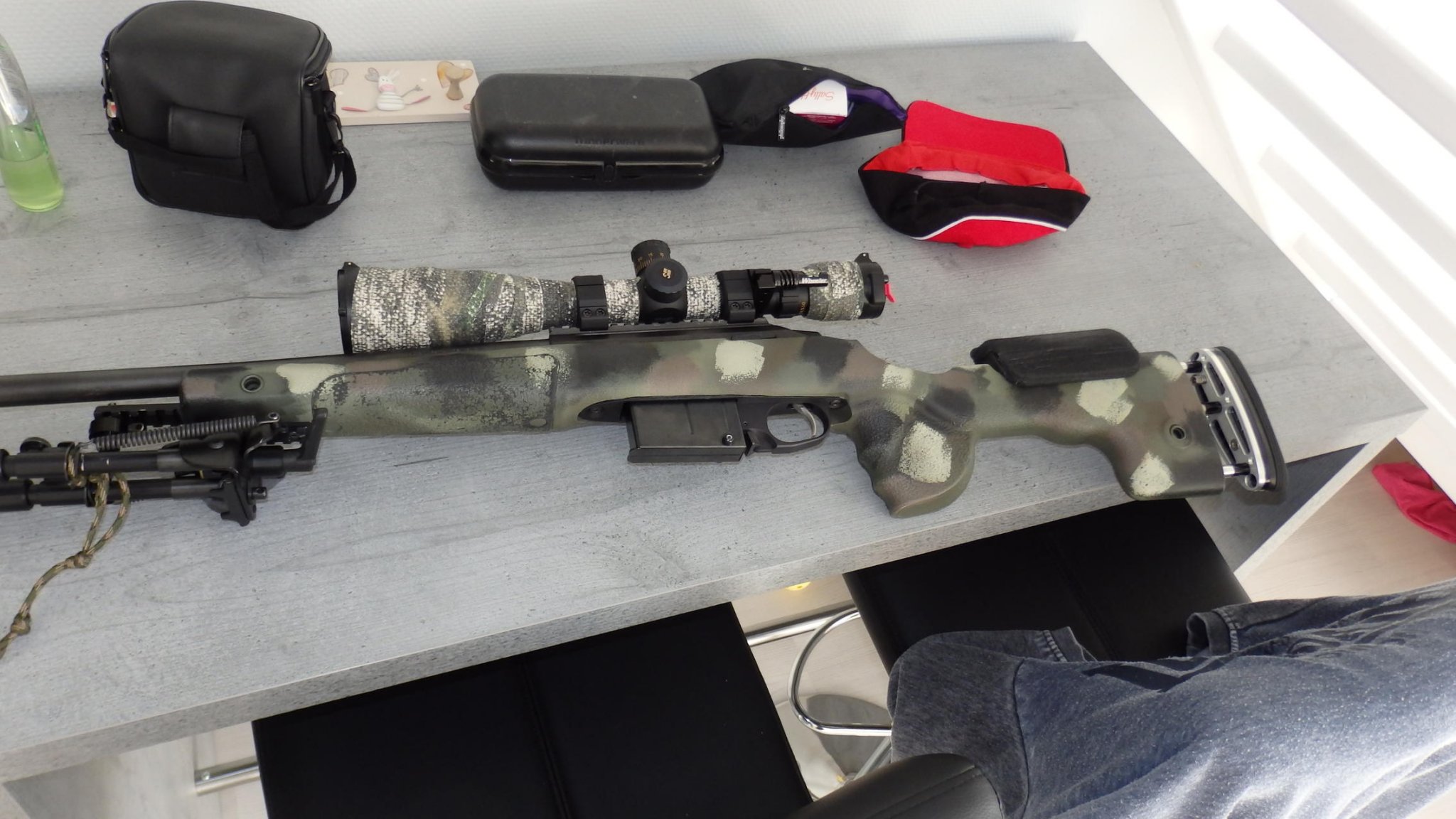

New grayboe stock came in, thought I'd post a picture of it. Also have a manners t6a and the original stock just laying around....

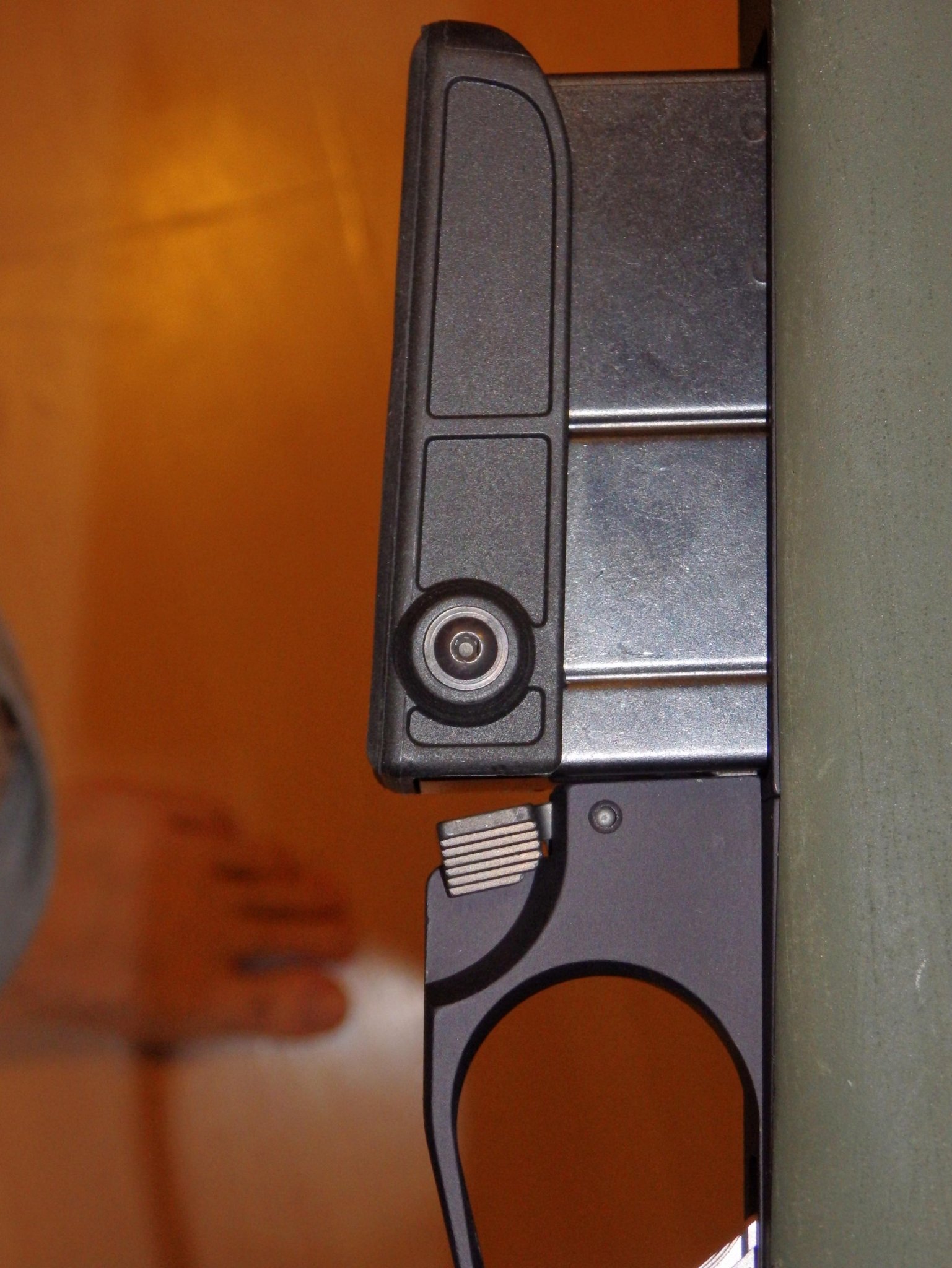

It seems that the ctr/tac a1 magazine just a poor quality steel on the follower spring.
When i had my first T3X CTR, i did noticed that poor magazine, tryed it for couple times, and bought TRG original magazine from SAKO.
Never had any issues with the TRG magazine, you can not even compare Tikka magazine to TRG, material are totally different quality.
I did strip the CTR magazine in to a pieces, and re-assembled it so, that i made threads on the rivets place in the magazine, so that i could take it a part and strech
that soft follower spring, when it started to show weaknes, and it was s--t in the begging, so i did not used it for a long time.
With the TRG magazine it was pleasure to handle.
But TRG magazine is gold on the price, holy smole.

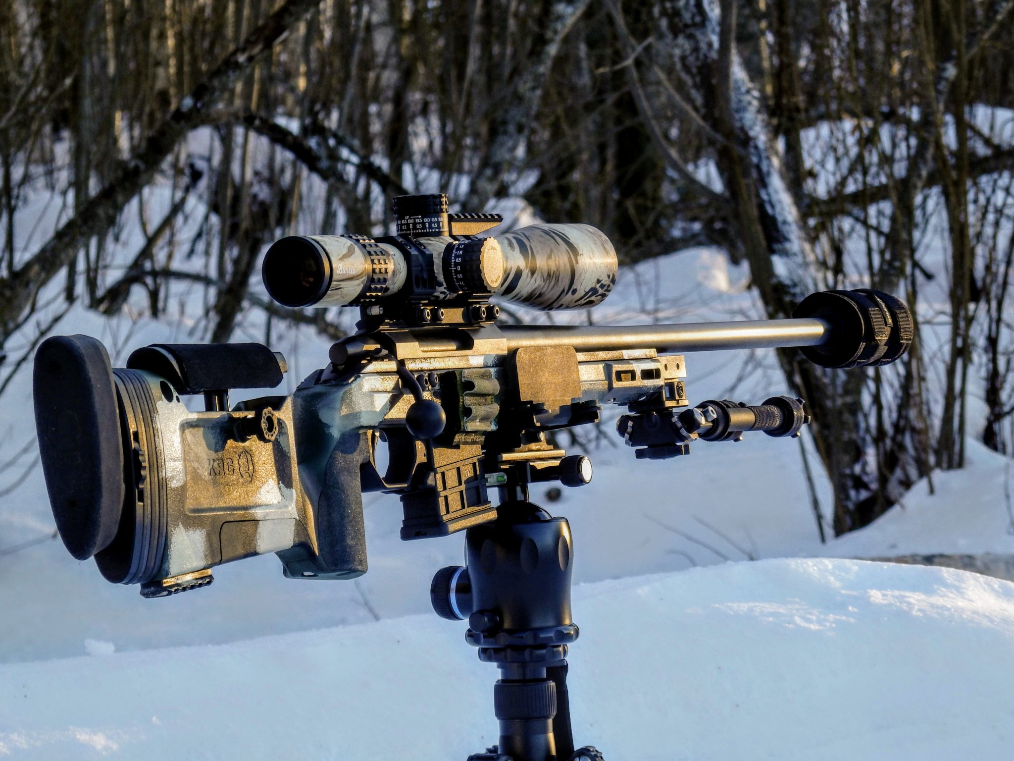

Now with KRG chassies i use MDT AICS style magazines i have zero errors on feeding and these are cheap, really like them.
Interesting. I just ordered a TRG magazine (since Beretta stole my third mag anyway). It didn’t occur to me that they’d be different.

Yes, after reading your comment above I ordered the TRG-22 mag from EuroOptic. I am hoping there is a difference.
I bet my ass off, you will know why you payed that extra ;)
Sako TRG is build to military specs, Tikka might not as that tight tolerace, or it would be a hard compeater to TRG.
So you need to do some job there and here.
Not meant to say, that the Tikka mag would be total crap, but it is not the same as the TRG is.

So I ordered this yesterday and it arrived today. I ran some rounds through the TRG mag. You were right. No feeding problems. Now I just have to face the sticker shock when I buy a second one!
