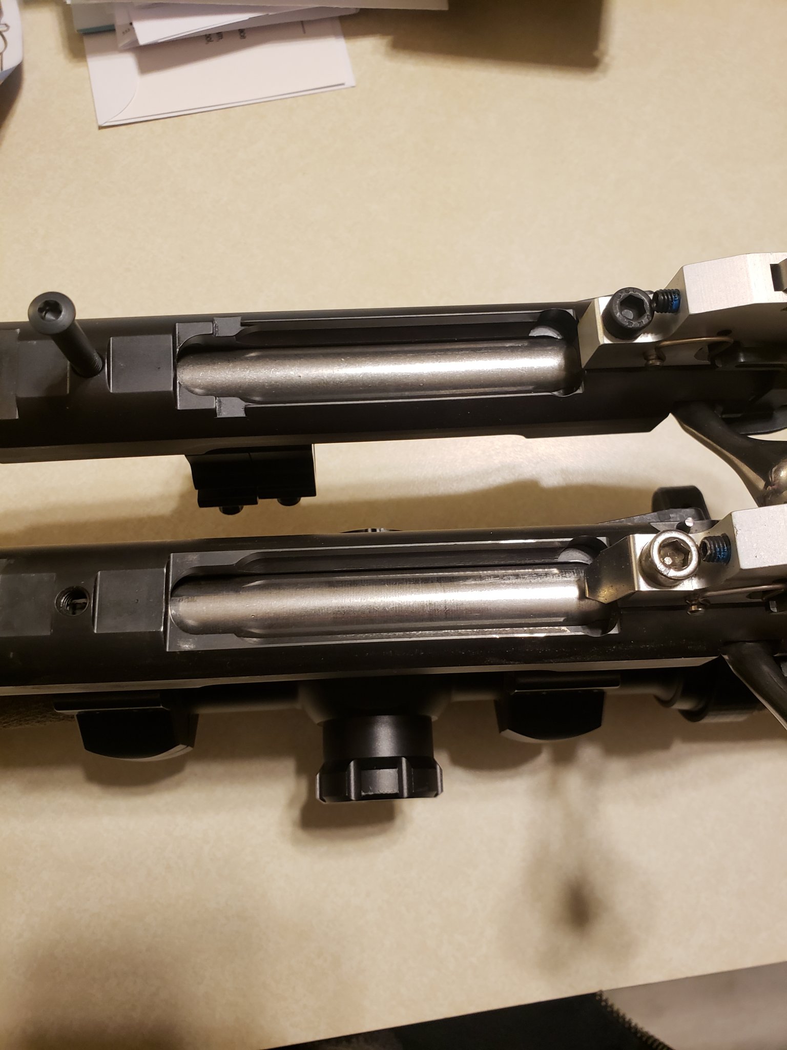

The bottom action is my varmint and it doesn't have the slot that my CTR and other T3 has.

It can't be a CTR as they just started making those in .223, so it is probably a Varmint that has been cut off. Is it a 1-8" twist? All Tikka barrels are hammer forged, so it could be a spot that didn't get hit as much. Shoot it and see how it does. If it is a 1-8", it should like the 75 ELDM. Mine is a hammer with them at 3025 fps out of the factory full length barrel.
It is a 1:8
I have load tested both the 75 and 80 and the 75 does real well with Varget. What’s your distance from the lands?
@260284 do you mind getting a measurement of your varmint barrel right behind the threads?
It is a stamped tikka bbl I will measure though and look at the bottom of the action. Not too sure if you’ll be able to tell as there has been quite a bit of material removed on the bottoms to make the bottom metal and mags fit. It is a little rough under there. I’ll get pics shortly the riffle is still in the truck as I just got home from using it at the Pawnee club match.
