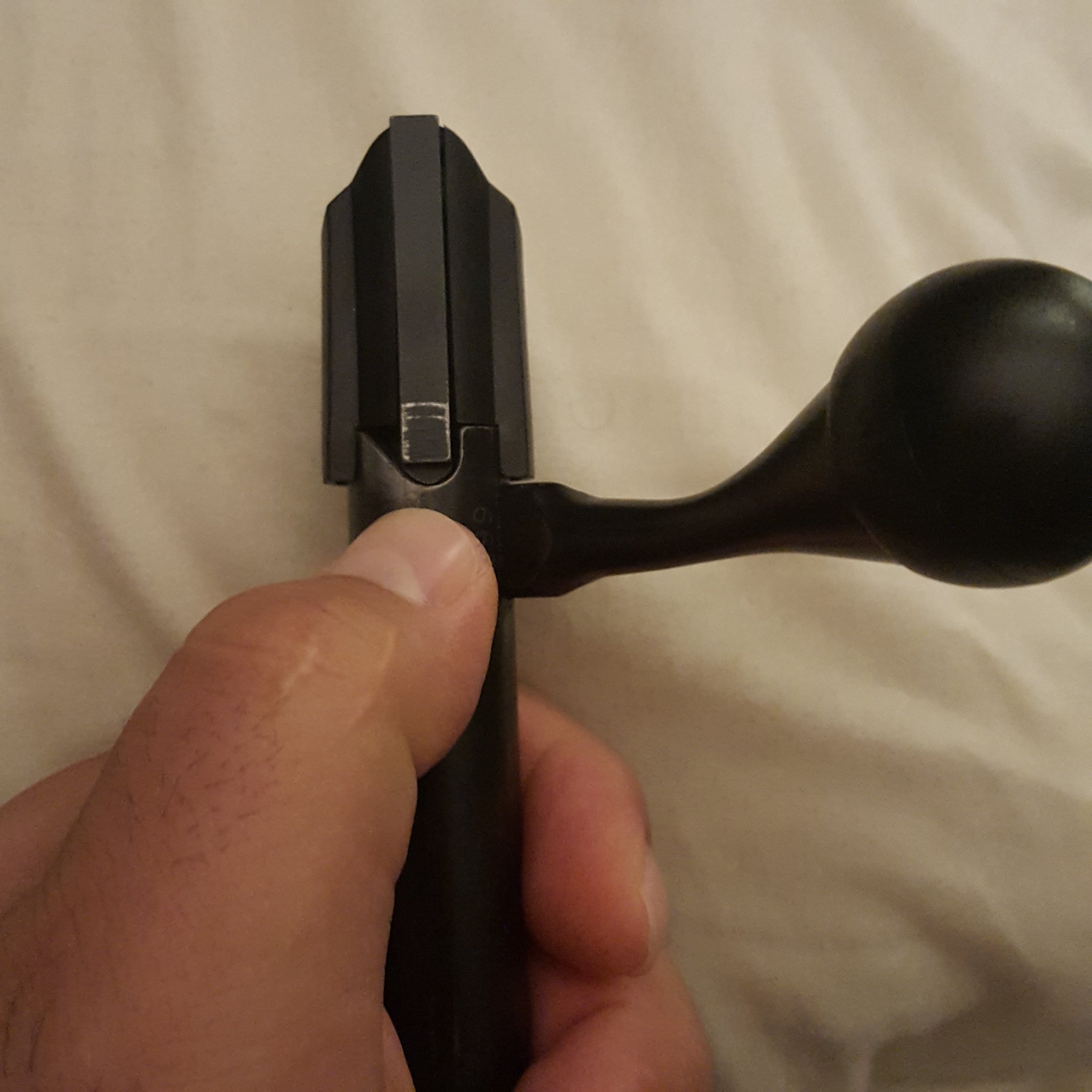

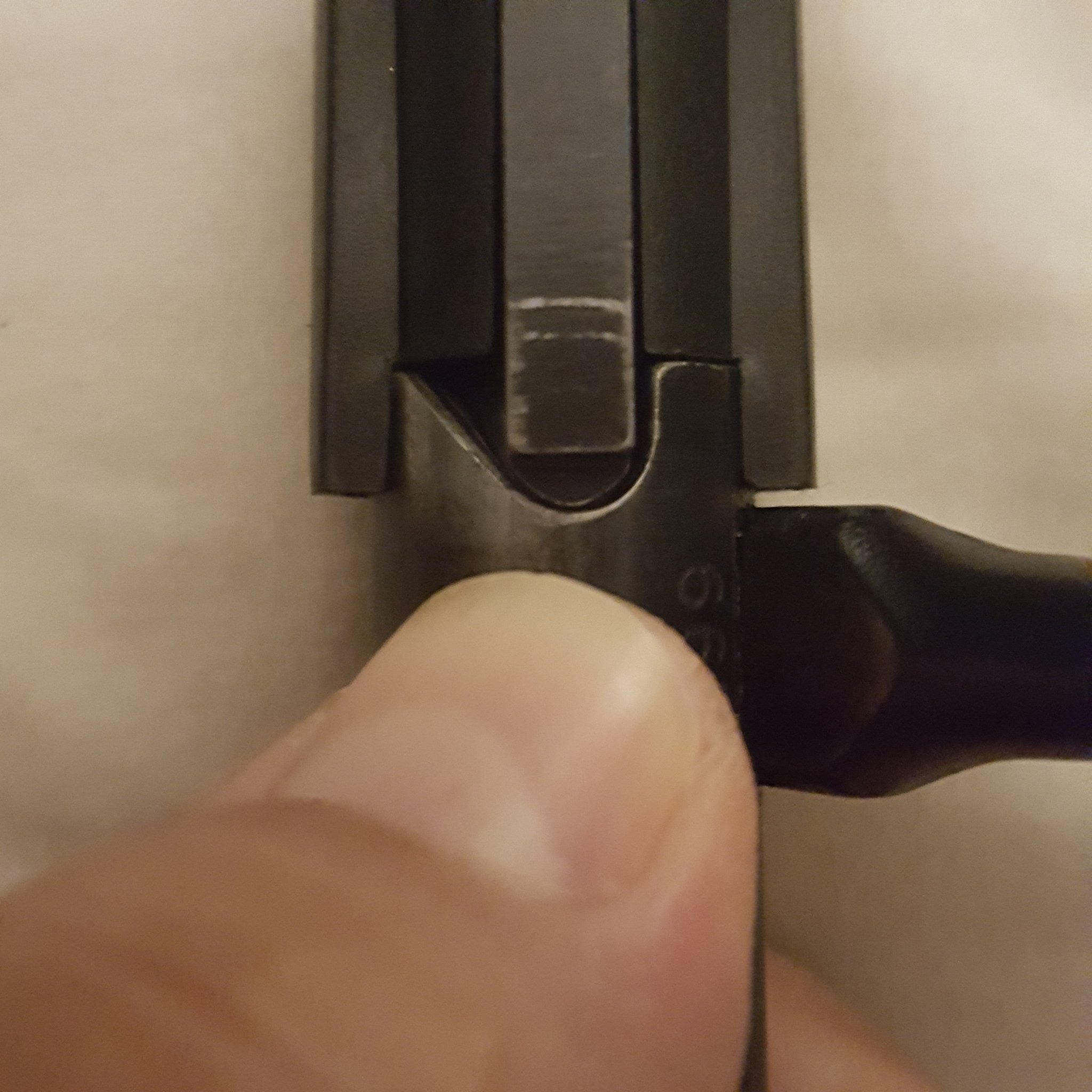

I had that problem with a 2015 model CTR. I polished the cocking surface that interfaces with the firing pin. Use an emery cloth or a dremel polishing attachment until there is no more stickiness/gritiness to the bolt. Lubricate well after and you should be good to go. If you need a picture of the surface let me know.
I would love a picture. Thanks!

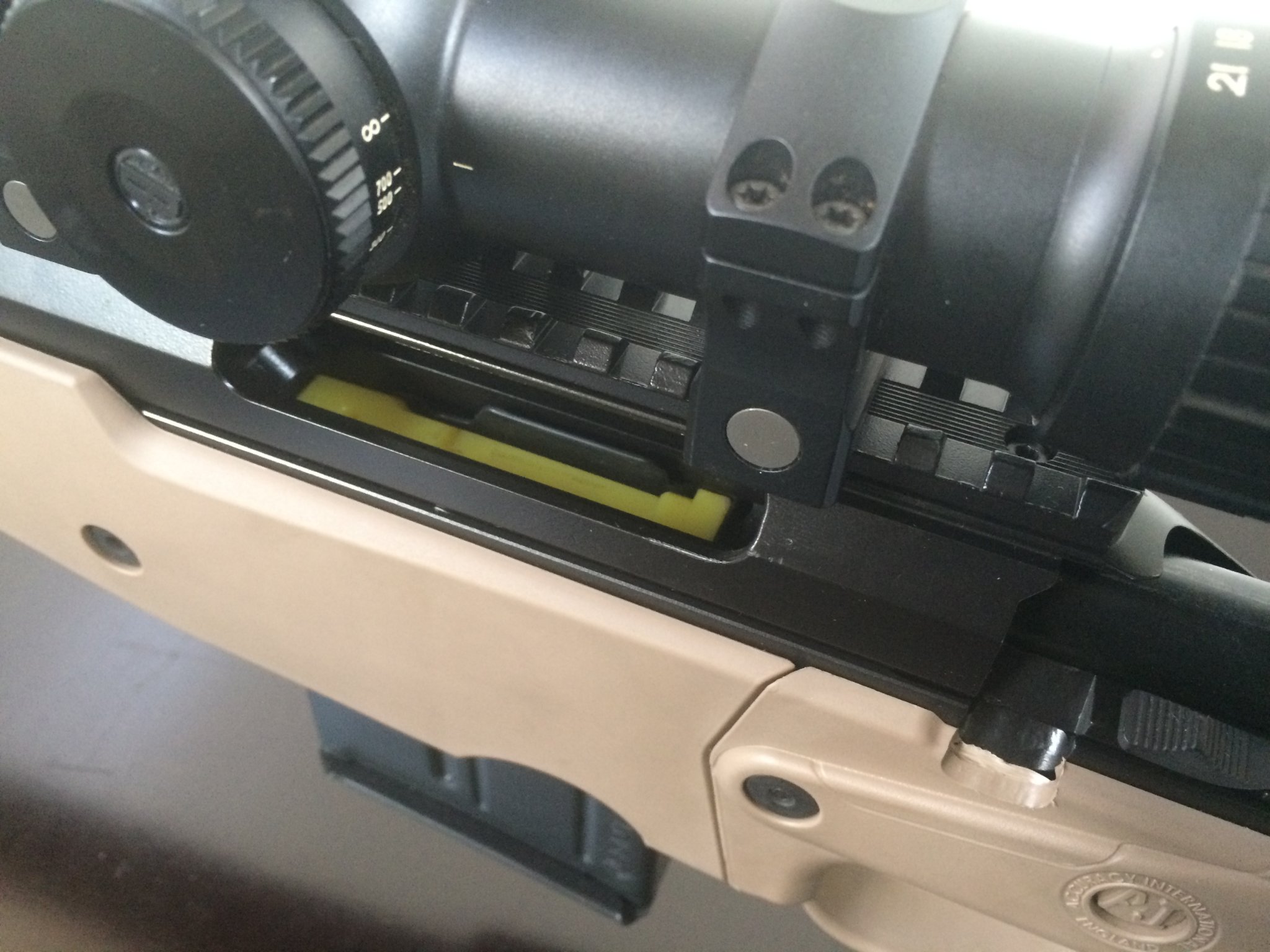

Where my thumb is...polish the pin bearing surface and the bolt surface. You can see silver instead of black where I over polished a bit. Just make sure they both have no burs or any areas that catch. Removing metal is not really the goal...just smoothing and getting a better surface finish.

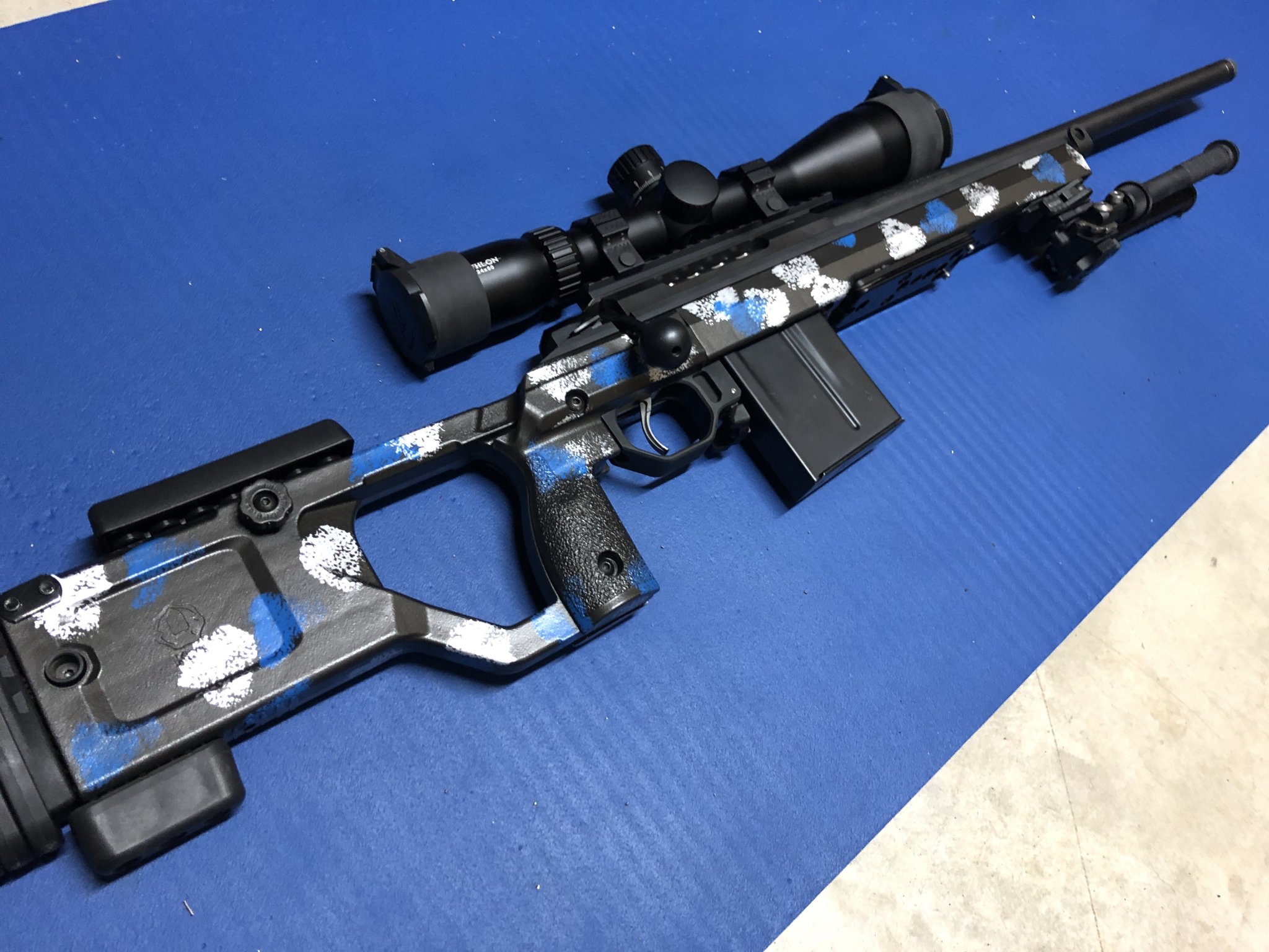

Sweet looking rig you got:cool:.

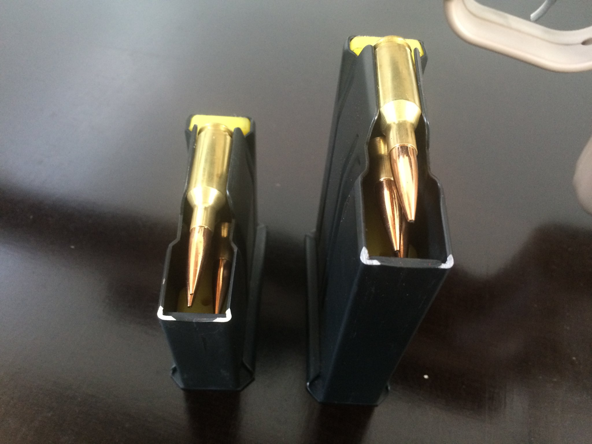

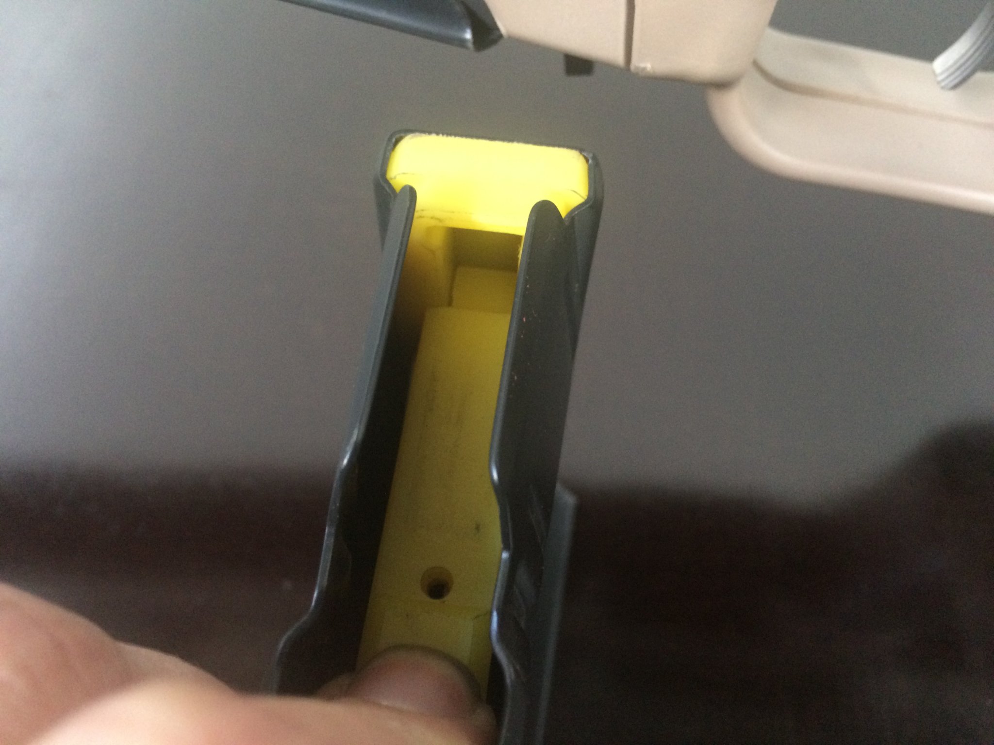

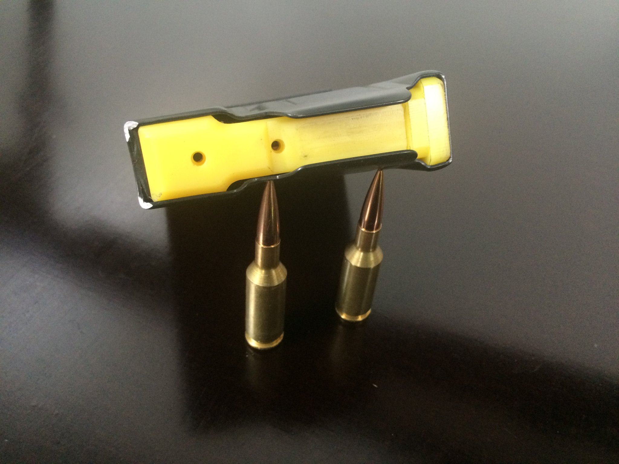

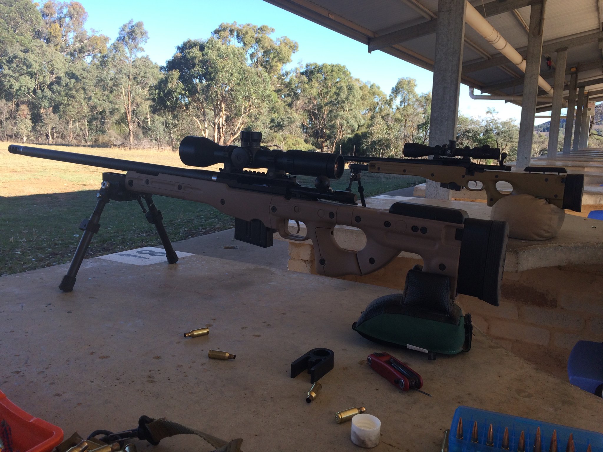

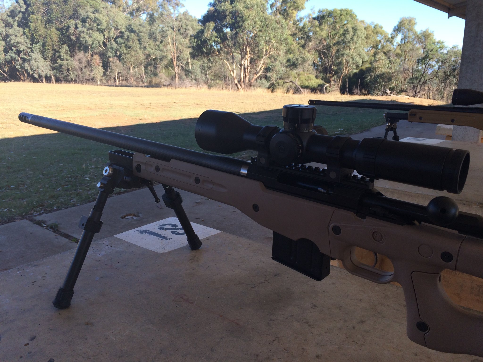

How did you do those followers and that spacer to the magazine?
Thanks, I tried a few different stocks but realised I really like the AICS more.
I cnc milled them out of some oil filled nylon sheet I had here, the 5 round needed a little hit with a dremel to clear the ribs on the mag which are different to the 10 round one so I added that to the drawing for the next one. It took a lot of measuring and CAD and a few runs in the mill to get the profile right but they work really well. My 3d printer is a basket case so I ran them in the mill. I'll order another few mags once I run these for a while and make sure there's no issues.

I've used the AI plastic 223 mags before as well as the 5 round magpul ones for a 6BR Remington and Howa but neither fit well in a Tikka.
A couple of little jobs still to go, I'll fit a Sterk swept handle and shroud and make another brake that fits a little neater then cerakote the shiny bits.

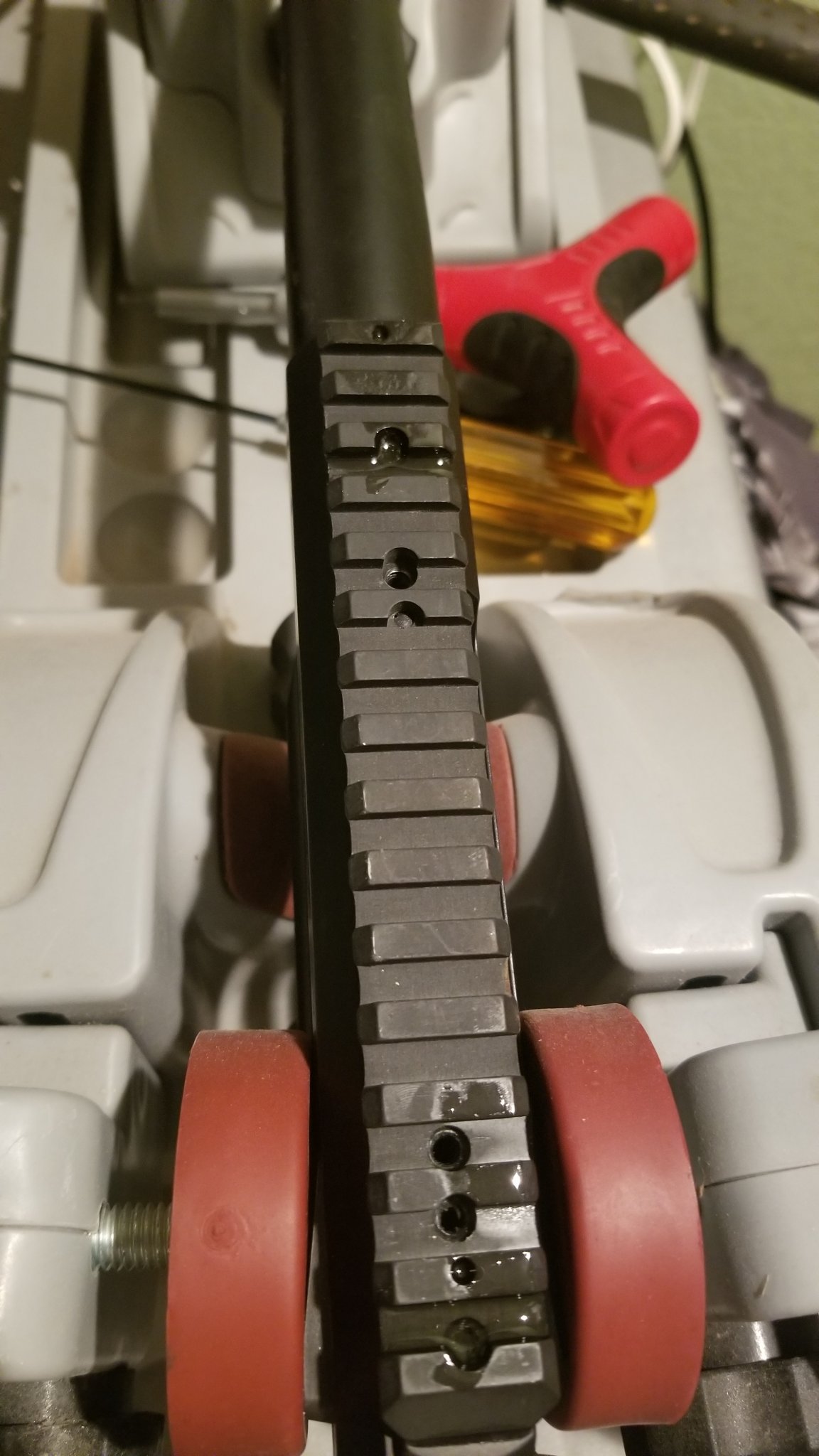

I'm not counting the mirage band screw. Look at the picture. 2 up front and 3 in the rear.
My mistake, usually people ask about the mirage band screw. When Tikka updated the T3 to the T3x, they added an extra screw hole for the scope bases. Other than the extra 5th screw, the scope bases remained the same as far as screw spacings go. It's why the aftermarket scope bases work with both the T3 and T3x. In other words, it isn't a must have or anything.

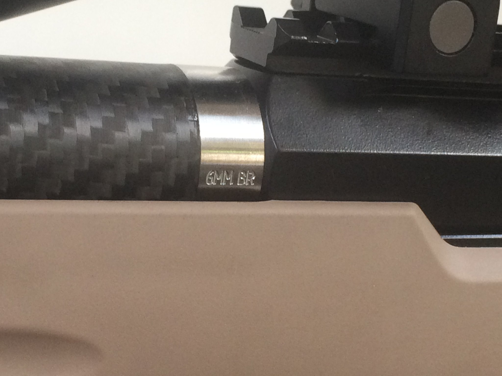

I took mine to the range today to give it bit of a run. All seems good just running the load and seating depth I use in my other 6BR which makes it easy (same reamer, same twist rate). I didn't take the chrono but it's a little faster with 4" more barrel, .1 mil less elevation at 500m. I actually ran the barrel in which is a first, shoot then clean for 10 rounds. The second 5 shots at 100m below which I was pretty happy with given a clean between each one:
7053330
All the cleaning was a bit of a waste, no copper came out so I think it's good to go now. Hardy make a very nice barrel. This is my first Tikka, I've got a couple of rifles on Tac 30 actions but this thing is so much smoother to cycle! Mags worked brilliantly, no misfeeds at all.

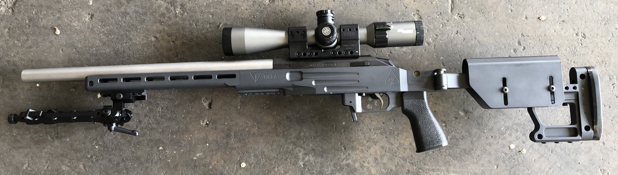

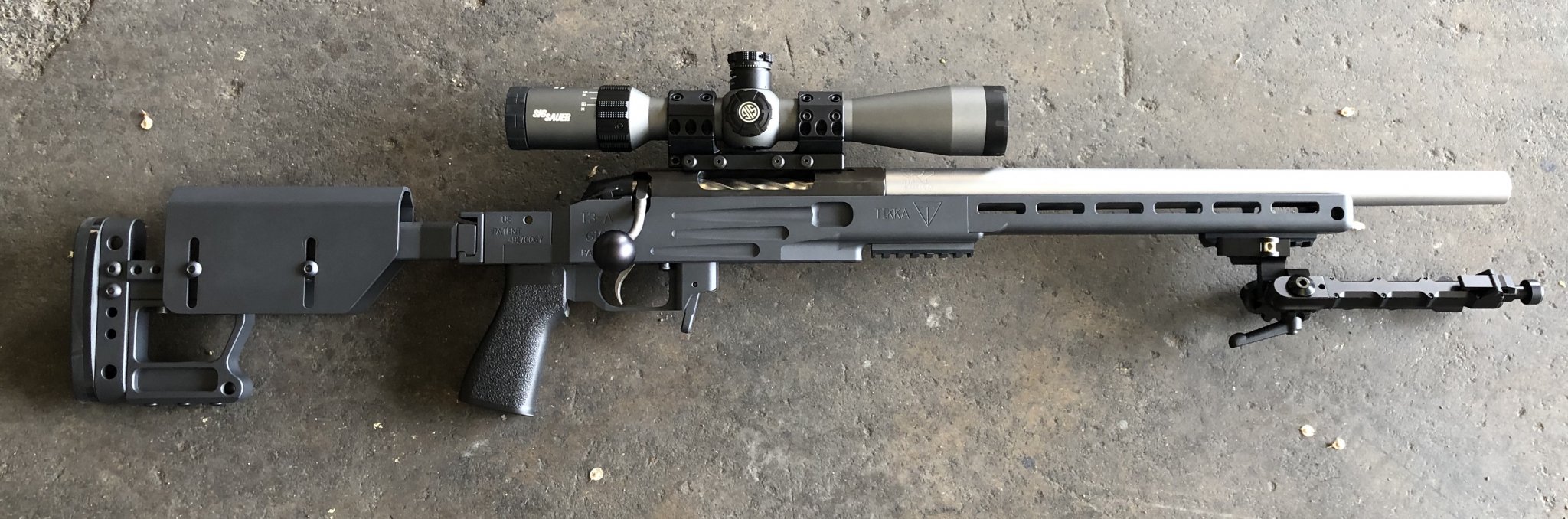

The mccrees that is
The cheek piece is actually effective I have the G10, but have the magpul prs on mine. Honestly, if I had to do it over, I would have gone with the McRees rear end. The chassis is well balanced though with my 20" CTR. It is solid, takes a beating, uses the TRG mags well and has a really good lock up mechanism in the folding stock. I highly recommend it.
