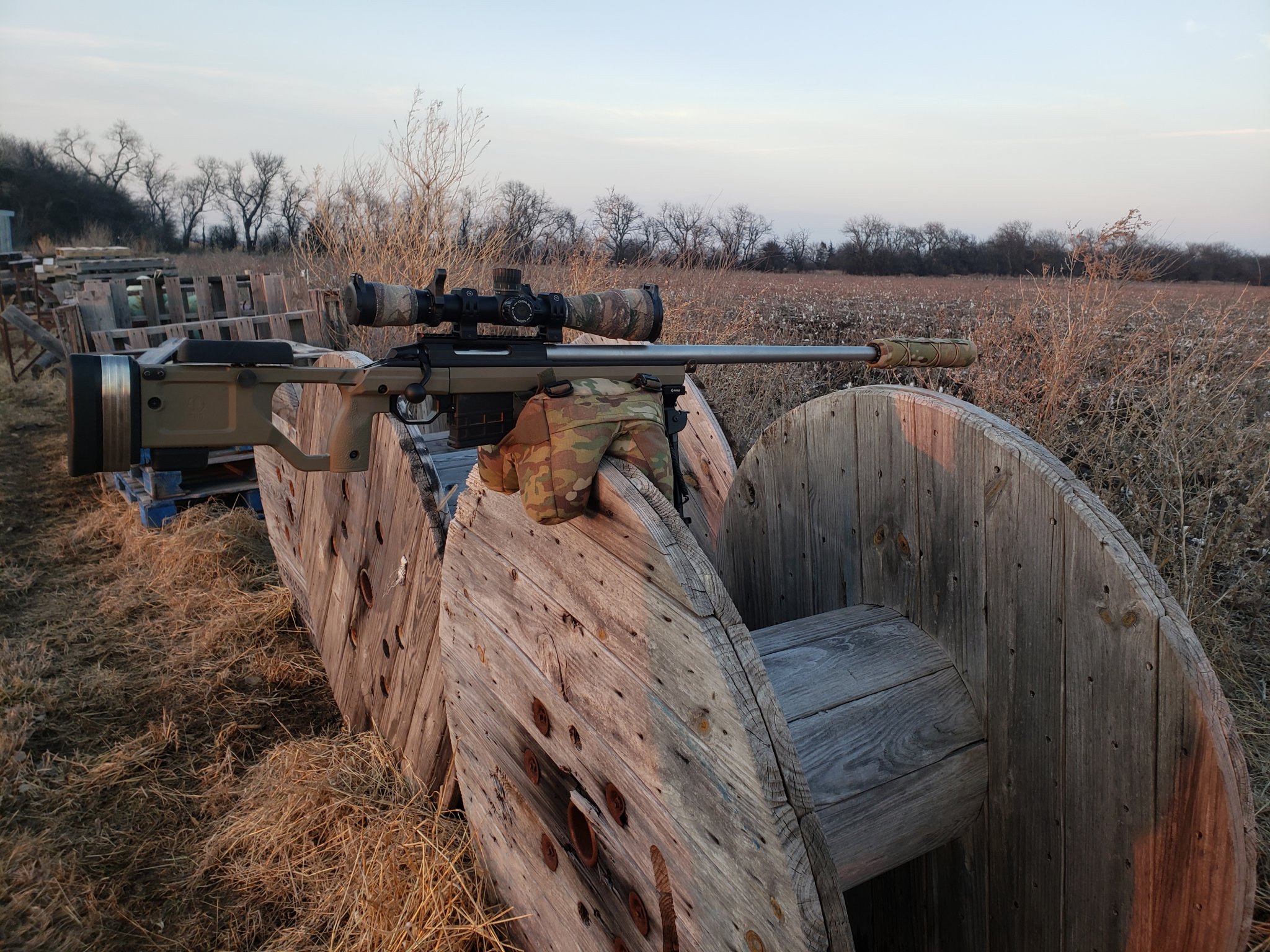

5-25x50 is dope and Spuhr mount on that, you are on right track, i LOVE spuhr mounts, pure solid mounts, and i have not found product that could beat that quality.
I have 3 of those, 34mm mounts all.
One Bushnell DMR II 3.5-21 G3i is on the way for the third mount.

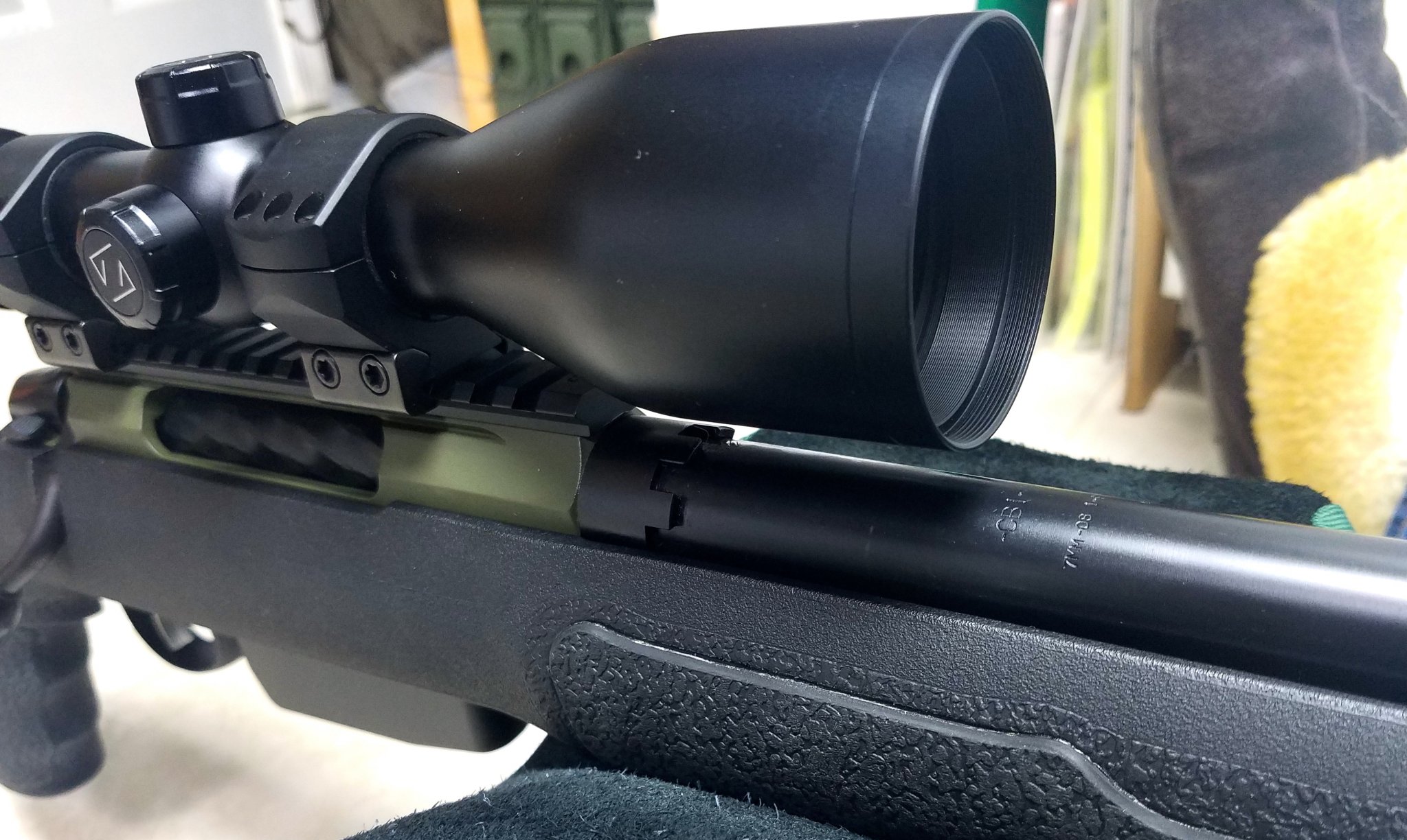

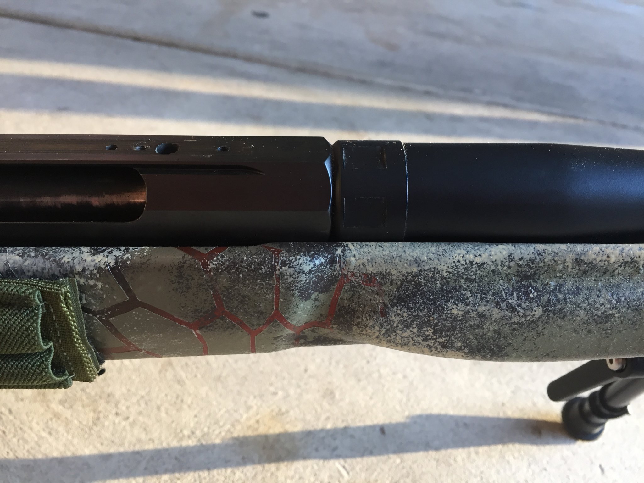

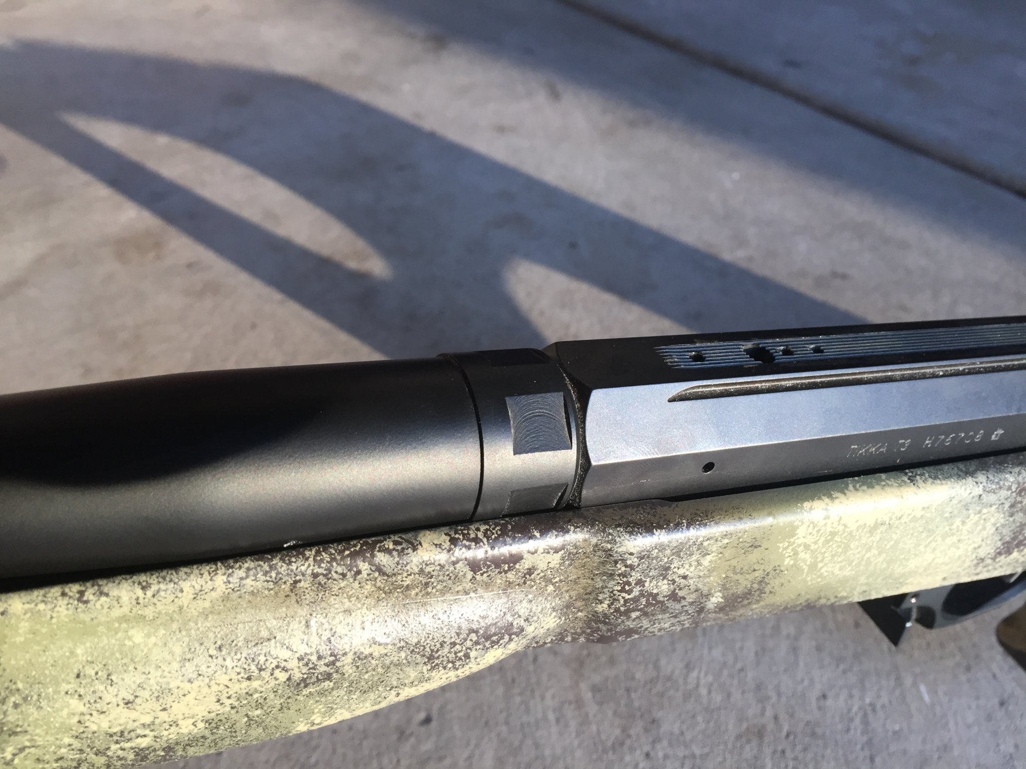

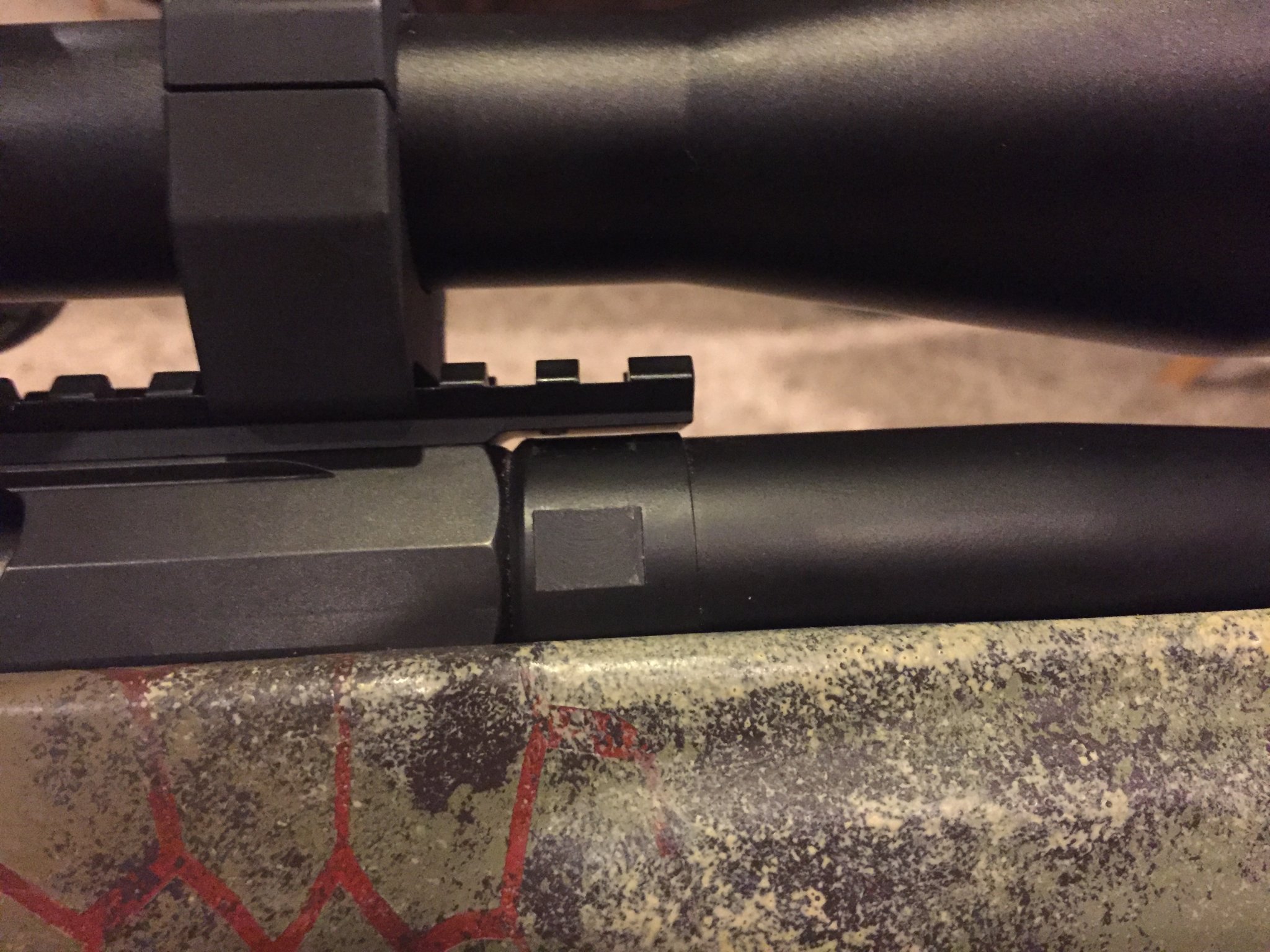

Yes, they are terrific. The barrel will have a maximum diameter of 1" at the shank so the very-stout barrel nut can slip over it. Tim includes a really nice barrel nut wrench as well. I opted for nitride.
Picture of the barrel nut below. Barrel profile is a custom medium-Palma-like contour. 7mm-08.

Pre fit should work fine. I’ve installed used 308 Ctr barrel purchased on here. Head space was perfect and it is sub 1/2 when I do my part using FGMM 175. I had a bad experience with a barrel nut coming loose during a match. Not diagnosed until I wasted 75rounds on 10 stages. Frustration level was high ?
Not an engineer but lots of mechanical experience. I’m thinking the low torque and small bearing surface contributed to the nut loosening up. Shoulder prefit with 10O lbs torque for me from now on.....

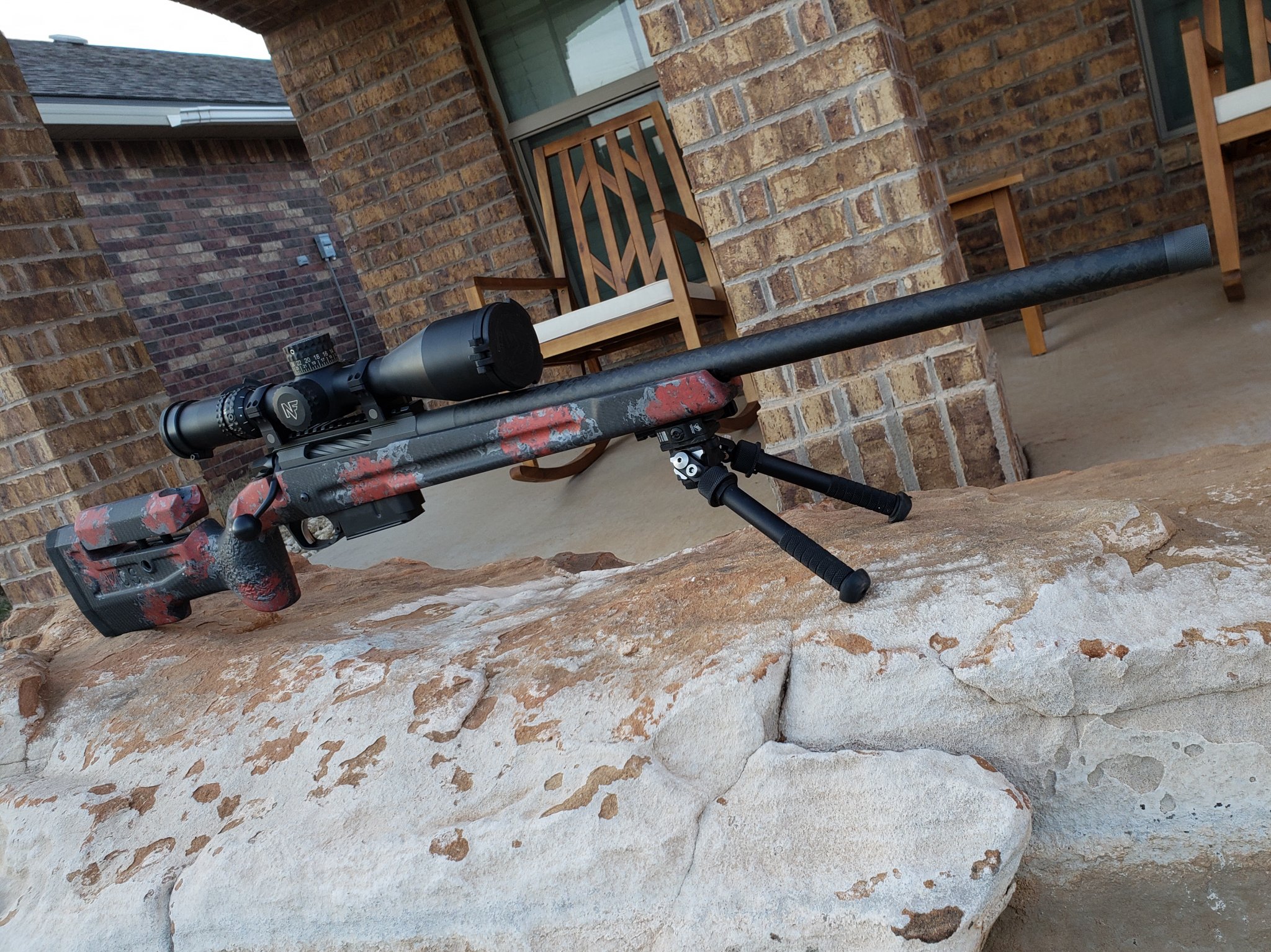

I have a BugNut barrel from SPR, it was the first Tikka he did. He has switched to a smaller nut for Tikkas and RAPs. I have had no issues with it and it shoots better than I can. The wrench is stout, you could probably pull a truck with it. I also have shouldered barrels on a couple of Tikkas. I swap a take off 20" CTR barrel with my BugNut barrel for a lighter hunting rifle. It headspaced perfect.
Never had an issue with it coming loose. I have swapped it with the 20" a couple of times with no issues.

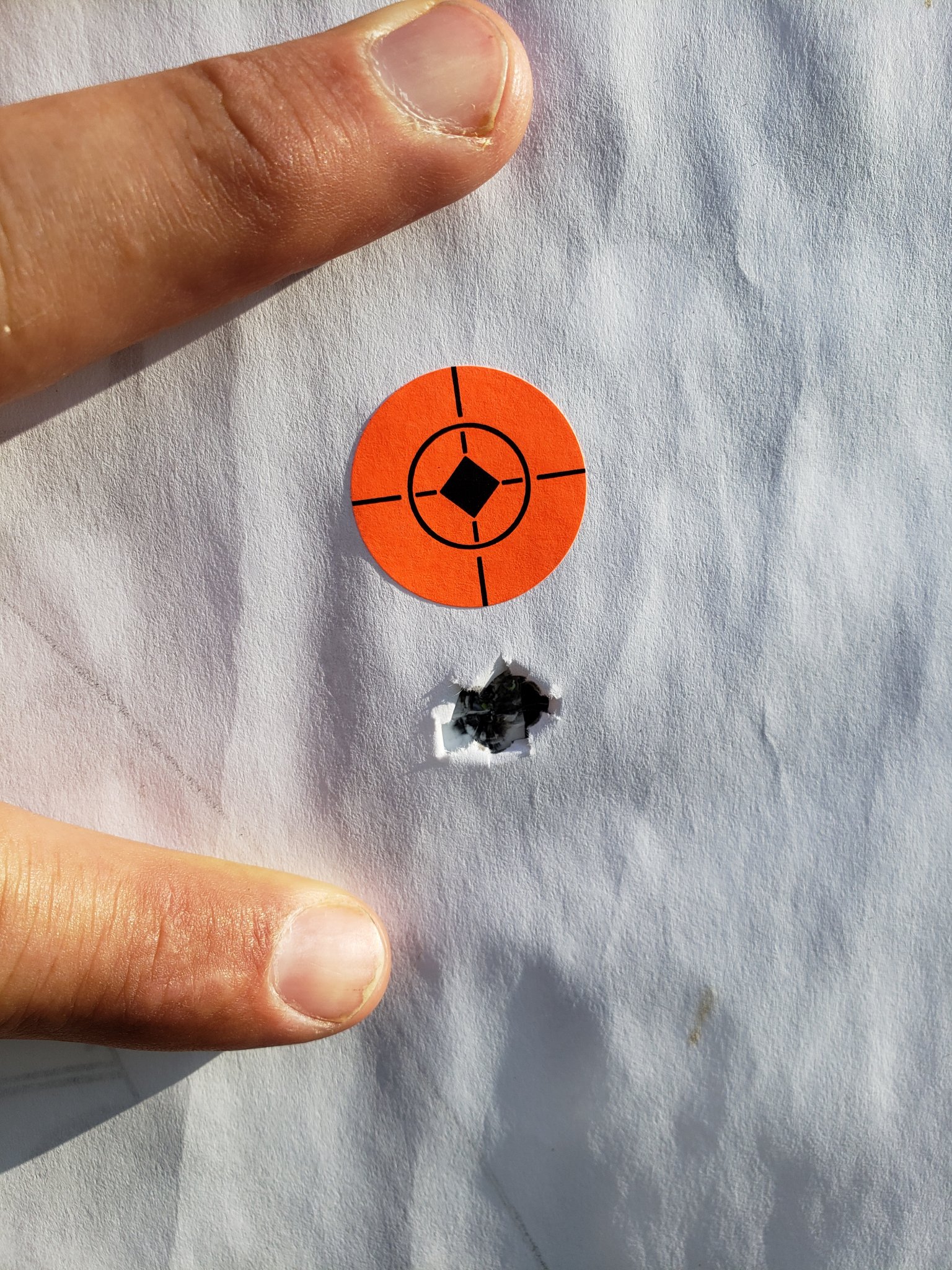

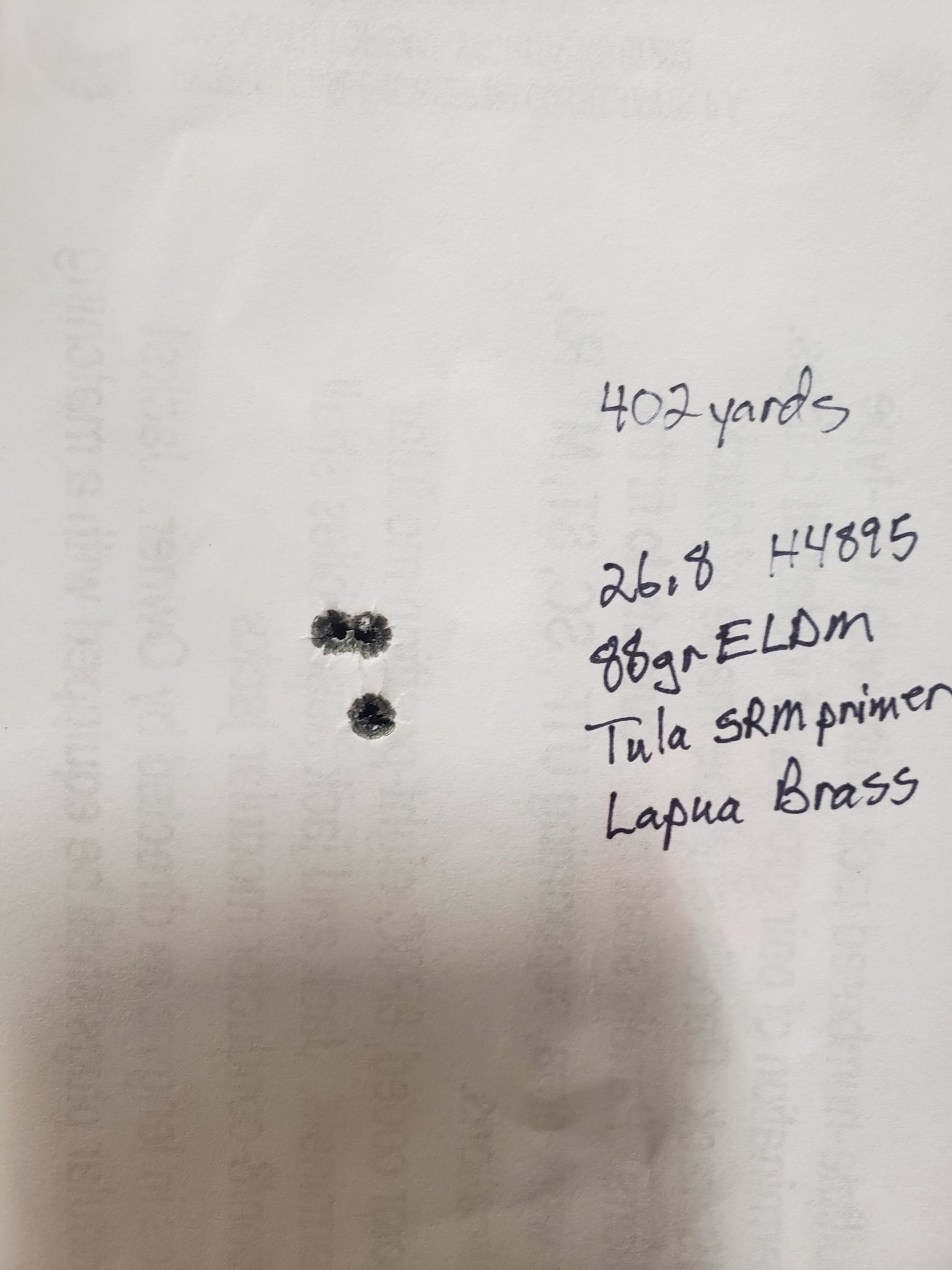

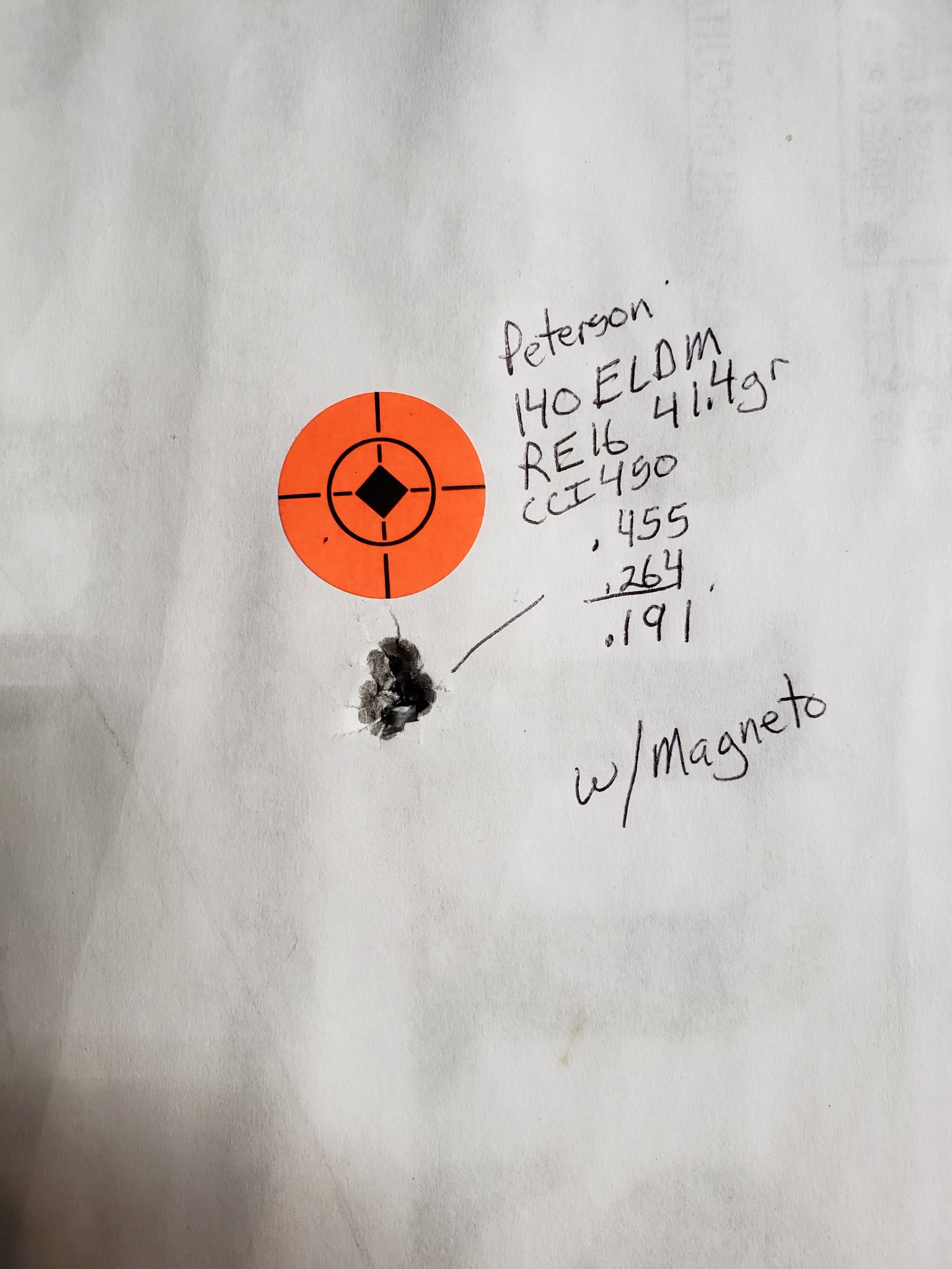

260284: What speeds were you getting with those one hole pictures above? Seems pretty light compared to the 43 grains I have settled on with the same bullet. I am at 2800 with my 24" Tikka Tac A1.
I am using Peterson small rifle primer brass in a 23.5" Bartlein. A friend is working up a load for his 24" CTR and is in the mid to upper 2700's with similar charges of Re16 and the same brass. Peterson has less internal capacity than the Lapua srp brass. Less capacity=more pressure/more velocity with less powder.

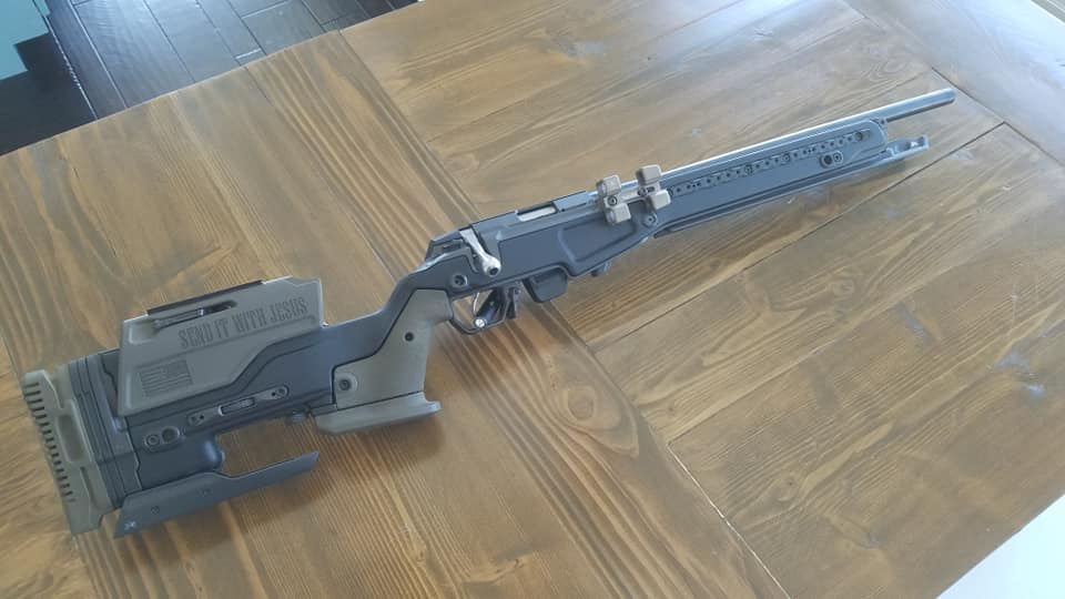

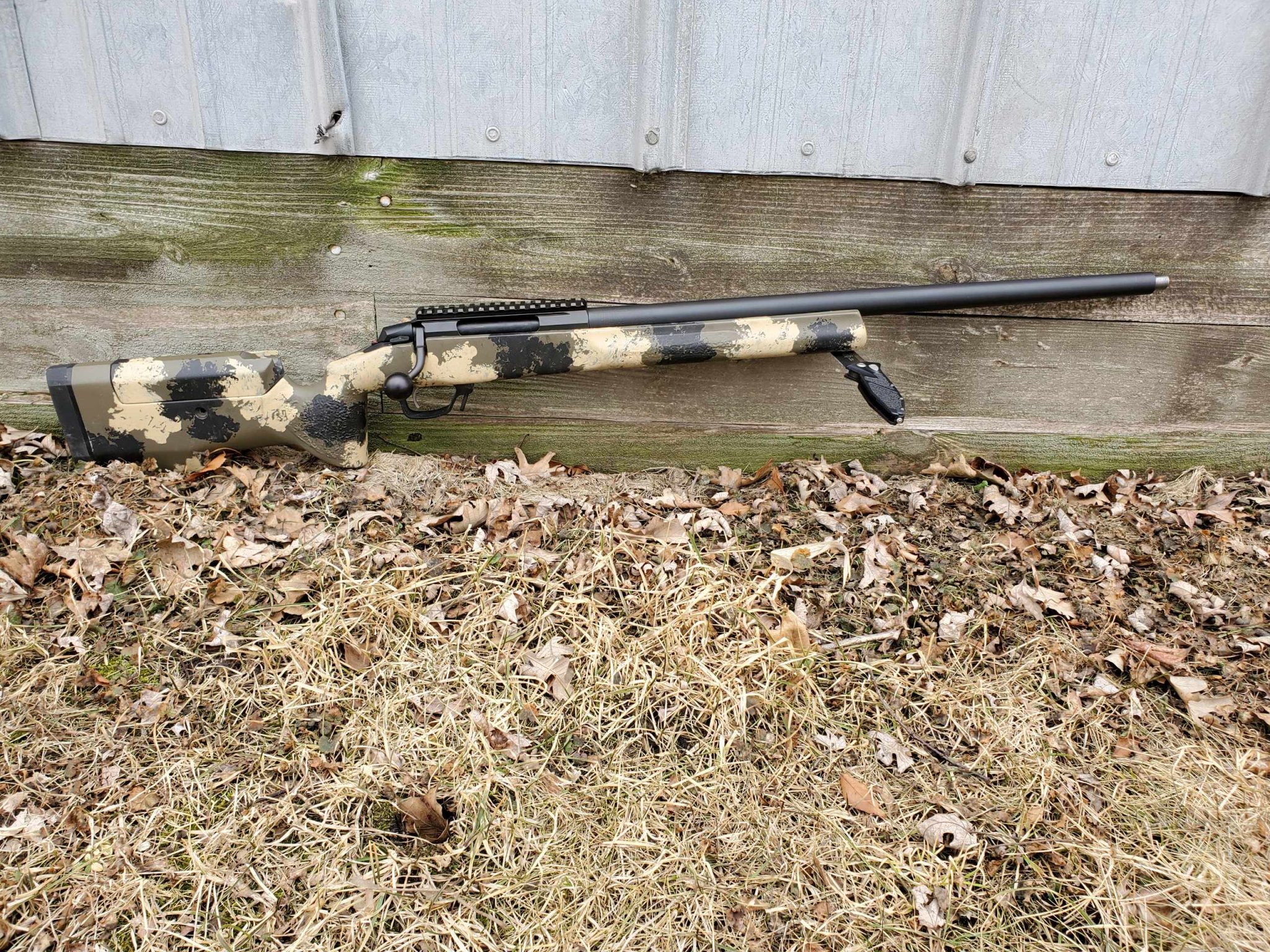

Finally got this one put together. Can't wait to get it on the range tomorrow. 6.5cm Proof barrel by Jon Beanland, the rest should be self explanatory.
Very nice!! I saw this in the Beanland thread and came over here to see if you posted it as well. Love the colors with all the CF! Did Jon flute the bolt? My Tikka just shipped from my smith, but I'm thinking about sending the bolt out to LRI to get it fluted.
LRI fluted that bolt for me a few years ago.

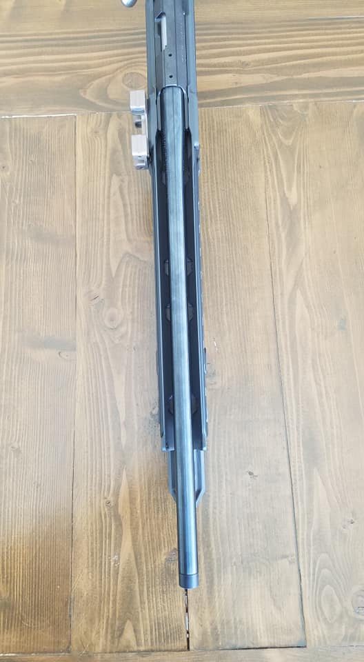

I ordered it from submoaparts.com. It’s a Zapp action wrench made by Gradous Rifles. I wouldn’t recommend trying to pull a factory barrel off (ask me how I know) unless you have a lathe where you can cut off the shoulder. I ruined my 300wm action, but repurposed the bolt anyway for a 6.5 SST build on my other action (so running two bolts with the same action for 6.5 cm or the wsm cartridge) If you’ve already had a smith put on a new barrel, this action wrench is great to take off an aftermarket barrel.
