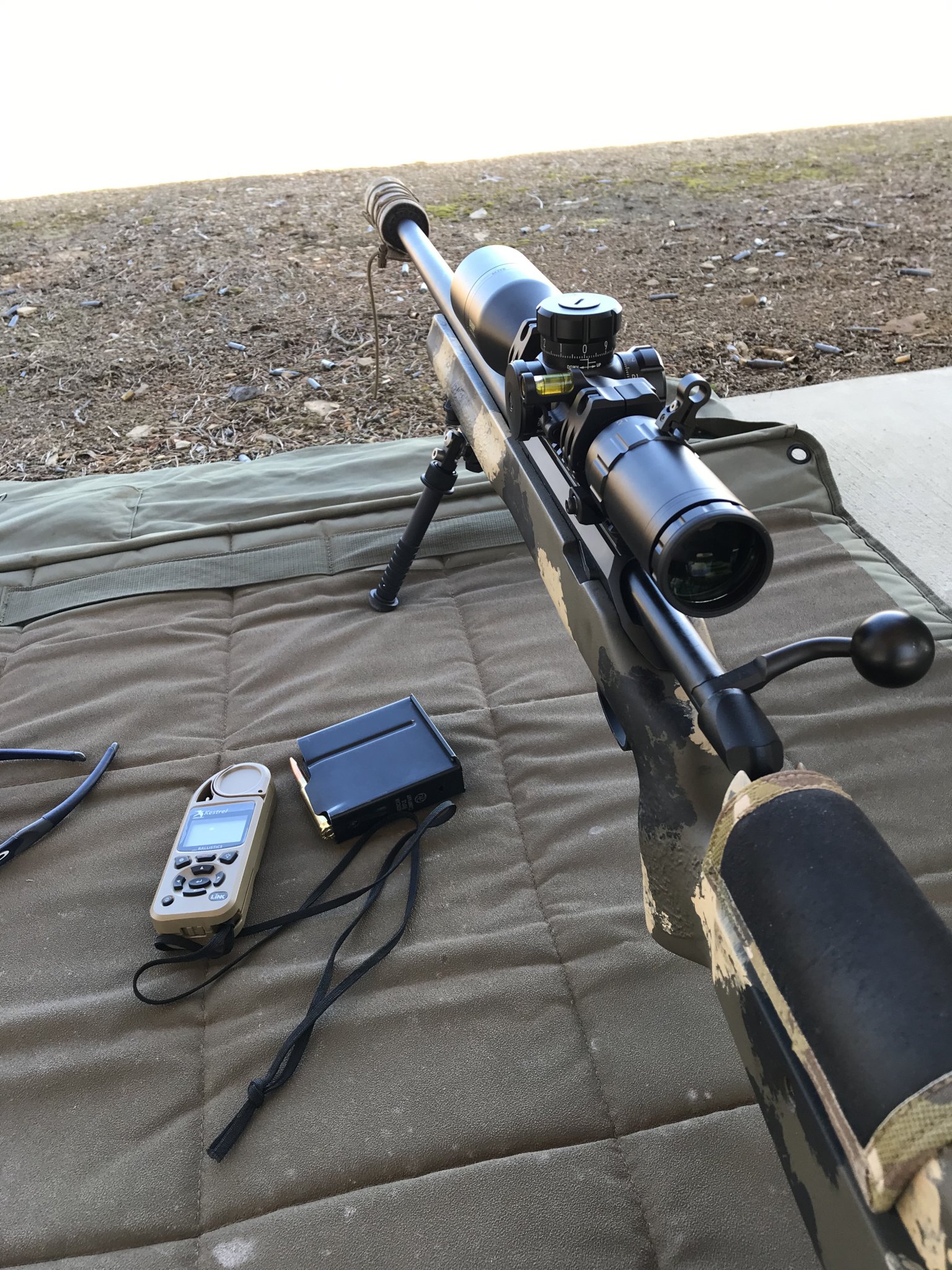

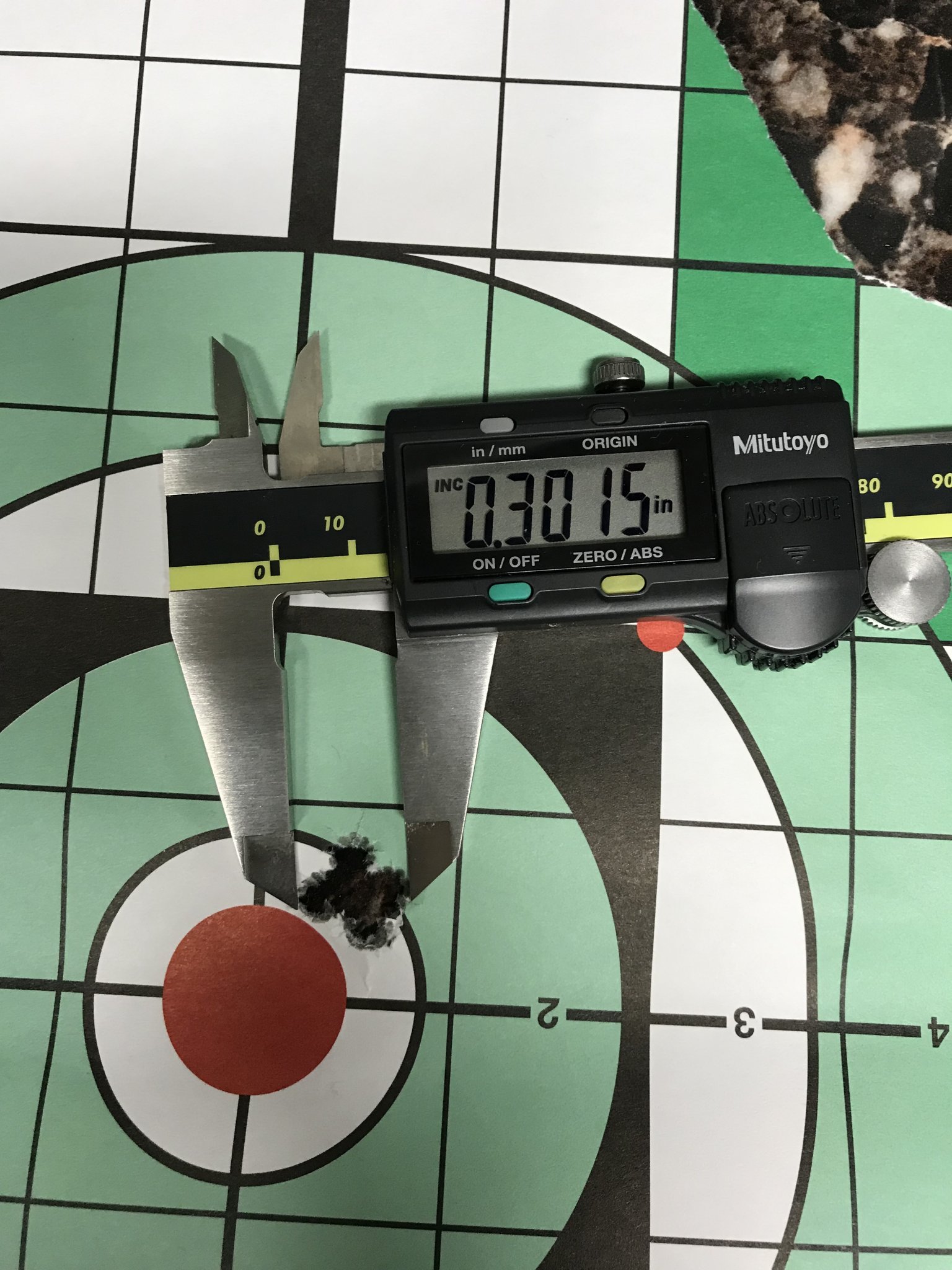

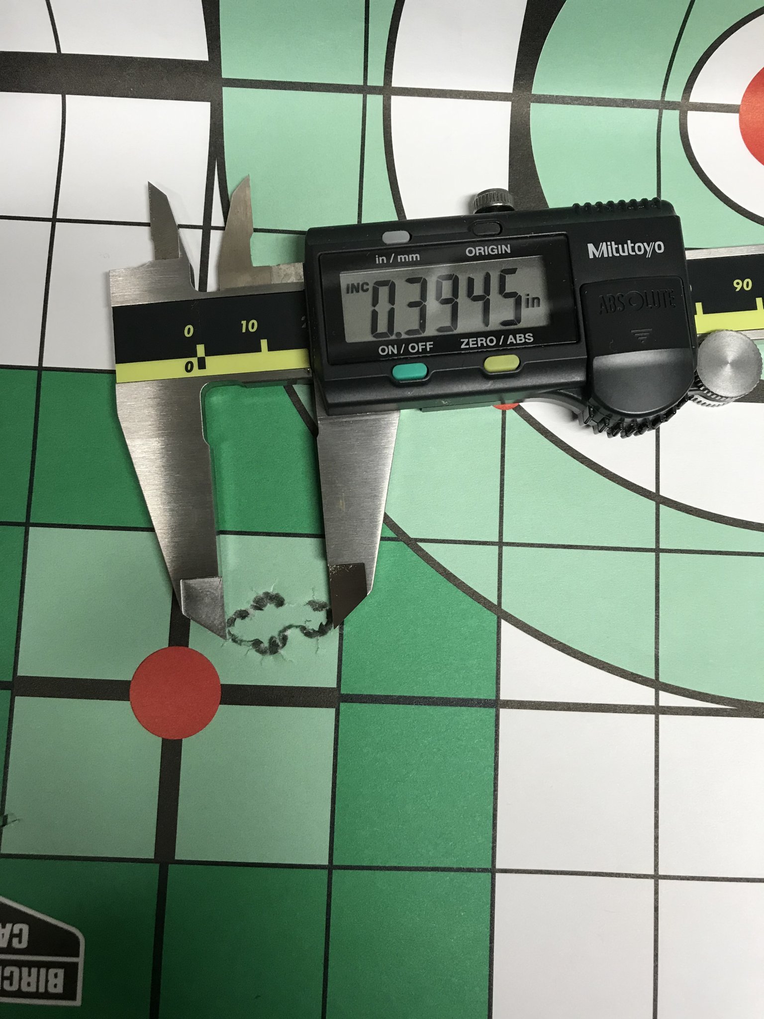

Took my Tikka with new Proof Research tube out to see what it could do. It didn’t disappoint. Bore sighted with 3 rounds to get a close zero. The picture below are shots 4-9 ( .394”) with Hornady American Gunner 140’s (5 shot sd was 10.3). Had I not pulled the last shot to the right, would have been less.
The next group @ .301” was 140 ELD match. SD @ 10.9 for 5 shots. This barrel is fast, too! Loaded some charges of RL16 and at 41.8 I had to stop due to pressure, but it was 2905 fps! 40.6 is probably where I will land with 2780 fps.
Highly impressed with this Proof Stainless barrel and the work of Andy @ The Firm Rifles Inc.
