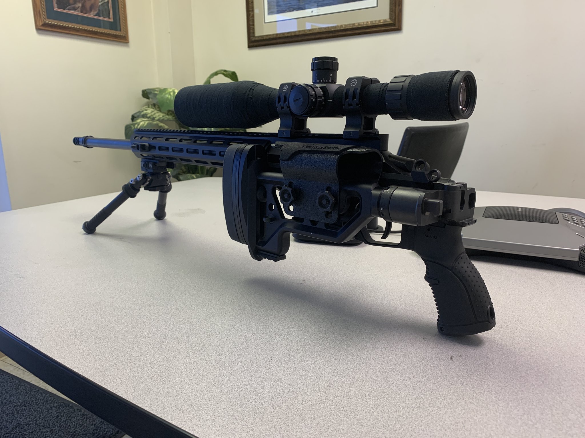

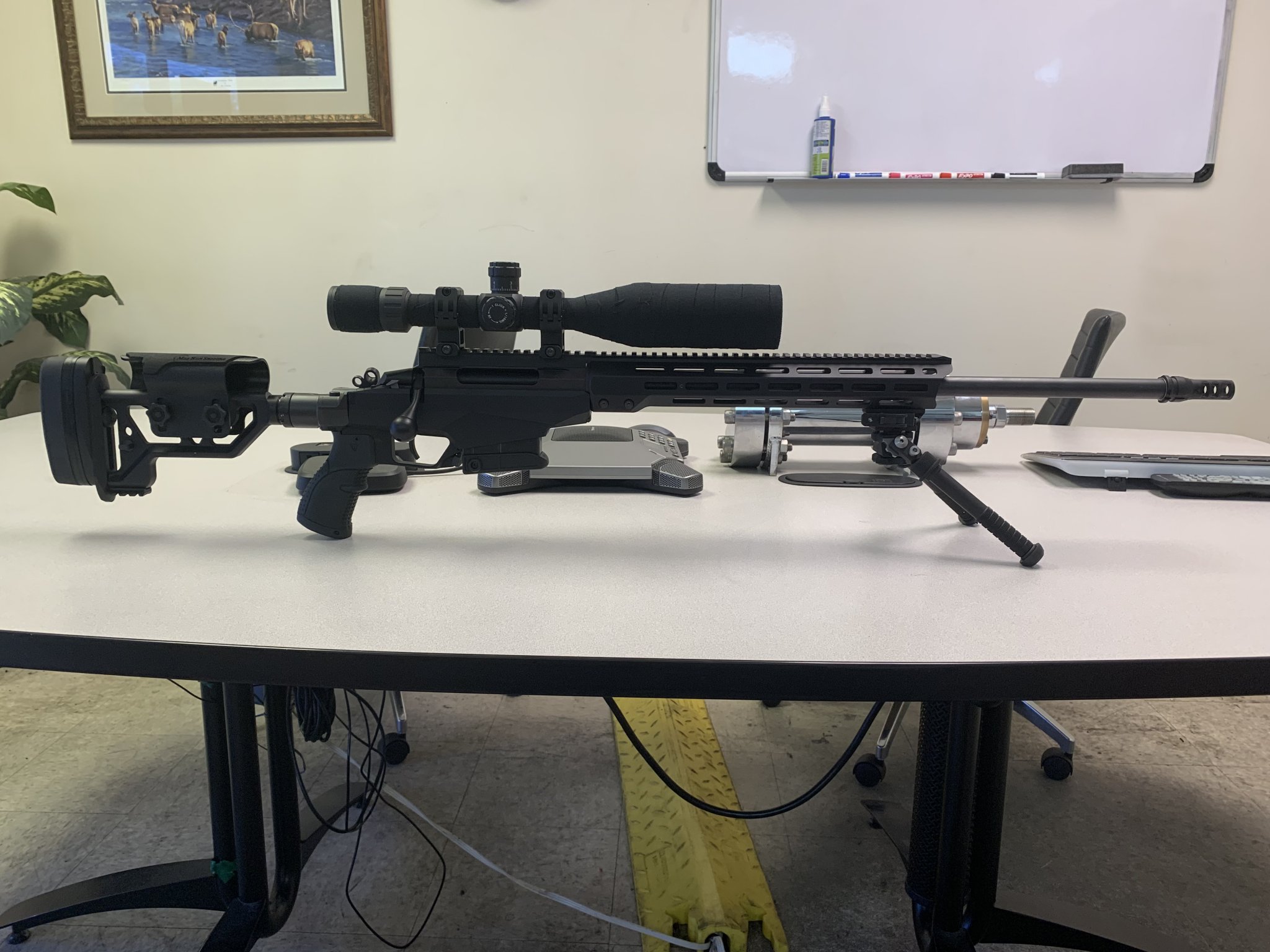

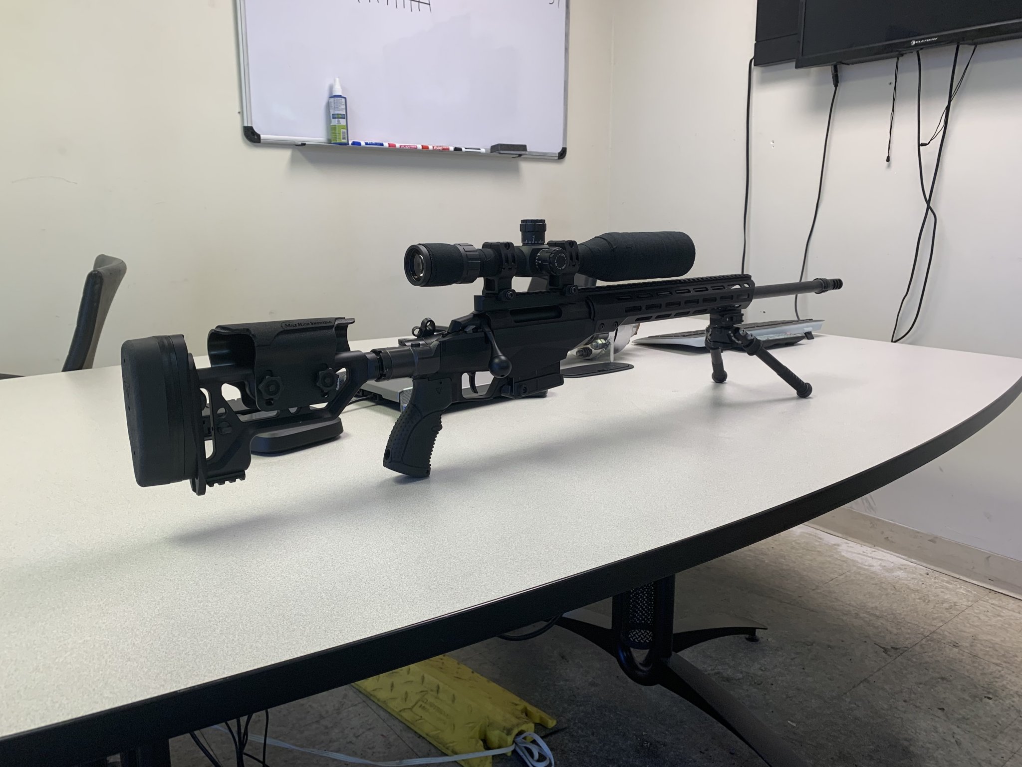

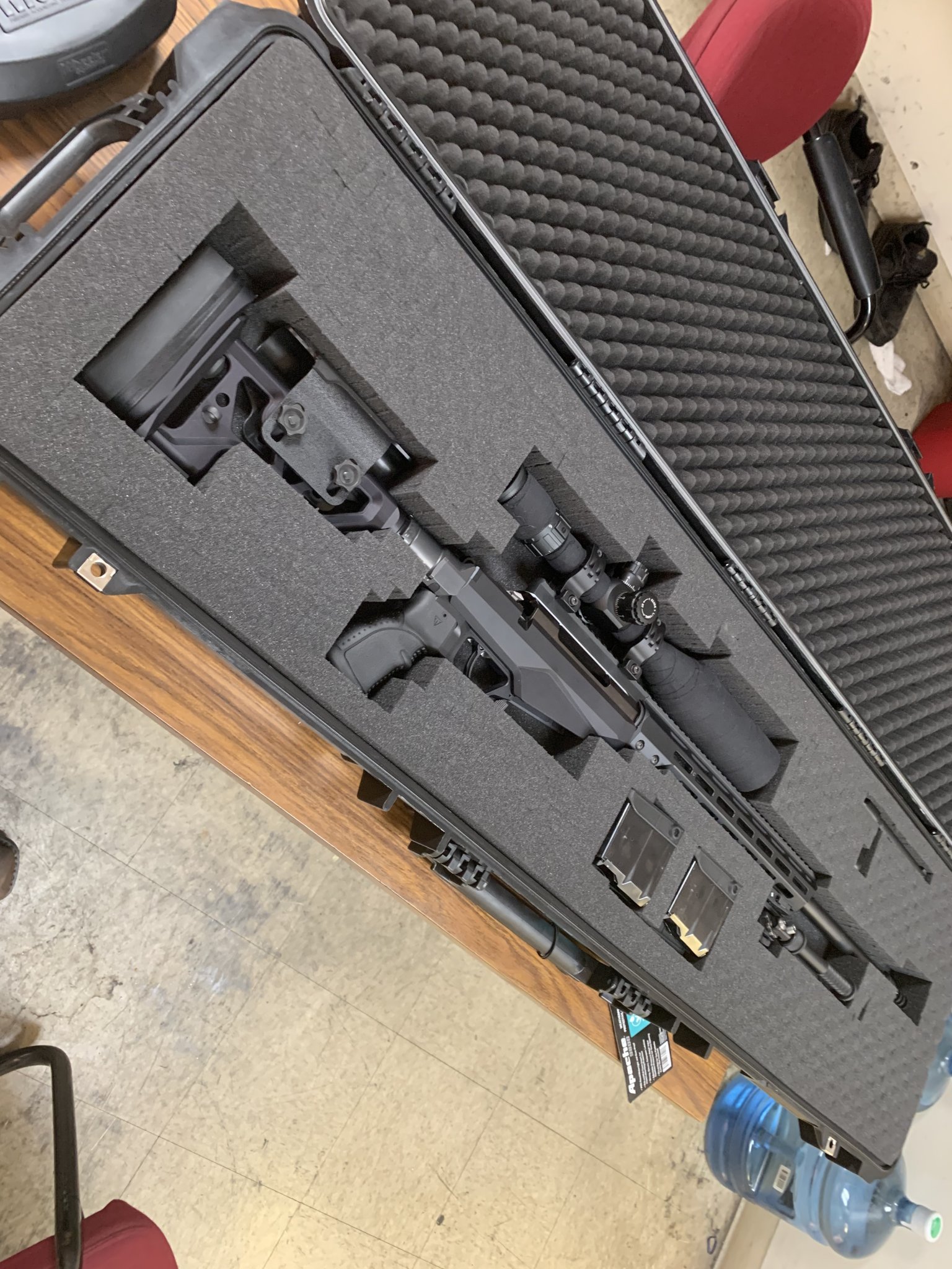

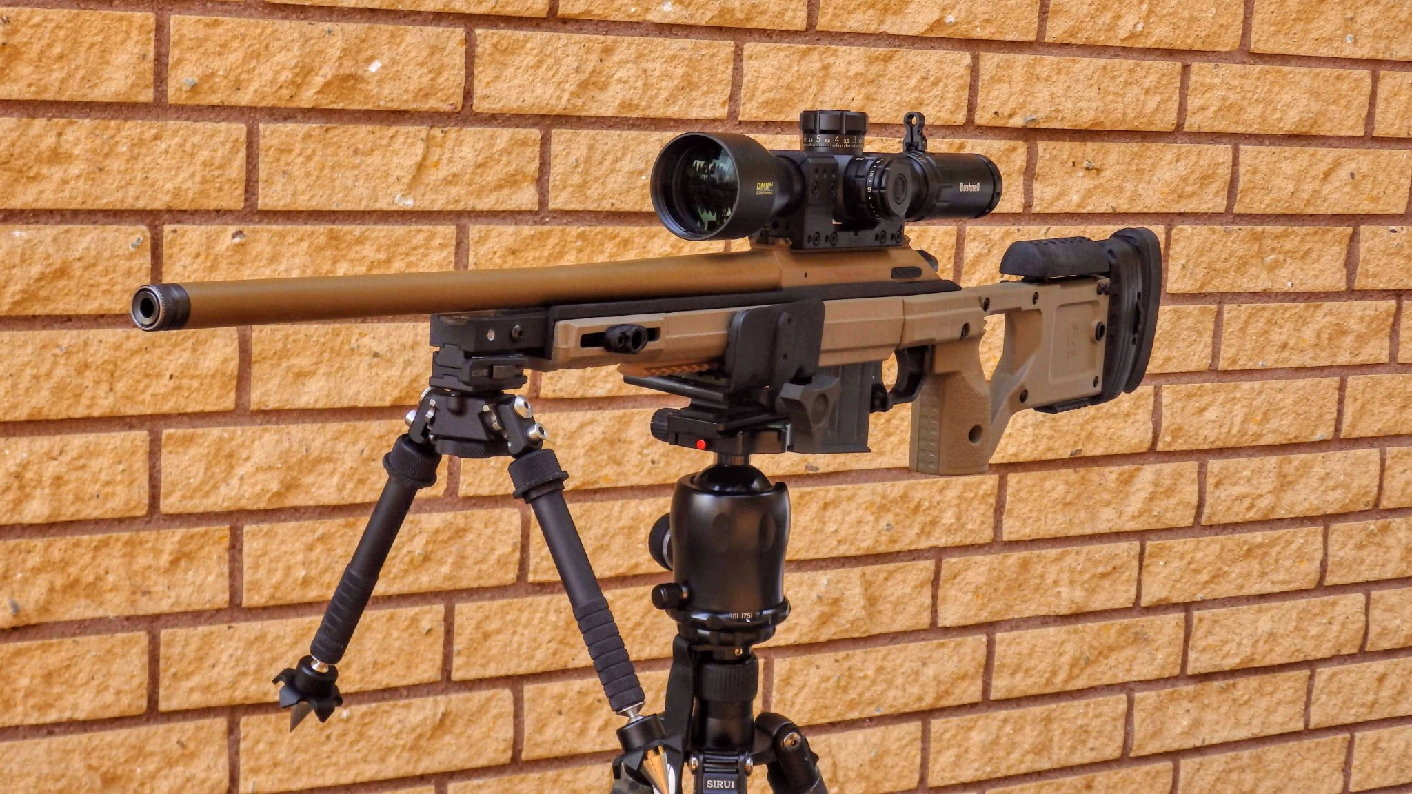

Ok so finally got my rifle together. I was all over the place on whether I wanted a CTR or a Tac A1. I knew I wanted a chassis, and I liked the A1, but decided the CTR would give me more options. So I got the CTR, and was planning to order my scope mount and a KRG Bravo or an MDT HS3, when I came across a good deal on an A1 chassis, so I picked that up. I really like the A1 chassis, and it turns out that was what I really wanted. So ordered the other supporting parts I wanted and this is what I ended up with. Had to mill out the trigger area to clear the wide KRG trigger shoe.
Tikka T3X CTR 6.5 Creedmoor 24”
Tikka Tac A1 Chassis
KRG Midas 2 Stage Trigger
EGW 20moa Tac A1 Scope Rail
American Rifle Company X-High 1.42” 30mm Rings
Weaver Tactical 3-15x50 Scope
Dead Air Muzzle Brake
BCM MLOK 3” Picatinny Rail for Bipod
B&T Atlas PSR Bipod
B&T Atlas PSR Bipod
Current Plans:
Get a pile of ammo
Shoot as much as possible
View attachment 7068045View attachment 7068046View attachment 7068047View attachment 7068048View attachment 7068072View attachment 7068073
Looks good!

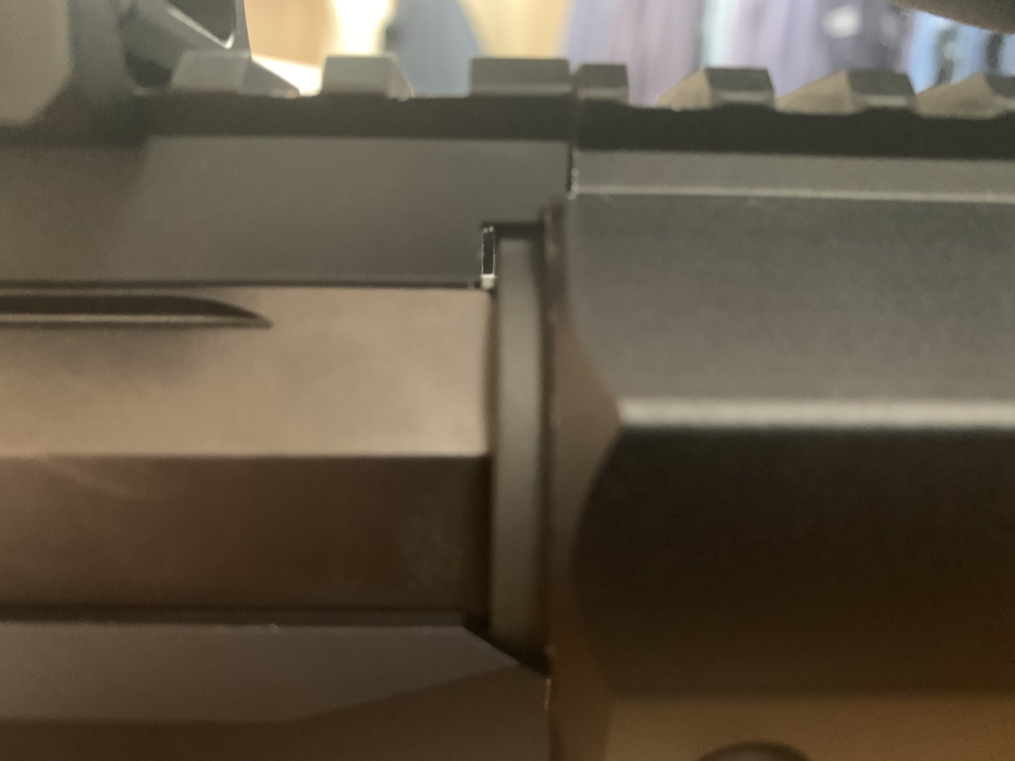

Also this is what I meant about a gap with the EGW rail. There’s about a 0.028” gap. Currently using some washers 0.040” ish to take up the space but they are a little too thick. Working on a permanent solution. But it causes the Handguard to tilt upward quite a bit and just isn’t right.

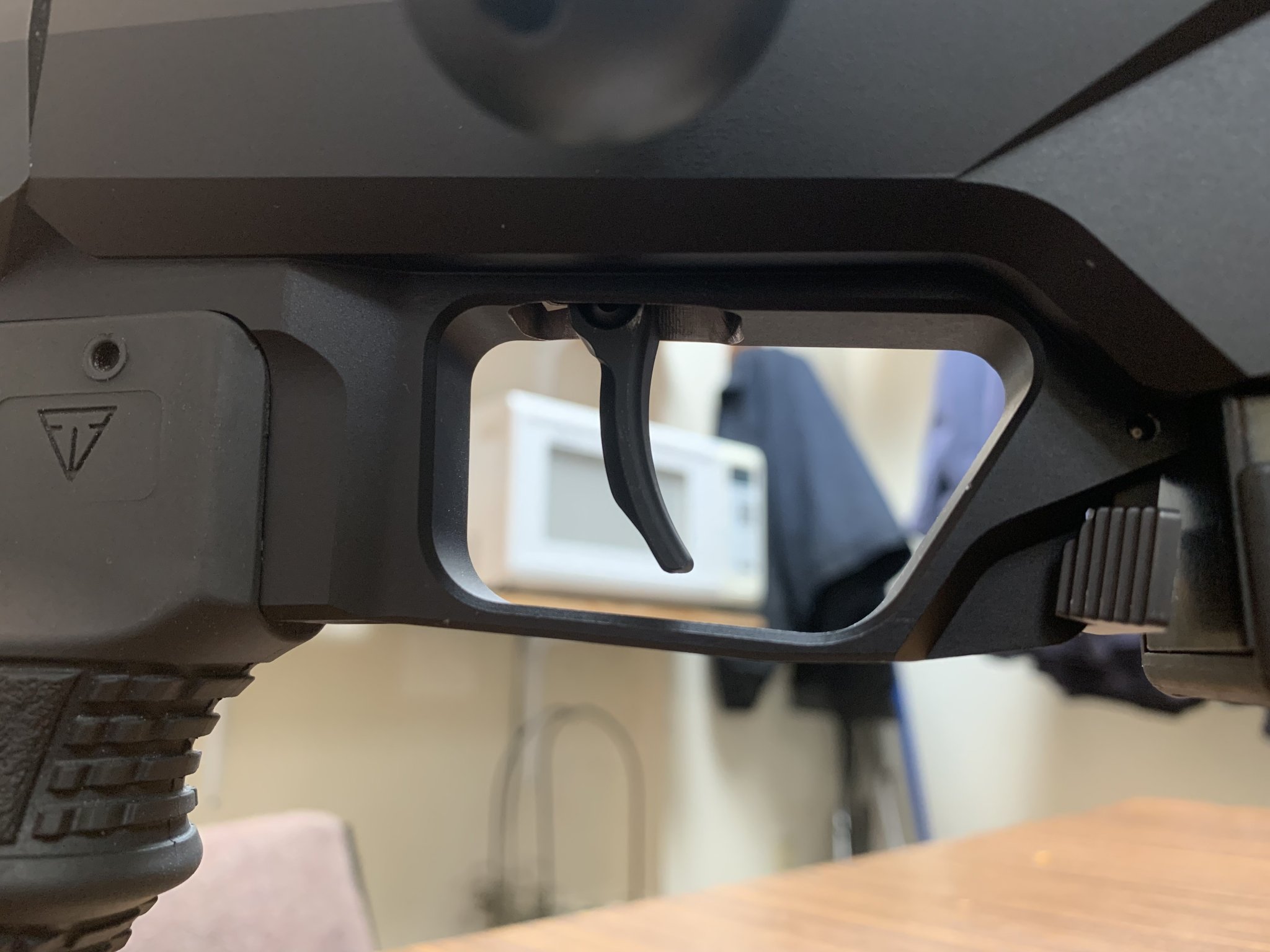

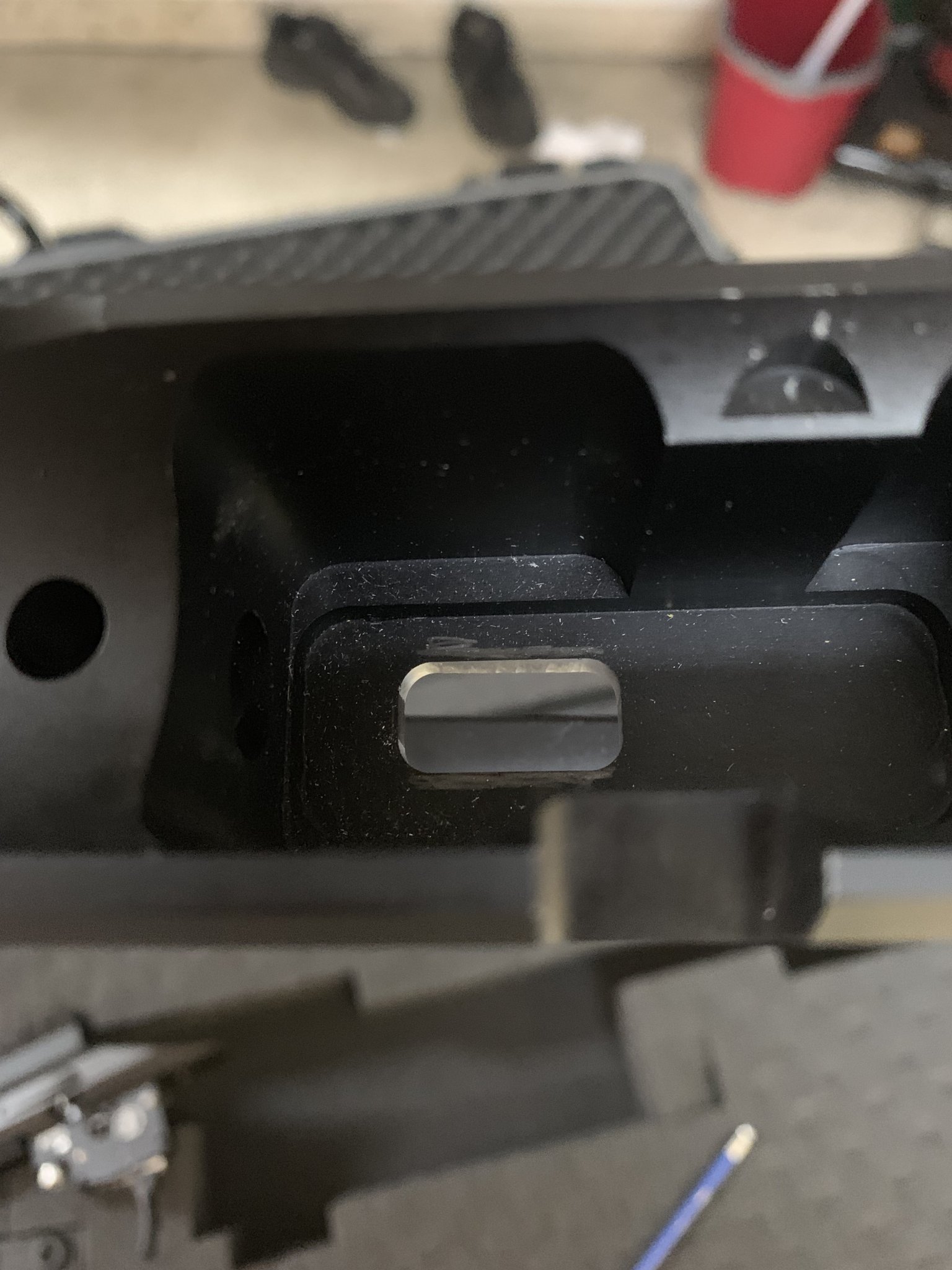

So after installing the action and torquing everything down to 65 inch/lbs for action and 45 inch lbs behind the action, the trigger is no firing. I removed the action and test fired and everything was good to go. Any ideas? I know the instructions say to remove the trigger spring clip on the T3, but the Tac A1 trigger is different and doesn’t have the clip,
Update, I emailed KRG, probably won’t hear back til Monday. So it’s causing issues when the rear action bolt by the trigger is installed...I installed the forward action bolt and trigger still worked.
if you are using the KRG Midas in a Tac A1 you will have to mill the trigger opening in the chassis wider and longer toward the rear to create clearance for it. If this is not what you are talking about, ignore what I am saying, ha
So no krg...the problem was that the chassis was binding against the safety linkage preventing it from fully engaging forward and selecting fire. I had to make a small adjustment with the set screw that holds the safety linkage in place against the trigger wall. Needless to say, the Bravo is out of spec, because every time I pulled the action out of the chassis, the trigger worked perfectly. I installed and removed it at least 10 times to troubleshoot it, and spent roughly 5 hours figuring it out.

Also this is what I meant about a gap with the EGW rail. There’s about a 0.028” gap. Currently using some washers 0.040” ish to take up the space but they are a little too thick. Working on a permanent solution. But it causes the Handguard to tilt upward quite a bit and just isn’t right. View attachment 7068080
Are you concerned because of how it looks or functionality? I don’t think the gap will impact accuracy.
Functionality. It causes the handguard mounting ring to torque upward and misalign the Handguard. The scope base with the bolt hole and the 2 lower bolt hole face should be on the same plane so the ring can sit flat against them when tightened. In this case they are not even. I spoke to EGW and they have not encountered this issue. It may or may not be a possible issue with the EGW rail on some chassis. I’m just going to put a shim back there to take up the gap which should fix the problem. Just gotta fins the right shim...

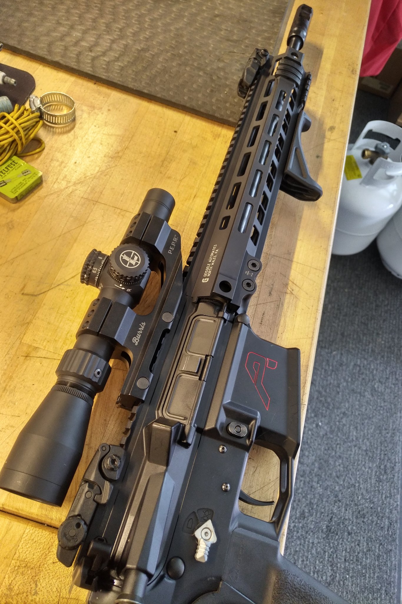

Had an idea to make the A1 accept AR15 Handguards. Now that I have a rifle I can prototype. Have 2 possibilities as of right now. 1) Make a custom mount based on the Tikka mount, but threaded to accept and AR15 barre nut or 2) Make a custom mount that will directly interface with an AR15 rail. Options with this include the Seekins and the Aero Precision and the MI Supressor Ready Rail, probably others but I see those as being candidates since they seem to be the right diameter. Option 1 would be the most customizable, but I’ve run into difficulties due to the diameter it has to be to accept AR15 barrel nuts, might look at ar10 nuts. Option 2 will work but will be difficult to manufacture multiple interfaces. It would involve machining the Handguard Mount directly into the Tikka mount. Also really would like to make a Lancer carbon fiber rail work if possible.
Any suggestions on what rails y’all would like to use on the A1?
Also, looking at making the mount out of 4140, 17-4 SS, and/or Titanium.
Just wanted to get an idea of who would be interested to see if it would be worth doing it.
Let me know your thoughts
I would want this rail if I were sticking with the TAC A1 chassis.
Reactions: D1rtyHobo
Geissele handguards are ROCK SOLID pieces of gear. I have a Mk4 13" on my AR and it's head and shoulders above anything else I've used. The fitment of the rail onto the included barrel nut, the overall heavy duty construction and machining of the rail, the fact you don't need to "time" anything for the gas tube (just torque and go).
Superb.
Reactions: phlegethon
I’ll see if I can make one work.
And this leads to my next question, can any send me a blueprint of the Geissele barre nut? In particular the outside dimensions, the inside doesn’t matter as it’s threaded 1.25”-16. Knowing the outer dimensions of the nut will determine if it will work.
B&T Atlas PSR Bipod
Current Plans:
Get a pile of ammo
Lovely! I had same problems and mine is still CTR. I would love to have PSE composites and two stage trigger!
