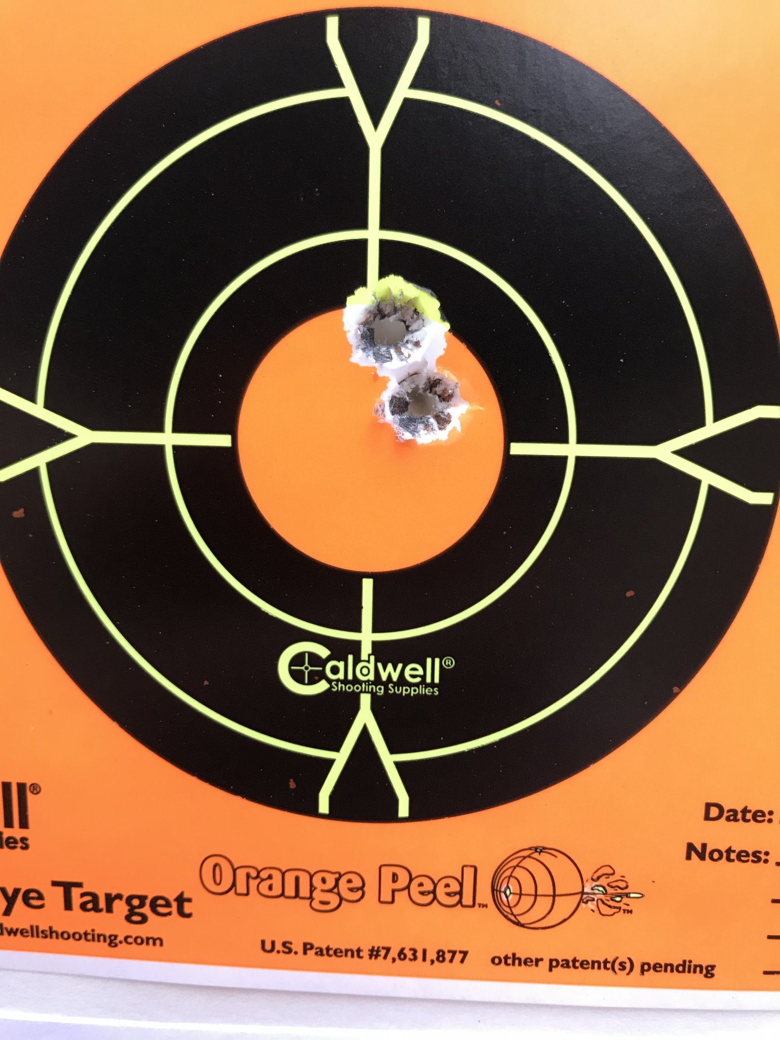

That’s 2 bullets in the top hole and then the third below. Factory ammo - Federal GMM 130 Berger OTM I bought at WM. Dies got here today.
Shot this afternoon after I mounted the new Badger Ordnance 20moa unimount.
Only shot 10 rounds and those were the last 3.
I have yet to adjust the trigger.

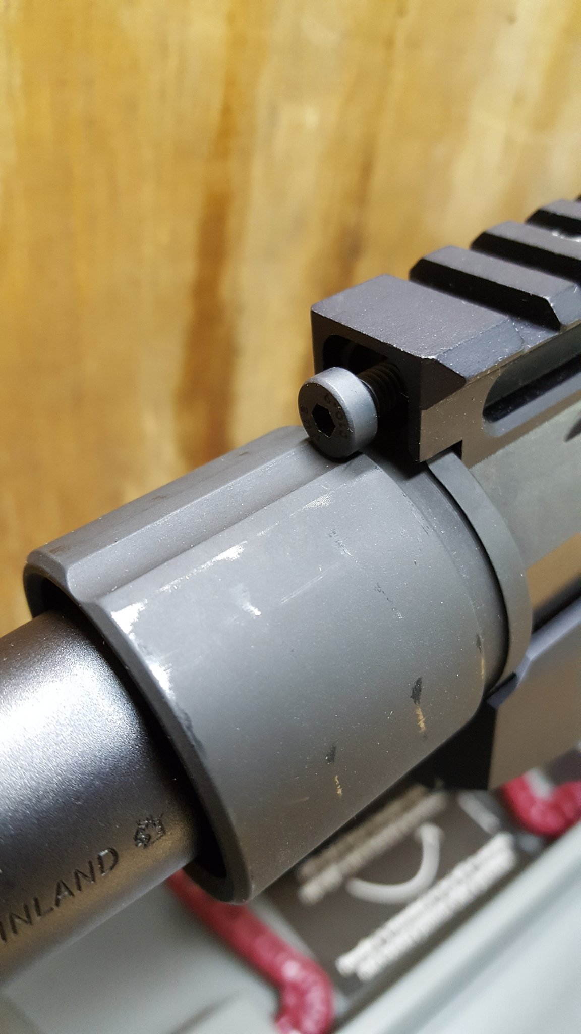

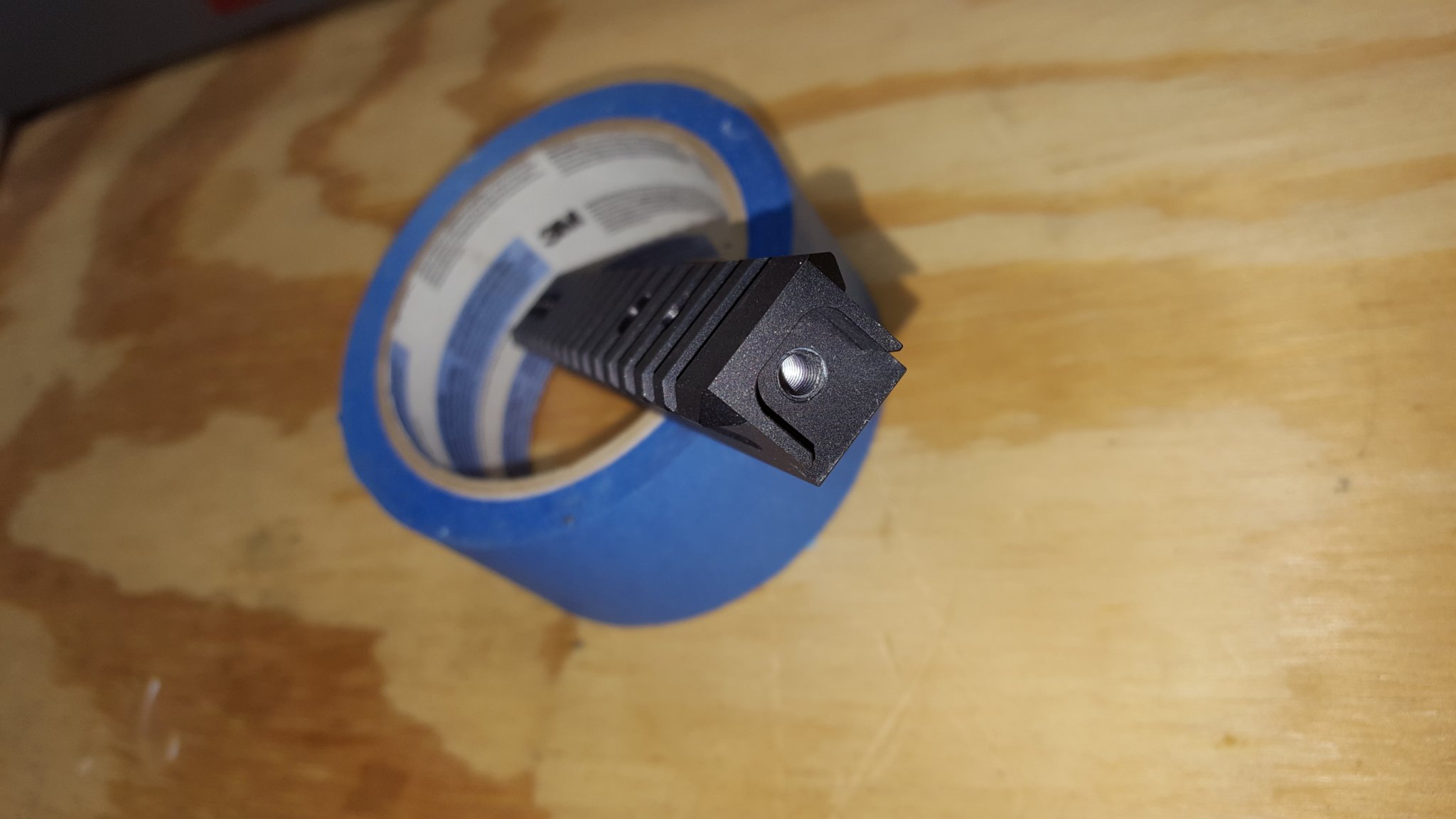

Has anyone taken the factory rail off their TAC A1 and installed a 20 moa rail? Looking for a specific example. I ran across the Mountain Tactical warning as well and that has me concerned.

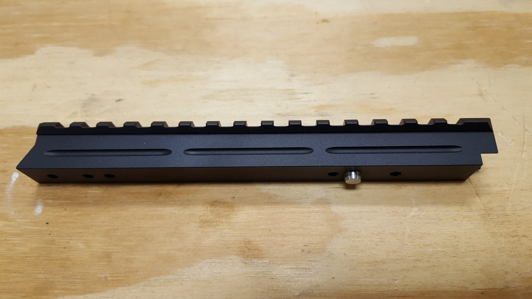

I bought a 20MOA rail from Mountain Tactical. After multiple emails and phone calls I was reassured it would fit. I purchased the Gen2 only to return it. The rail is too long and too low in height. They suggested cutting the rail to fit! I have searched and have not found anyone who makes a 20MOA for the T3X TAC A1 version after multiple purchases/returns from multiple companies. Therefore, I had one made at a machine shop. I will receive it any day and will post more info.
As far as removal of the factory 0MOA rail, I recommend a lot of patience! The factory liberally applied epoxy to the receiver on my unit. The epoxy worked its way into the 6/48 threads and hardened once the rail and screws were installed. I ended up stripping 1 out of the 5 screws. Also, keep in mind there is a 5mm bolt that goes into the front of the factory rail. In order to get access to this bolt, remove the 2 bolts in the forend, and slide it off the barrel. Note: the exoxy was since removed from the rail and receiver in the pictures below.

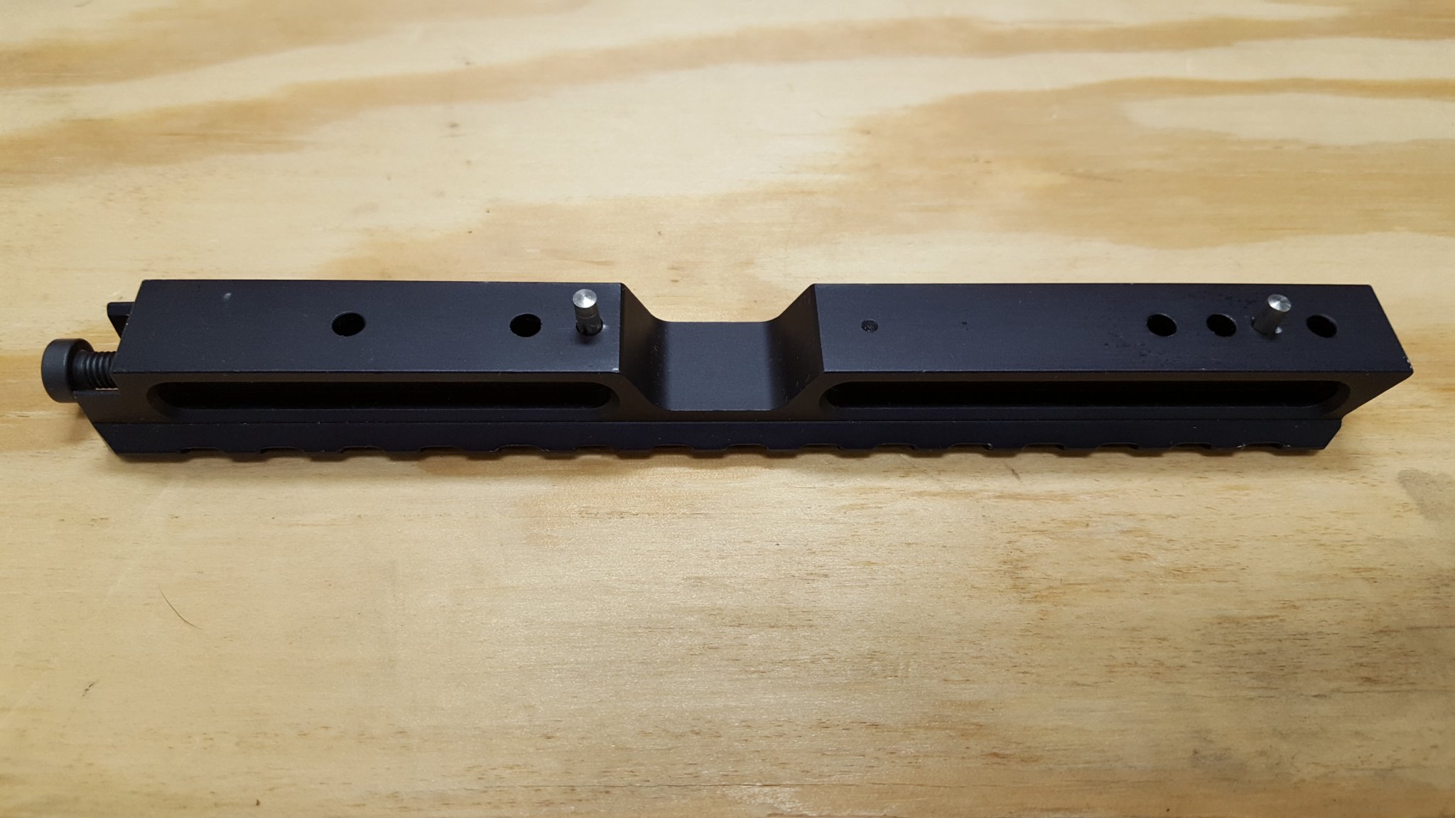

I saw ARobinson's attempt to replace the top rail with a 20 moa rail. I took my TAC A1 apart this weekend to check out the trigger (more about that in a minute) and as I disassembled it I noticed that the collar for the handguard screws to the chassis at the bottom and into the rail at the top. Unless a manufacturer comes out with a specific replacement then swapping out for a 20 moa rail is not going to work. The rail needs to be specifically machined to mate with the collar. I'll follow Mountain Tactical's advice and get a 20 moa mount from Seekins.
I also contacted Dave at Yodave about a replacement spring. He wasn't sure if his T3 spring would work in the TAC A1's two stage trigger. So I pulled my trigger assembly off and the short answer is no, it doesn't look like it will work. The spring is contained within the assembly and I'm not about to start pulling the trigger apart. I've adjusted the trigger to Tikka's recommendations and it's excellent at just over 2 lbs.
Yes sir....that's exactly what I had to do regarding the rail. Apparently none of the companies selling rails for the T3X TAC A1 took the time to do some research!

I had a heck of a time getting the rail off my T3x. Can't imagine it being any easier on the TAC and I didn't really want to try.
I just went with a 30MOA Spuhr mount on the factory rail. With an ATACR 7-35 I have plenty of elevation adjustment.
Yes sir.....it was a bear to get off. Lots of patience req'd. The factory applied epoxy liberally and it oozed into the screw holes and then hardened once the screws were torqued down. I stripped 1 out of 5 screws! On top of it, the screws were very soft. No wonder the Beretta reps are telling people not to take the rails off!
I’m scared to buy one that is not stainless for this reason! My ctr is SS and had zero epoxy on the threads or anywhere for that matter,it came right off with ease
The CTR I had a pain with was a SS one too. Still took a lot of work and a heat gun.

I used JASCO. Took some time and patience, but the epoxy came off the rail & receiver rather easily. Note: use JASCO in a ventilated area. However, the epoxy in the threads is another story.

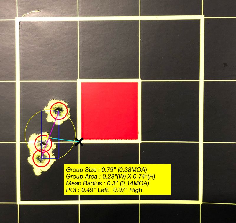

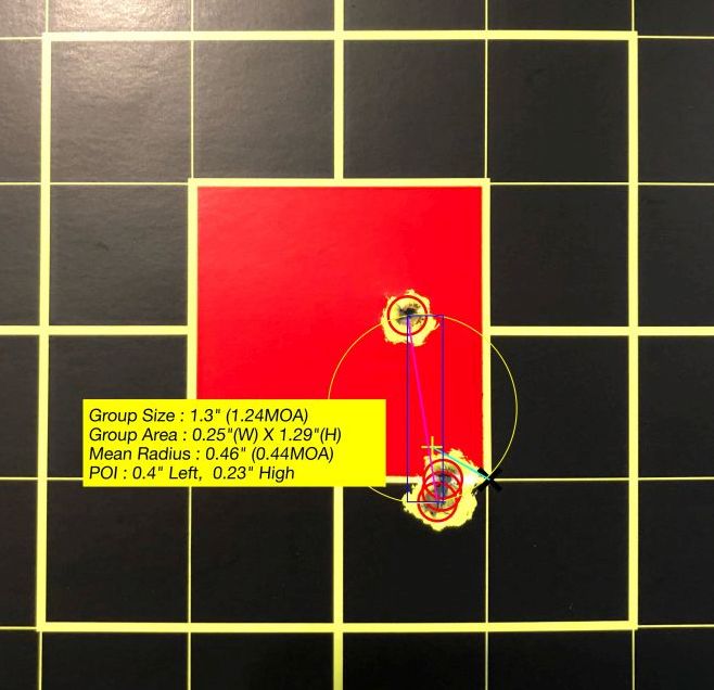

Got mine out today to finish up the last 4 single shots of barrel break in and also the first 2 of 5 3-shot cycles for break in.
All shots are hornady American gunner bulk ammo.
Here is the 4 single shots, at 100 yards. POA was lower right corner of red square. First shot I knew was off. Next three were all in the one hole just left of POA.
First 3-shot group at 100 yards (ignore the MOA calcs as I forgot to change it back from 200 so it halved the calcs)
And then a 3-shot group at 200 yards
I'd say I'm pretty happy with this. I'm not a skilled shooter by any means so I'm looking forward to improving technique even more and bringing these down even smaller.
Reactions: Winkmeister

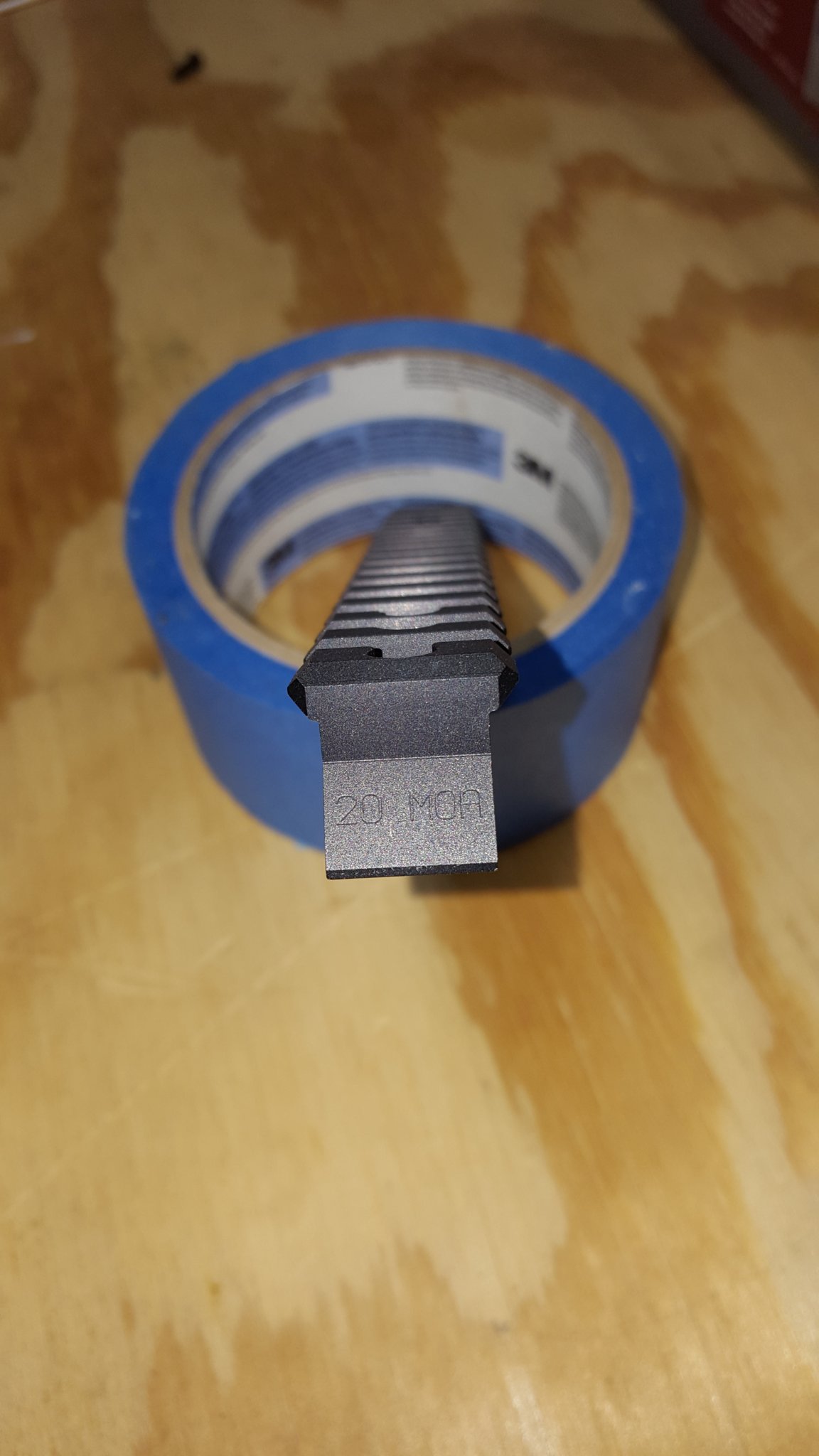

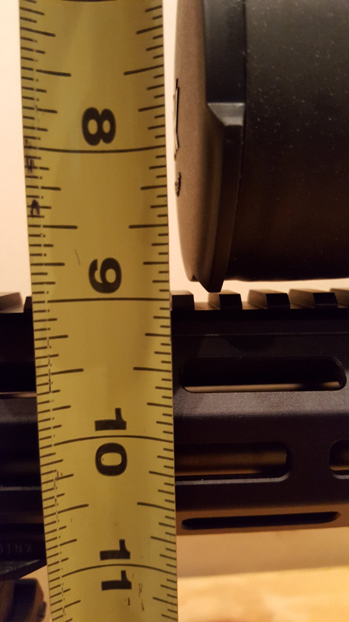

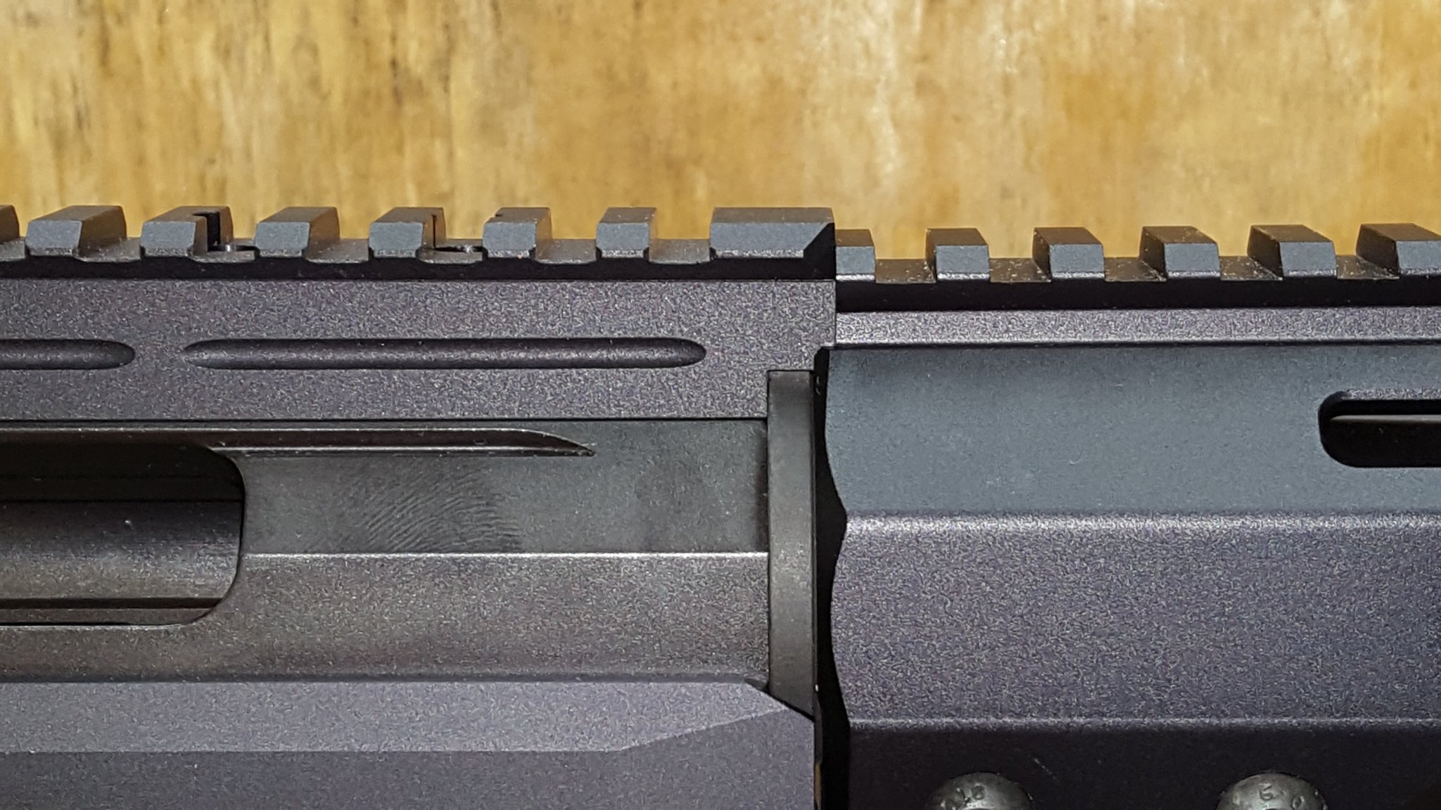

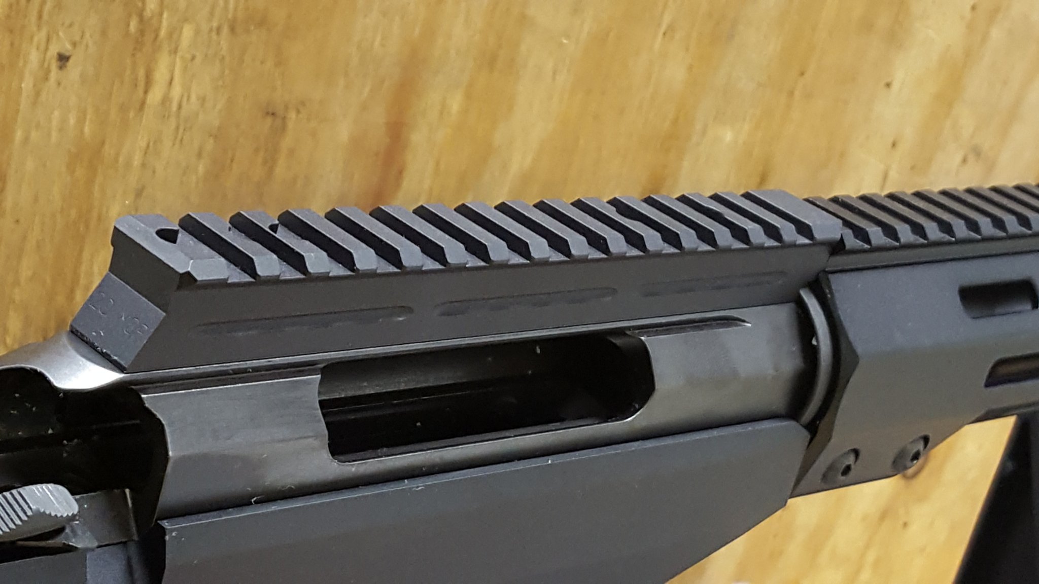

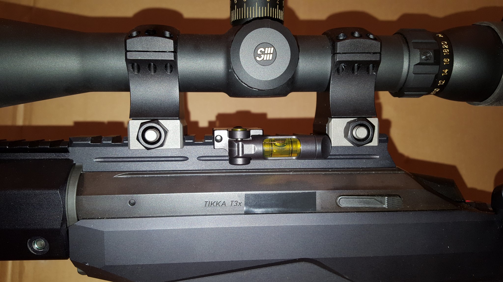

Finished installing my scope on custom made 20 MOA rail.
30mm tube
56mm objective
1.50" rings
19" length end to end of scope
As you can see, there is less than 1/8" of clearance between the front flip cap and the forend rail. One could possibly get away with 1 3/8" rings, but some flip cap modification would be required.
