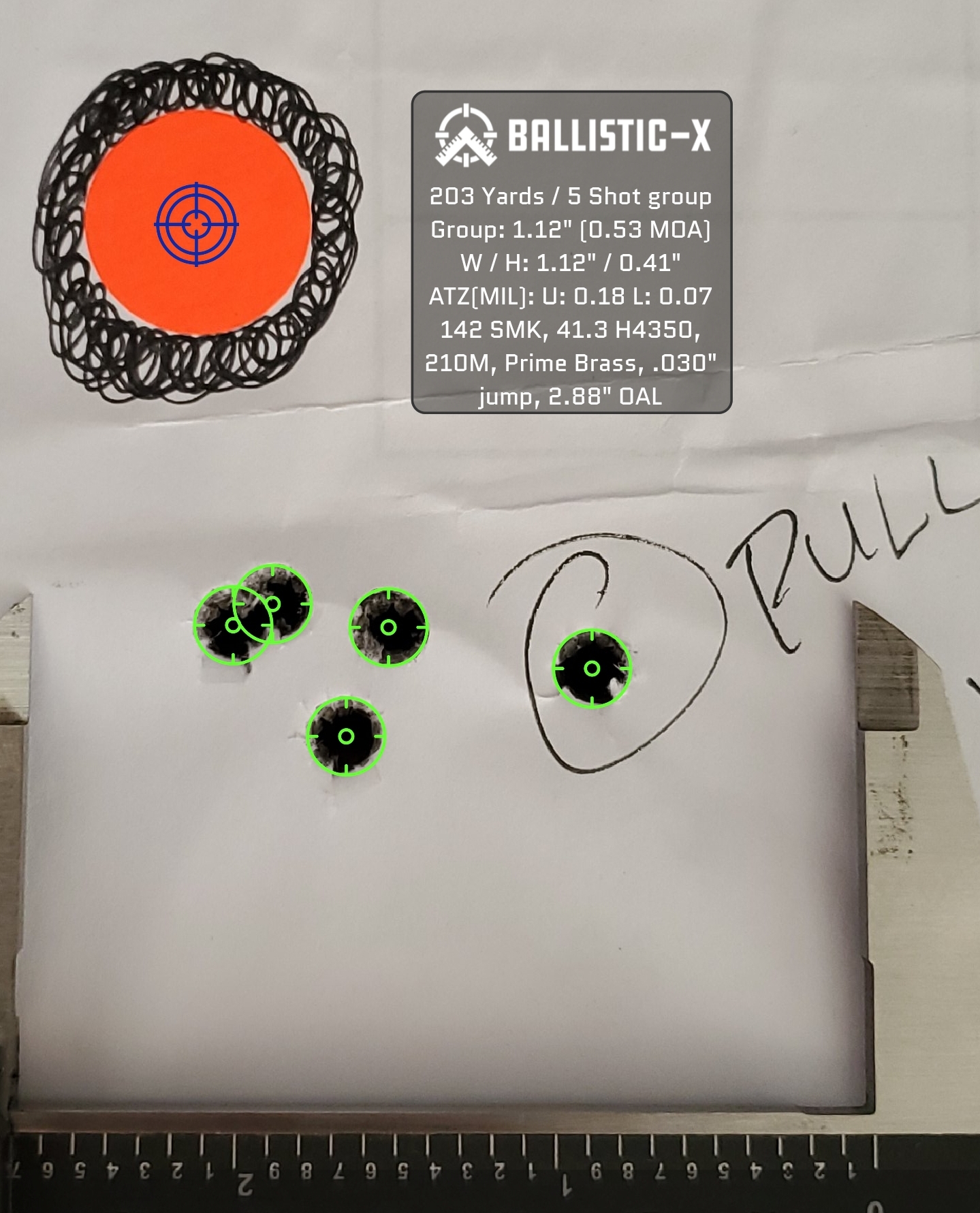

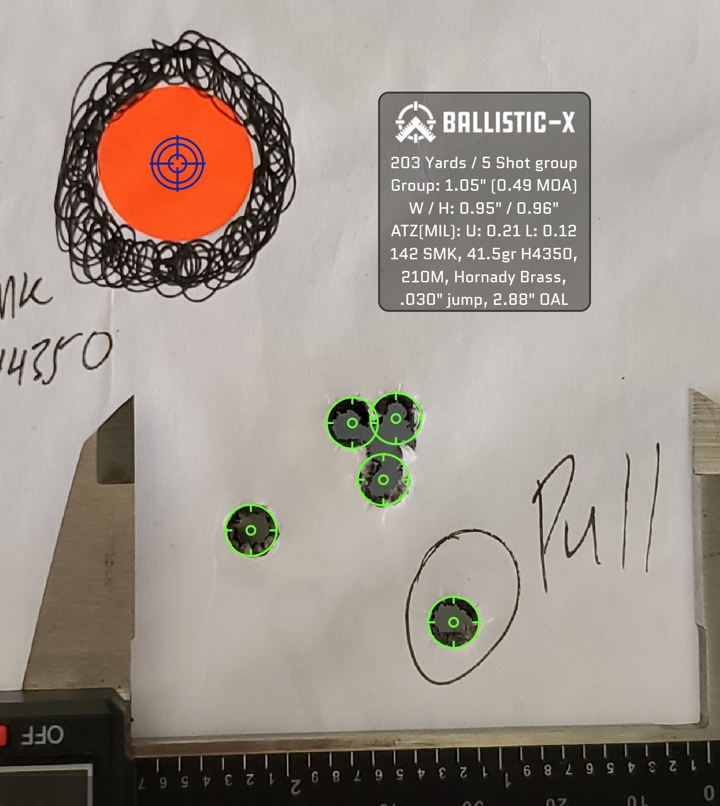

My Tac A1.... 203 yards today.....
Got my seating depth testing loaded up...

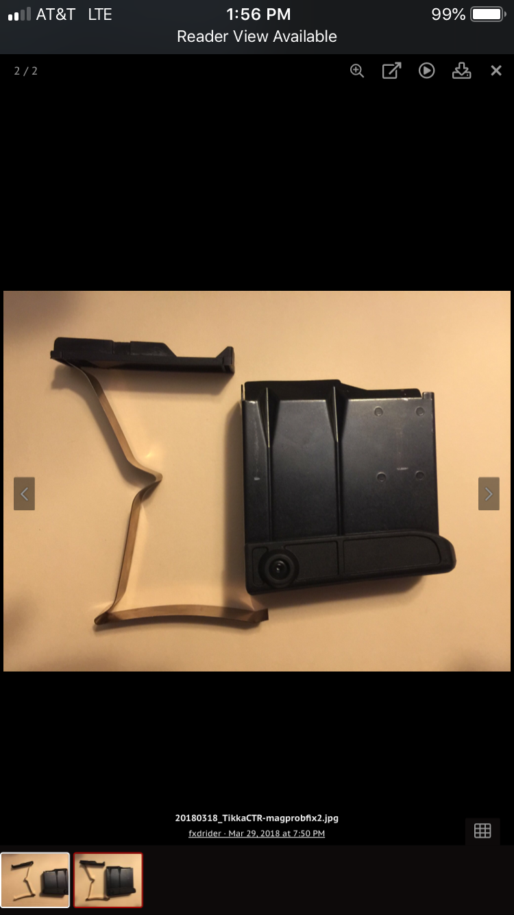

Mags can be finicky when run dirty, hard and fast...at least the three I had were, keep em clean and you should be good.

FYI - there are a couple of mag fixes on YouTube about bending the spring very subtly in certain directions to improve feeding. They flat out work. I was running into issues with feeding where cartridges where feeding nose up and the bolt would pass right over them on cycling. At that time I had put about 2,000 rounds through the rifle but none the less it was annoying at matches. I took apart the mags and bent the springs as the tutorials instructed and haven't had a feeding issue since.
