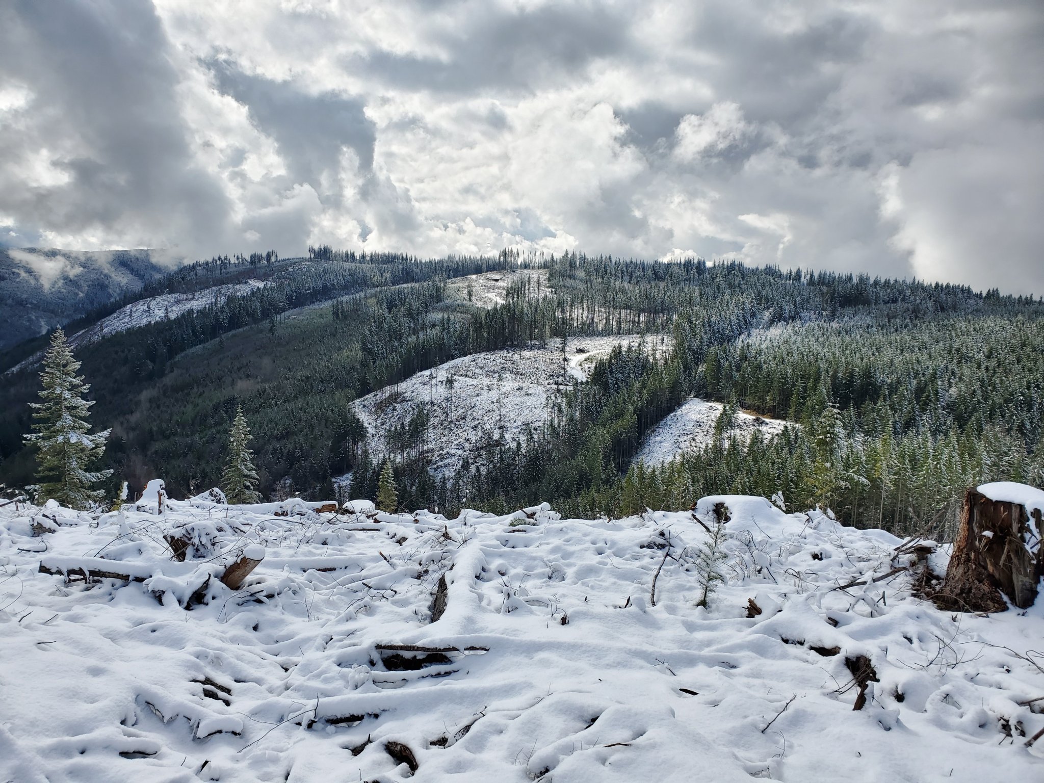

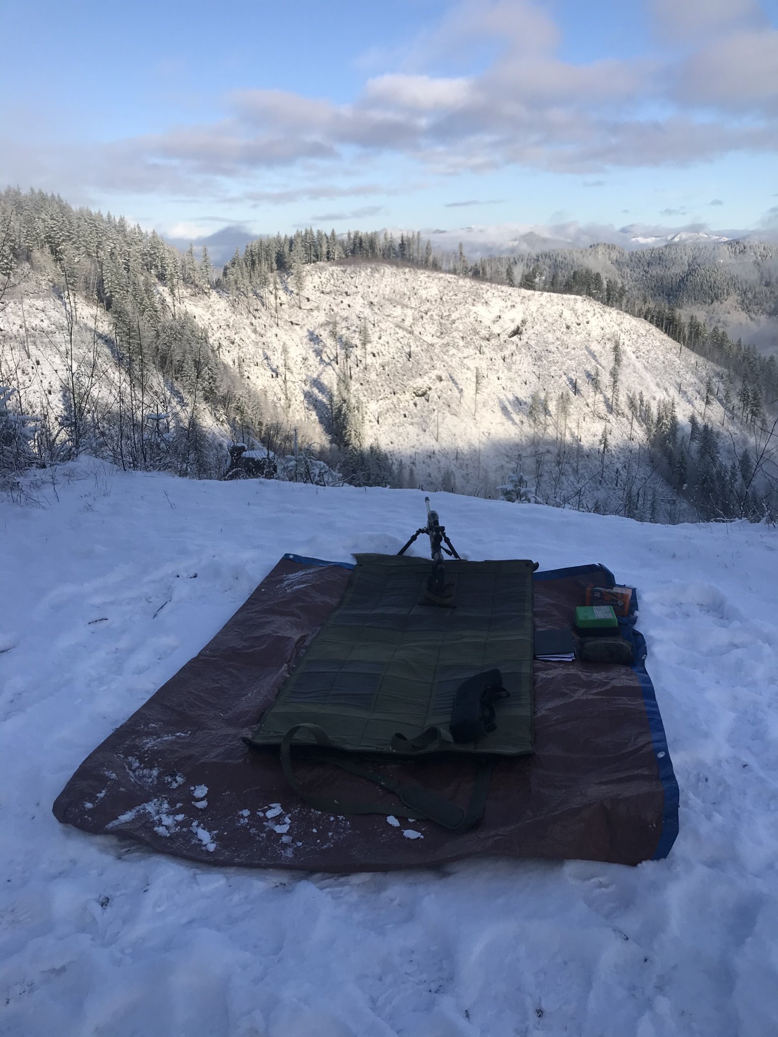

    My buddy & I saw the most refraction/displacement I've ever seen today.
    Was shooting @ 1645yd across the valley in fresh snow with near calm wind & morning sun @ about 10 o'clock in relation to the azimuth.
    We both had to dial .7-1.0 mil higher than normal today.
    Started with the 1st and. Dialed 16.7 mil & hit almost 1 mil low. Stayed that way for the duration.
    Can't account for the discrepancy otherwise.
    Tgt was the black cliff face near the top across the valley.

    Conditions were as follows:
    Temp 32*F
    Press 28.06"
    Hum 79%
    Over the last 3 weeks I've been trying for a CCB shot on a 10" rock @ 1439 from the exact same FFP. Temps were within 2-3*. Humidity & press was also nearly the same. Always I was within .1 mil on that rock.
    The wind there can be very difficult but all the fog floating around was going up not down so we can eliminate a strong down draft.
    The snow & bright light is the only real difference aside from the range.
    Also the range was provided by both our Terrapin x. Both gave the same readings +/- 1 yd.
    Temp 32*F
    Press 28.06"
    Hum 79%
    I don't know for sure, but my guess is that there was an inversion. The sun warming the air down in the valley and on the mountain sides, while the air in the middle remained cold, acting as a lens.
    Just my guess.
    Entirely possible. I don't pretend to know exactly what the cause was. I'm surmising that it was a refraction causing the change in poi. For all I know there could have been a 20 mph updraft but I highly doubt it. I would think the fog movement would have indicated that. We certainly saw or measured nothing like that. The prevailing breeze was 1.5-3 mph from about 150*. We could see fog drifting up the opposite slope but it was moving the same speed or slower.
    Surprised both of us when we impacted so low. Don't remember ever seeing such a difference before.
