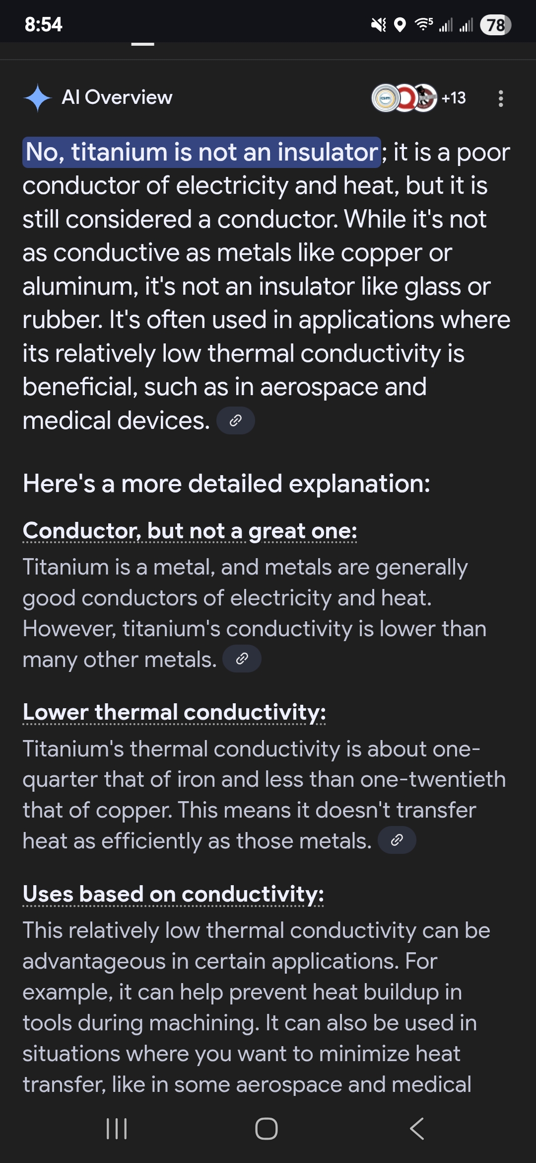

    It's not an insulator, see photo below. It's a conductor.
    As far as the rigidity compared to cf, they are very similar based on the reading I just did sounds like cf is more rigid when weight is used to compare them, but titanium is more rigid when the mass is the same, so they are nearly identical in rigidity.
    It is a terrible thermal conductor. While it’s not quite an insulator, it’s not a good thermal conductor and is used often to insulate. I use titanium backing shims behind my brake pads to reduce the amount of heat transfer to the pistons and into the fluid. It wasn’t used on the SR-71 Blackbird for its thermal conductivity either.
