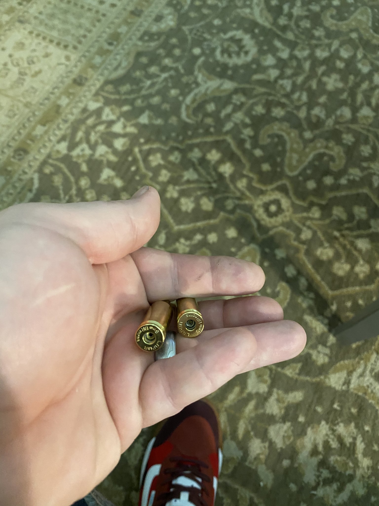

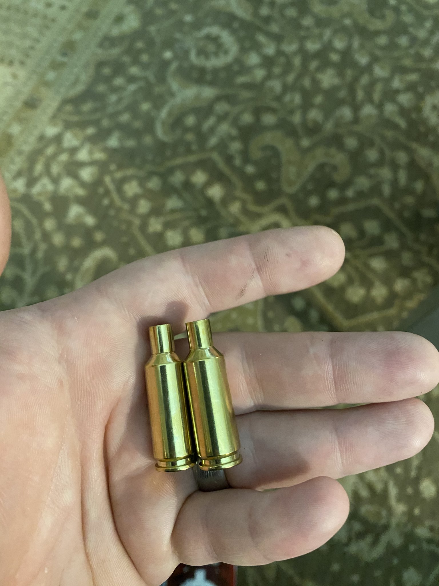

That sill doesn’t answer how tumbling overnight is excessive. Here is brass I tumbled with pins overnight:
I did say that you would notice if you had used the pins with the right proportion of chemicals.
View attachment 7344689View attachment 7344690
Fair enough. You got me there. What do you use? The lemon shine/dawn method, or do you have a secret recipe? I really like those pods. They also make them dry without spots
