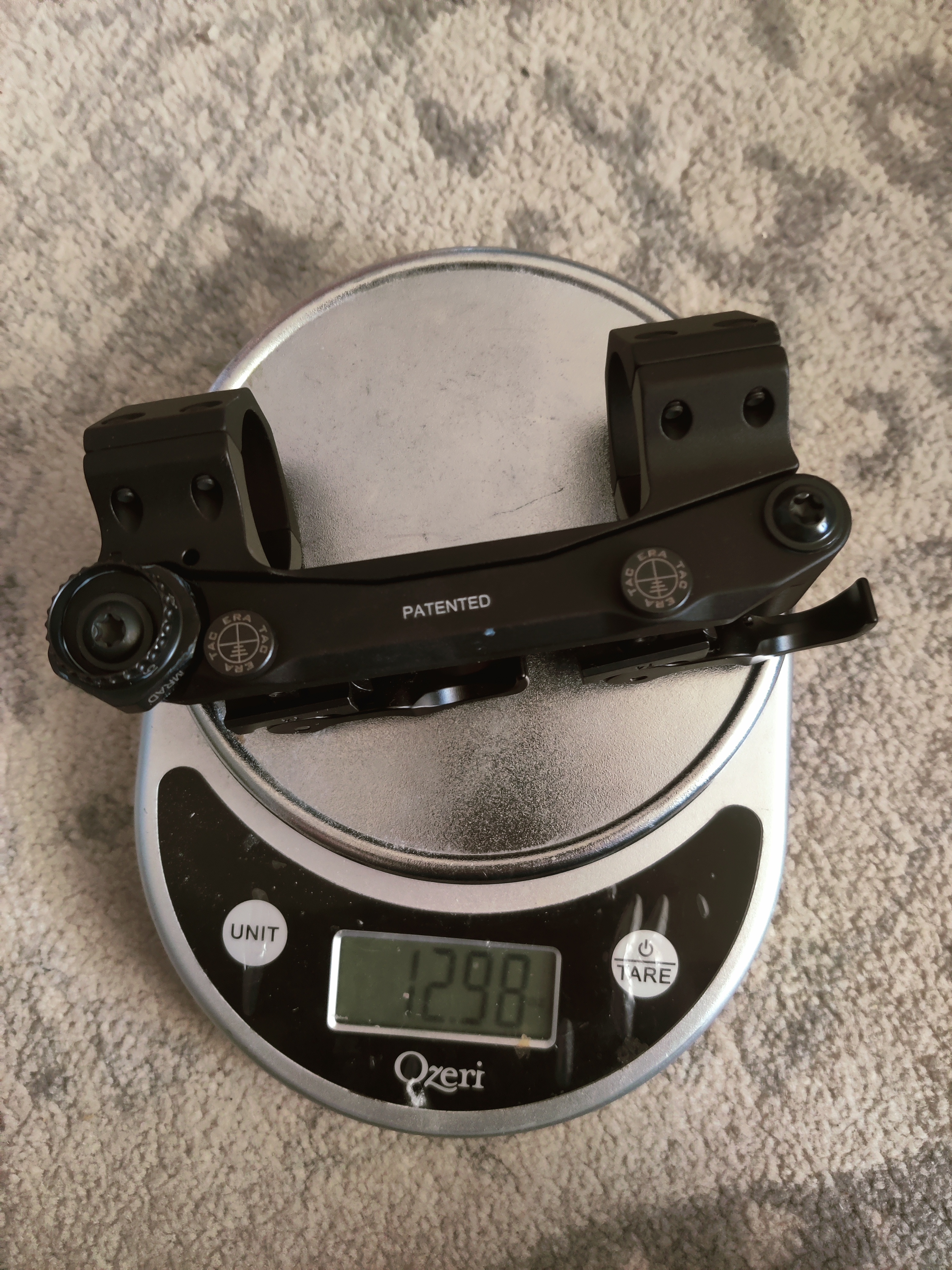

Does anyone have experience with the ARC "Air" brace mount ? ... The 4 ounce cantilever
Wondering about the toughness of that one.
I have the regular M-Brace ... And that thing is awesome. I cannot imagine it ever breaking.
Considering the Air brace for an SP10

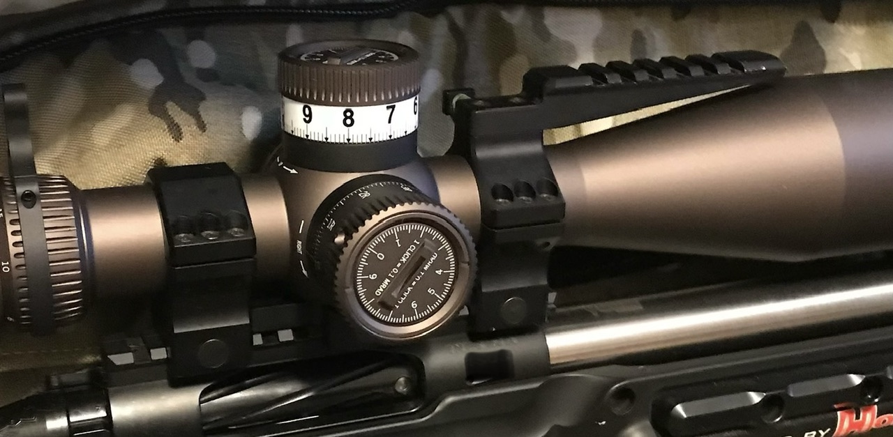

I'm a fan of pretty much anything that Ted and ARC make. I haven't used his mounts but I run his rings on three rifles and I'll keep using them.
