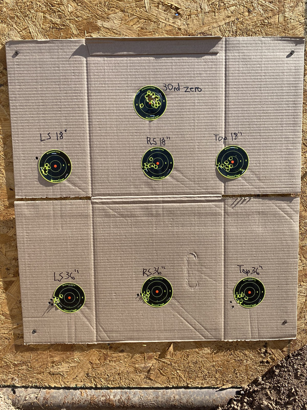

To check zero retention, the rifle and scope rode uncased in my UTV over miles of washboard dirt roads and through rough pastures and drop test consisting of drops and knock overs that I had actually accidentally done in the past. I have had a name brand scope completely fail after riding in a padded case over that exact same road and through the exact same pastures. Before I did the drop test, my rifle was due a cleaning, so I cleaned it. I also had to load another batch of ammo to continue testing. I fired two five shot groups to foul the bore with the clean barrel and new batch of ammo. The rifle settled in during shots 6-10. It was not perfectly zeroed, but I didn't pursue it, as my goal was to determine whether the scope would maintain the same POI after being dropped. Shots 11-15 were after two drops from the leaning position. I leaned the scoped rifle against my bench and pushed it over so that it fell while pivoting on the butt pad. I did this once to the left and once to the right and then fired a group, shots 11-15. POI was the same in relation to POA, no zero shift. After shots 11-15, I put the scoped rifle on my shooting mat, resting on the bipod. I then knocked it over twice in each direction then fired shots 16-20. Again, no change in POI in relation to POA, no zero shift. The Tract Toric Hunting Scope withstood impacts I have previously experienced, withstood vibrations and jolts in the UTV that all my scopes are routinely subjected to, and retained zero. Not all scopes I have had in the past have survived that.
Upright Knock Overs
Bipod Knock Overs
