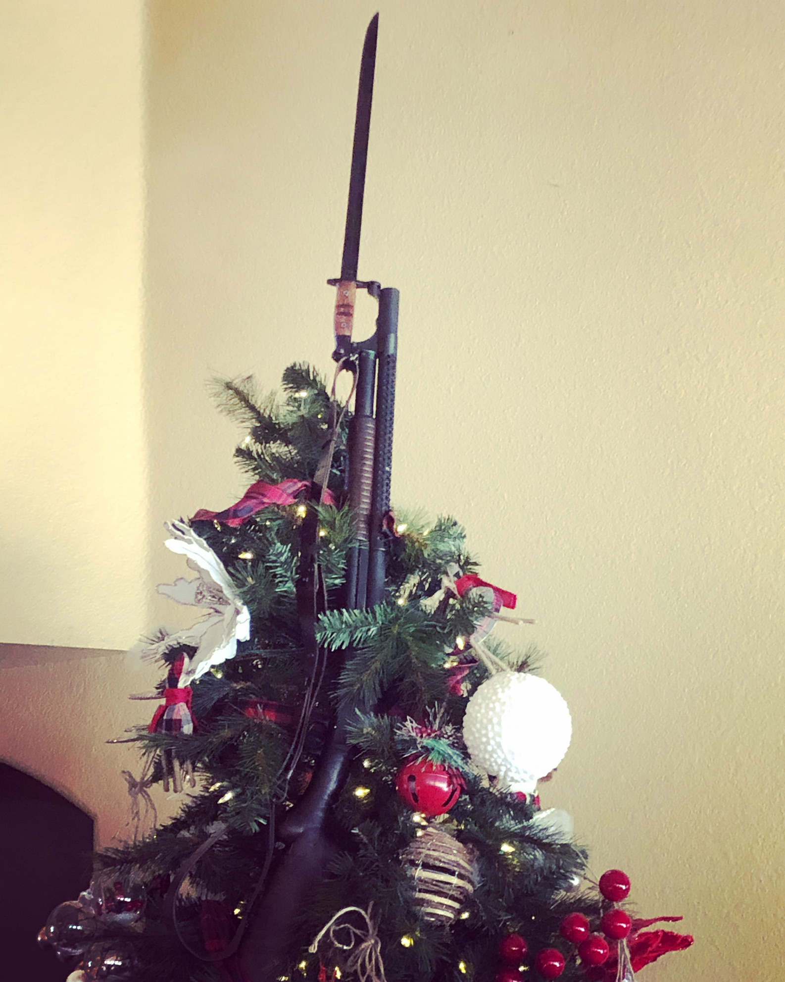

Never underestimate a Green Beret..........
Merry Christmas ya’ll

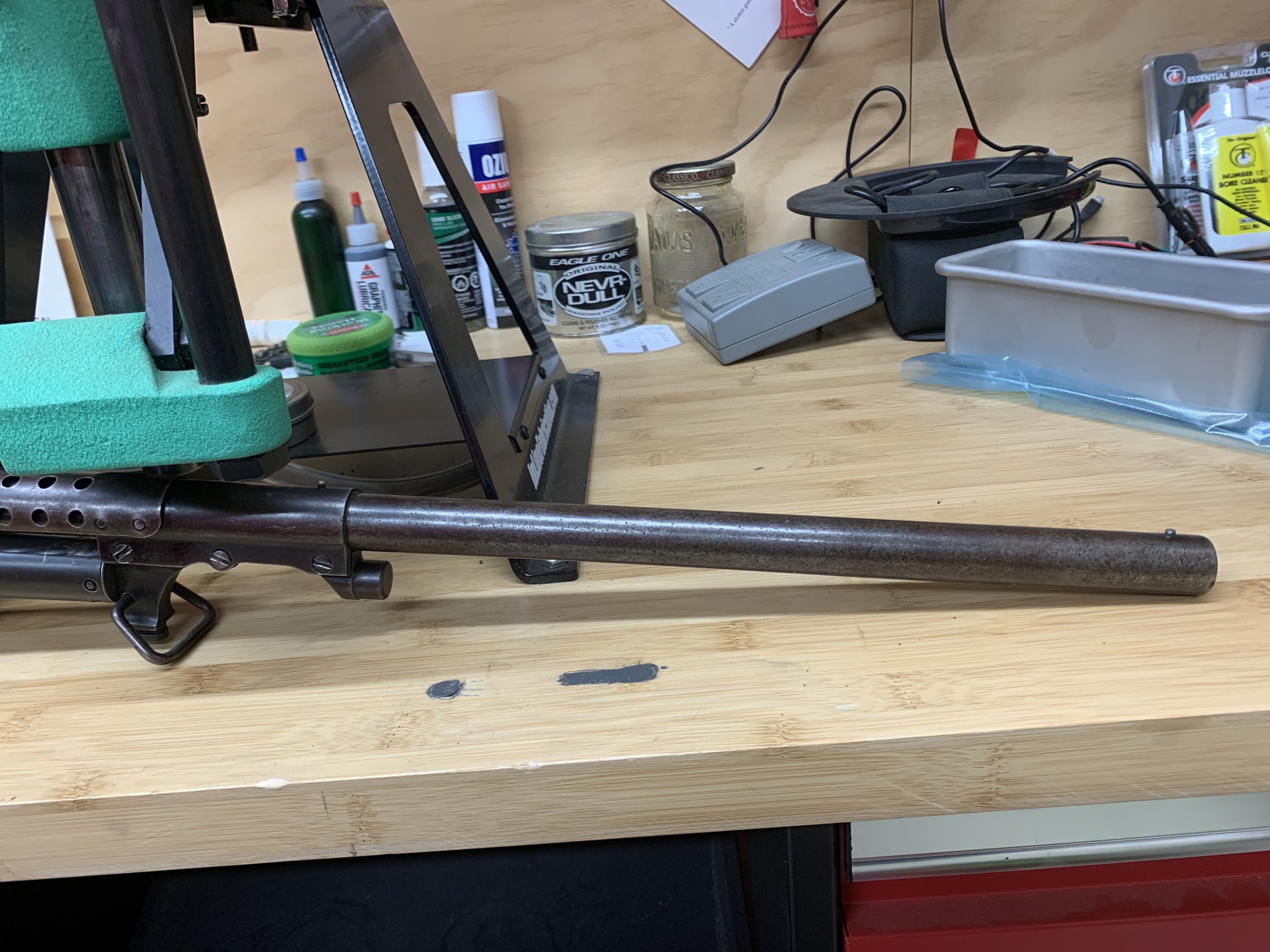

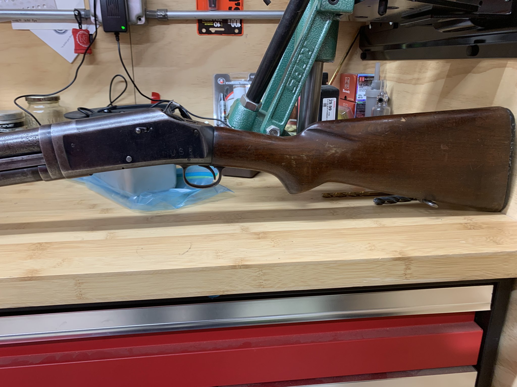

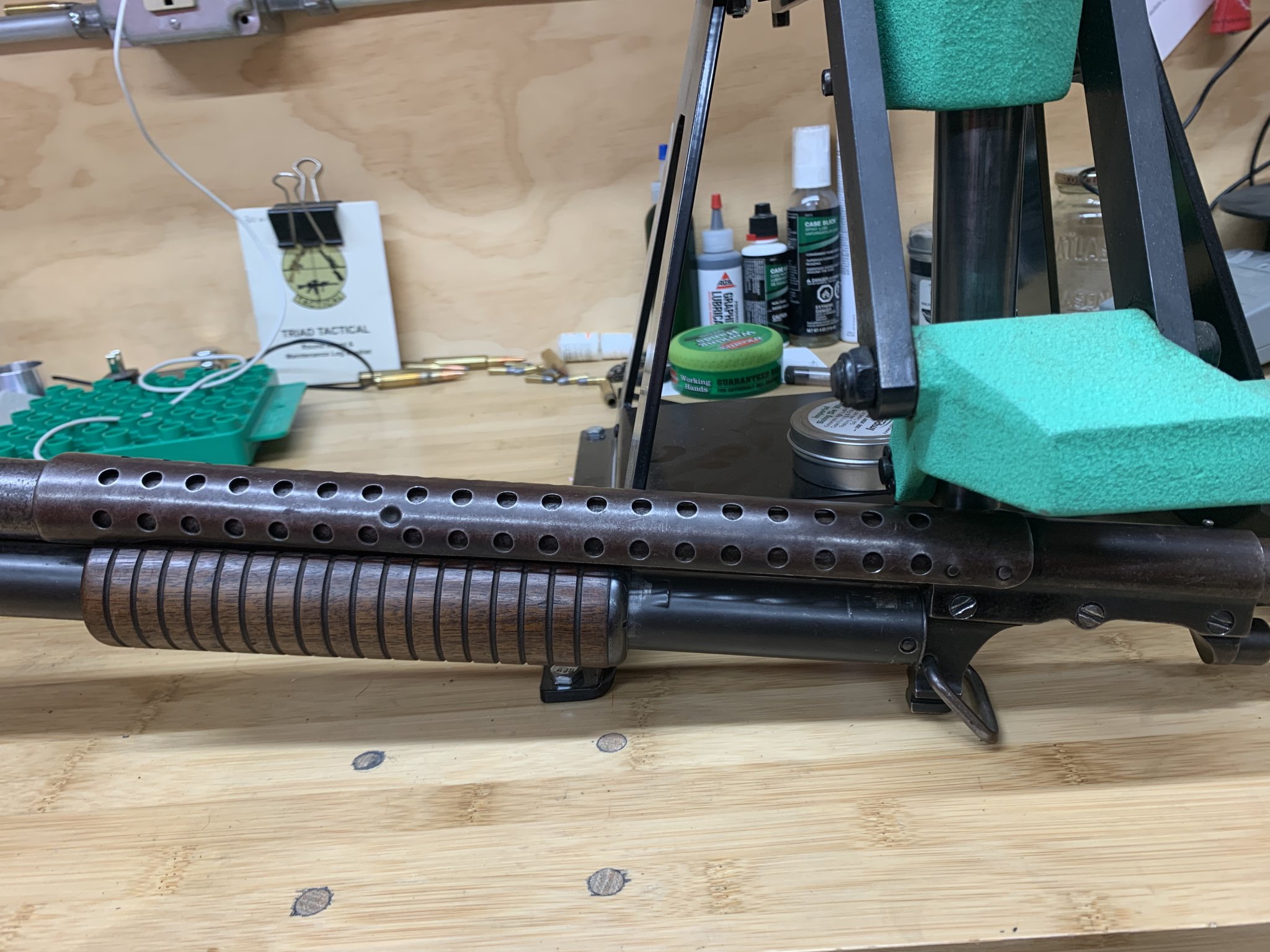

My father (KIA Camp Enari, 21 NOV 69) and his uncle were stationed in the Philippines at the same time for a short time. My great Uncle was a bulldozer operator and had uncovered a stash of weapons from the infamous "I shall return" time frame. They were able to assemble quite a few Model 97's from the rust pitted and otherwise destroyed remnants. I have the only one remaining in our family and it ain't going nowhere. It is not in mint shape but not bad either. I used it to shoot birds with as a 12 year old. It has a 32" full choke barrel!!! The barrel shroud, bayonet mount, stocks...everything else appear to be original to that shotgun. Now I'm seriously considering a restoration to the short barreled version and finding a correct bayonet.

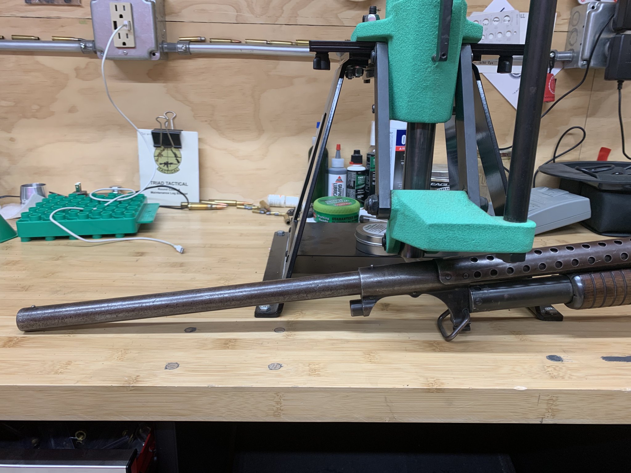

32" barrel with heat shield and bayo lugs? I'd like to see something like that
Thanks for spending more of my money.
@pmclaine maybe you can tell me more about this relic
Sold my 1920s-era, US marked Model 97 a few years ago. It was a nice representative example but just not my cuppa....
Sir, I am humbled by your estimation of my knowledge. I have fooled you sorry to say.
Looks like a takedown 97.
Unsure why the heat shield long barrel came together or how.
I do know a lot of long barrel mil guns existed and were used for aerial gunnery training but they tended to be semi autos and would have no need for a bayonet.
Maybe someone was putting together a repro but never got to the cut stage.
Any ordinance marks on it?
What's the butt pad, well used or some civilian replacement?
PS - Went back and saw the US/ bursting bomb.

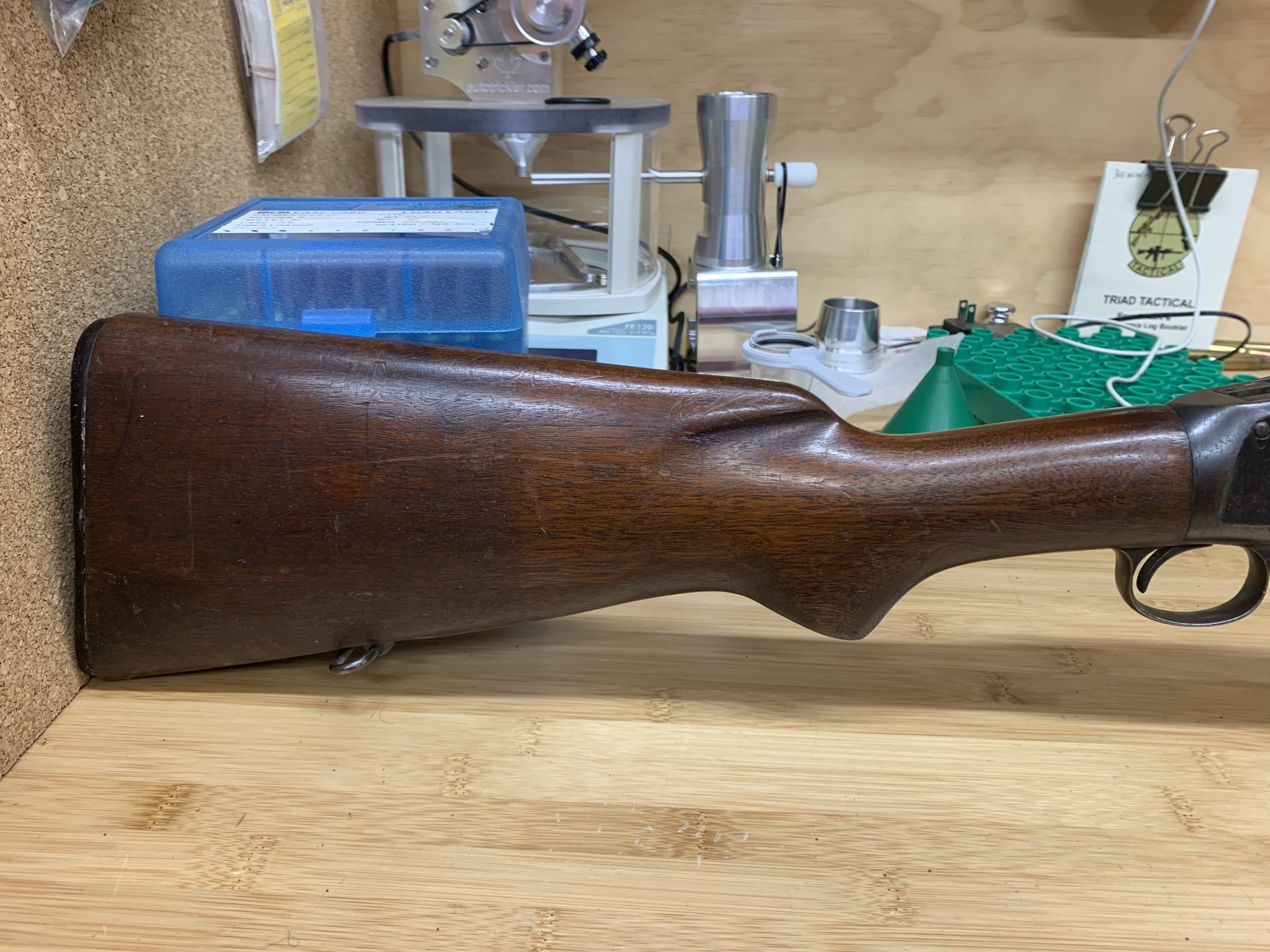

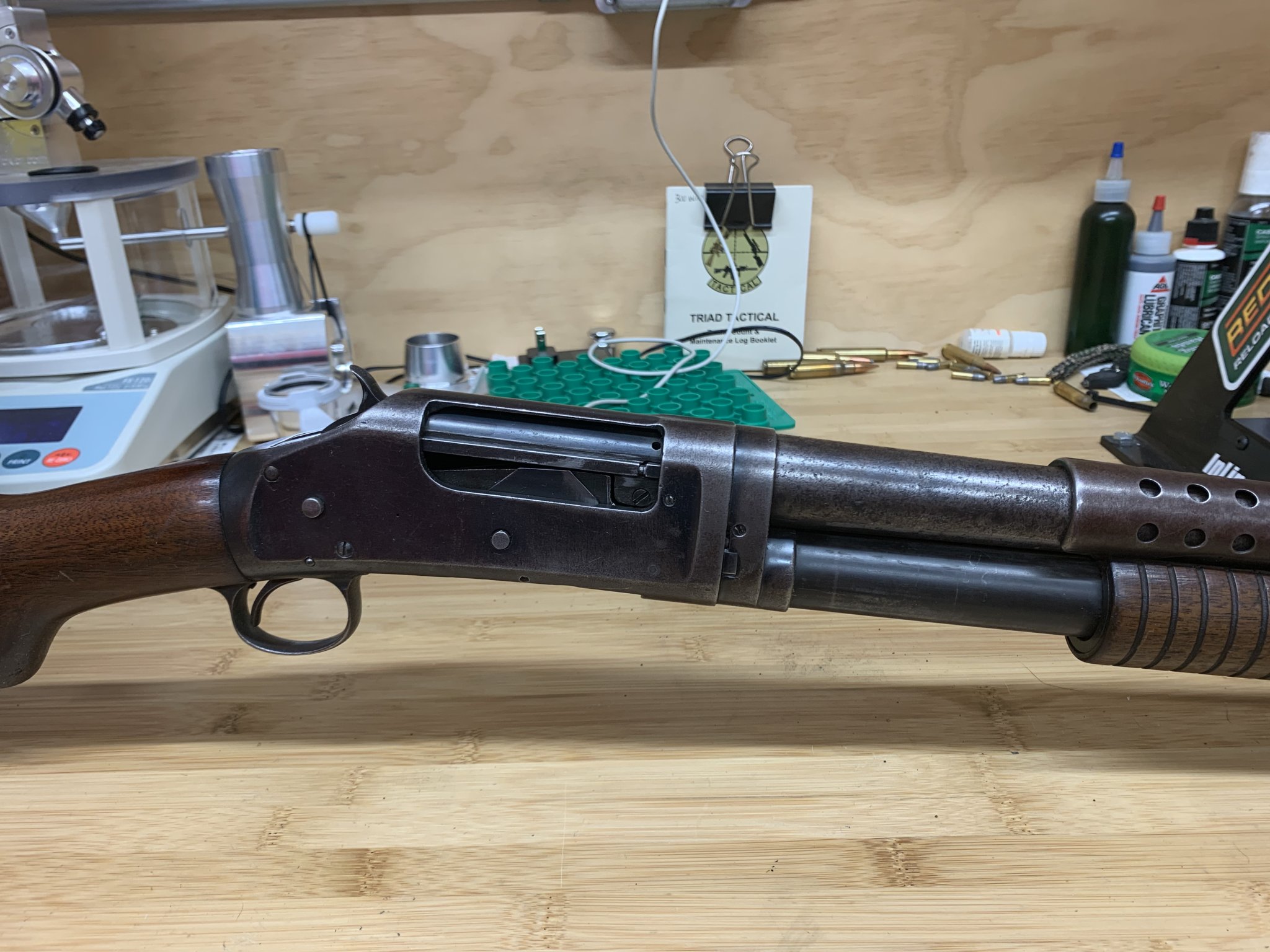

Of the several that made it back to the US in the care of my dad and his uncle, this one was said to be in the best condition as far as the pitting of the receiver.
The barrel shows more pitting than the parts mated to it which is why I believe the barrel came from another shotgun. I read decades ago that the 97 could be had with up to a 32” barrel and pretty much any choke. Also read that use of weapons originally intended for the civilian market was commonplace. My guess, and that’s all it can be, is this barrel came off a civilian shotgun.
I’ve never once considered altering it until this thread by @buffalowinter. Even now I debate whether to leave it as is with the scars and patina but taking it back to 20”, cleaning up the metal and bluing and finding a correct 1917 bayonet would also be cool.

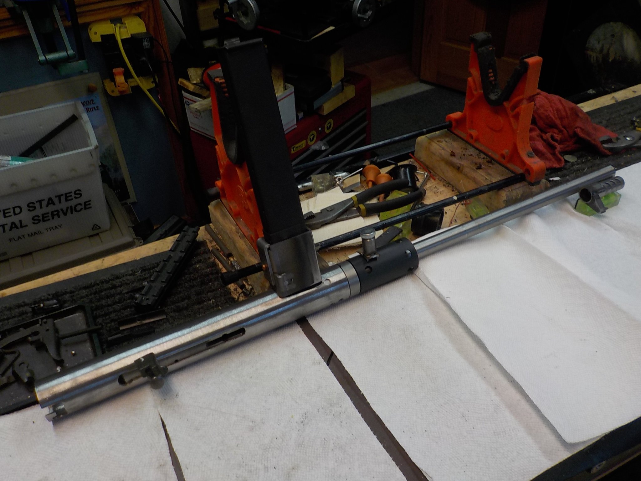

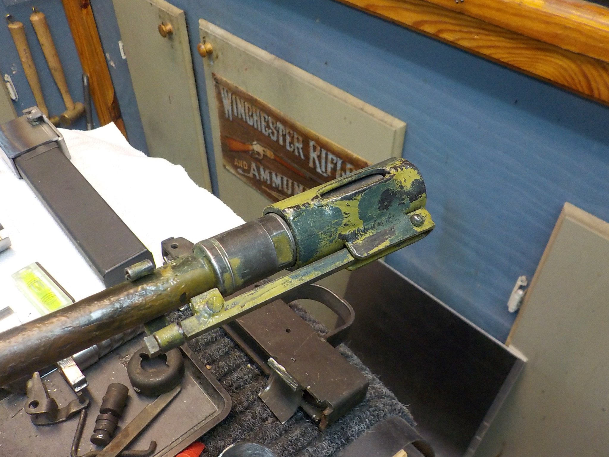

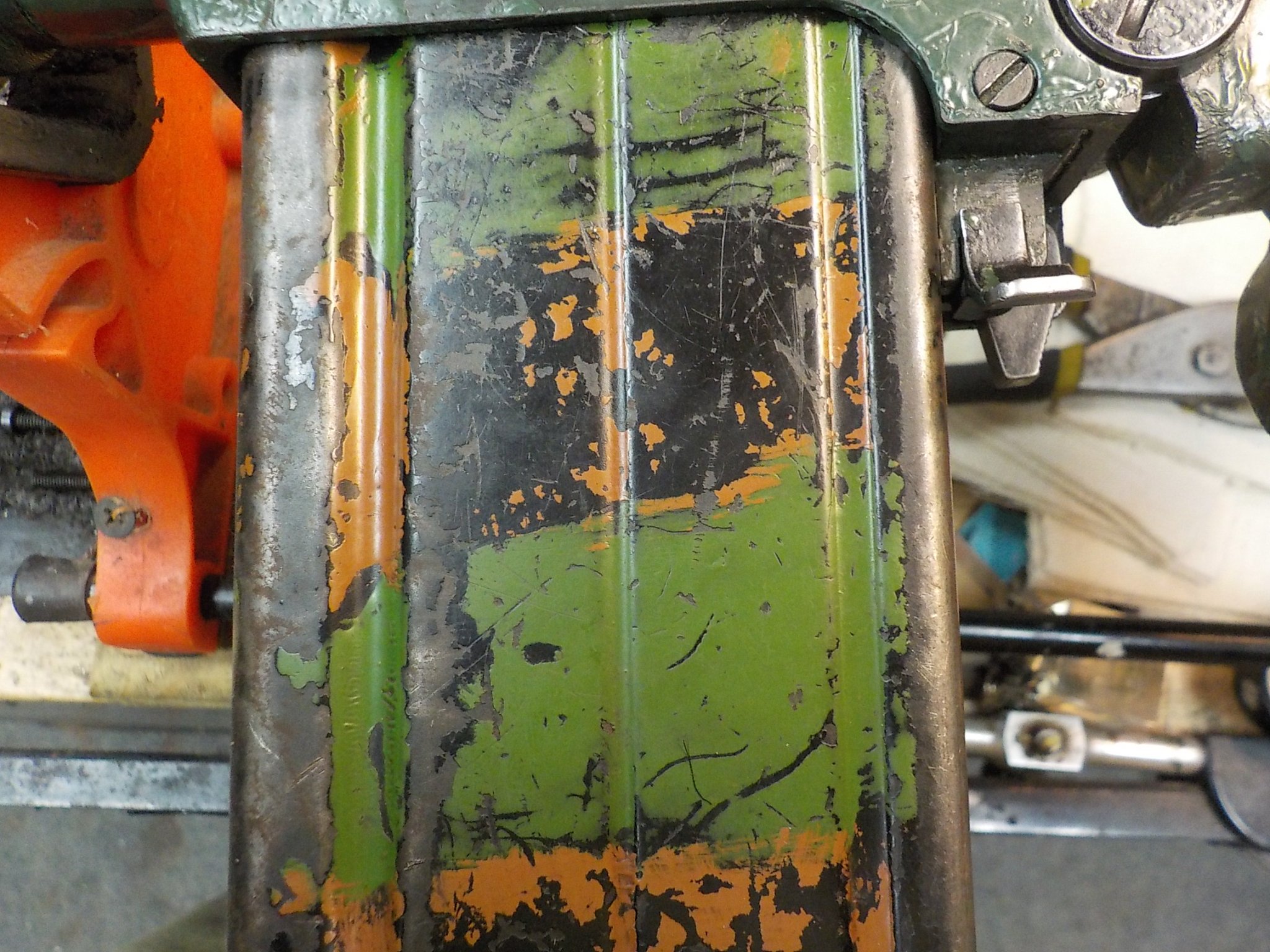

Starting work on the Owen Semi-Auto "SMG". Pretty complicated as the vertical feed means I pretty much have to make a new bolt. Trying to modify one right now, but it's pretty rough. The little stove pipe in front of the magazine is the barrel screw. It's just for show on mine, I'm welding a barrel trunion in. Nice concept, vertical feed and bottom eject gets gravity working for you, probably don't even need an ejector...but it serves as a bolt guide. I don't know why they didn't offset the mag a little to the left so you wouldn't need offset sights. I'll start a separate thread as work progresses. I'm also working on my British WWII Paratrooper folding bicycle and a Winchester Model 12 trench gun.

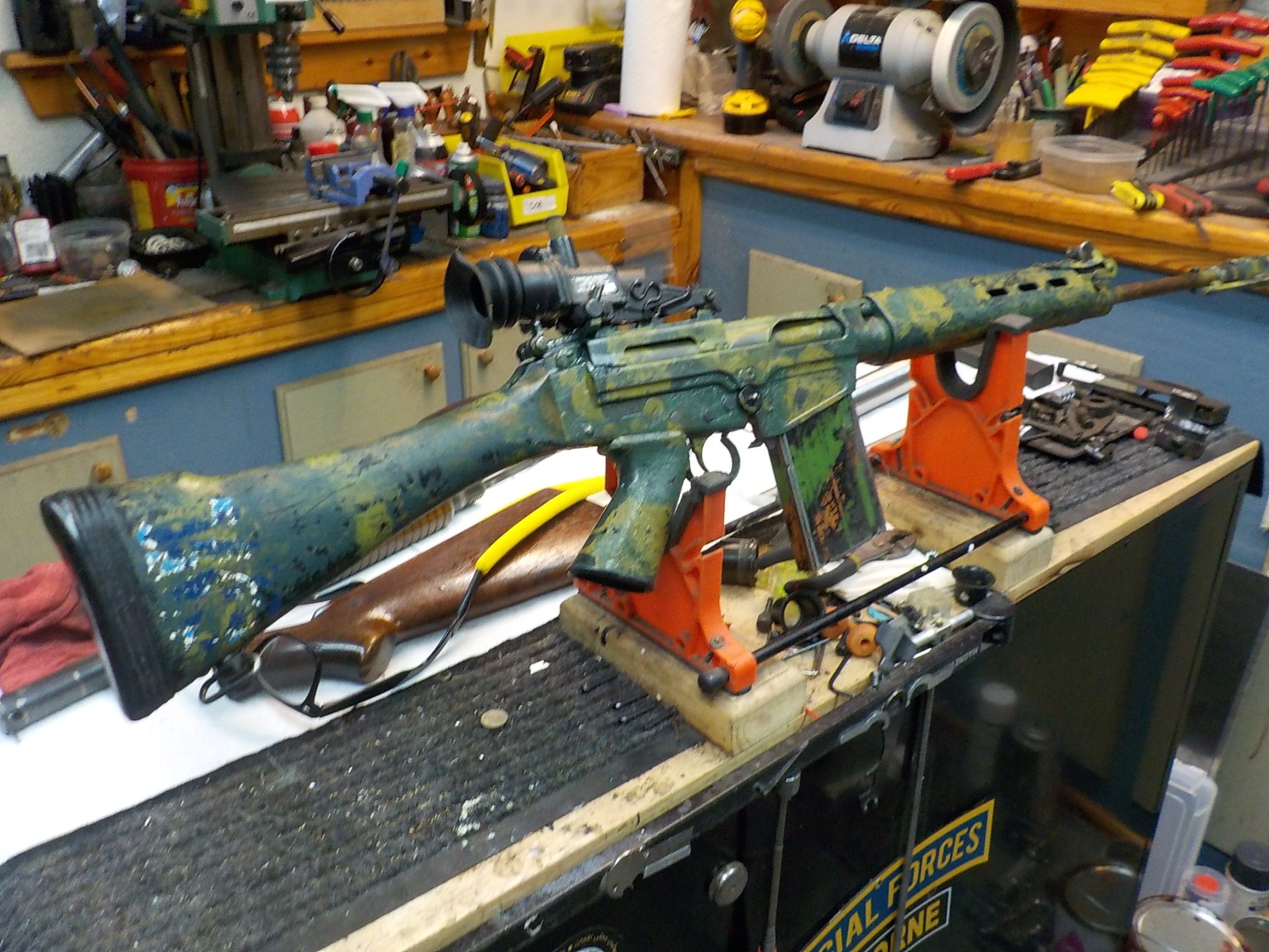

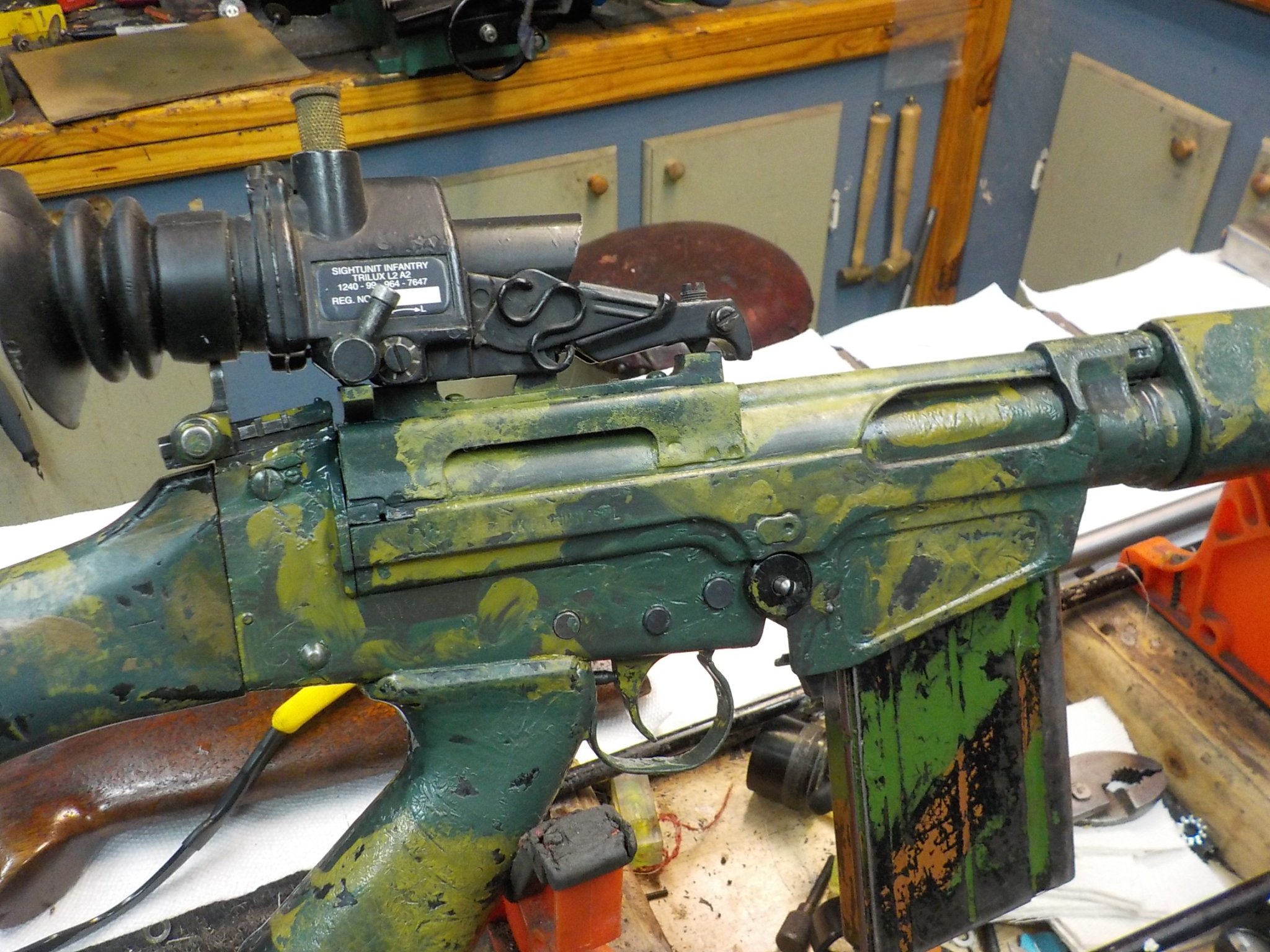

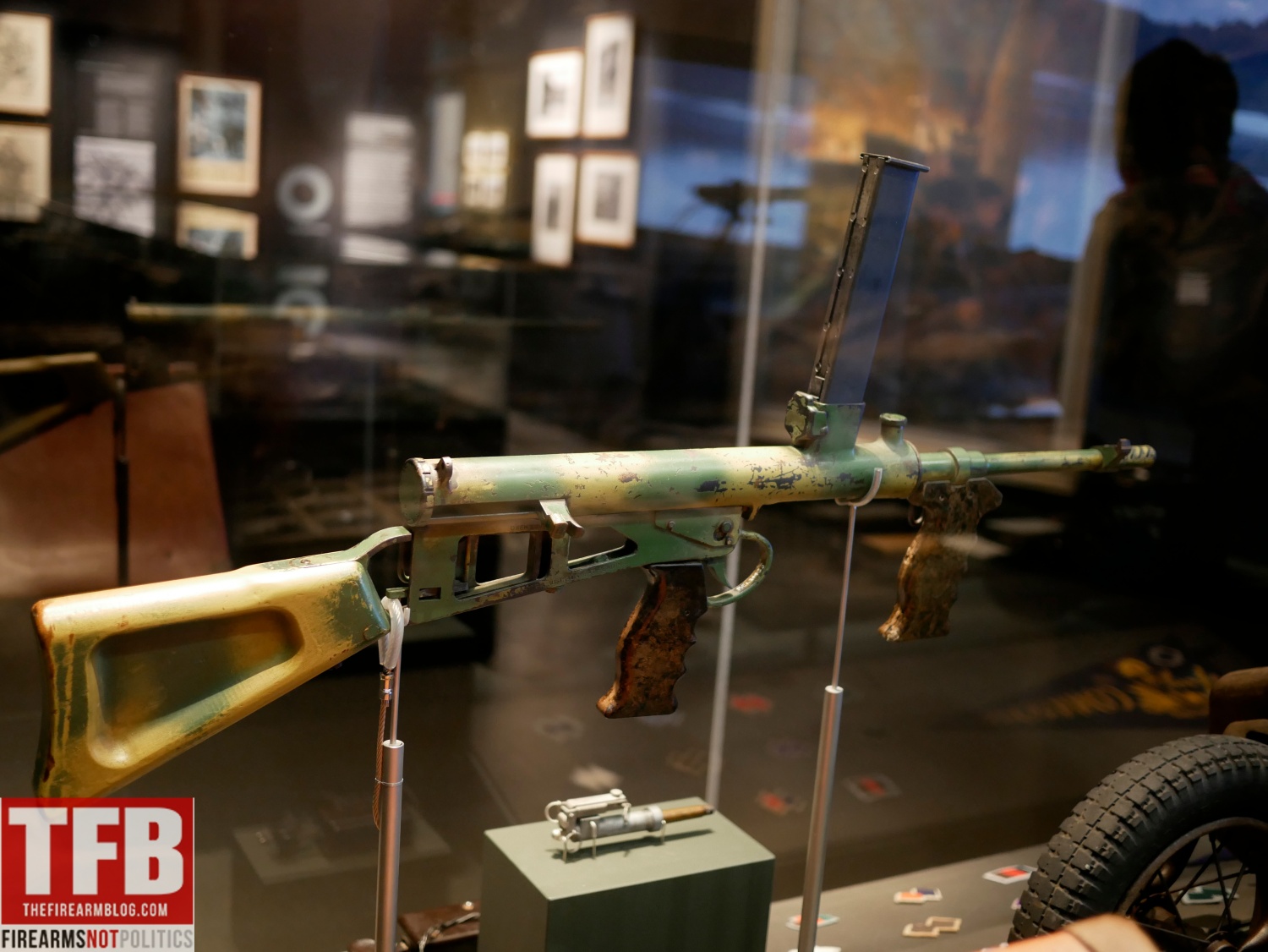

you going to paint that in the original Neon camo?
I'm going to paint it in the original camo colors. The gun in your pic isn't matched very well. I have some professionally matched colors left over from a Rhodesian FAL that I built. My FAL came out of South Africa but there is some evidence it was first in Rhodesia. Many original parts, lower, stock, magazine, and Halbeck device (muzzle brake) which is pretty rare.

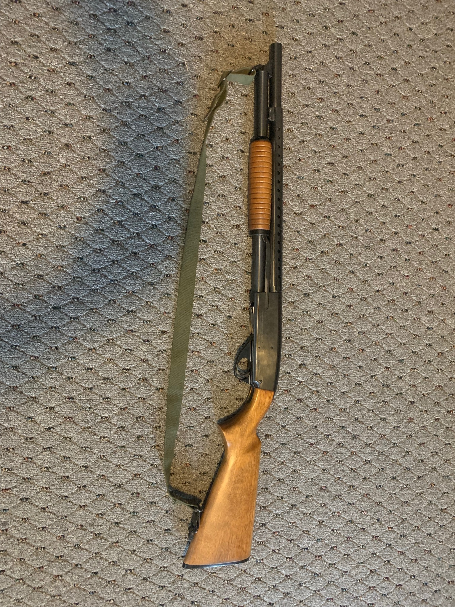

Model 37, the shotgun my father bought a year before he died. Spent my last day with him, duck hunting. Got me one, with that same Model 37.

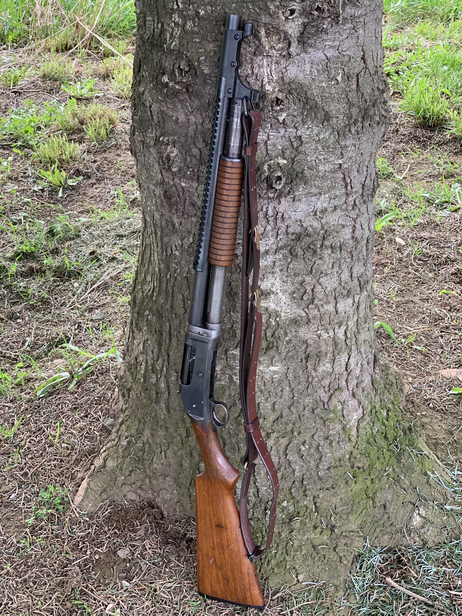

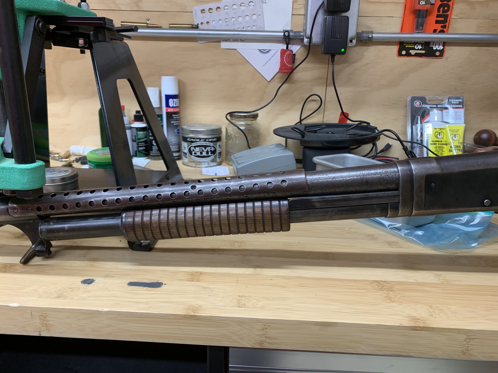

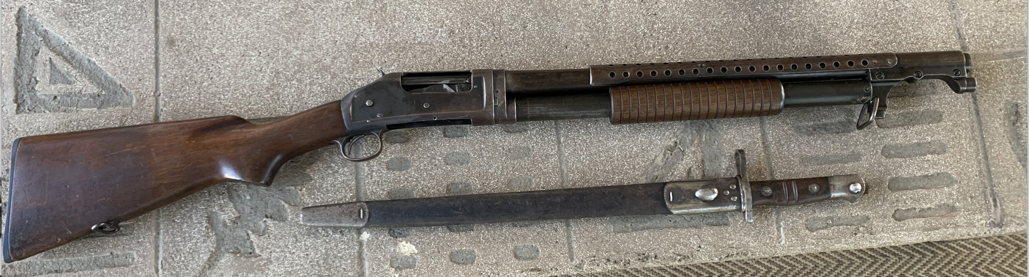

Wellllllll....UPDATE.
To correct @Charger442 on only one point, the serial numbers do, in fact, match.
I never considered this as anything more than a family heirloom, even if it HAD been on that island in the time discussed. The problem is, this shotgun was manufactured about a year after that fateful date when MacArthur left about 4000 Marines to the hands of the Japanese. I will leave that thought to marinate.
That being said, this shotgun MAY have been in the Philippines circa 1957-58 when my dad and great uncle were stationed there. It is also very possible that the great uncle did uncover a pile of weapons stashed in a hastily dug ditch because hiding the stuff in a ditch did happen. It may very well be that this shotgun had a 30 some inch full choke barrel installed from one salvaged from said ditch, but the receiver and barrel extension were never in that ditch.
So, I decided to make it as original as I could. I looked all over for a correct Winchester barrel. That is not a fast and easy item to find. I almost had decided to have the long barrel cut to the appropriate length when I came across http://bullcreekarms.com/ and they happen to be not very far from me at all. They located a correct barrel, replaced a few dinged up screws and made sure the action was all gtg. I will add a Turner sling and am planning to launch some bird shot over the next day or 3.
I am very pleased to have this join the other WW2 weapons of mass destruction in my collection.
@pmclaine, @buffalowinter

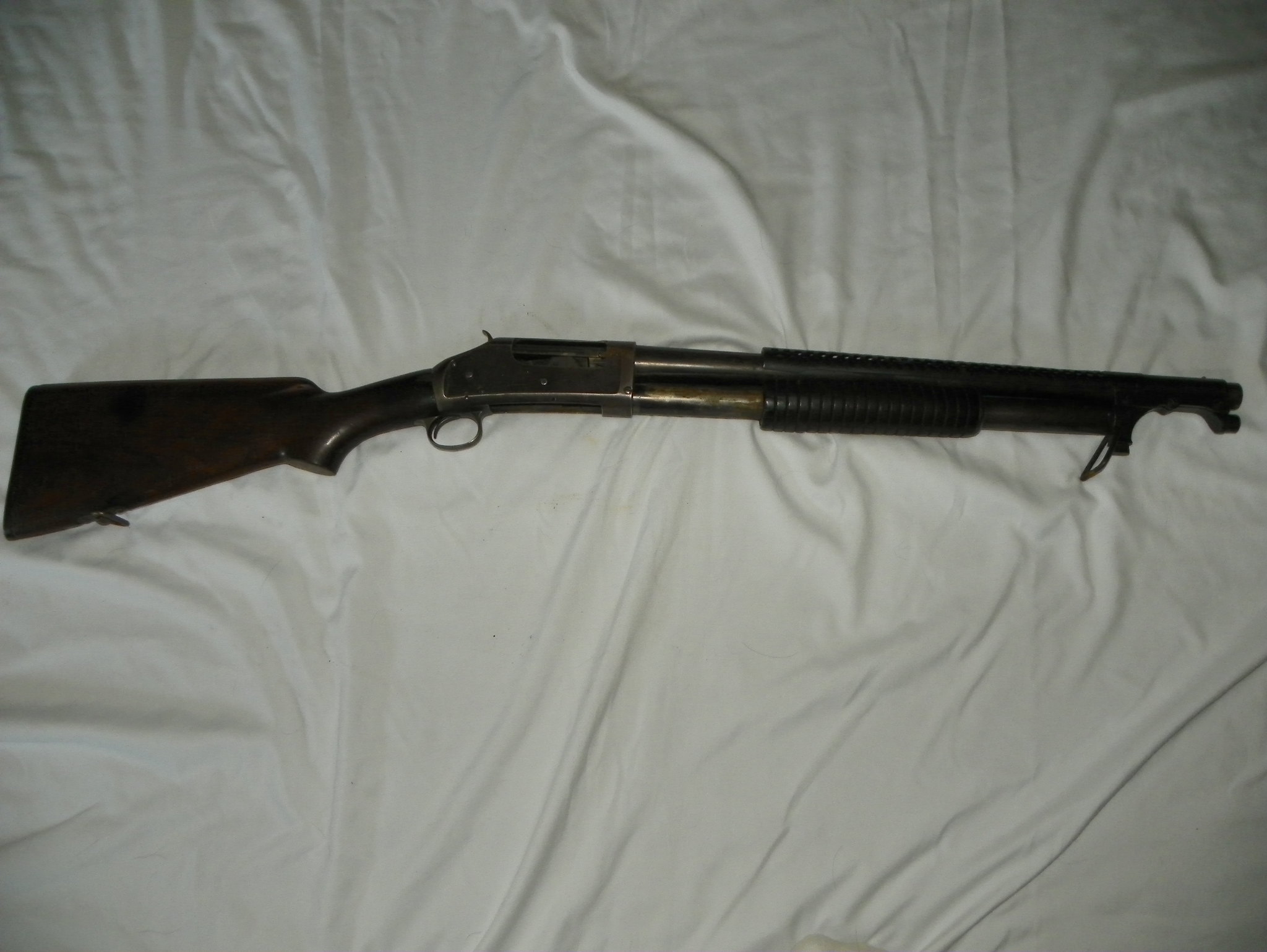

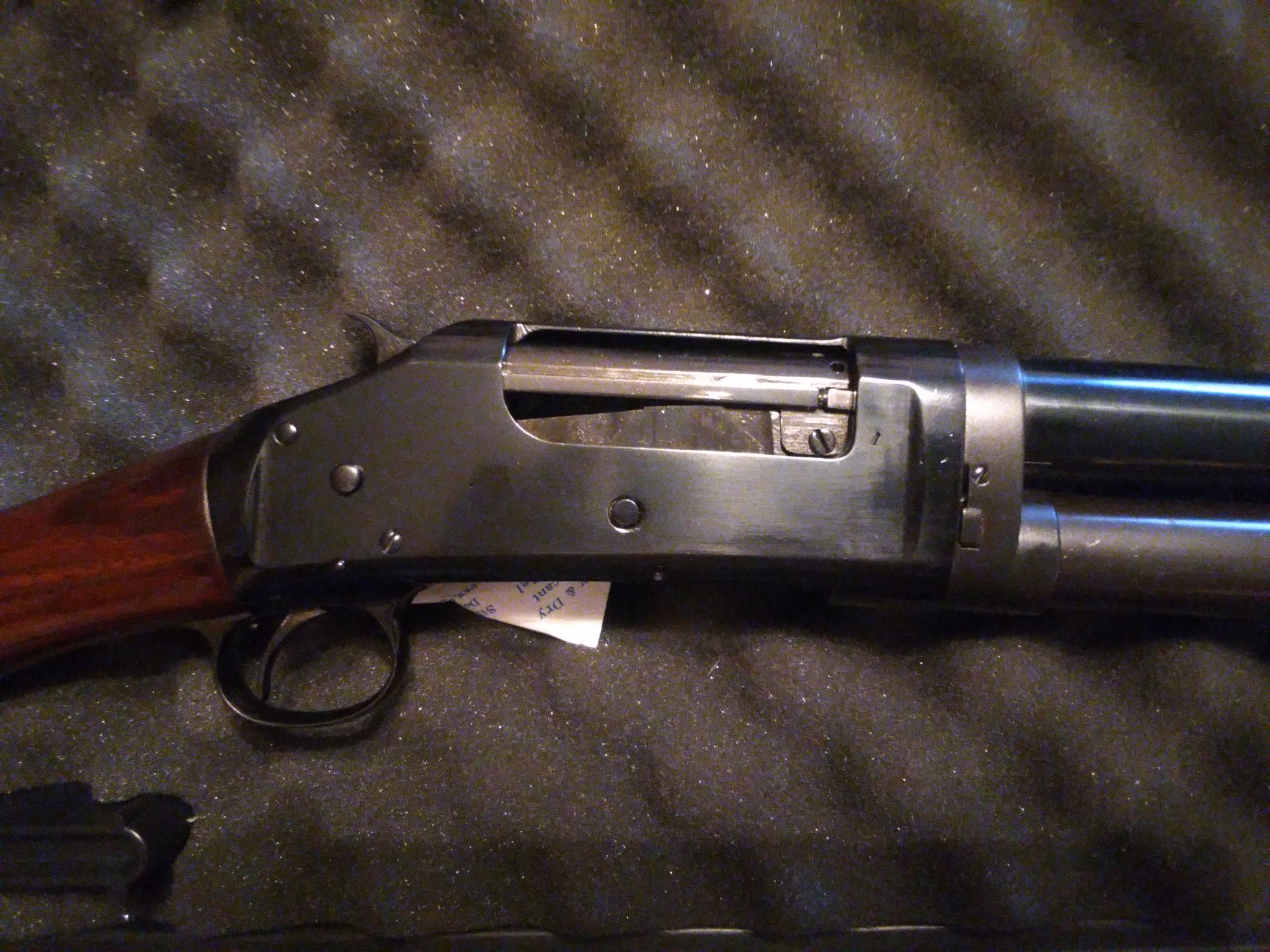

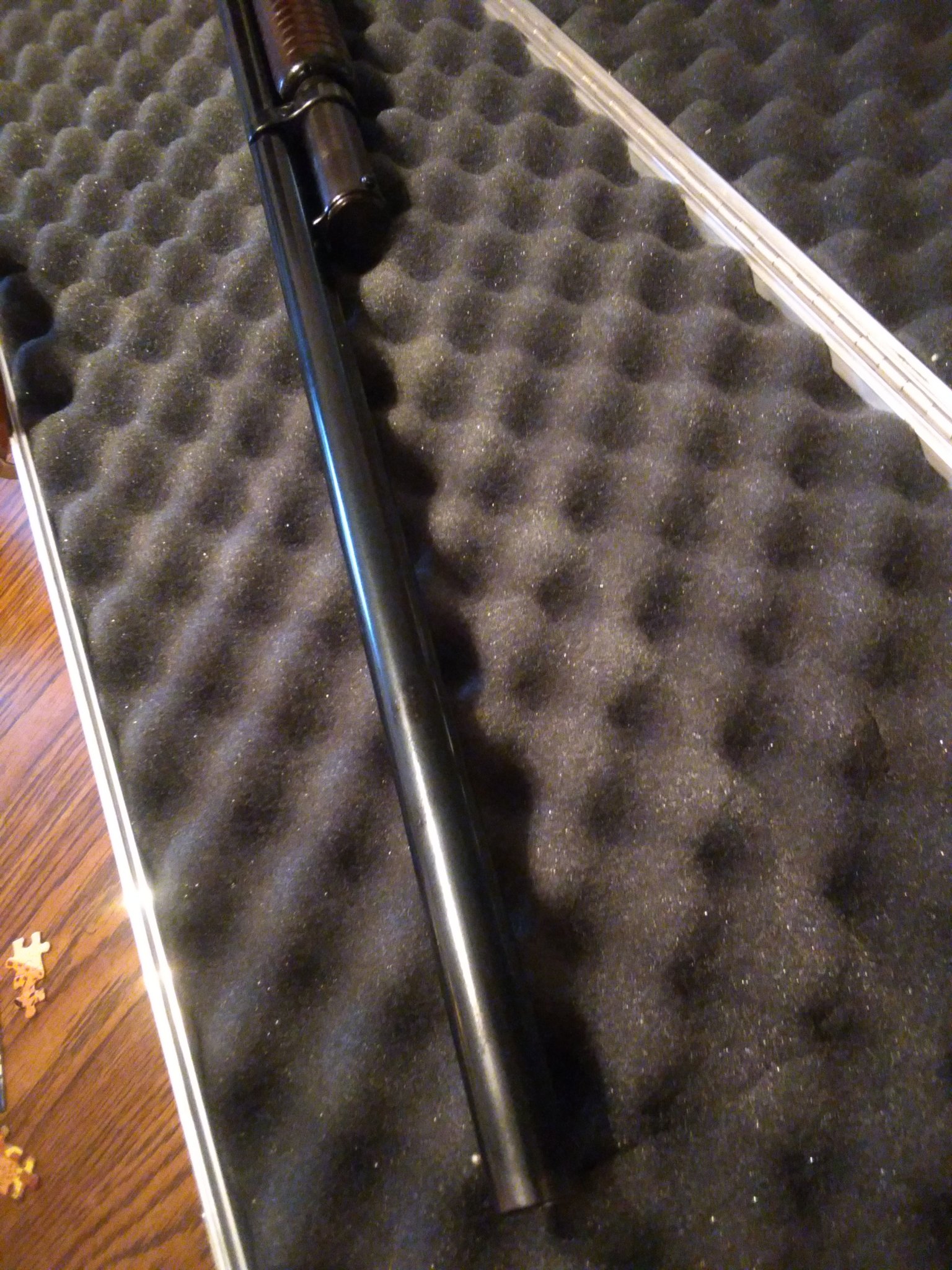

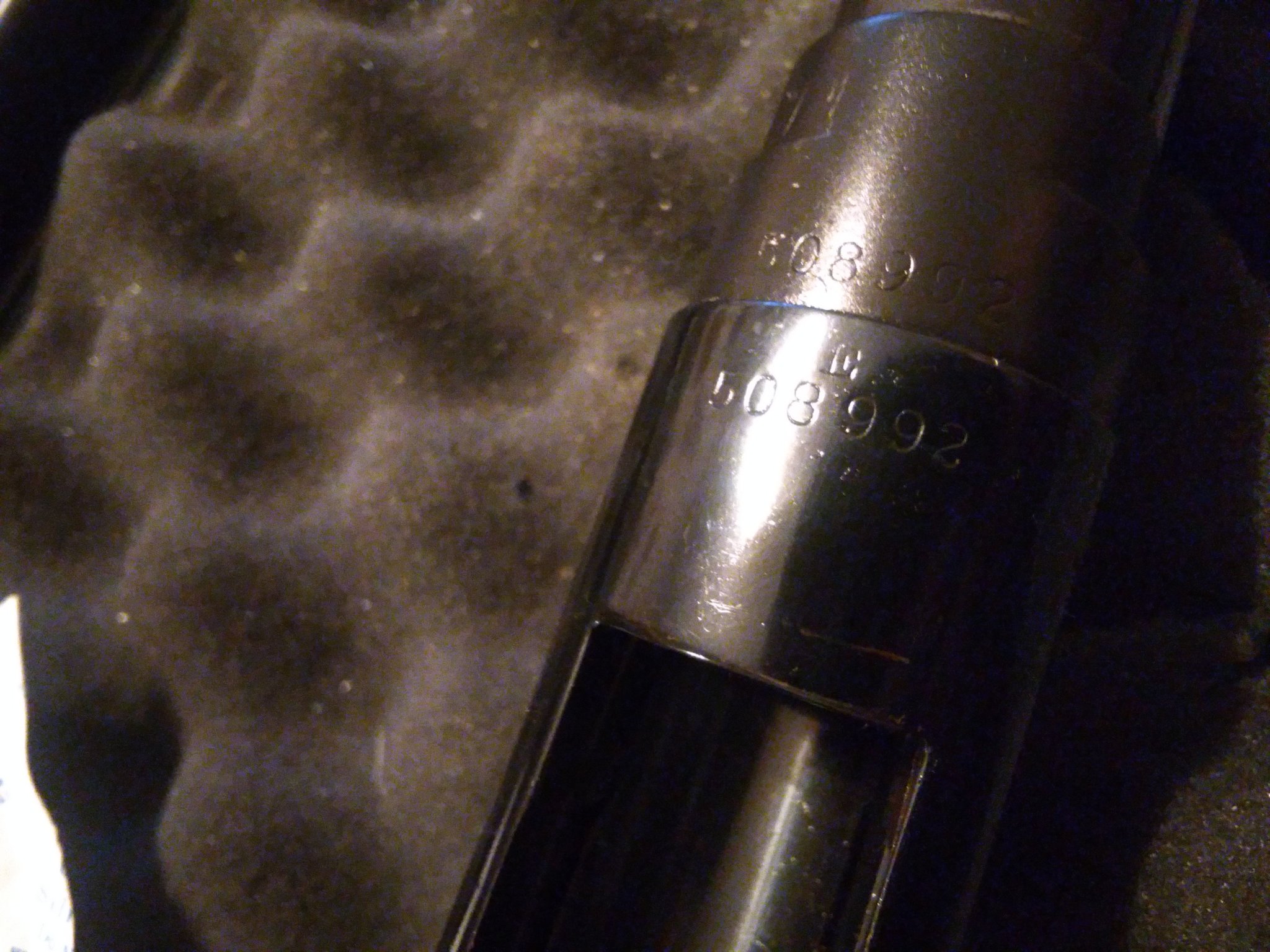

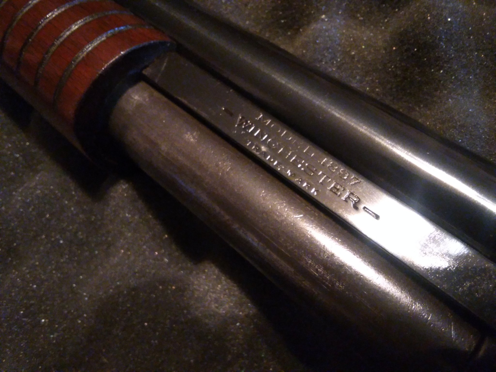

Hey, check this out... ..not in trench gun form...but you know...
Anyways... This really is a great post, and your builds are awesome. They're good enough that they got me up, out of the chair; and pacing around while I checked them out.
Sound the Charge.

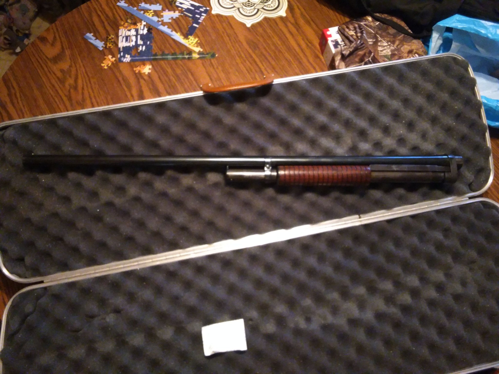

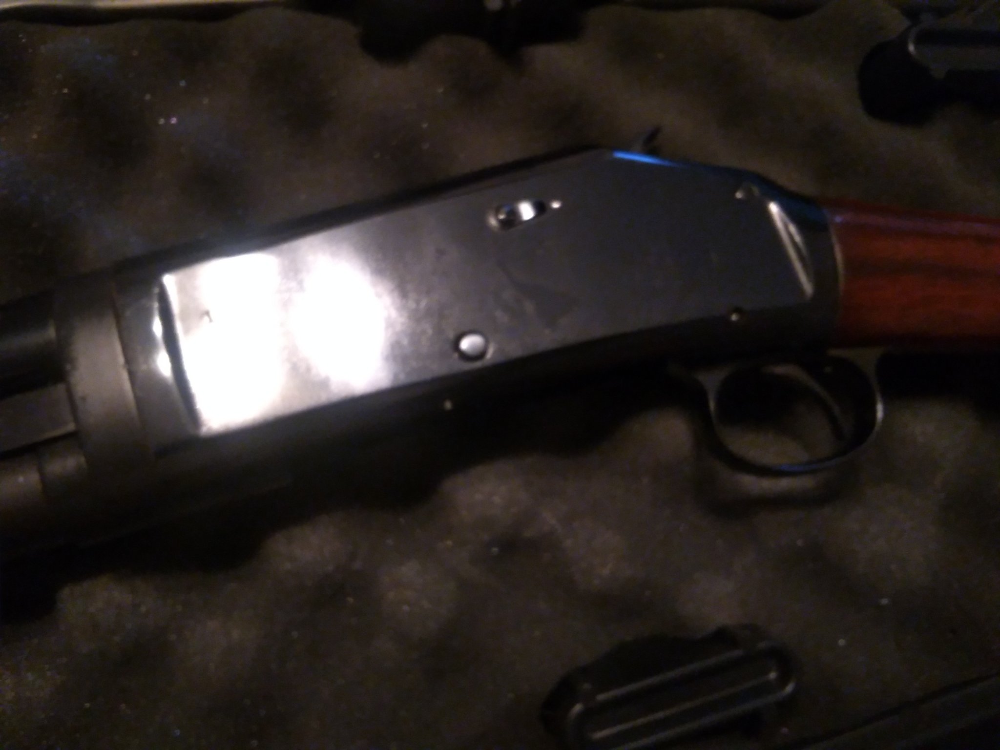

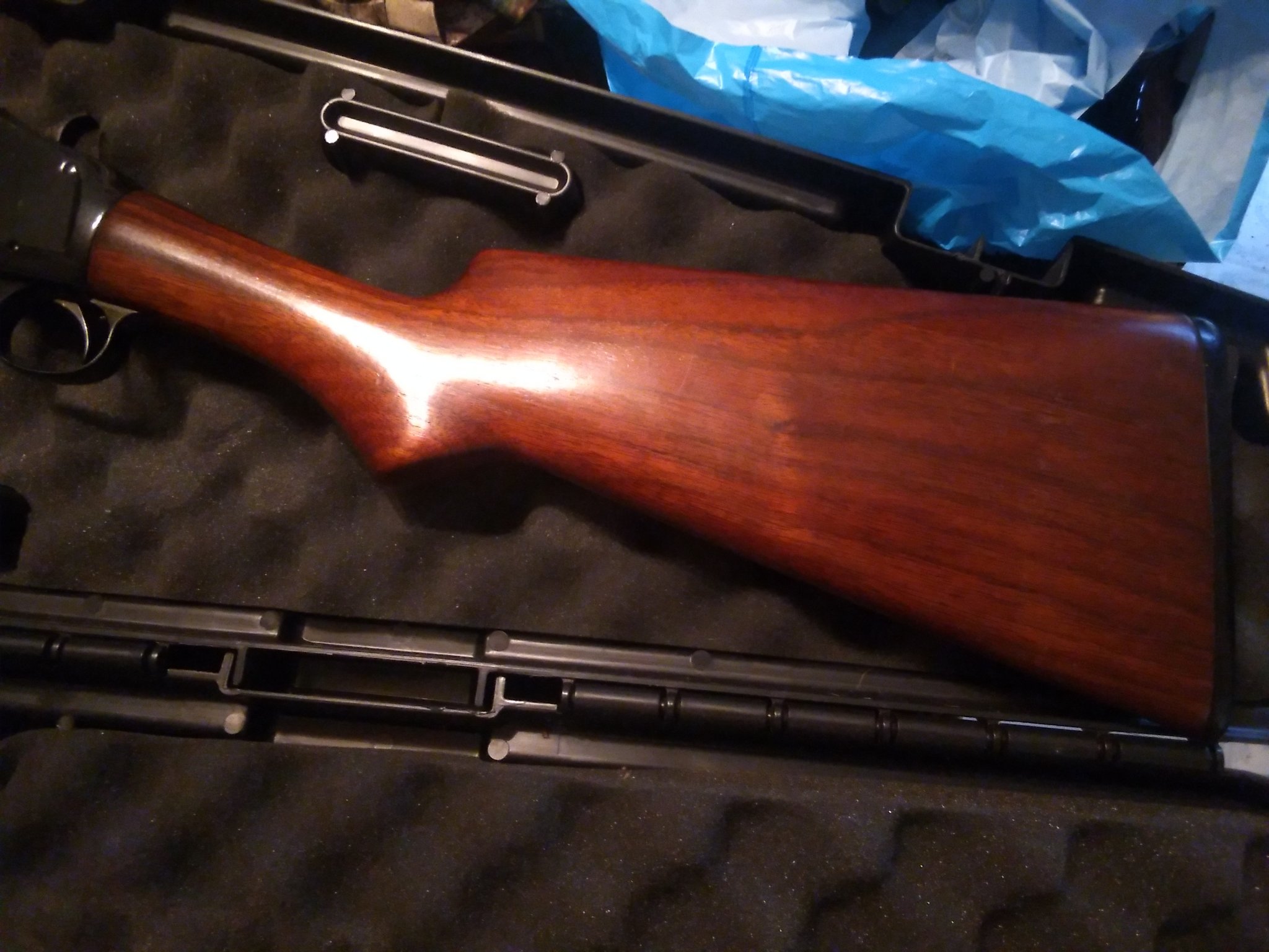

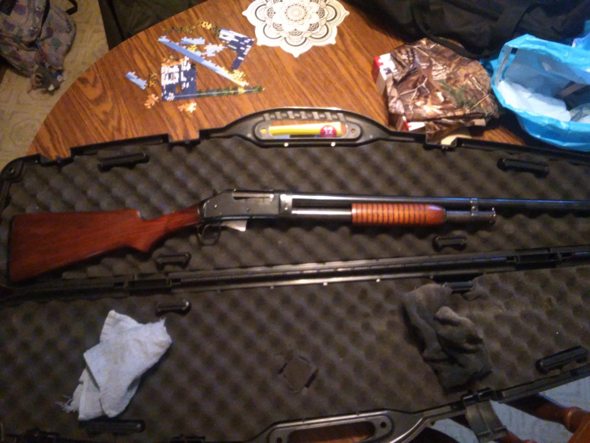

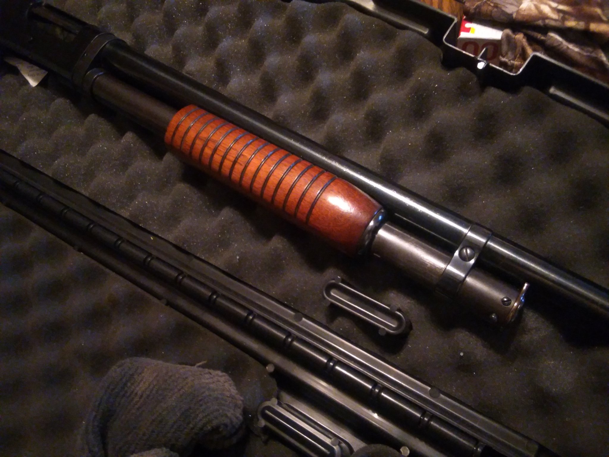

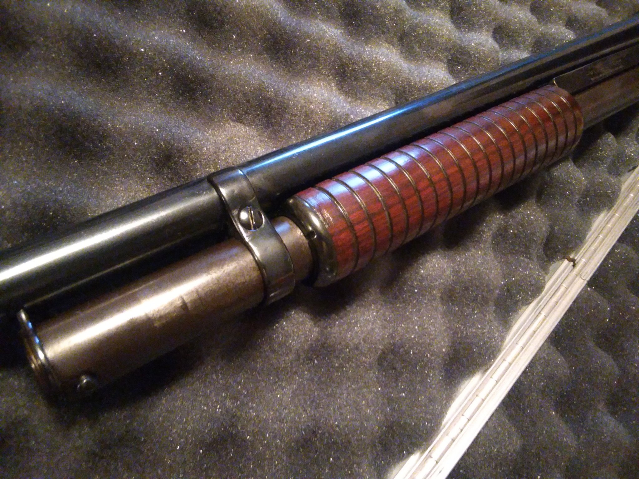

GREATO POSTO!
Sound the Charge.

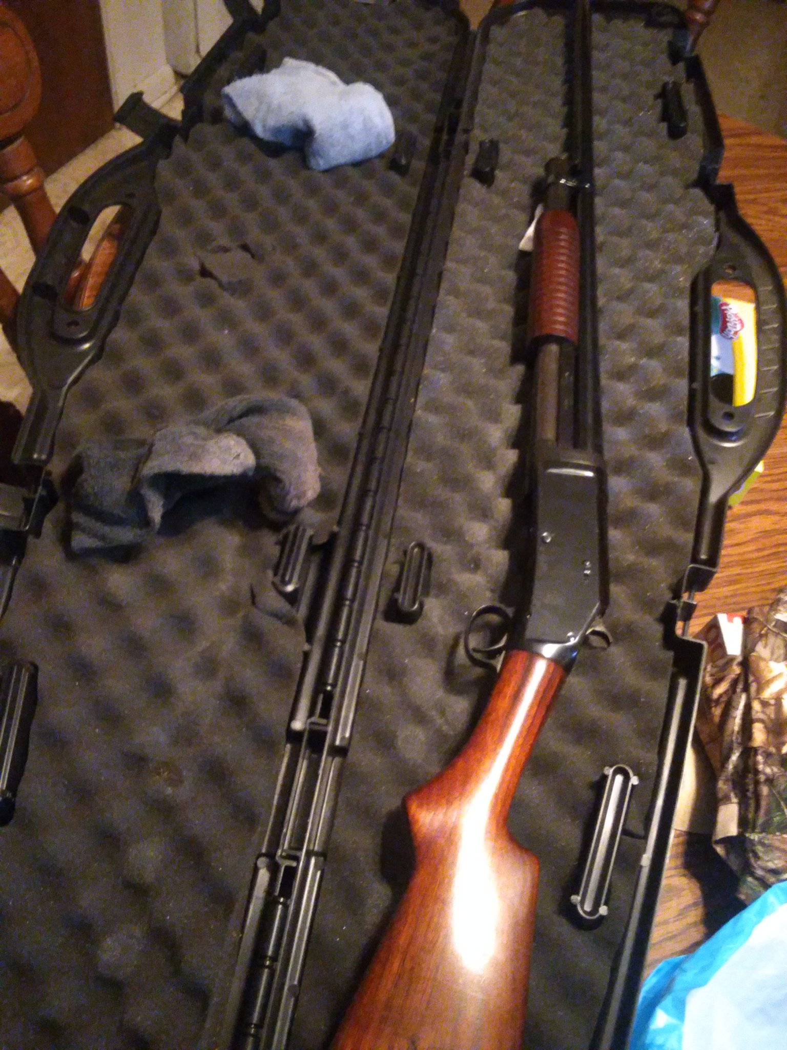

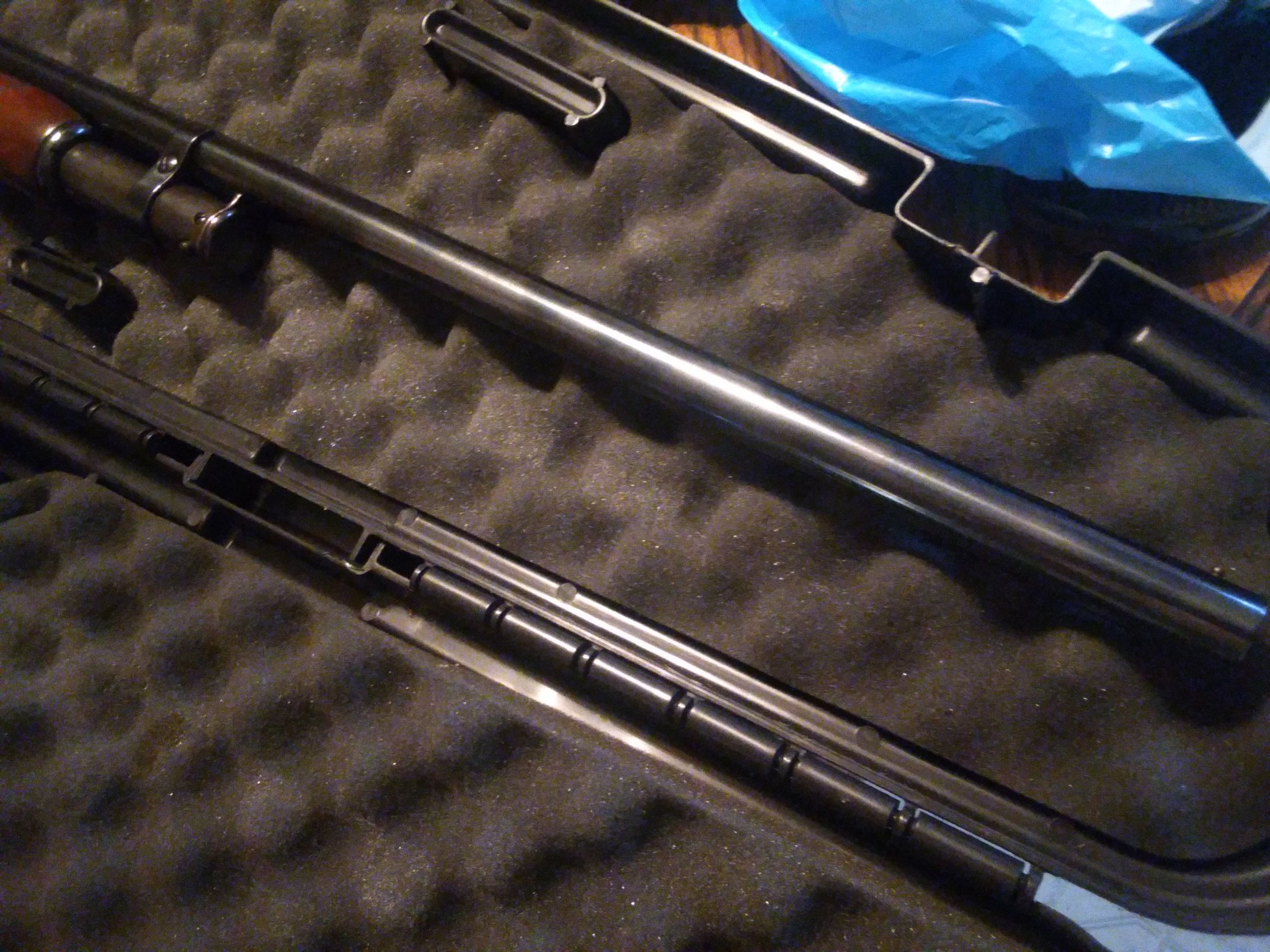

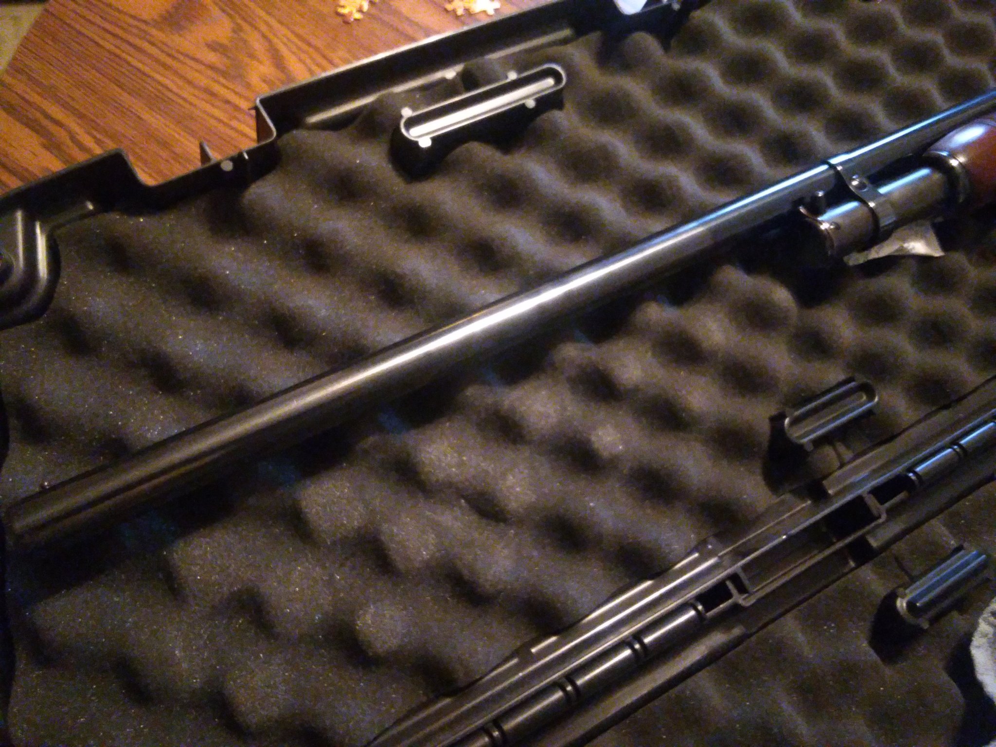

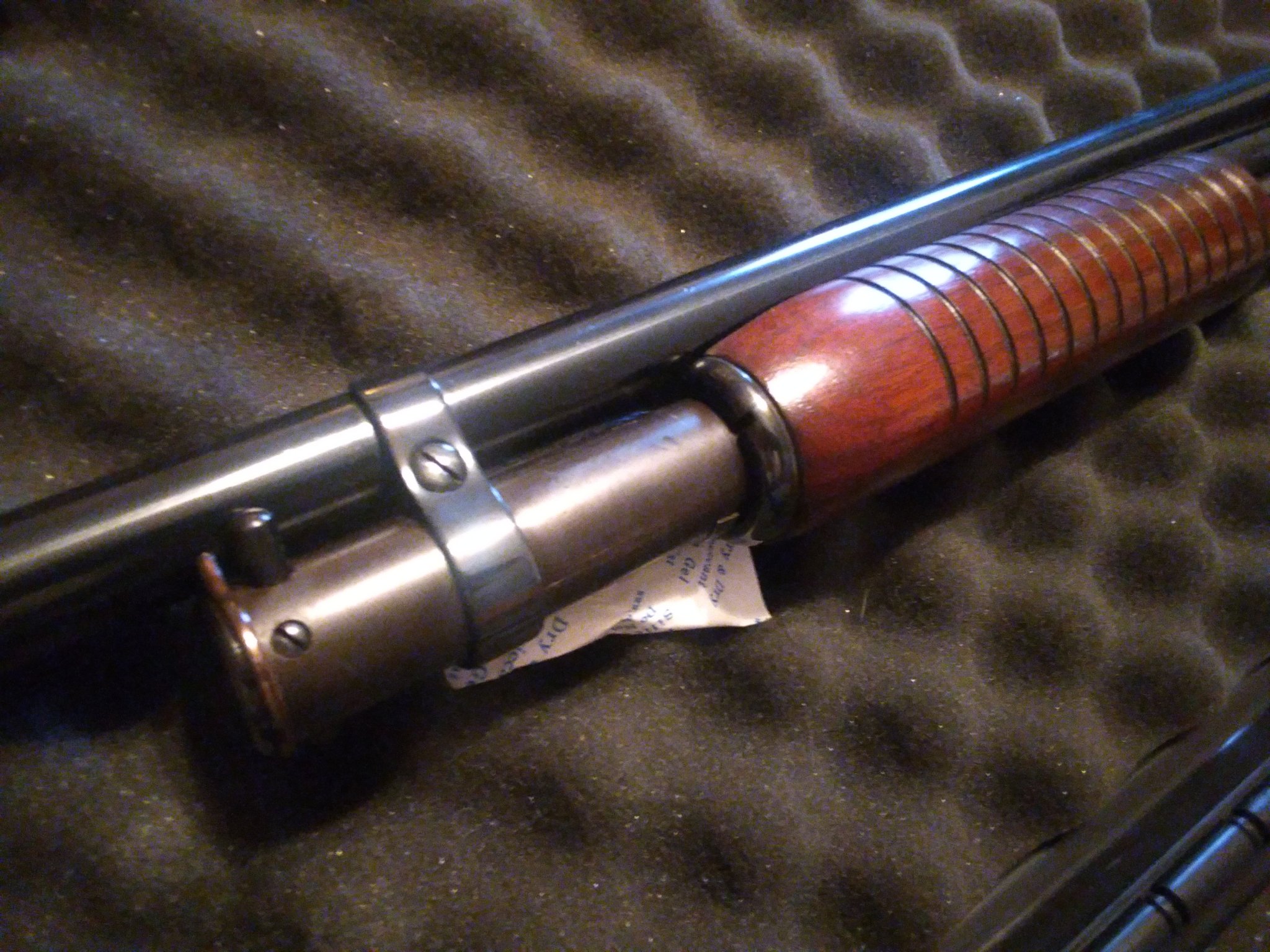

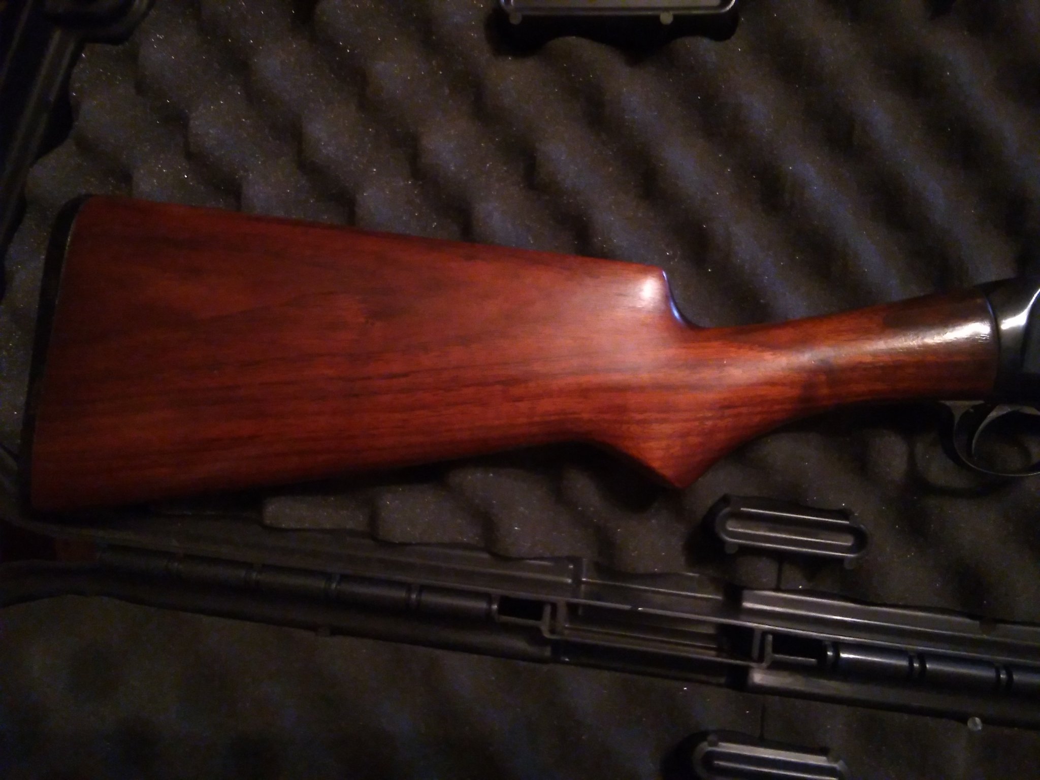

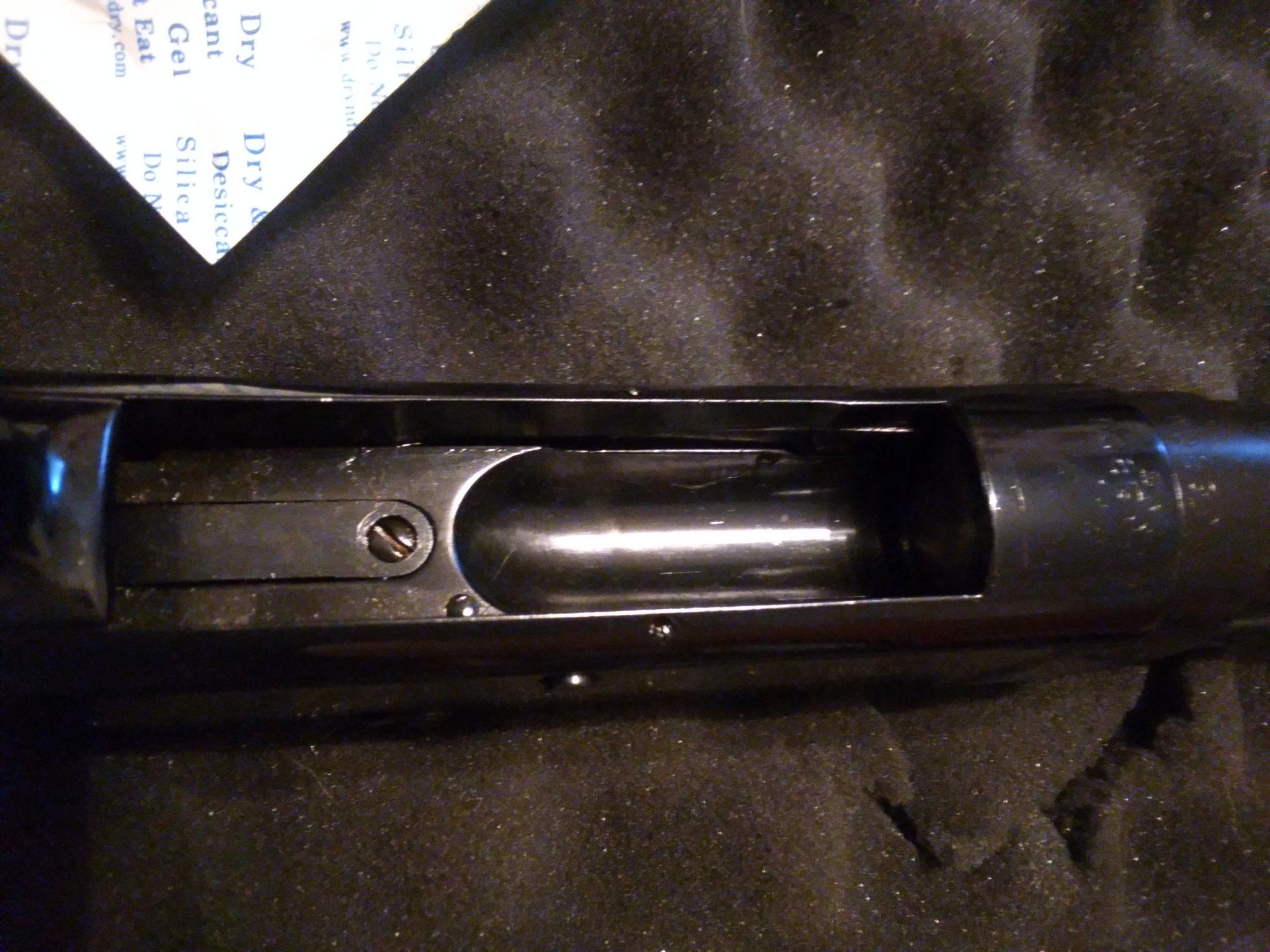

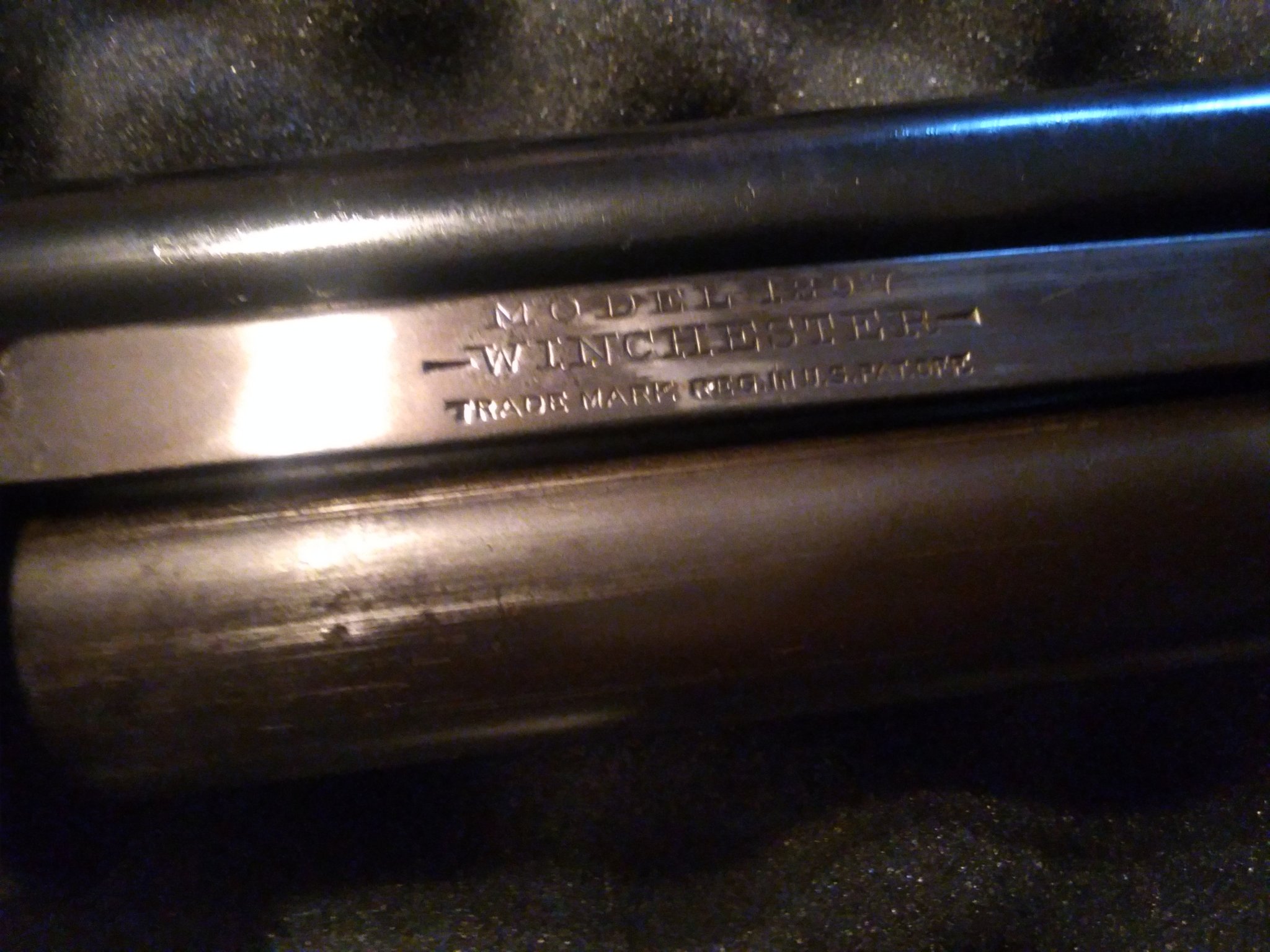

If that hasn't been refinished that is an extraordinary example.
Thank You. I don't know if it has been refinished or not, but looking at it; I can't help but think that it has to have been. It's an early-ish serial number... 500xxx-something...that you can see. .... The little specs on it, on some of the pictures is just lint, and dog hair... It wipes off. I don't know how the dog hair gets through the case, but it does.
I keep the surface pretty well wiped down, and I have been meaning to strip the grease off; and start keeping it treated and Renaissance wax rather than Lucas gun oil.
I will say this... You can see, up by the tang, where the wood has been stained over time with oil. It was like this before I got it. I try real hard not to get any oil on the wood.

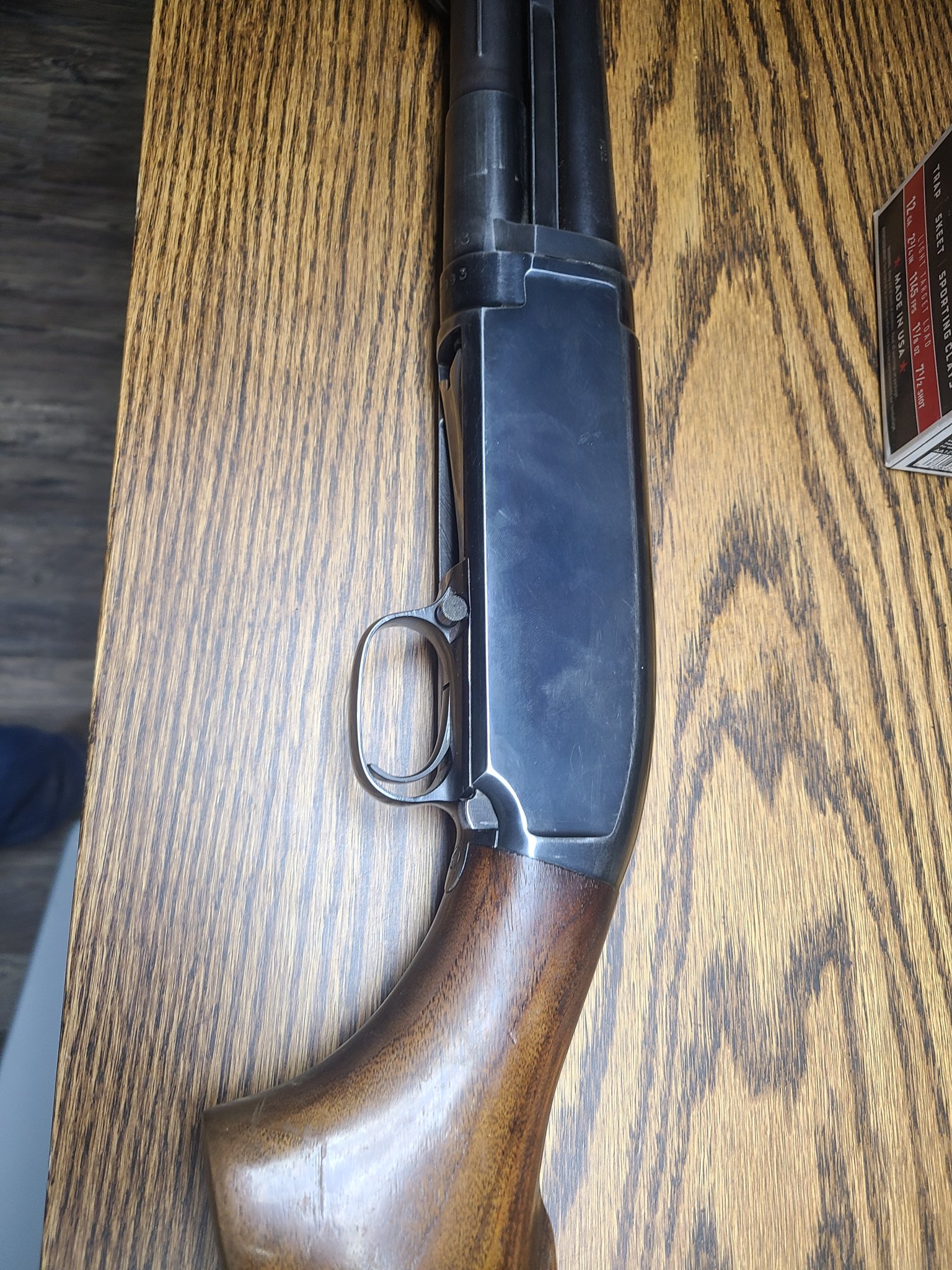

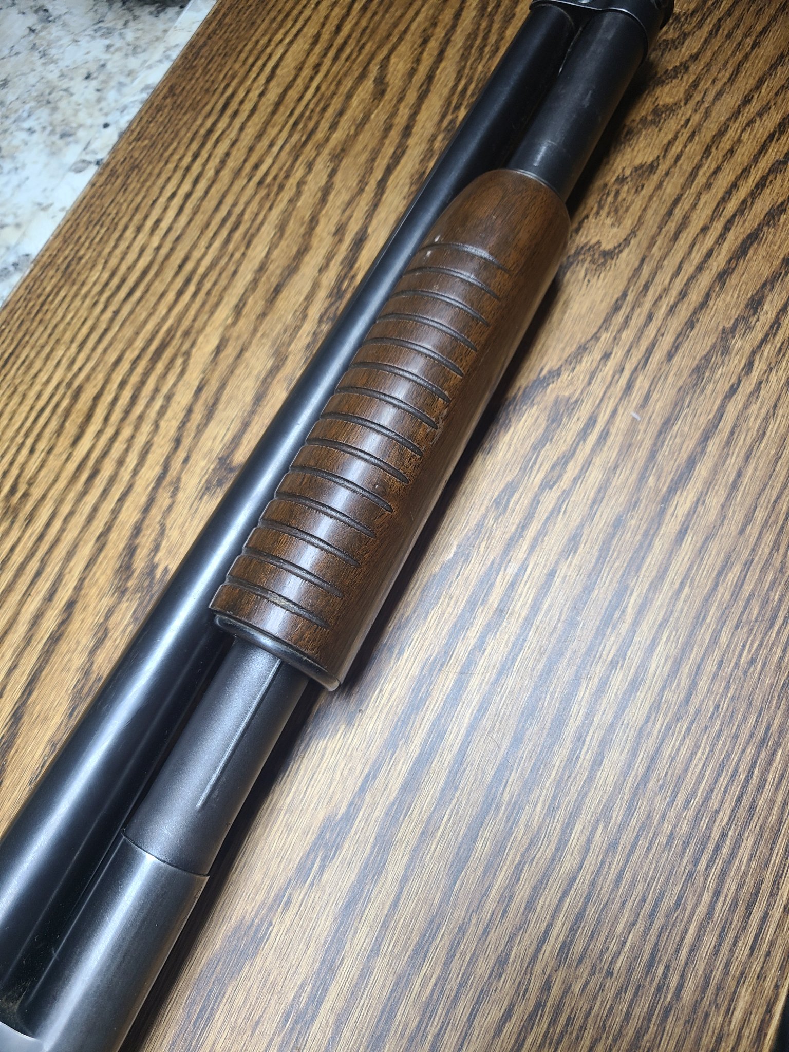

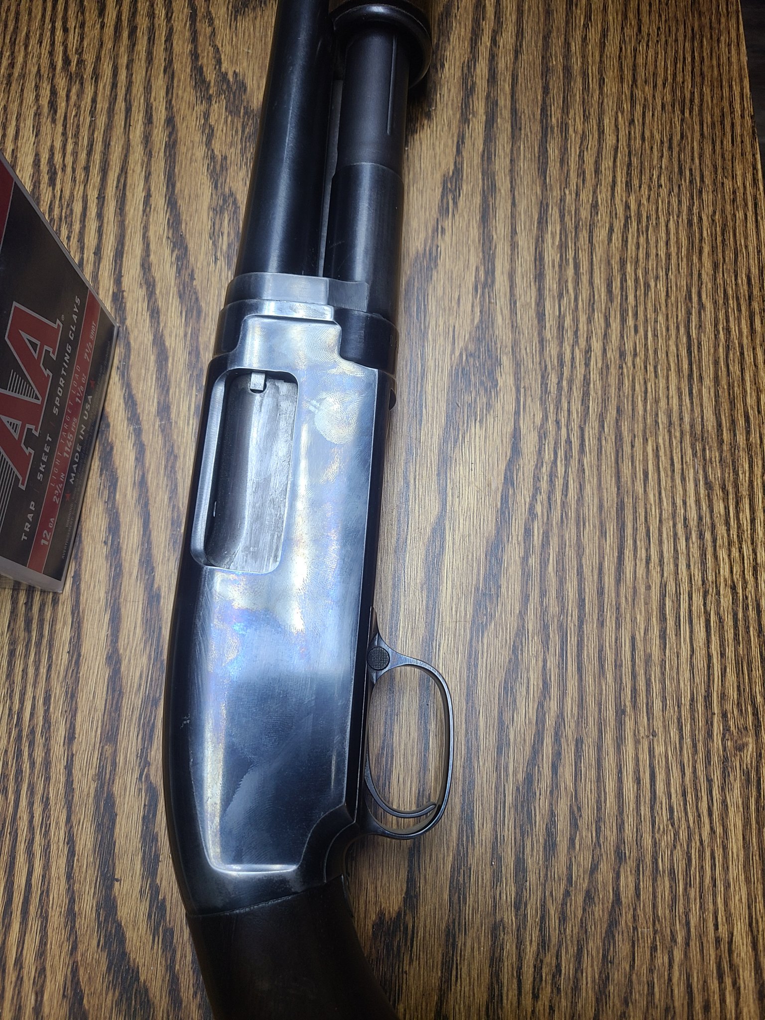

I just picked up a winchester model 12 in an auction. Just cleaned it all up, but haven't test fired or anything yet. Nothing makes me think it won't work.
It seems to be in great shape. Its a 12 gauge with a full choke 28" barrel. 2 3/4 chamber. It had a cool old wooden plug in the tube that was stamped with the gun specs. I've seen plenty of wood plugs, but they're mostly just carved up dowels. This one seems factory.
To stick with the trench gun theme here, and pretty much the only reason I bought it, I'm gonna cut it down to, what I think is correct, 20", or maybe 18". I'm gonna see if I can get it threaded for chokes too while I'm at it, just to have that utility.

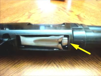

I have a question about loading this thing. Any shells in the tube want to squirt right back out unless the loading gate is pushed about half way in to hold them. It makes it pretty hard to load. Is that normal? I'm used to more modern pumps that I can stick a shell in and it will just hang out there.
Edit. Forgot pics. 20221017_123303.jpg20221017_123309.jpg20221017_123316.jpg20221017_123320.jpg20221017_123330.jpg20221017_123333.jpg20221017_123340.jpg

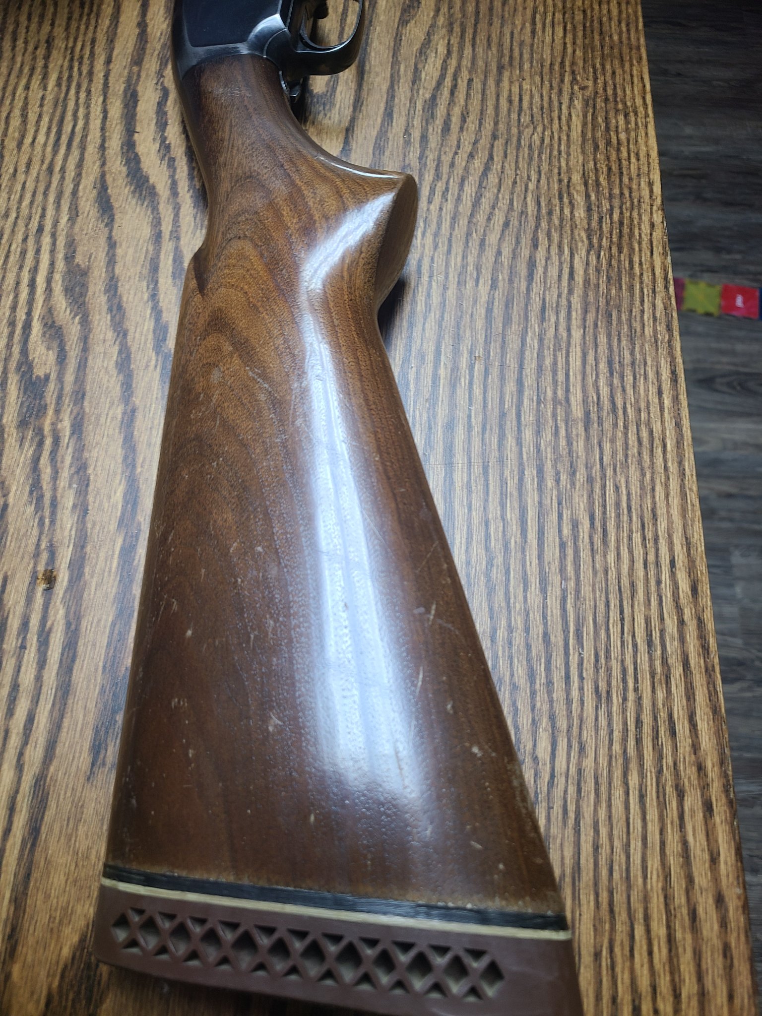

Bringing this back to the top.

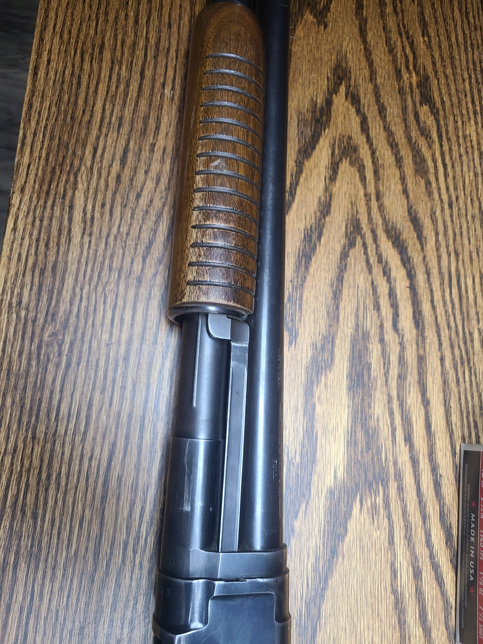

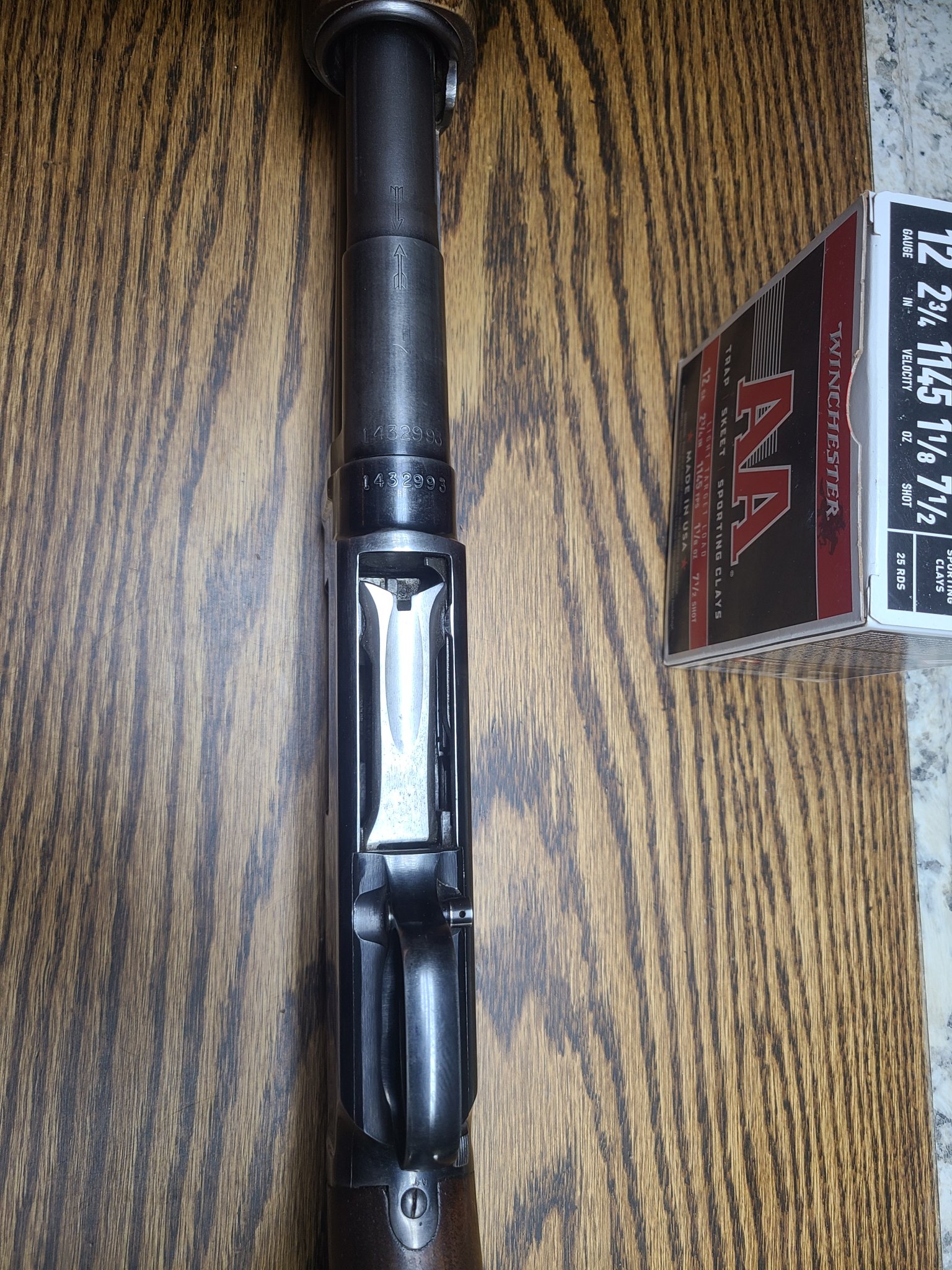

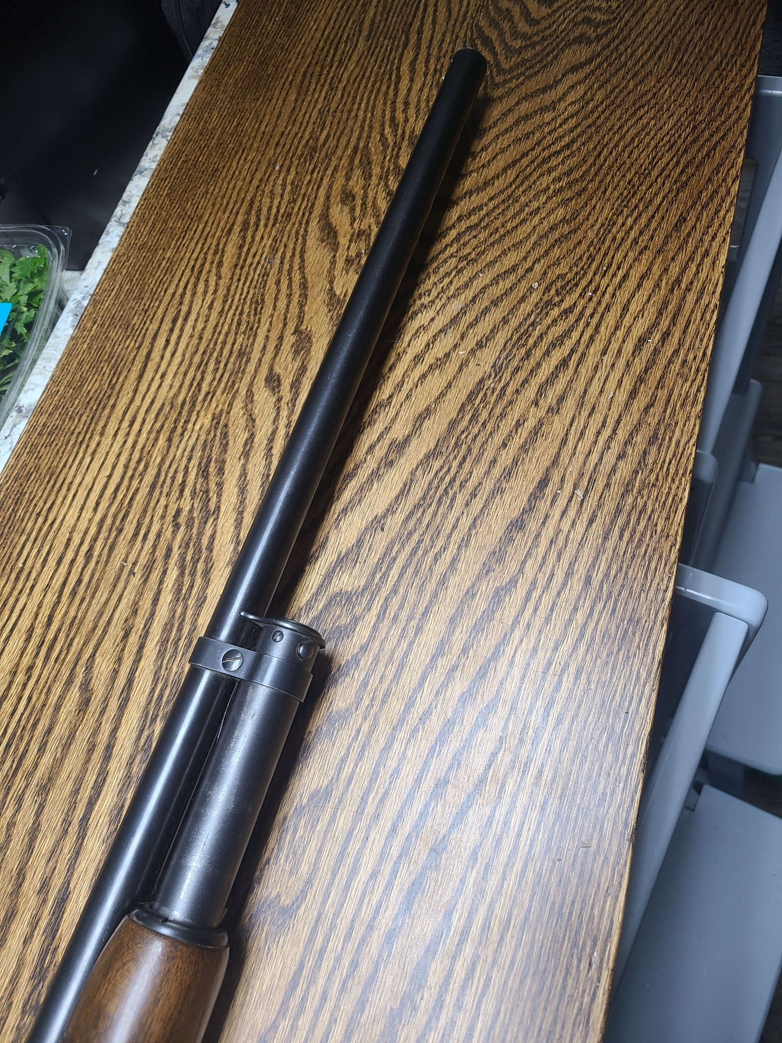

Edit. Forgot pics. View attachment 7978582View attachment 7978583View attachment 7978584View attachment 7978585View attachment 7978586View attachment 7978587View attachment 7978588
I'm not a model 12 expert, but they don't have a shell stop spring like most other pumps do. What is meant to happen is the shell lifter has a nick inn it that functions as the stop - so it looks like the shell is partway out. Photo stolen from the internet.
Hey, that looks like a take down model. That's cool.
Yup, that's what I'm seeing. Guess ill just have to get used to loading it. Is the lifter supposed to push out of the way if I push hard enough with another shell? I think it does, but again I'm used to the shell stop.
It does come apart at the action. Based on quick googling when I was cleaning it it looked like they all do that. Is that not the case?
I thought it was the manner in which it came apart, as to whether it was a takedown or not...
Don't let me give you any bad information...maybe I misspoke..

I should have thought about you guys. There was a 97 in the same auction. I didn't watch too close, bust based on how they usually go it probably went for about $450.

Pretty sure all model 12s are takedown, it's the model 97 that had some solid frame derivatives as a portion of the numbers manufactured
Sound the Charge.
I really like it! I am also glad that you are keeping it original.
I cried when I saw a CAS shooter cut down a Black Diamond trap gun to 18-1/2”.
If anyone is looking to make a trench gun, I’d recommend contacting your local SASS or NCOWS club and find one that has already been molested rather than cutting up a good one that is becoming scarce.
IIRC, the “E” denotes a 1950’s production.
