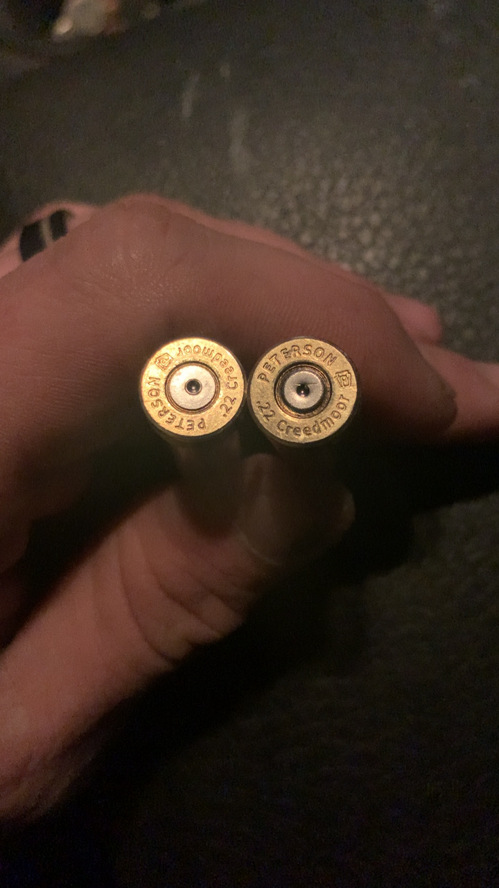

Had this issue about 2 weeks ago on a ARC Nucleus. At 1st thought it was my reloads (felt like hangfires). Then I dried fired to check and it was doing exact same thing as described. Seems like a false break then actual break. I dried fired several times and the issue has disappeared. I hadn't shot this rifle in awhile, and speculate it was just dirt/dust that might've gotten inside somehow. It is 1/5 TT Diamonds (single stage) I have. No issues with the others so far.
Curious can you tell me more about this I too have a nucleus action this is what my misfires look like left was fired and right was not it does this with my 6.5cm and that 22cm
I didn't have the same issue you do with "misfires". It felt more like a "hangfire" at first, but wasn't that either.
My issue was specifically the trigger. Right away I unloaded and dry fired. And the trigger basically turned 2-stage. 1st a false break then the actual break. This is on a single stage Diamond. It felt like something fell outta place inside or possibly dirt/dust got caught up on something.
I kept dry firing and the issue went away. Finished the ~60 rnds i had that day.
Sorry couldn't help. There were some reports of light strikes when the Nucleus just came out. I would think those issues have been resolved. I've never had any issues with any of my ARC actions. 2x Nucleus and a LA Archimedes...all running Diamonds.
It looks like you are plenty hot on the load. Also check to see how well your primers are seated. If they are not seated well, the first hit from the pin seats the primer and possibly ruins it. It does appear that your firing issue is not trigger related, unless your sear is dragging, causing not enough energy in the pin. My initial though would be to clean the primer pocket in the brass, then make sure the primer is seated well in the case.
