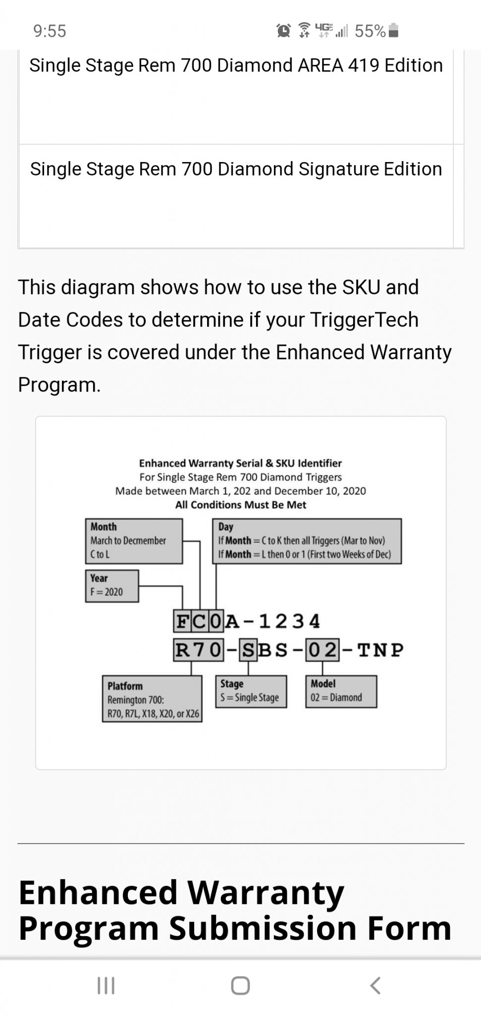

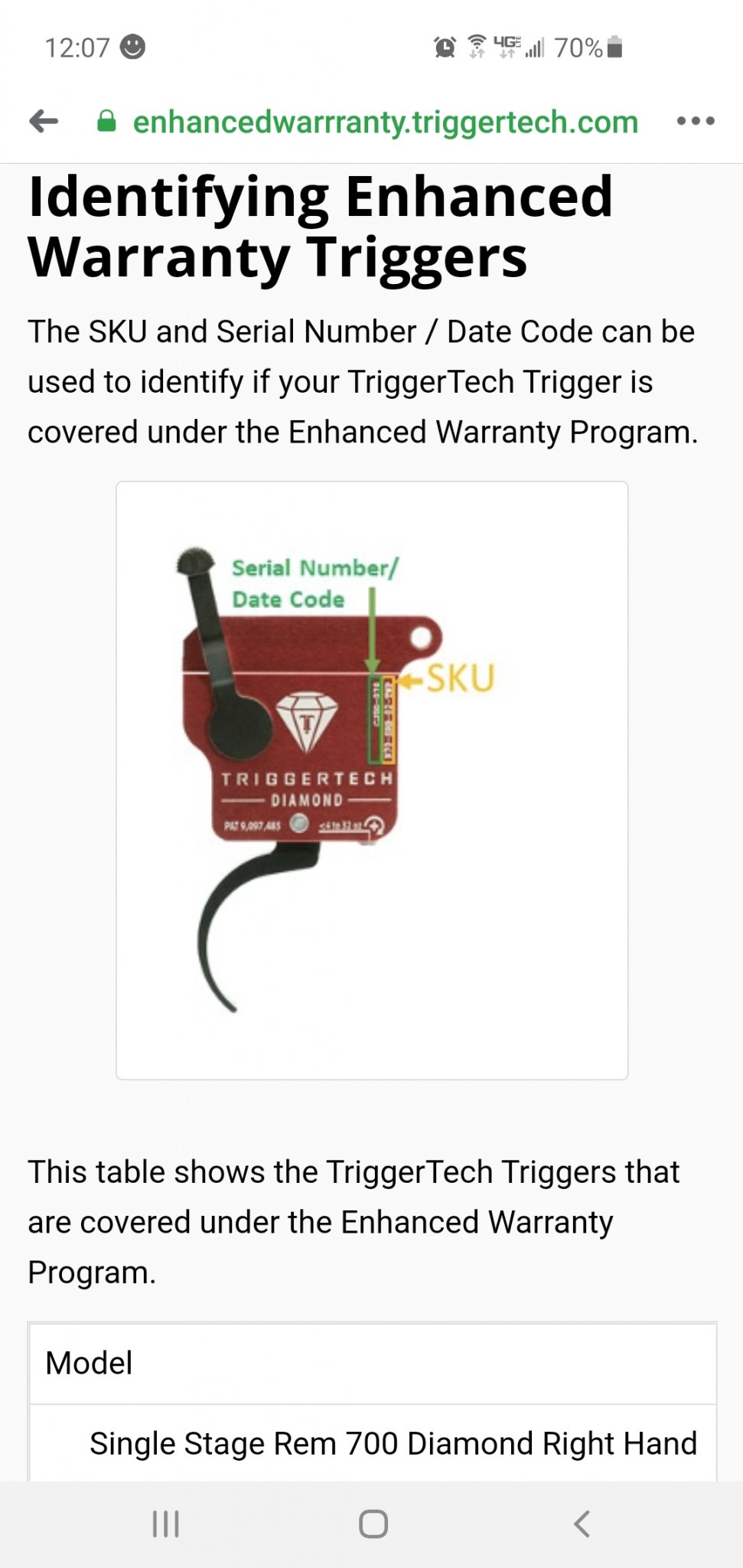

DDR/Defender, were your triggers manufactured during the timeframe of the known issue? You can determine when yours were made by looking about halfway down the page at this link which was shared earlier in this thread. It explains how to read their date code.

Taken from trigger tech website. This should help.
R70-SRB-02-TNC
Serial Number:FK1C-0319
This is my trigger info after I filled out my ticket for warranty.
Mine is FH2G-xxxx...looks like from this year Aug 2nd?
