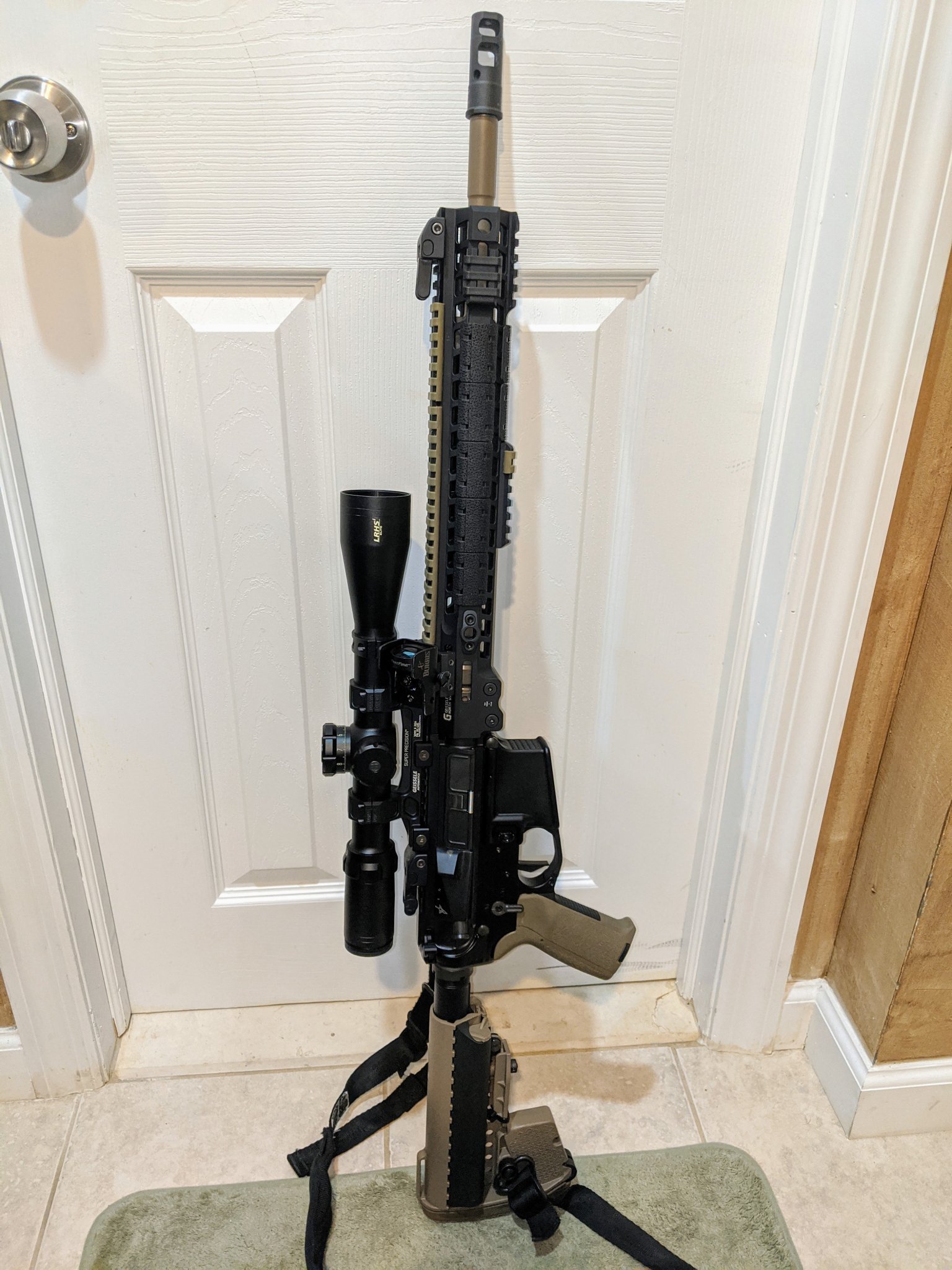

I I like it a lot but hate that it is working so well for me on the ar and bolt action 308. i am now debating getting a trijicon Tenmile 3-18x44 or 4-30x56 for my 24 inch 308 savage. (left handed) I like the christmas tree reticle. and by the way, I can see the detail starting at 5x and above magnification, so i think the ffp is plenty useable in this scope. I don't really hunt all that much, realy just wanting a tactical toy that I can work on building my sniper skills. If you help, i will tell you whatever you want to know about the 2-10. My friend says it is really clear class, i think so too but don't have much to compare to
Reactions: adamjma
@smattmul I guess I'm just looking for validation that it is in fact at least comparable if not a step up from the very widely loved Bushnell LRHS 3-12, of which I have two. Sadly not illuminated, and the reticle is a little spartan for my tastes as well.

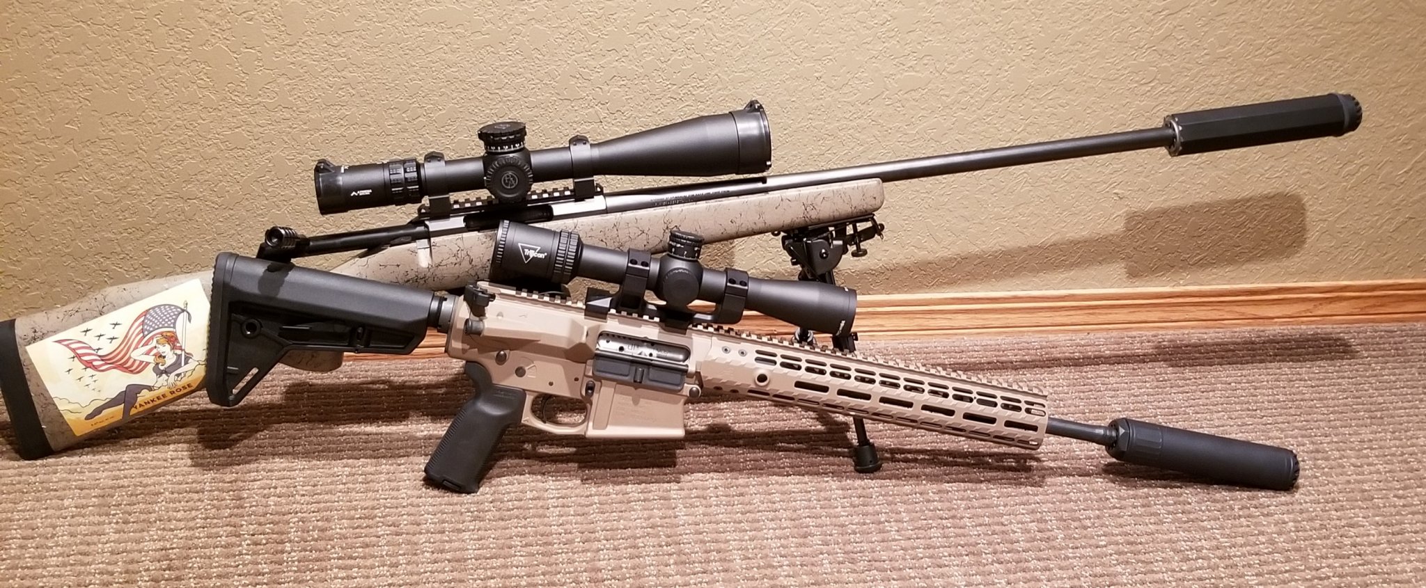

I've been playing with this 2-10 for the last year. I built up a 16" lightish weight 6.5CM AR 10 to accompany my 24" Tikka CTR 6.5CM
The guns operate as a "matched set" if you want to call it that. The idea being that both rifles shoot the same caliber, 1 semi auto acting as a spotter and then the bolt acting as primary. The scope on the Tikka is a primary arms 6-24 GLx with athena Mil reticle. To match it I wanted something more mid range oriented but still with a Mil reticle for spotting hits and calling corrections. The trijicon credo 2-10 was one of the only scopes that could meet what I was looking for without breaking the bank, or being a pig of a scope. Keep in mind, the credo is $920 from BDU, the next best competitor to the application IMO was the vortex razor at double the cost. I was willing to give up the 1x for $900.
The 2-10 is in a seekins precision 30mm 20 moa base. I havent set the zero stop due to still dialing in a handload for the gun. I have played with it out to 600yds and so far tracking appears to be very good for intended purpose. Keep in mind this is a 16" faxon big gunner barrel, very lightweight and it is nothing close to a precision rifle by any means. The rifle and scope have taken quite a few hits since I first received the scope back in May. Never has the zero shifted internally through the abuse. Externally I had an issue that I didnt realize till after the fact. We were shooting about 500 yds, I didnt dial in, just hold over in the reticle and went way over target. My hold was about 3.5 mils. Next shot dead hold, spot my miss at about 1.5 mils low. At some point the rifle had taken a hit or bump on the elevation turret and turned the turret 2 mils and I didnt catch it. Do the math and 2 mil bump + 1.6 mil and everything made sense again. The scope needs a cap or locking on elevation.
The rifle has fallen out of the back of the pickup a couple times, once my fault, once my FIL, both not paying attention when dragging equipment out for setup. I have also done some barricade work and run n gun drills with it. Not alot, just for fun to see how it would drive. The 2x obviously isnt as fast as a red dot, but if you are used to lower end LPVO scopes like the strike eagle or competitors to it then you'll appreciate the higher quality of credo. Budget (<$600) LPVO 1-8 is not an acceptable comparison to the credo, it is competing with LPVO's above its price point. I can still shoot both eyes open with the 2-10, again not as fast as a red dot on my VZ 58, but I really wasnt a whole lot slower either, couple seconds through the runs entirety and rifle weight was more of a factor.
Only other con is the illumination. Its finicky now, loose connection. If I turn it on, it doesn't. Consistently if i lightly push the illumination turret in it will light up, but as soon as I take my finger off it turns off. I do not use illumination much, and for the most part the scope gathers enough light that I dont feel the need to mess with it much anyway. I also have very good eye sight, so for someone who doesnt, it may impact them more significantly. (Edit: messed with it and the cap isnt holding the battery enough to make good contact, a plastic shim has resolved the issue completely)
I would buy another personally. The abuse and beat around that its gotten, the weather its endured (not arizona hot, but kansas hot high 90s) as well as some cold weather, snow work (not Minnesota cold, just KS cold usually still above 0F) has proven that its maybe not a deployment duty grade optic, but I would say its definitely way above range grade, and its priced kind of in the area where a regular guy who wants a nice scope that will perform can budget and get something that will serve well over their lifetime.

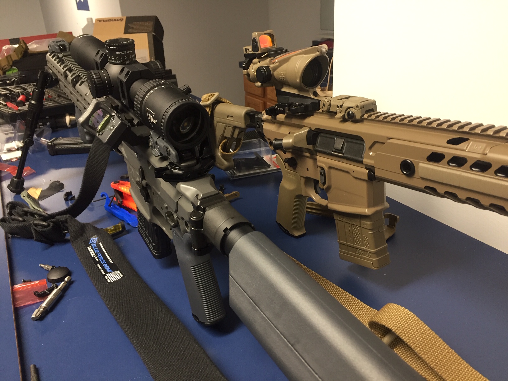

Was able to play with both the trijicon 2-10 and the PA GLx 2.5-10 side by side today. We didnt send a whole lot of rounds down range but got an idea of how they stack up to each other.
The trijicon is on my my 6.5 creedmore AR10 build and has the MIL tree in it.
The PA GLx was on a buddys' Daniel Defense 18" AR15 and had the ACSS Raptor reticle, not the griffin mil.
Right off the bat, eye relief is absolutely a pro to the trijicon. Im not sure if it was just because it was set up by someone else or if it was just the scope characteristic, but on 2.5x I had to get off the scope quite a bit, then when dialed up to 10x I had to be right up on it. That was pretty inconvenient for me. The trijicon was pretty good through the whole magnification range. 2x was also nicer than 2.5 on the low end, but I like the horseshoe on the GLx better on low power to pick up and the griffin mil retains that I think.
I didnt get pics but they are comparatively sized when side by side and neither one really seemed out of place.
Again the turrets on the GLx are awesome. If I could have those turrets on the trijicon I'd be really happy.
I cannot vouch for durability of the GLx, we dont have many rounds on it and it hasnt really had to endure any abuse, but it seems that it should be just as solid as my GLx 6-24.
Magnification ring on both is smooth through the range when adjusting, the Trijicon comes with a little nub installed and the GLx has a small fin.

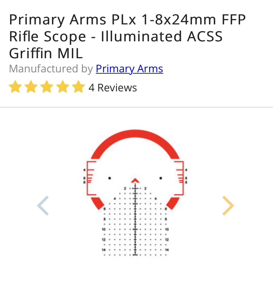

I have a PL-x 1-8 Griffin and it’s badass. I like the way it illuminates the entire horseshoe. It’s very quick to acquire targets with on 1x.
Reactions: TacticalPlinker
The FOV on lowest power is considerably less with the PA 35.8ft vs 50ft @ 2.5x and 2x respectively.
The FOV on the PA @ 2.5x is actually worse than the likes of the Viper PST 3-15x44 which is about 41ft.
It'd be nice if the Trijicon had a reticle more like the ACSS or at least had some design elements that aided visibility on the lower magnification settings.
Reactions: Neurotic
How do you like the eye box on that? Is easy to get behind for a snap shooting at 1x ? --- say from behind a barricade.
And that the other end of the spectrum how is the eye box sensitivity at 8x? Do you find yourself fighting to get a clear sight picture or it just comes together nicely?
Thanks
How do you like the eye box on that? Is it overly sensitive or easy to get behind for a snap shooting at 1x ? --- say from behind a barricade.
Thanks
1x is quicker than an RMR with bright illumination of the horseshoe and chevron. I haven’t used a lot of 1-8x scopes so don’t have a good comparison but it feels easy to get behind. Definitely tighter than 1x but not like you’re searching for a good view either. The reticle was the deal sealer. It’s just plain badass and on target.
