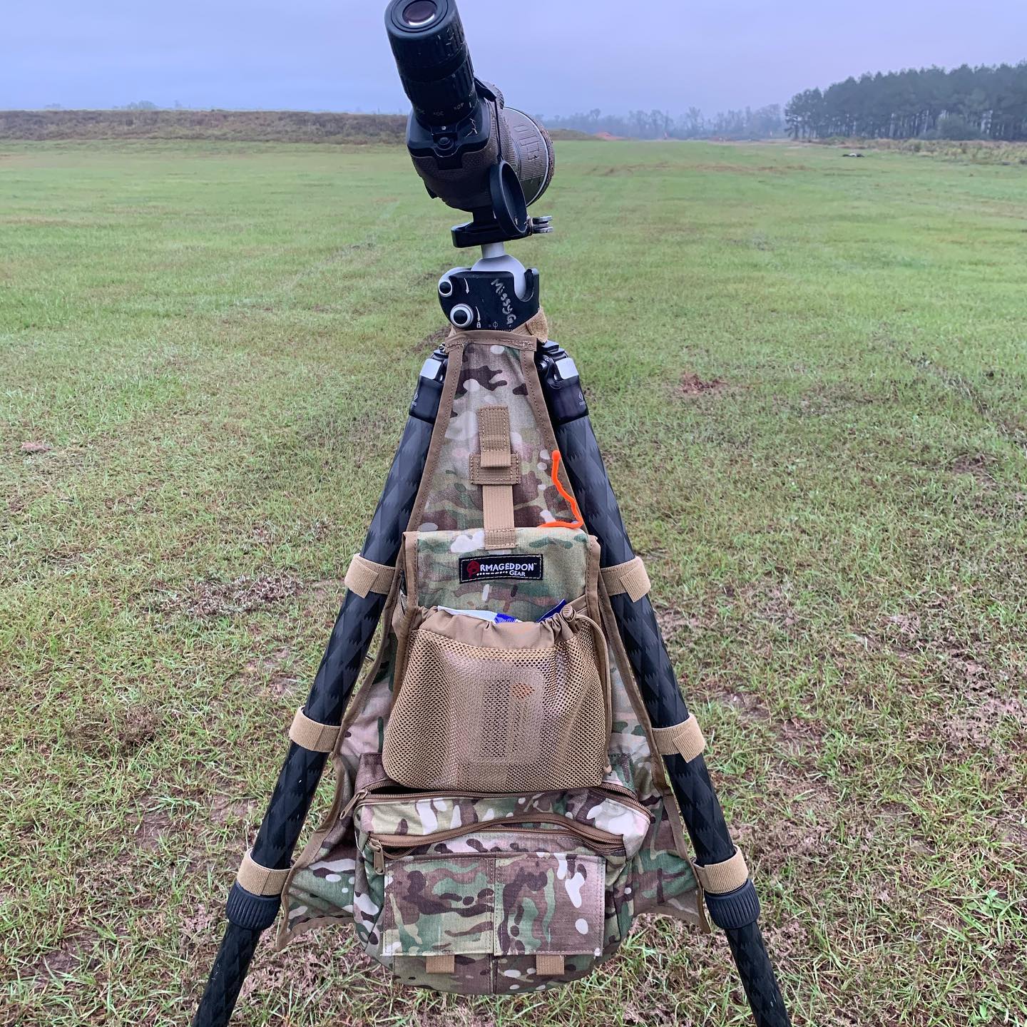

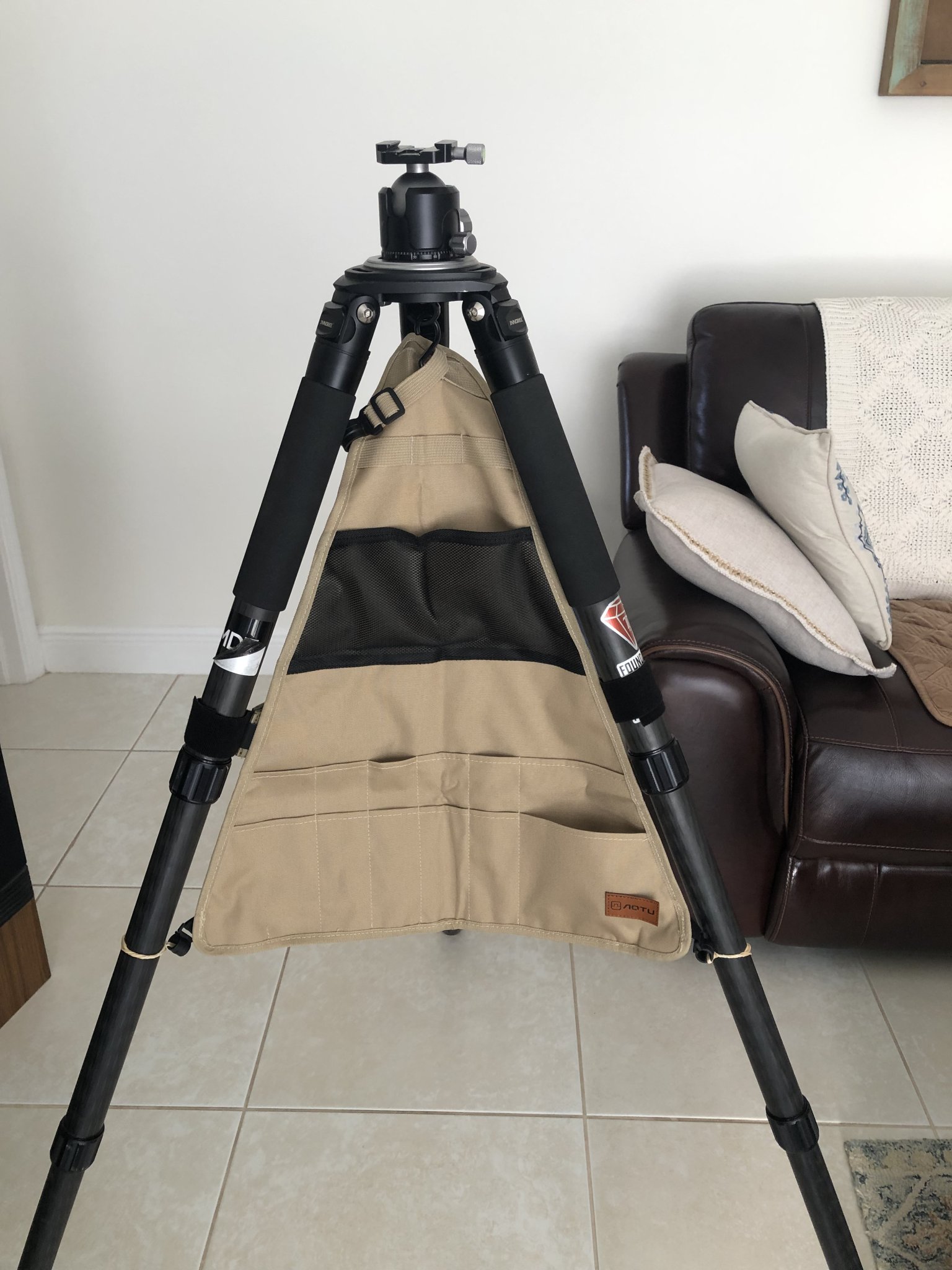

I have been using my Armageddon gear tripod caddy for a while now, and I love the thing! Only snag is its a pain to take down and re-attatch if I want to use my tripod for rear support in a match.
For the guys at the back shouting tripod rear is for pussies, I hear you, but once in a blue moon it can save my bacon in a match!
Anyway, after several minutes staring at it figuring out what I could sew on / cut off to make take down / reassembly easier, I thought why not ask the hide! Someone is bound to have butchered one before?

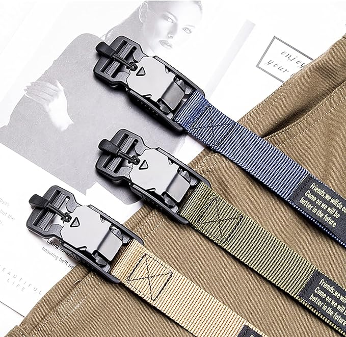

Thinking of adding some FIDLOCK style QD magnetic buckles, instead of the velcro wrap arounds. Would make reattaching SUPER easy & quick.
(Pic from AG Facebook page)
QR Buckles are fidgety once you try to cinch them on tubes.
They do better when they have padded insulation between them and the tube, as it allows them to cinch without causing a fulcrum/teeter-totter effect.
Easy job though for someone with even a small bit of experience on a machine.

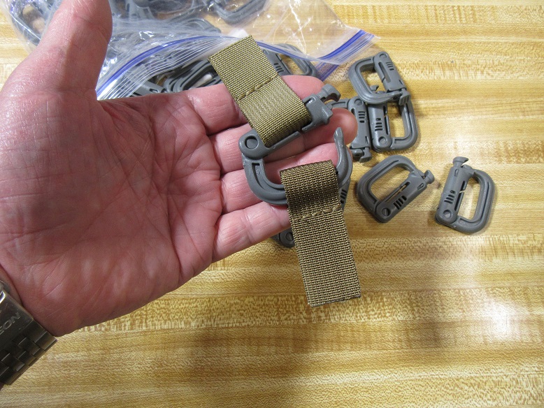

just quick off top of my head. and no idea if it adaptable to item or your needs of QD ?

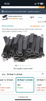

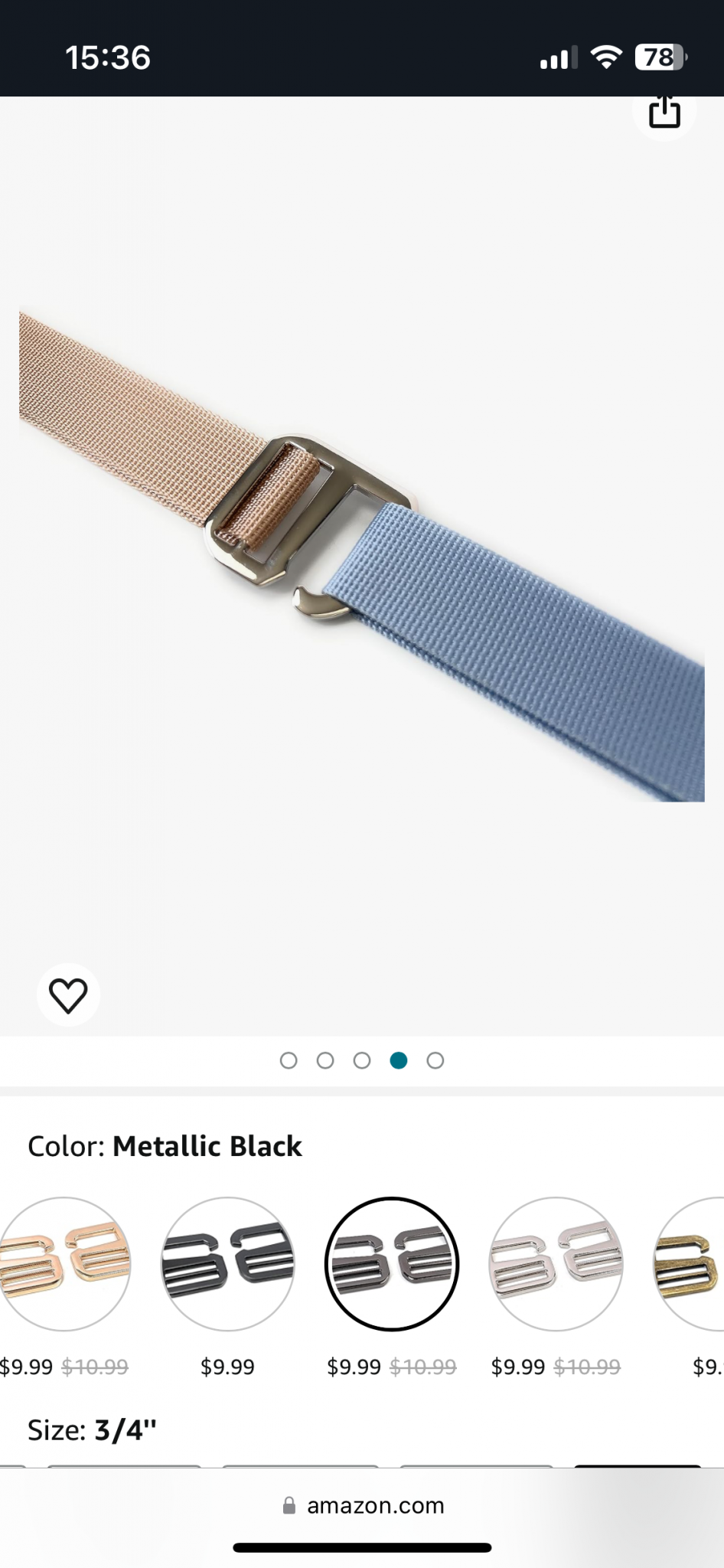

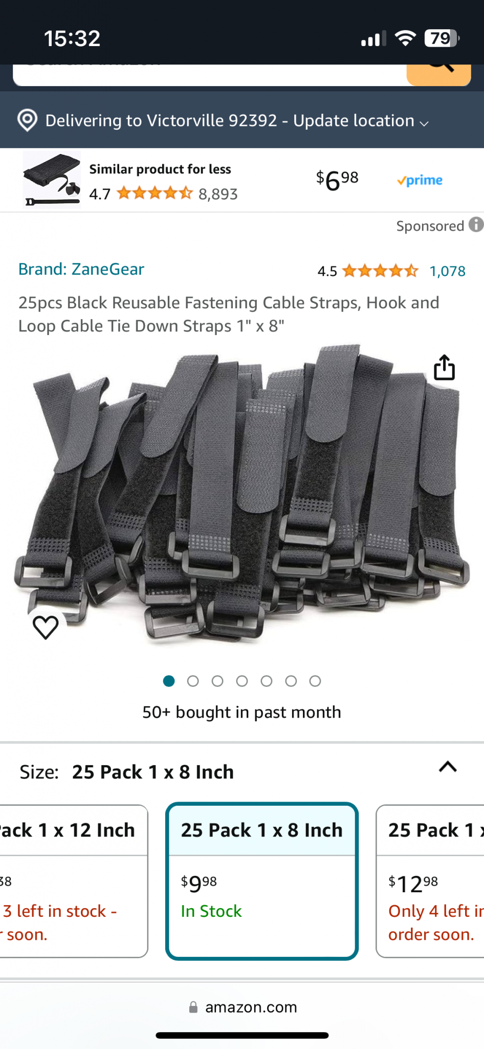

Put the hooks on the caddy. Extra straps for any screw ups on cutting/sewing etc.
Reactions: Hotshot001

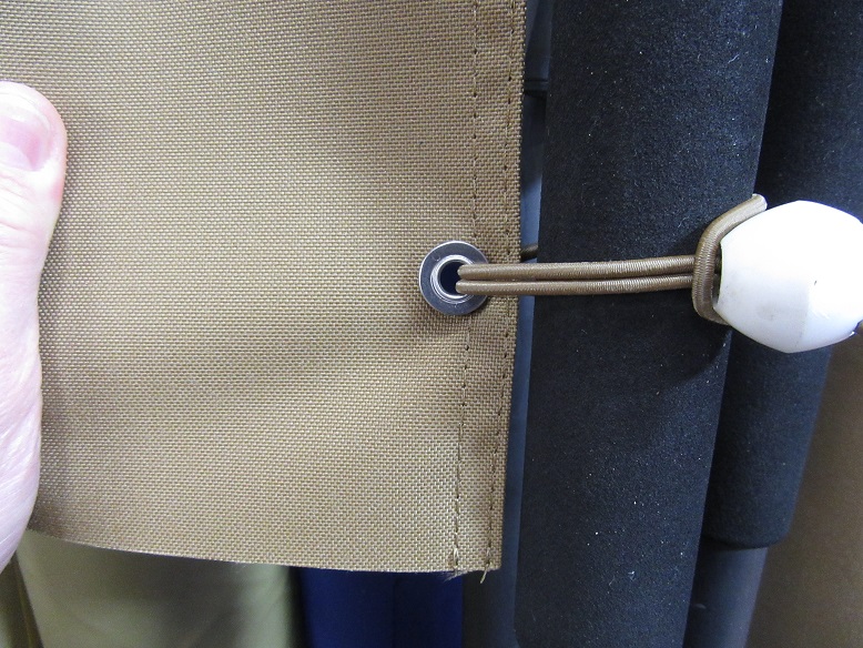

Something just popped in my head while was taking a piss a minute ago ...OK simpletons, Here is another WAY simpler and EASY way for Q.D. a Tripod Caddies .. This one so easy a Chimp can Rig it up .
Just use 0-spur grommets / 1/4" on the tripod Caddy fabric side edge .
Use 1/8" Bungee Cord w/Ball to pass-threw Grommet, and wrap around Tripod leg to stretch and hitch-over top of the Ball .

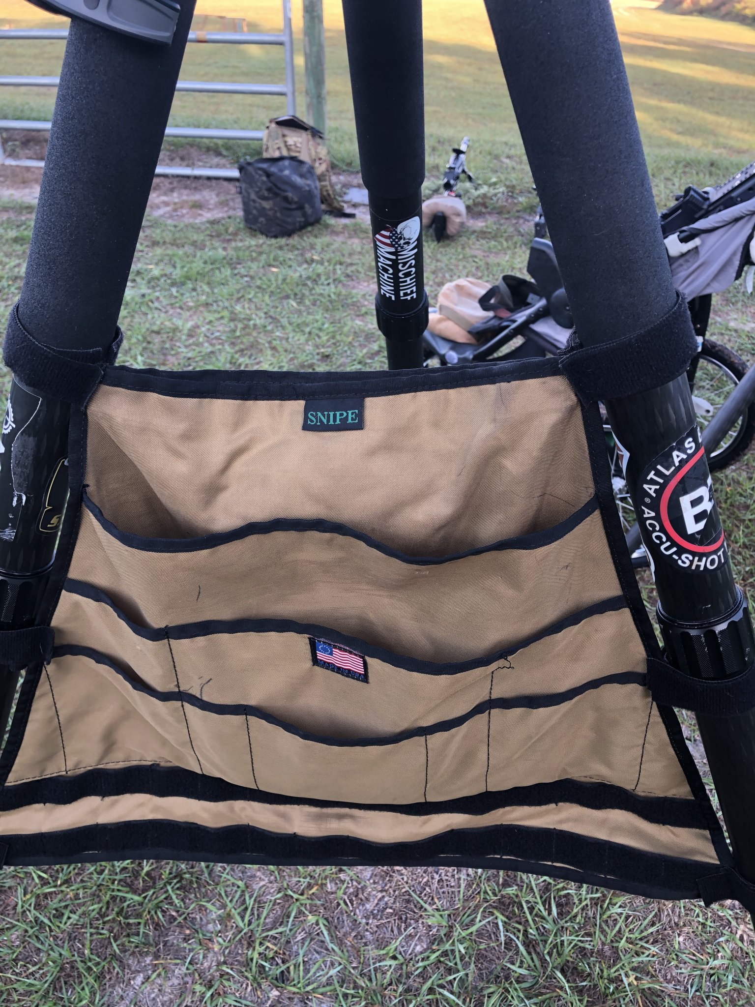

img_8510-jpeg.8425038
This is kinda what i want. But i think they are out of business

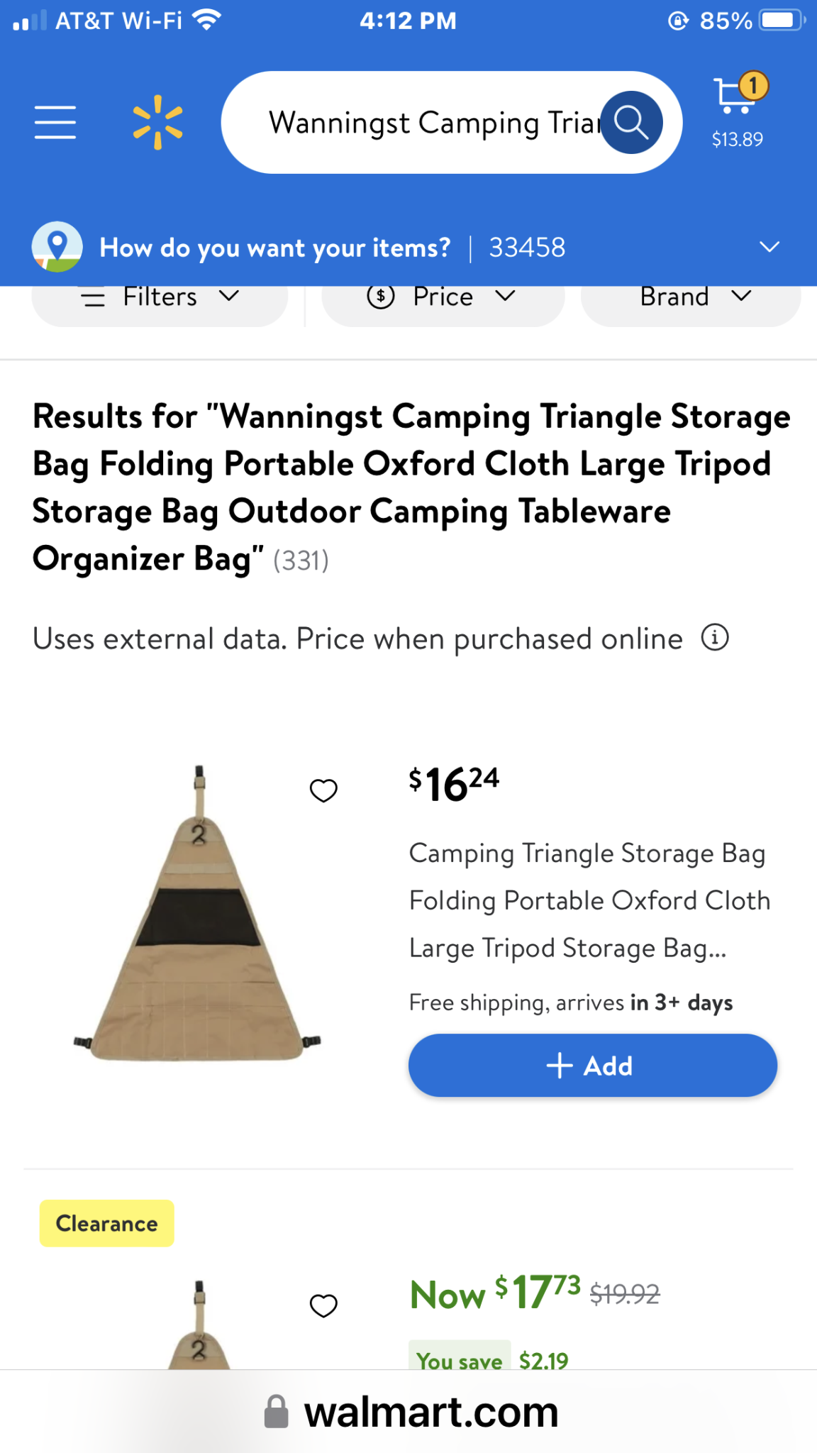

Just got this from walmart online of all places. Not too bad for $20
