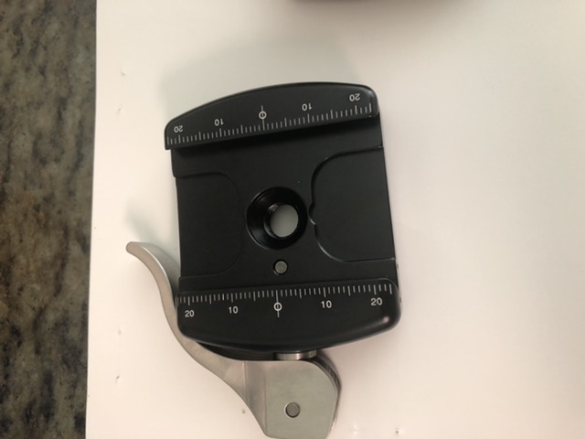

For the money I think the Innorel RT-90C is hard to beat. I use it with this Arca Swiss lever clamp. I couldn’t justify buying RRS gear. This setup works for me and I can get very solid with it. I’m all in for about $325, tripod and clamp.
I also have a Manfrotto 055 and Sunwayfoto DYH-90 panning leveling base and it’s not nearly as stable.

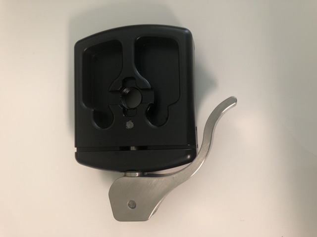

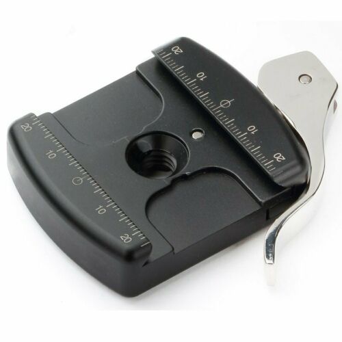

I wouldn't use this clamp or buy it. Whoever is making it is a knockoff manufacturer or seller. You probably aren't going to get what the picture looks like exactly because the pictures are from our website about 6 years ago and we don't have a ballhead named what the listing says it is for.
Buyers beware.

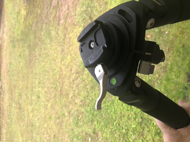

Here’s a picture of the clamp and with one installed on the Innorel RT-90C.
