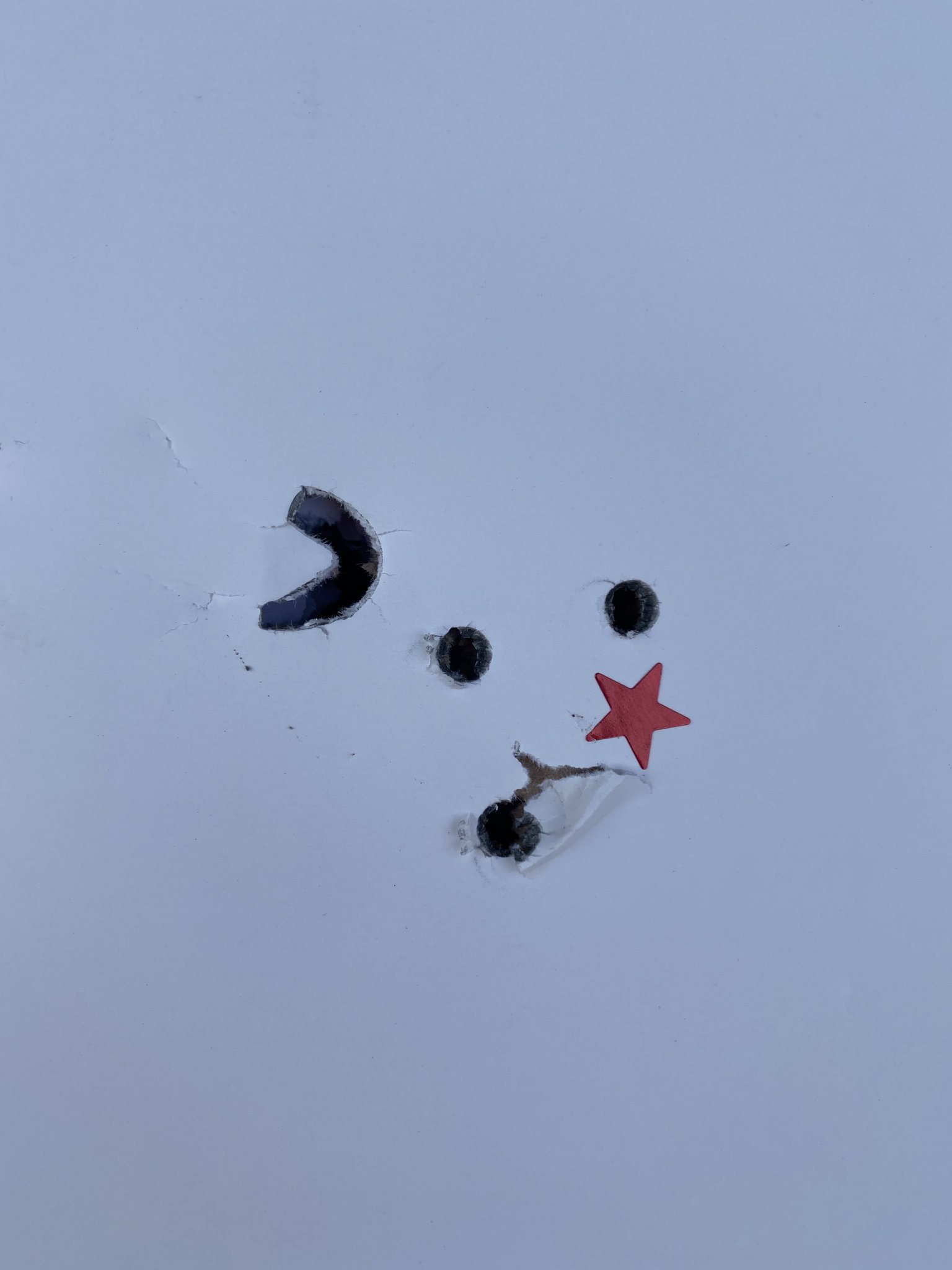

Tumbling/ bending bullets has me stumped
I called Hornady and they said the lots I have are recent. But they obviously still have issues.
Sucks to hear the problem still exists.
I bought a pile of the 147 seconds and they’ve GTG but the regular production gave me problems when I last tried them again at 2800 fps.
The 5R barrel is putting them out at 3050fps and the Proof is around 3000. Maybe too fast for the 147, but they are factory loads.

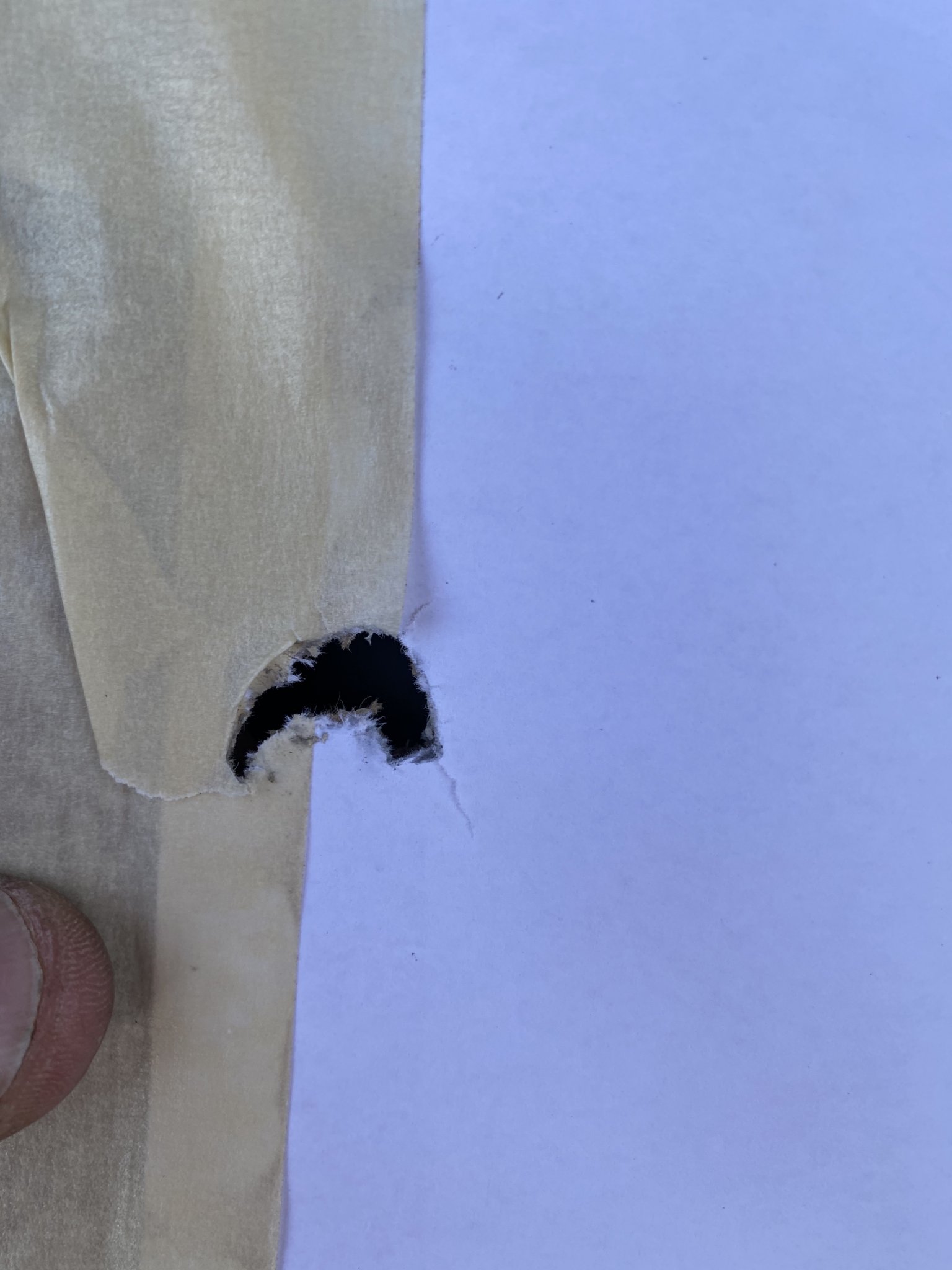

I talked to 2 different techs at Hornady today. Both lots of this ammo I have was made in October 2019 so they said it is the new stuff they have. The one tech said it might be because the gun isnt fully broken in yet. He thinks it might stop after 200 rounds or so. The other tech said they have seen issues with the 147gr but he said almost all were with 4 grove cut rifle barrels. I'm not sure what Proof uses. He also said I might have a right bore since I am getting 3025-3050fps out of it and that might be causing it. They emailed me a return label so I am going to send them 1 box of each lot that I have. I might try running some JP bore paste thru it to see if that helps. Also going to shoot 50 or more rounds to see what that does. I hope I get this figured out since this gun is a real shooter when the bullets dont come apart. And they told me that the L shape is the lead core hitting the paper after the jacket came off of it.

It happens. Barrel + bullet combo puts too much heat/deformation into the bullet. 147s get it the most, probably a lot because of how many people are shooting them, but I've seen 150smks let go too. 6.5 PRC and SAUM (any overbore caliber under 7mm geared for low drag bullets, really) are hard on thin jacketed bullets. Especially if you don't clean regularly.
143s won't have that problem. Newer lots should be better, too.
Had this issue with a customer's rifle a few years ago. They wanted to shoot a 6.5-06 throated for 147s, and with the loads we worked up to verify good function and precision we had this tumbling issue.
We ended up having better success with a Barnes bullet for hunting loads and a Berger 153 Hybrid for the range.
140s did not have that problem for whatever reason irrespective of manufacturer.
