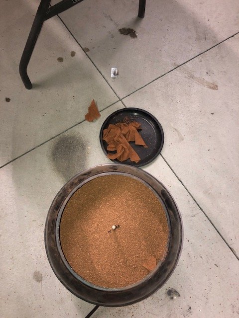

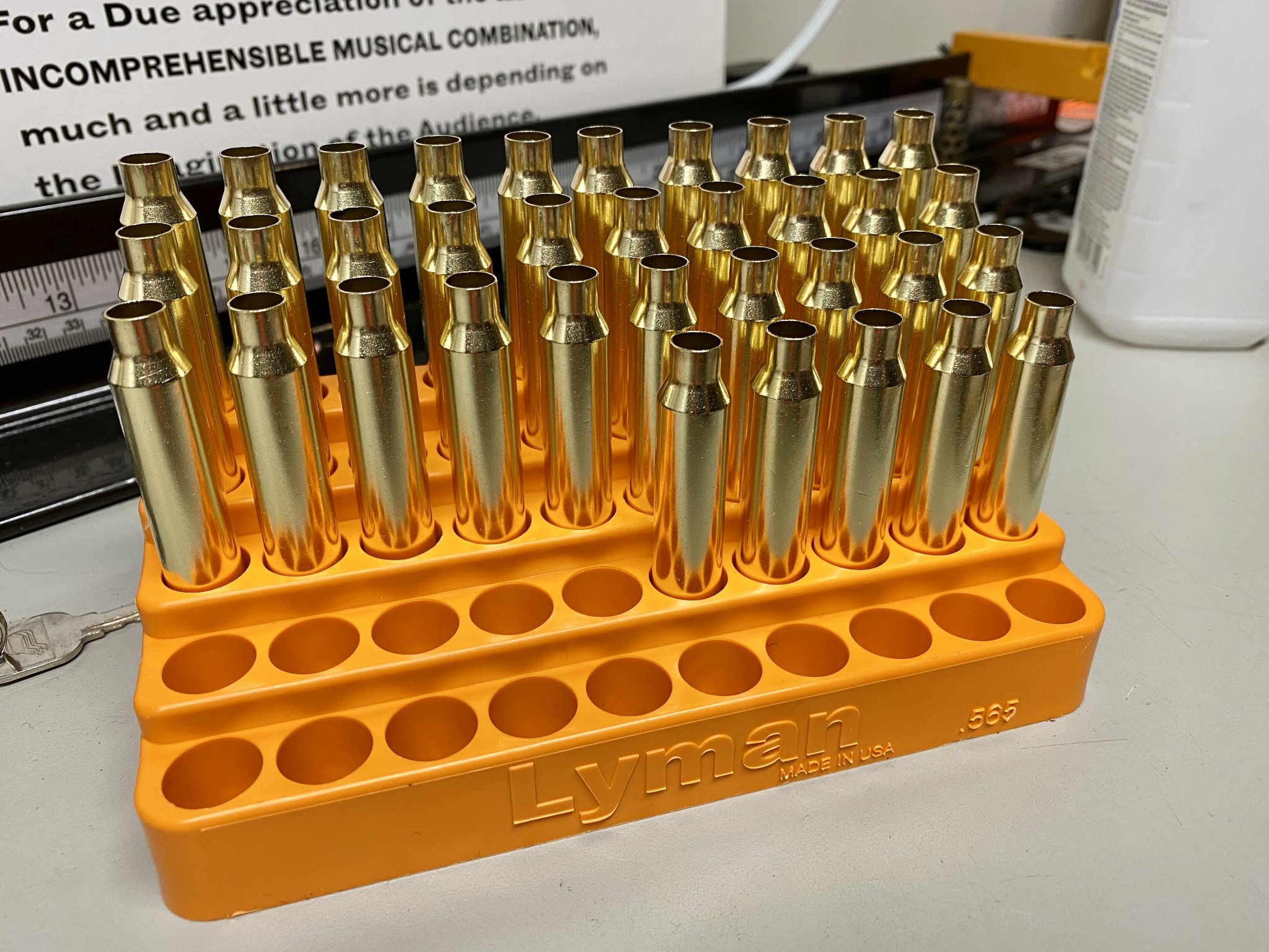

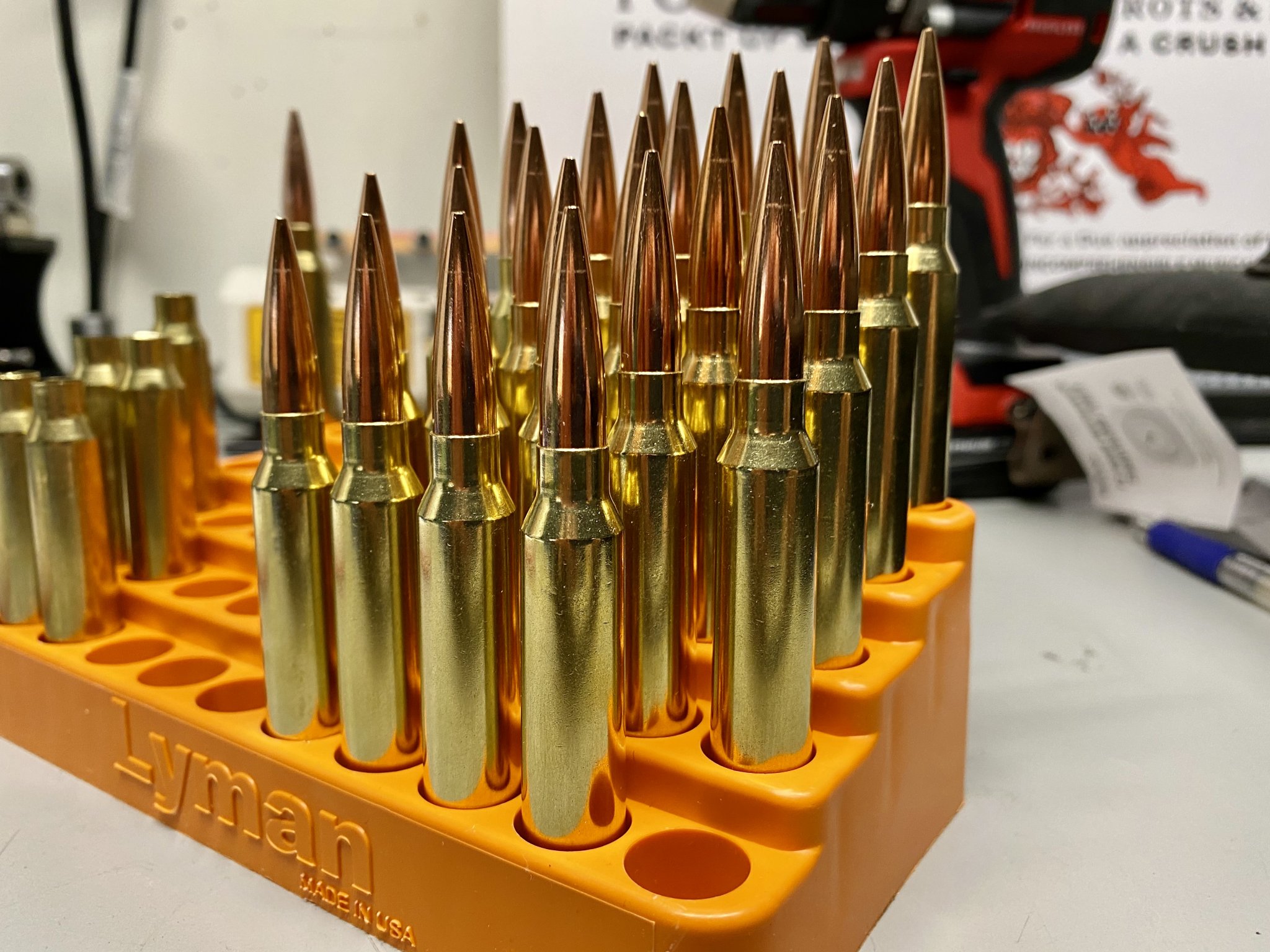

    Hopefully the images are visible. I’m using fairly old walnut media that is “Pre-seasoned” from Bass Pro. It polishes REALLY good. Not the absolute shiniest media I’ve used, but REALLY good. For some reason I prefer the walnut over corn cob but I can’t remember why. It’s clean and slick.
    With already polished brass, I tossed 100rds back in with at least 3 used dryer sheets and one new one. The clean shell is the result of using dryer sheets vs. not. I’m really impressed and this is good enough for me. The laundry room will have a box for used dryer sheets from now on.
