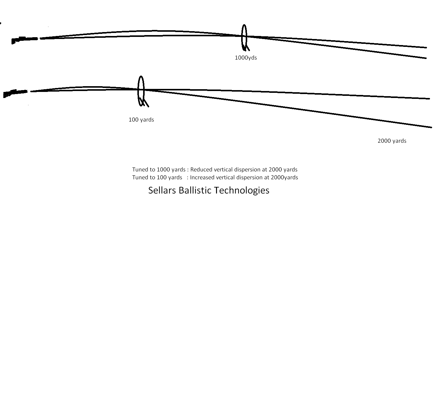

So we agree that adding mass has reduced the amplitude regardless of a slight change in frequency?
Now what if this is true.
Slower bullets leave the barrel later in time than do the faster bullets.
If the muzzle is rising the slower bullets leaving later in time leave the muzzle while it is pointed at a higher angle than the faster bullets.
At some point in time those 2 paths will cross each other or converge.
This is how as reloaders we tune our rifles for best accuracy.
Yes those angles are extremely small as are the time differences.
If on the other hand the muzzle is traveling downward with the slower bullet leaving later those 2 paths will never cross and accuracy will never be what it could be.
Does that sound good to you or just made up nonsense?
Let me know so we can continue or call it quits

Okay so you understand how the slower bullet and faster bullet can converge on the target without a tuner.
In my scribble drawing showing the 2 amplitudes we can pick any two points along both waves and assign them a number. We can give those two numbers a fancy name or just coordinates or anything anyone here would like to call them.
They just need to be the same for both waves.
What are your thoughts on any 2 points on wave 1 versus the same points on wave two with regards to a change in the vertical differential between those 2 points?
Wave 1 would be a bare barrel and wave 2 would be a damped down barrel due to the tuners mass.

If a gun is shooting at its best at 1000 yards is it also shooting its best at 2000 and 3000 yards?
I think your point is that a tuner would make a gun good at one distance and horrible everywhere else.
In actuall practice with my little experience the gun shoots better at 100,200,300,600 and 1000 yards not just a single distance.
I'm not attempting to discount your years of experience. We'll just have to agree to disagree about whether your results point to causation or correlation.
Fair enough , if you have an idea as to measuring the slight angle produced by the recoil force I will be glad to try it . The graphs I post are the only known way to measure barrel launch angles as of now mainly because it is the actual movement being traced on paper and not a electrical signal . I can see changes in incredible detail including in bore timing variations with the same instrumental velocity . So we don't agree ? That is understandable , I am only after the truth in these endeavors and if I am wrong it will not be the first time. Here are some of the problems involved to do instrumental measurements on micro movements and angular at that . Since 2001 I have been trying to do just that and after talking with many military labs and scientist from all over the world and discussing all of the variables involved it was next to impossible to correlate where the shot landed and which mode of vibrations landed it there or if it was a vibration mode that put it there or if a intermediate ballistic force or external ballistic force caused the shot to land . Attaching sensors to the action and lug area was done by Harold Vaughn and it worked well but it was mainly measuring pressure points at the lug and action area converted to a signal. That is ok but it was not measuring the precise micro barrel launch angles involved . To do so Harold had to shoot ladder tests similar to mine to to really see and measure these very small changes in a shooting tunnel. They could be calculated based on the strain gauge measurements but not actually measured. G force sensors had their own issues simply because they diverted the barrel from the normal dynamic response when attached to the barrel. For a while lasers were thought to be possible but as the gun moves rearward in a normal dynamic response the vertical plane and horizontal plane of the barrel could be measured but the problem there is the barrel is bending different directions in at least 8 different planes in 5 different spots at one time all while moving rearward and torquing so if not attached directly to the gun would be next to impossible to extrapolate the effecting variables.

Here is the theory illustration .I have seen the same as you sir .
I was speaking specifically in regards to positive compensation.
The whole premise is that if you time the exit of a slower projectile while the barrel is moving up, there will be a point of convergence between those two projectile speeds at some distance.
That convergence point only happens at one distance.
However there are numerous assumptions that need to be made, and there are many internal and external factors that influence ballistics beyond just velocity. In most disciplines and for most shooters, I would think any advantage would just be noise. Perhaps there's something to it in disciplines like BR or F-class, where minute advantages make a big difference, and where tools such as SEB front rests, ruddered stocks etc are used where such small differences will show up on target.
Though going along with the inconsistency theme, the BR guys and F-class guys use tuners in a completely different fashion then what's reported here, and attribute different capabilities of tuners than what's presented here. So who knows. Seems like everyone's theories on tuners is grounded in their own personal biases, willingness to believe, and flawed statistical analysis'. There's a lot still to learn apparently.
