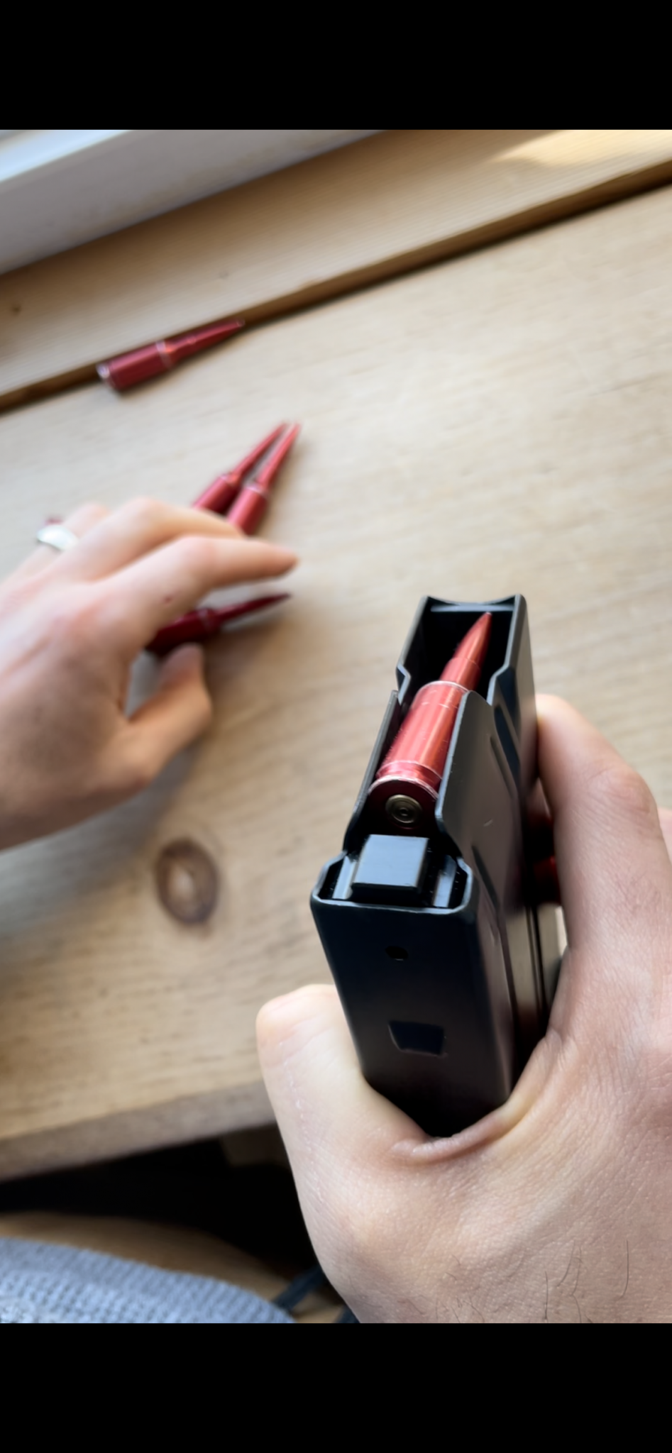

    Looks like there is plenty of clearance from the tip to the mag.

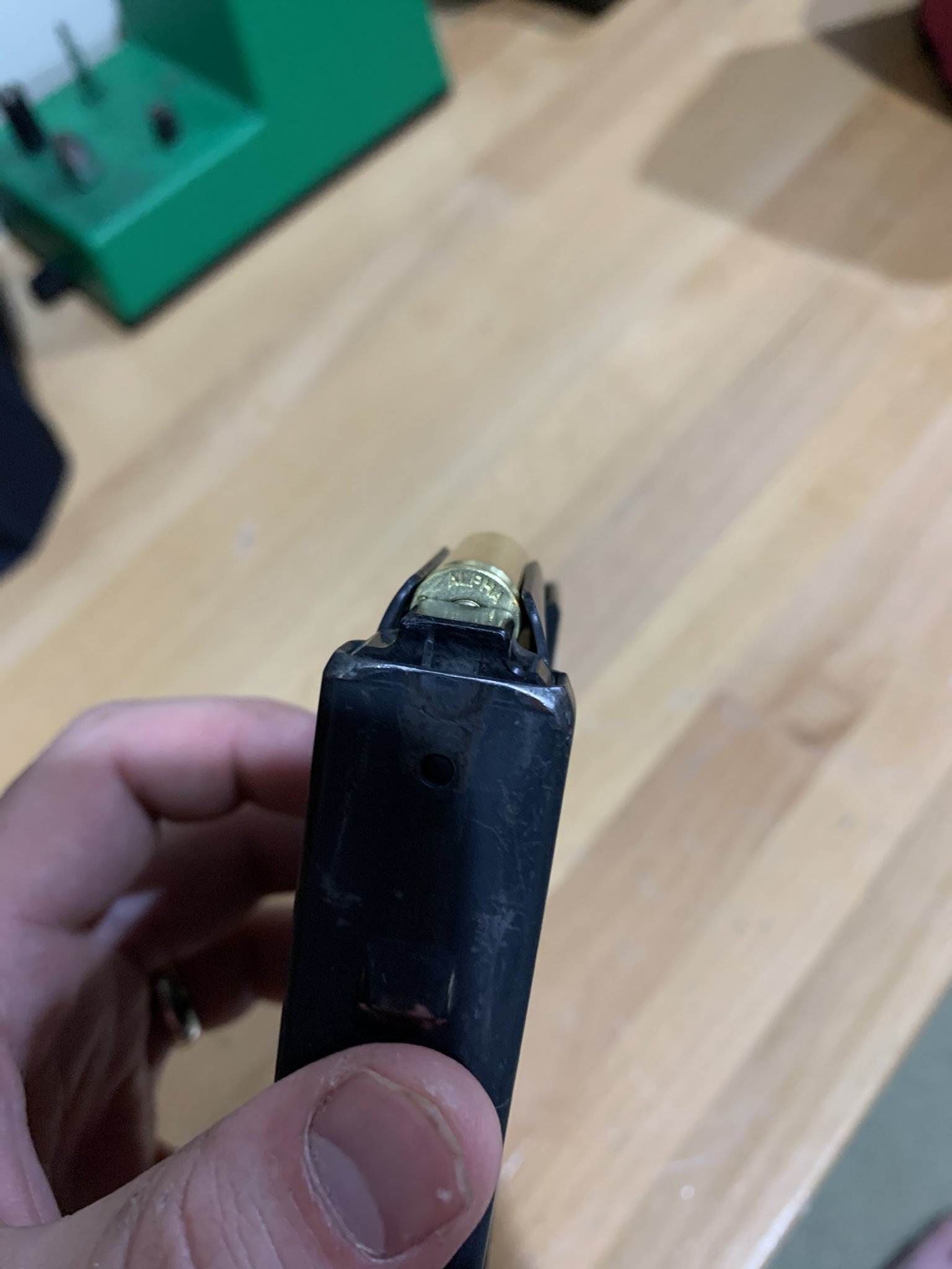

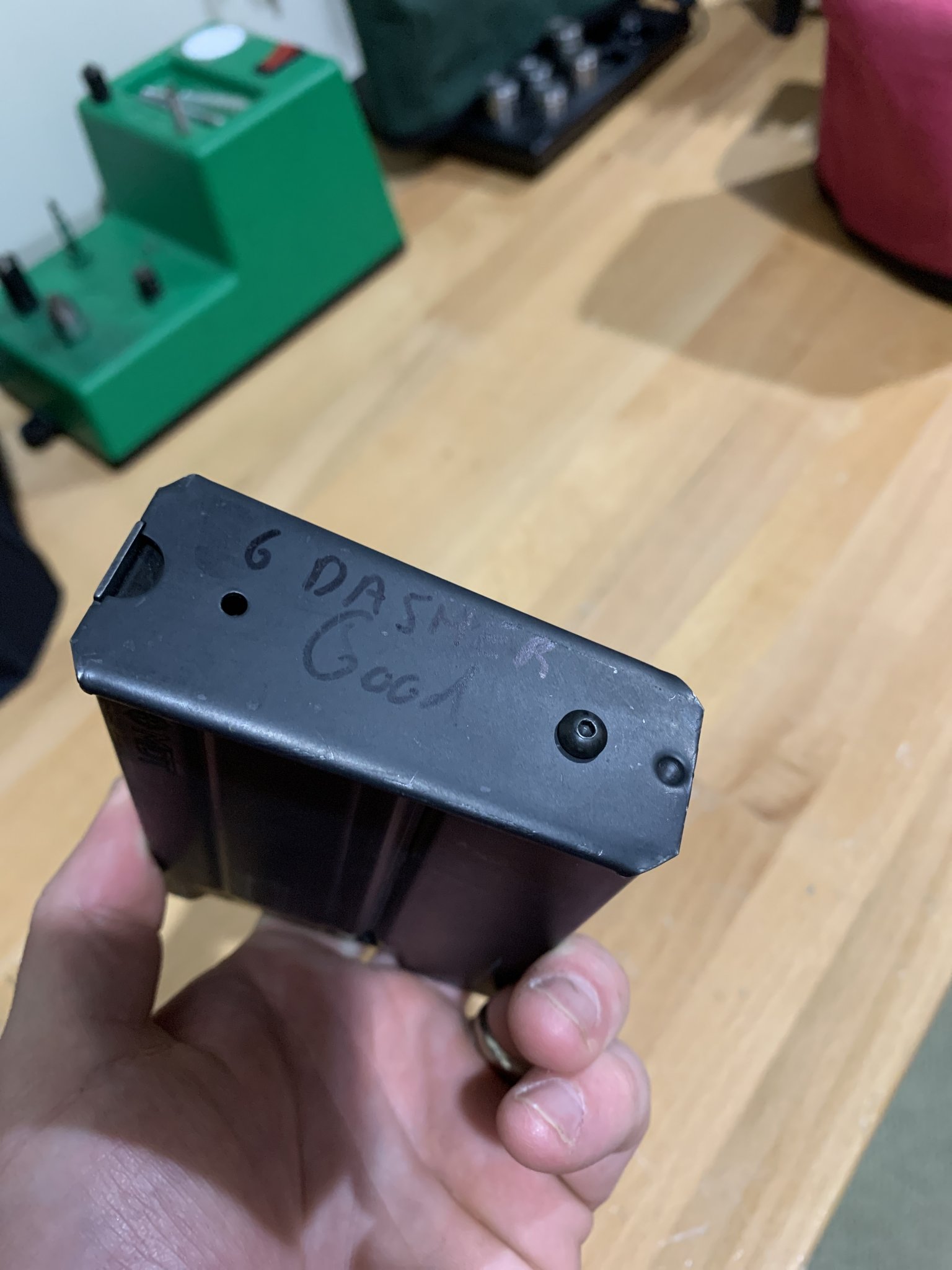

    After you taken the baseplate off and are reinstalling don’t push all the way closed. Just enough so the hole in the bottom of the mag is inside the mag body and then install the screw as shown in pictures and finish installing baseplate all the way on.
    second picture is case at the top of mag and how it sits on the feed lips. Those are non adjusted from the factory feed lips
