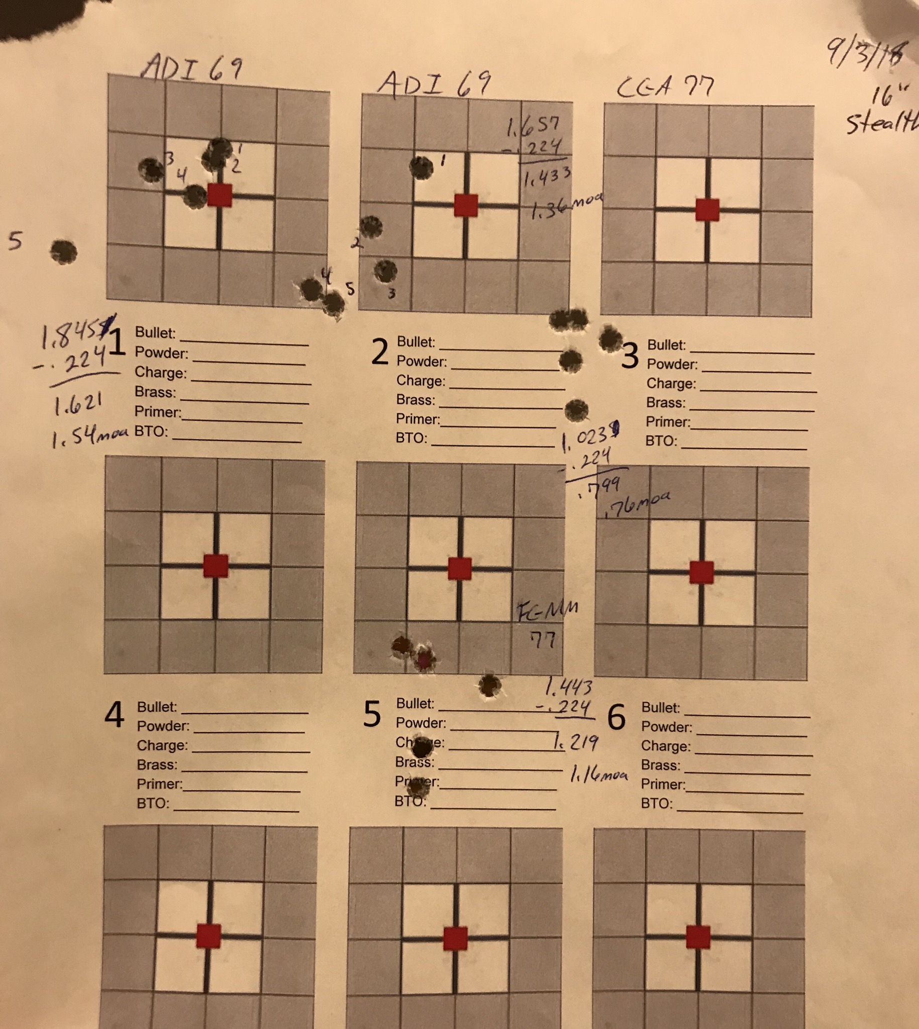

Mine is overgassed, substantially, I'd say. There are no problems with cycling or function - the heavier buffer managed to slow down the BCG enough that's it's only slightly mangling the case mouth now, versus nearly folding it in half. If anything, it could do with a stronger action spring or AGB. I know your reply was to the other poster, but I make mention for this reason: what is going on with manufacturing process and QA/QC if there's that much variability on gas port diameter coming off the line?

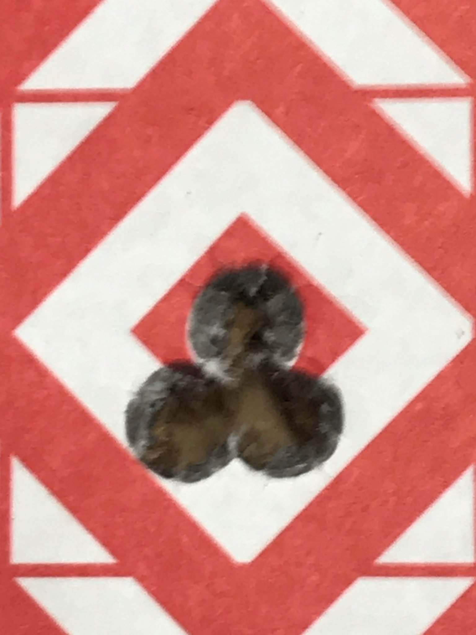

My Larue barrel likes black hills 69 gr Sierra match. I shot 2 5 round groups back to back at 100 yds. One was 0.89" and the other was 0.66". Aggregate 10 round group was 1.01". So a 1 moa 10 round group. Was a vortex viper hst at 10x.

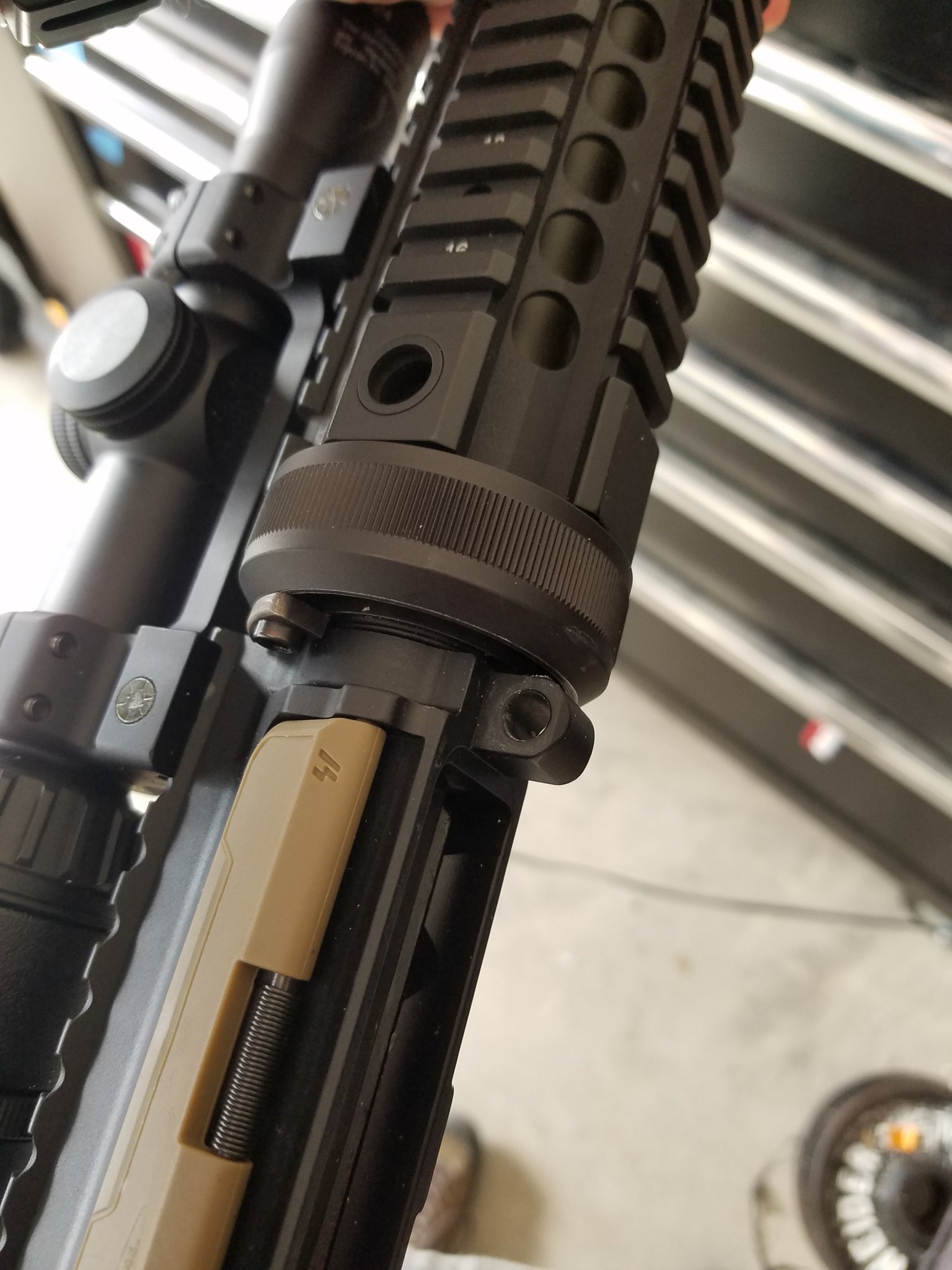

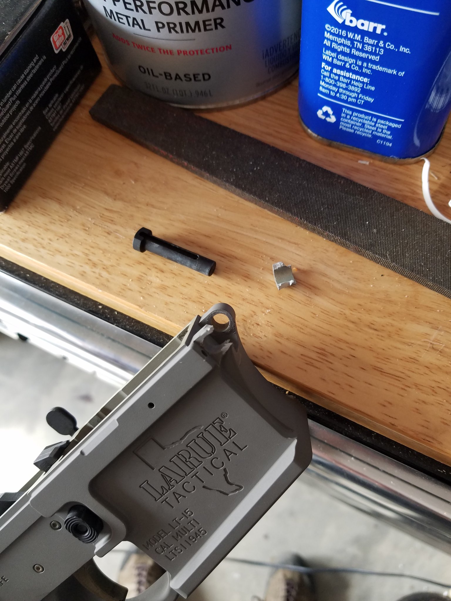

You know... I think I'm about done with LaRue for guns and mounts. That pains me some because I'm a sentimental sort of guy, but there it is.
The last scope mount I ordered went back because it was out of spec. This morning, this (likely out of spec) lower broke during disassembly.
I'll see what their CS has to say, I guess. If anyone wants a cheap Grendel upper, let me know.

How in the hell!!??
I have their Grendel up coming next week, hope it works better.
Did you ever call them with your initial issues?
Send it back, they will take care of you.

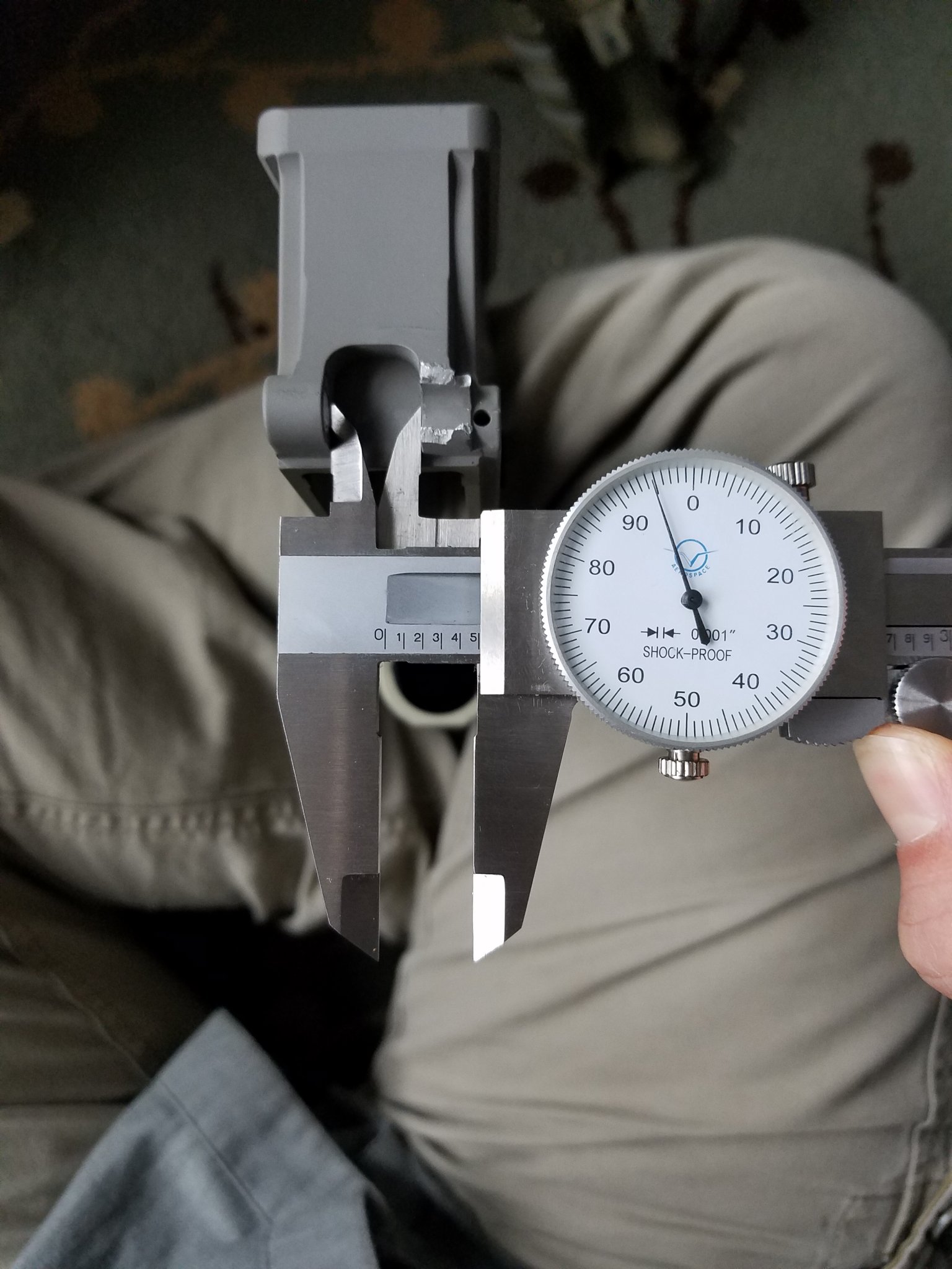

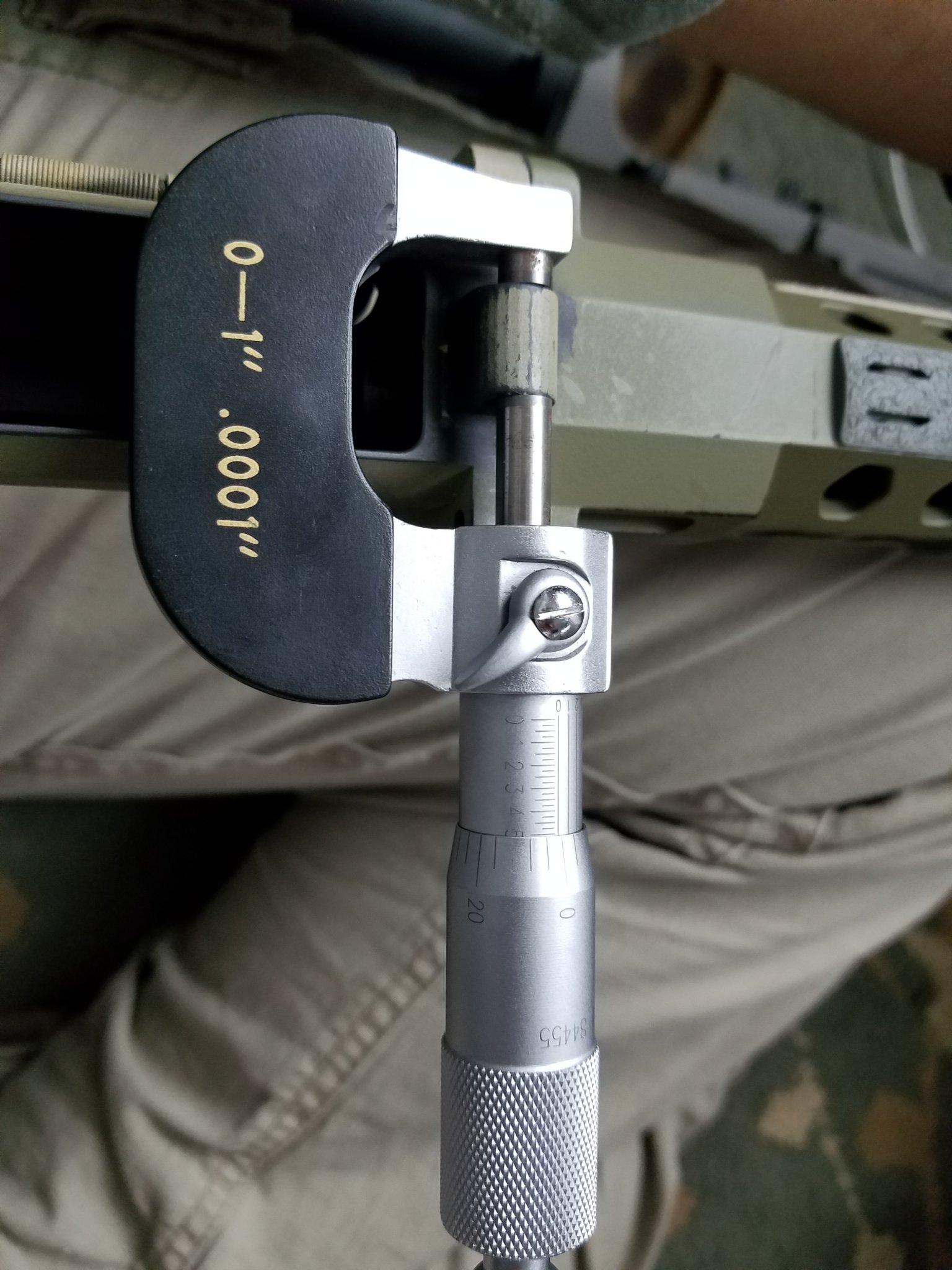

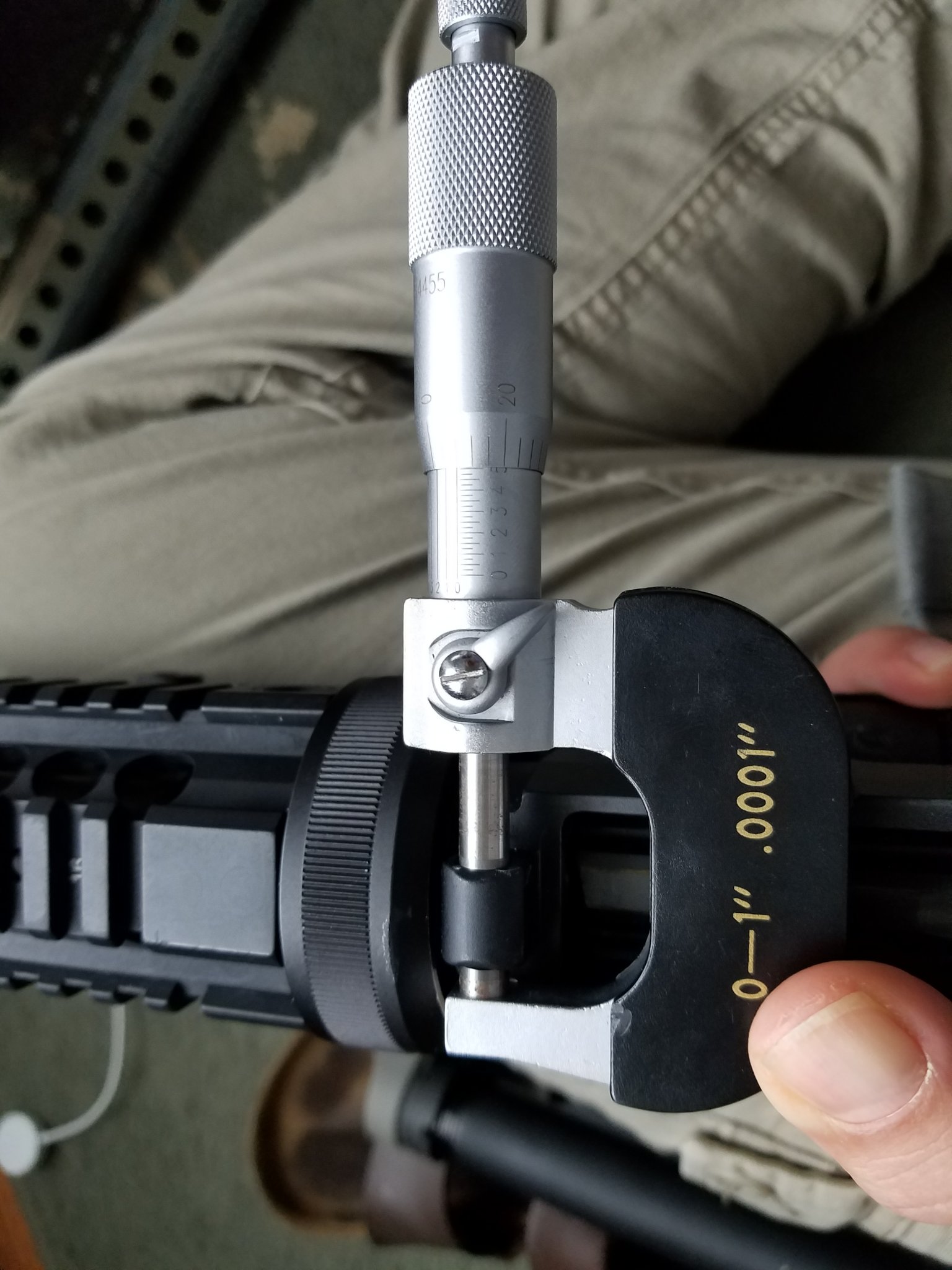

FWIW, what's left of the lower measures at .495 inches with my calipers. If the spec is .500" +/- .004 then it is out of tolerance. Cannot say what it was pre-destruction, of course, as the material may have distorted during failure.
As to the how - simple: I pushed out the rear pin, drove out the front pin and "shot gunned" the rifle because it remained "stuck" at the location of the front takedown pin; I then pushed the receiver extension and handguard towards one another to free the receivers. I certainly didn't expect it to require more force/stress to separate the lower from the upper than the lower was capable of handling.
I don't understand your question as written, so hopefully the write up is clear.
ETA: mic shots, lower, LaRue upper, CMT upper

I attempted to measure my small frame Larue lower. I got the same .495 but if I put a tad of force on the calipers I was able to read .500. My measurements are not confidence inspiring.

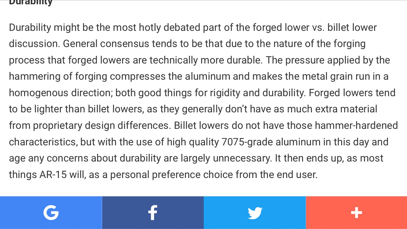

Bro, to me it is unacceptable that ANY name brand forged lower would break in that manner. They should without question make it right.

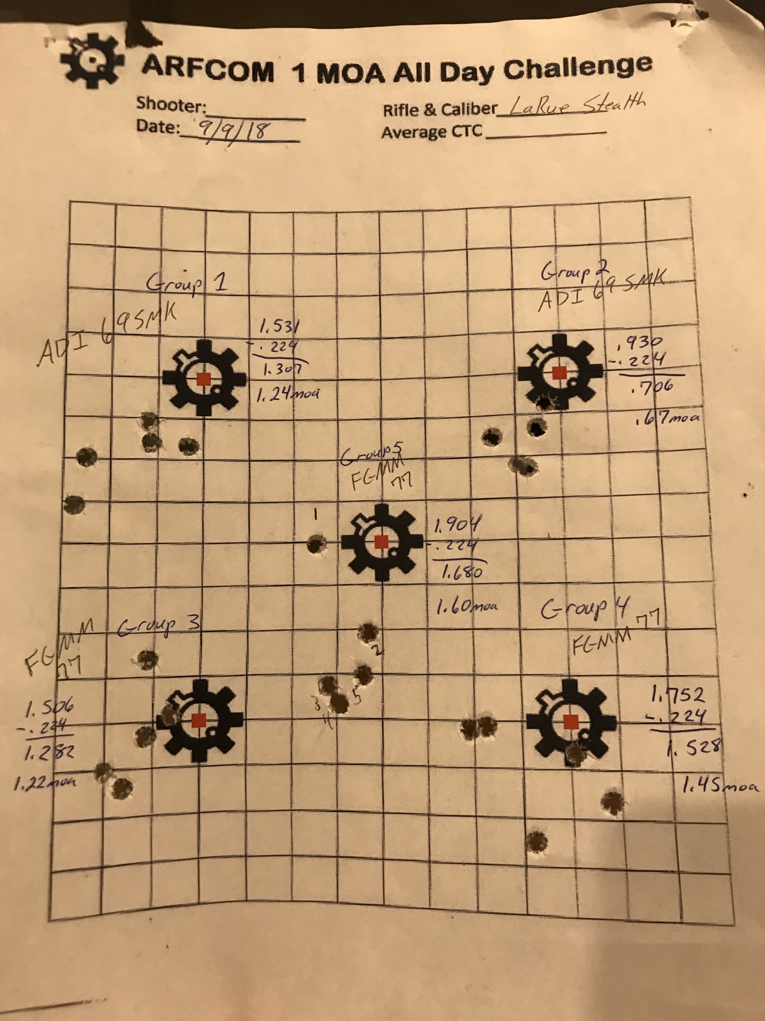

OP’s groups looked like mine with the 223 and the 224. After a few rounds, it would start to walk or throw rounds.
These are the newer barrels. Not sure if it’s heat treating or just the barrels in general, but I’ll never purchase another one. There are just too many other great options with less abrasive owners to choose from.
No lower should break like that. I thought maybe the pin holes didn't line up with the hole in his upper & he tried to force the pin through anyways but it sounds like something else is going on.
Reactions: Lawless
I agree. All of my lowers are plain old PSA, I would not be happy at all if any of my $40 lowers broke from simply taking them down...much less a LaRue or other expensive brand.
This looks and sounds about right for the PredatAR profile barrels. I know my PredatAR would cut a pretty nice group and then just go nuts when it got hot. It should not be the case for the heavier stealth, however. I'd pay a premium in the used market for one of the LW-barreled guns based on my limited experience with LT factory rifles, but feedback on the stealths is generally good. I have never used one as I do not care for the XTRAXN chambers and larger-than-most porting.

Personal aside - this is at least in part due to the notion that tighter is always better. My assessment is that when folks are making billet lowers they shoot for in house specs in manufacturing that are at the very "bottom" end of the specification range with tighter tolerances. For example, if the milspec here is .496 to .504 inches (i.e. the spec is .500 +/- .004), I'd guess firms are doing .498" =/- .002" (and charging accordingly). My matched CMT upper and lower (which I bought because they were on sale, even though I really only needed the lower) were a super tight fit - mild interference, even. The CMT upper measures right at .497" at the interface for the front take down pin. The LaRue lower is smaller - i.e. there's an interference fit there that essentially locks the upper and lower together. I did not appreciate that before assembly, nor did I measure it. Based on how tight the CMT upper and the LaRue UU were on the CMT lower it wasn't a concern The take down pin was so tight that I had to use a hammer and punch to drift it out - again, not a first for this, wasn't really concerned. Between the lugs and the pin, clearly something "stuck" - probably something small, which caused an initial yield/failure that compromised the part integrity and then propagated until the part failed catastrophically.

ETA: sorry, it's the LaRue upper that mics right at .500" - the CMT upper mics at .497" as I've corrected above. Photos were posted above.
ETA2: tried fitting the busted lower to the UU tonight. They don’t fit together...at least not without a hammer...maybe. Had I tried that first, I feel like this all would have been a lot more straight forward...I could have sent back a non-functional lower in perfect condition with fewer issues, I think.
