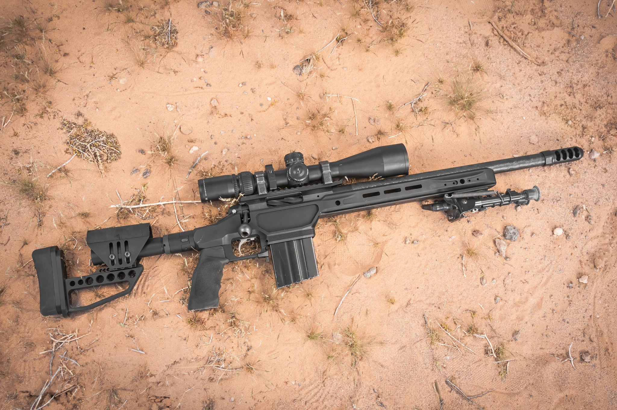

Bolt lift is just under 7 lbs on the new Deadline action. During testing of the Deadline, we have not had a single bad extraction or ejection. That was firing hot loads, hot loads stuck in the lands, proof rounds.... you name it. The savage extractor style works well when it is properly machined. The extractor can't actually come out, since the ejectors are in the way. The dual ejector system works awesome, no matter how hard/soft you pull on that bolt. Reviews are to come soon! keep an eye out.
Nice rifle^^^^i realy want to do a hunting rifle in a xlr carbon.
Sent from my SM-G930P using Tapatalk
Thank you! I originally built the rifle as a 6.5mm Creedmoor match gun but haven't been shooting matches. When hunting season came around it was my best option. I'm looking forward to getting my hands on the Deadline and am planning on a lightweight 6.5mm SAUM.

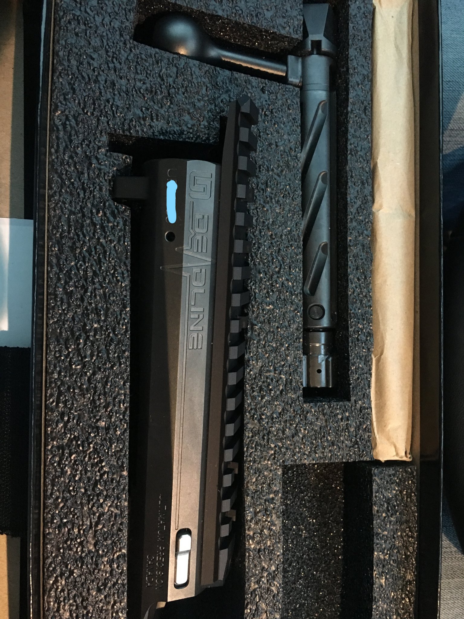

Picked up from the FFL on friday! Pending Build list includes:

Might take me a few weeks for a full range review, but here are my first thoughts:
Ultimatum Deadline:
Built like a tank. love the 60deg throw, swept back handle, and the dual ejectors seem to work nicely while just cycling. Action cycles nicely, and should smooth out even more upon use.
KRG Bravo:
Feels rock-solid and has tons of features. Zero complaints for $300!
Timney Calvin Elite Adjustable:
LOVE the trigger. I have fairly large hands, and love the fact that I can move the trigger forward...just feels way more natural. Breaks crisp, no creep, and factory set to 1/2lb pull. This may end up in my match rifle sooner rather than later.
