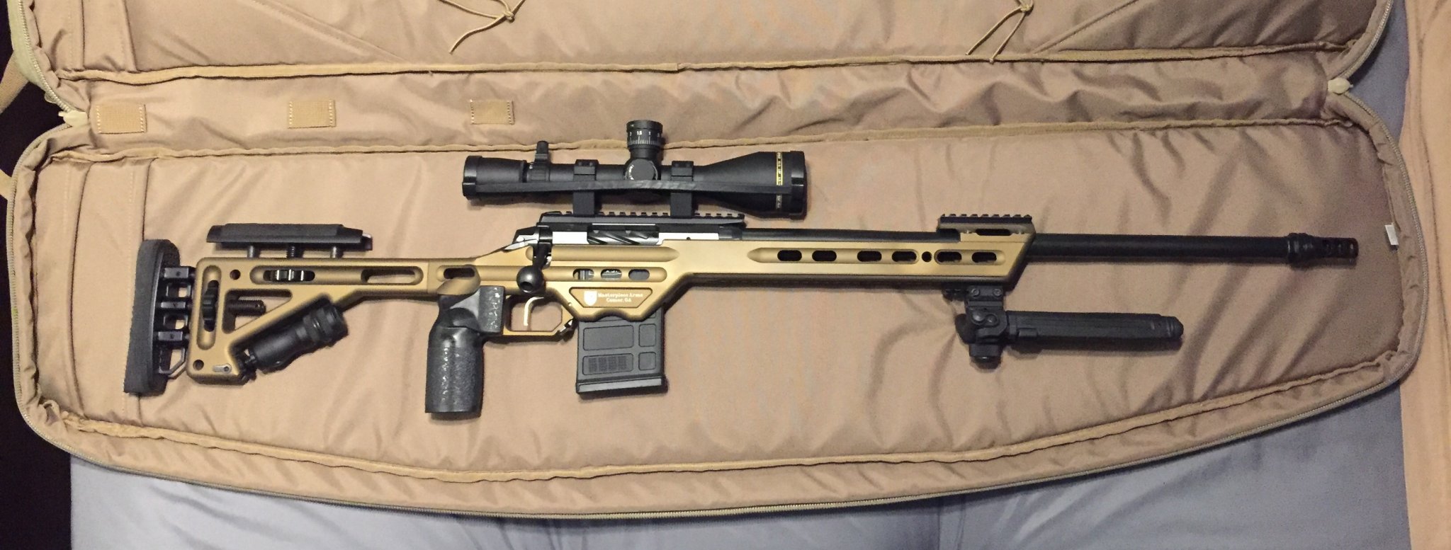

Trimmed .065 from mag catch and .080 from the longer MPA action screw which went in the rear.
A friend is gonna throw a small shank barrel on it this weekend before im it heads to WTO for a barrel and some play

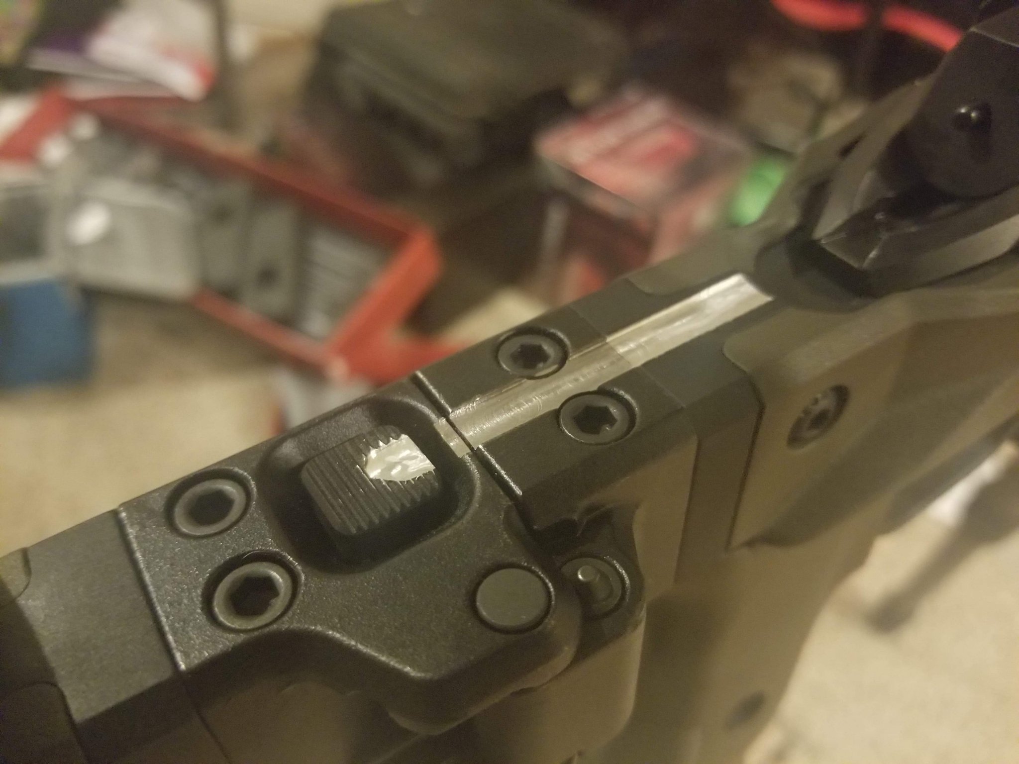

I have one as well. I went a different route with the chassis. I picked up the magpul pro700. Now it required more modifications than the others out there but it wasnt hard to do. I work at a machine shop so I have access to some stuff that made it easier. First I had to mill about .045 deep channel to allow the cocking sear to have clearance. The pro700 has a straight back buttstock and doesnt drop. I had to make a bevel in the inlet for the trigger hanger and had to trim the mag catch like everyone else. I had to do less because I'm running aw mags. As for the 223 because I run this as a switch barrel, I cut the top of the mag down from mdt to fit without having to have a second mag catch, magpul made it very clear they wouldn't give me another one....
I also did the same MDT 223 mag modification to fit the same height as my AW 308 mag catch. Easy stuff.

I was wondering why I was having problems with the rear action screw. I'm assuming you're running the Deadline in an MPA BA chassis as well? Is your measurement of .080 dead on? I'm considering taking a mill file and shaving down the screw as well.
deadline in MPA Comp. yes
.080 is close. put it the whole way through the rear tang and you can see how much needs to be trimmed. it's easily visible

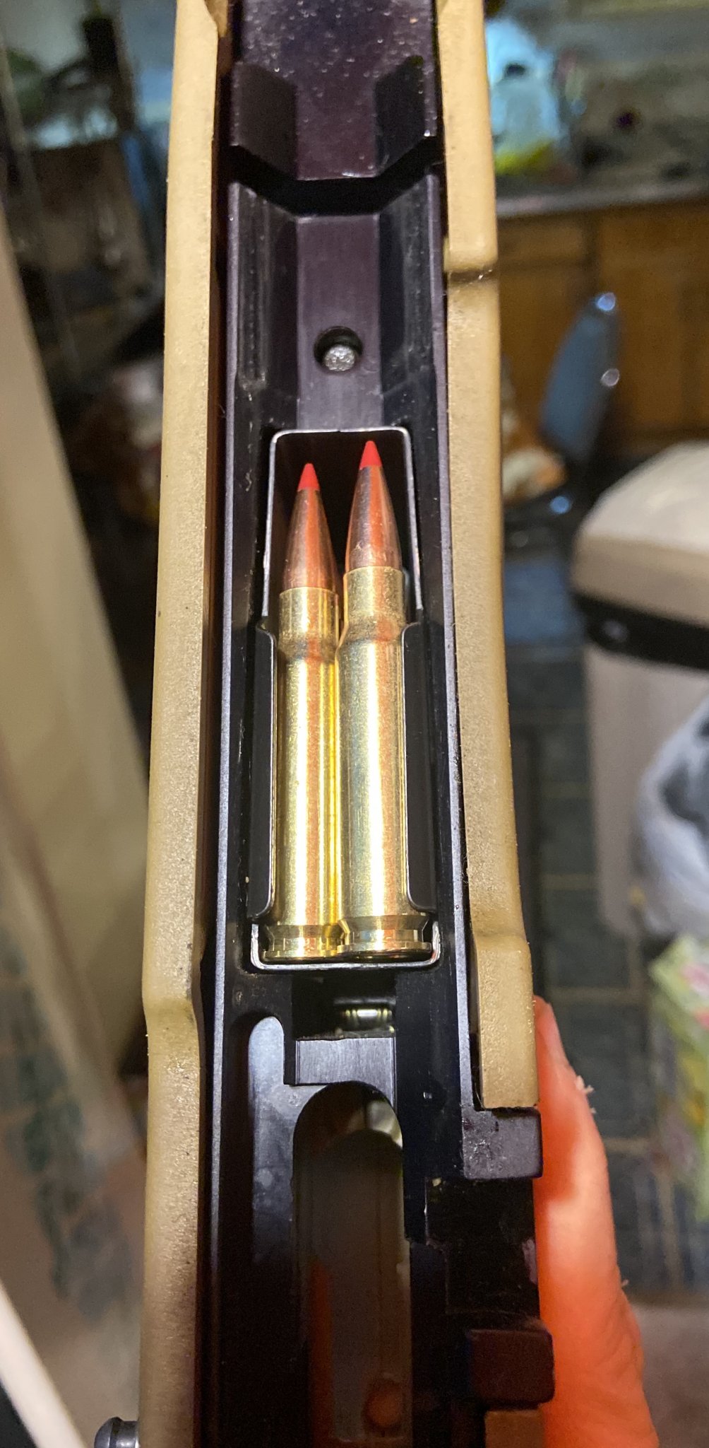

So I just realized my old Gen 1 AICS takes AW mags. Looks like I’m going to drop one of these actions in and I’ll have a backup rifle for PRS.
