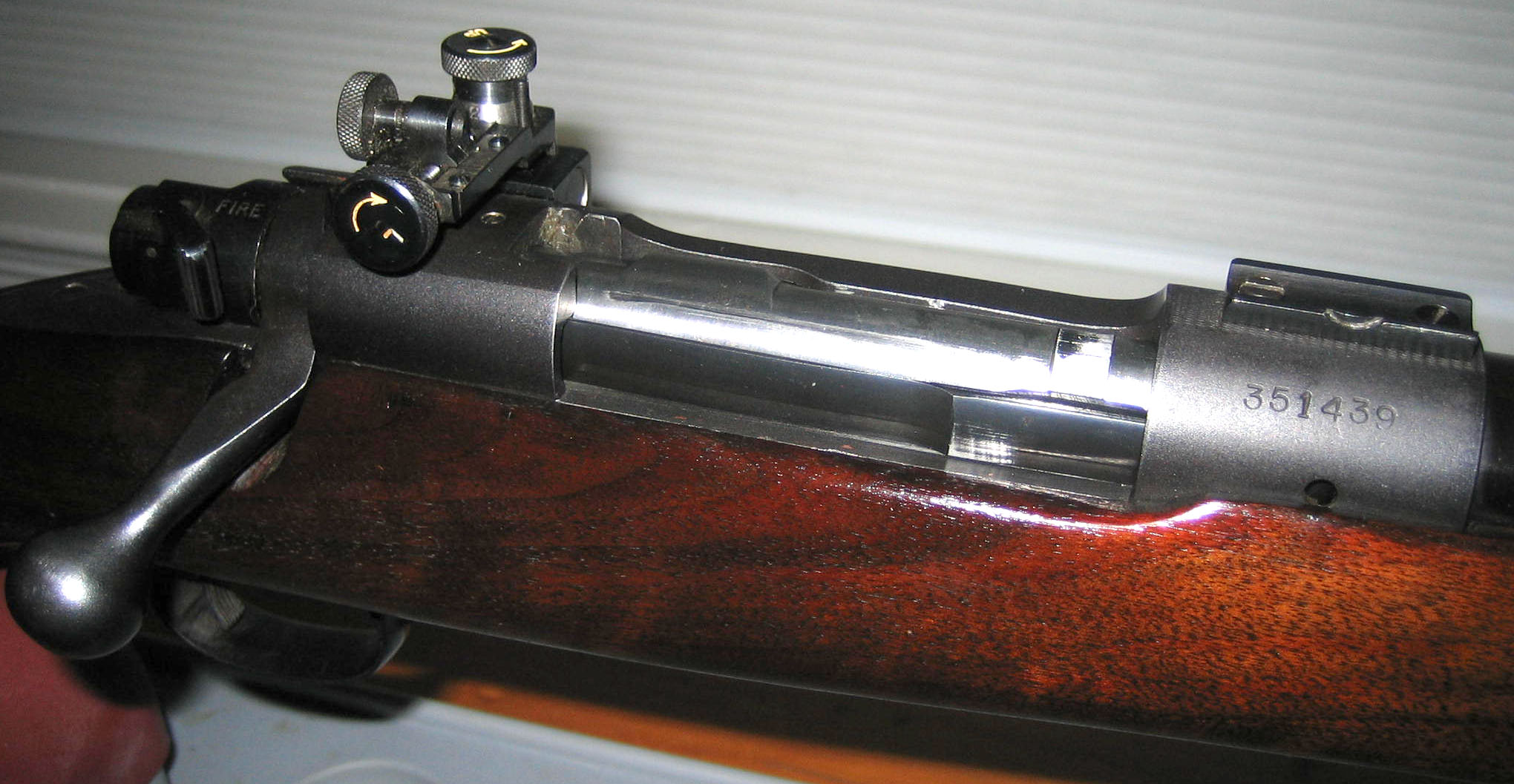

    I finally picked up the RIAC Model 70 Van Orden rifle this evening. I have attached a couple of very quick (rather poor quality) photos.
    As soon as I get the chance, I want to dismount the rifle from the stock and do some quality inside-and-out photos, which I will post here in the hope of drawing comments from the followers of this forum about how the gun in its present form appears in relation to other Van Orden Sniper rifles they may have examined.
    At this point I can say that the barrel is free floated and the fore end screw is a dummy (Winchester themselves did this on occasion with their Varmint rifles - which also had Medium Heavy barrels). I'll be curious about whether there is any bedding compound on the inside.

    The non-scoped rifle is civilian and not free-floated, nor glass bedded. The scoped rifle is "US Property", free-floated with minute evidence of glass bedding. The non-scoped rifle is for sale.

    Did both of your rifles come through Evaluator's Ltd? One civilian-sold and the other sold to US Military for marksmanship competition? Only reason I ask is that I'm curious about what work Evaluators Ltd did on the guns they special ordered from Winchester before they sold them as Van Orden "Sniper" or "Special Target" rifles. The Van Orden rifle I have has a free floated barrel and what looks like a very small amount of bedding compound. I also happen to have several strictly original civilian pre-64 Model 70 National Match, Target Models, and Bull Guns. None of them has either bedding or a free floated barrel. So I suspect that the barrel channel modification on my Van Orden rifle was done after it left the factory, possibly by Evaluators Ltd and possibly by the end user?
    Appreciate any thoughts.
