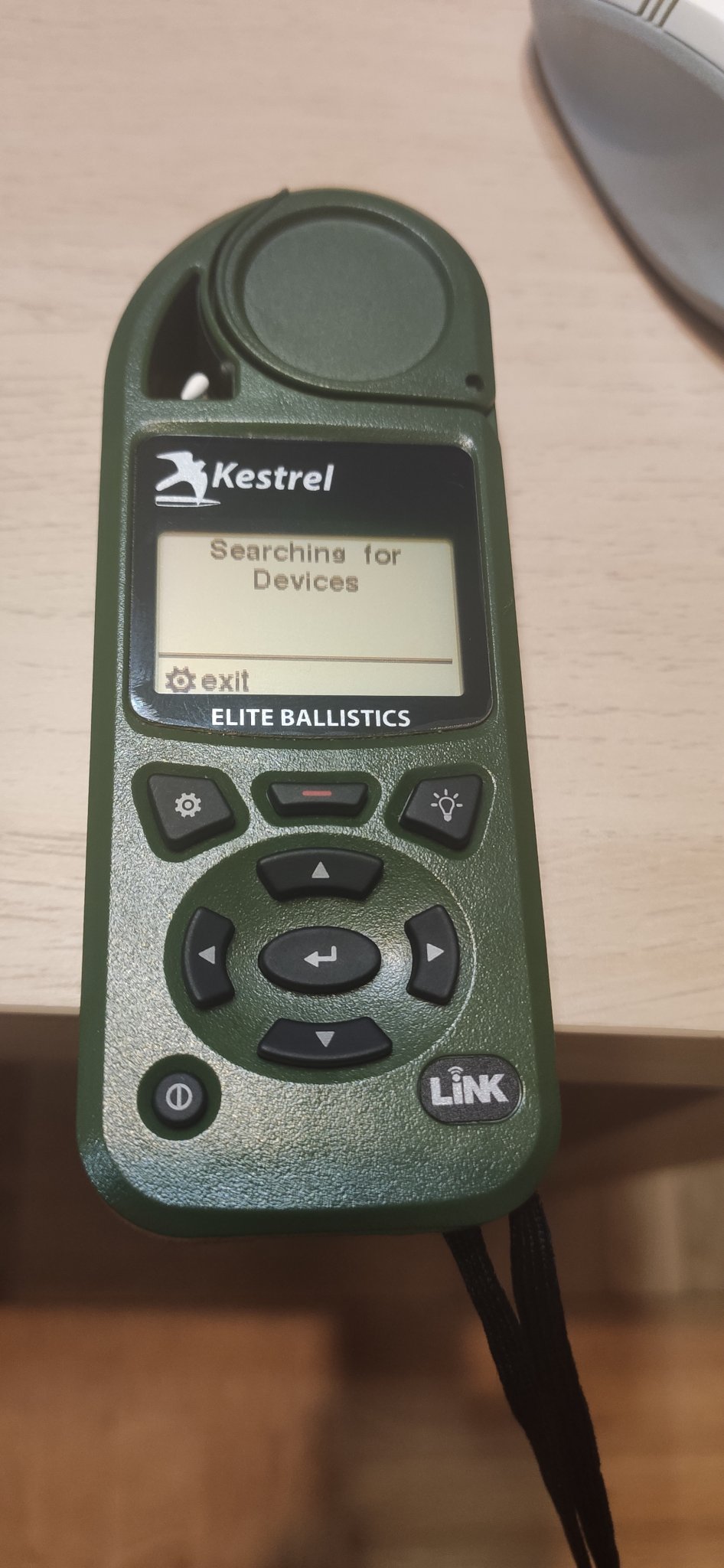

My Kestrel can't see the Terrapin X after update.
Searching for device never stop.
I'm disappointed(((
