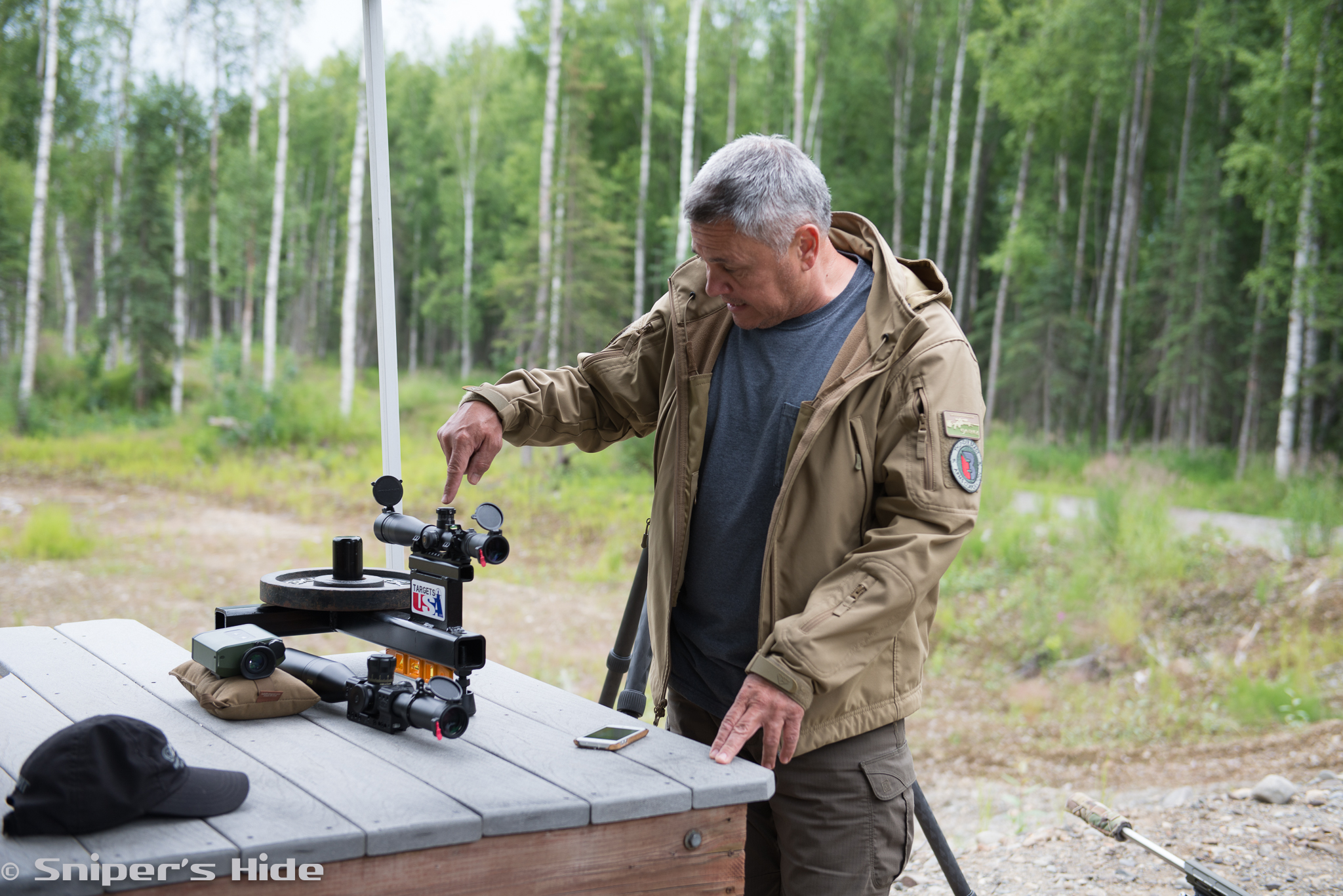

The manufacturers are aware of this, the first question I was asked was, "Were these vertically split rings" and the answer was yes.
Then in the explanation of the symptons, it was explained how they pinch the internals and the scopes will actually work UP & RIGHT and not work left and down.
The Left and Down problem is why they did not return to zero. They will track out, but not back. It forced us to design the scope testing tool because it was getting worse. Up in Alaska, there are not a lot of high-end shops, most mail order their scopes and they buy the cheap rings at Three Bear.
We tested this, hardcore across multiple classes and students and saw it first hand.
We tested an entire class of scopes more than once and found them lacking just like the companies said

We swapped some out and they worked
we did not have enough spare parts to truly test this aspect of it on grand scale
We usually carry spare scopes in our rings to replace problems, we did not carry spare rings and to be honest you cannot slow a class down more than we already do fixing stuff
This last class we had 2 scopes with issues, we just replace them with spare scopes, we don't attempt to diagnose them, takes too long.
