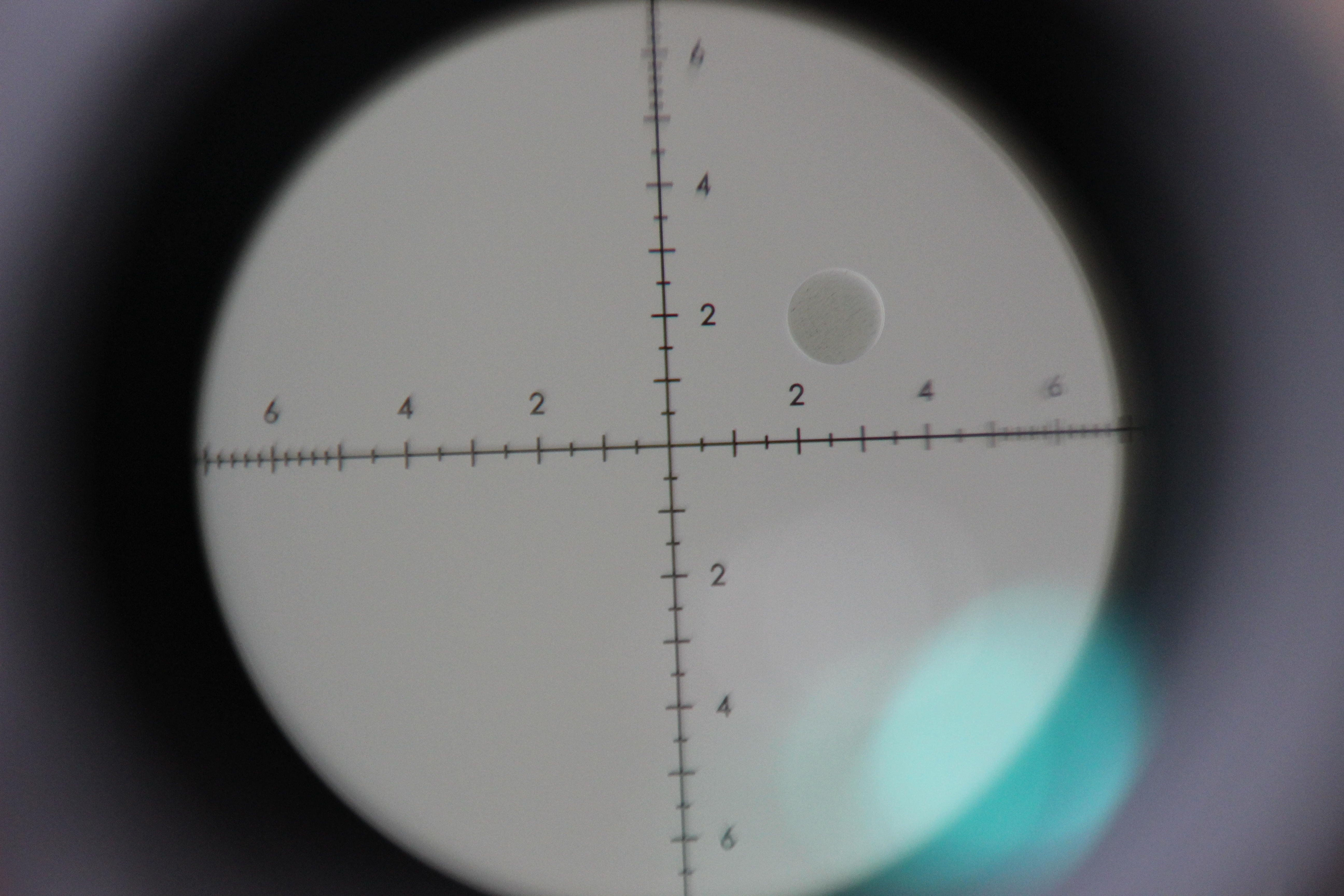

Well, it looks like I will be sending in my PST again. For the second time within a year there is moisture / grease stuck on the inside glass. Last time this happened they told me it was moisture, but when I brought it to their attention this time they are claiming that the internal grease must have became less viscous and splattered onto the lens. I figured I would post this to keep a public documentation of the situation.
https://www.youtube.com/watch?v=zY1grKlkF0A
Here is the email I sent them yesterday(5/26/2014)
Well, unfortunately for the second time my Viper PST 6-24x50mm FFP MIL riflescope has failed me. I would normally be much less upset about the issue, but this is the second time this exact same issue has happened. I know to some the PST line is a middle of the road scope, but for myself $950 is a lot to spend on glass and I really went out on a limb to try your product on the recommendation of many other shooters. Last time this happened, you were able to take care of the problem by purging the scope and re-sealing it, but being that the same issue has happened twice now I am led to believe the problem lies within the scope itself. I have done nothing to abuse the scope, it has never been dropped and has lived its life on a heavy .308 which has fairly soft recoil. I really cannot explain why this would have happened, but I would really hope you guys could take care of the issue. Being that it is the second time this scope has had moisture in it I don't think it would be too much to ask for a complete replacement rather than another servicing. I am fine with sending in everything with the scope, I just don't want to keep getting screwed by this optic which clearly has issues that persist beyond a simple purge and repair. I don't know if you guys keep a record of the repairs, but my S/N is -------- and it was repaired in July 2013. Since then I have only been able to shoot it a handful of times and yet it still managed to accumulate water droplets inside.
Please contact me ASAP. Thanks, Mike --------.
Their Reply(5/27/2014)
Good afternoon,
Thank you for contacting Vortex Optics. I am very sorry to hear about the moisture again. This is actually grease that is already in the scope, it is not coming from an outside factor. They cleaned the reticle off last summer when the scope was in for service. Sounds like they did not get all of the excessive grease out of the scope. Also, as the weather warms up the grease thins out and can splatter onto the reticle during recoil. However, it is a problem none the less. Generally, once the scopes grease is cleaned out this will not occur a second time from what I have experienced. I am happy to send a shipping label that I have attached to this e-mail to get the scope in. I will have it come to my attention and have our lead technician take a look at it. I cannot promise a replacement. As with our warranty repair comes first and this is an issue that can be resolved for good. The replacement decision will be made by our technician. I have also attached the repair form to send in with it. Let me know if you need anything in the meantime. I will be keeping my eye out for the scope.
Kind regards, ----------
Hopefully they can get this sorted out.... AGAIN :s

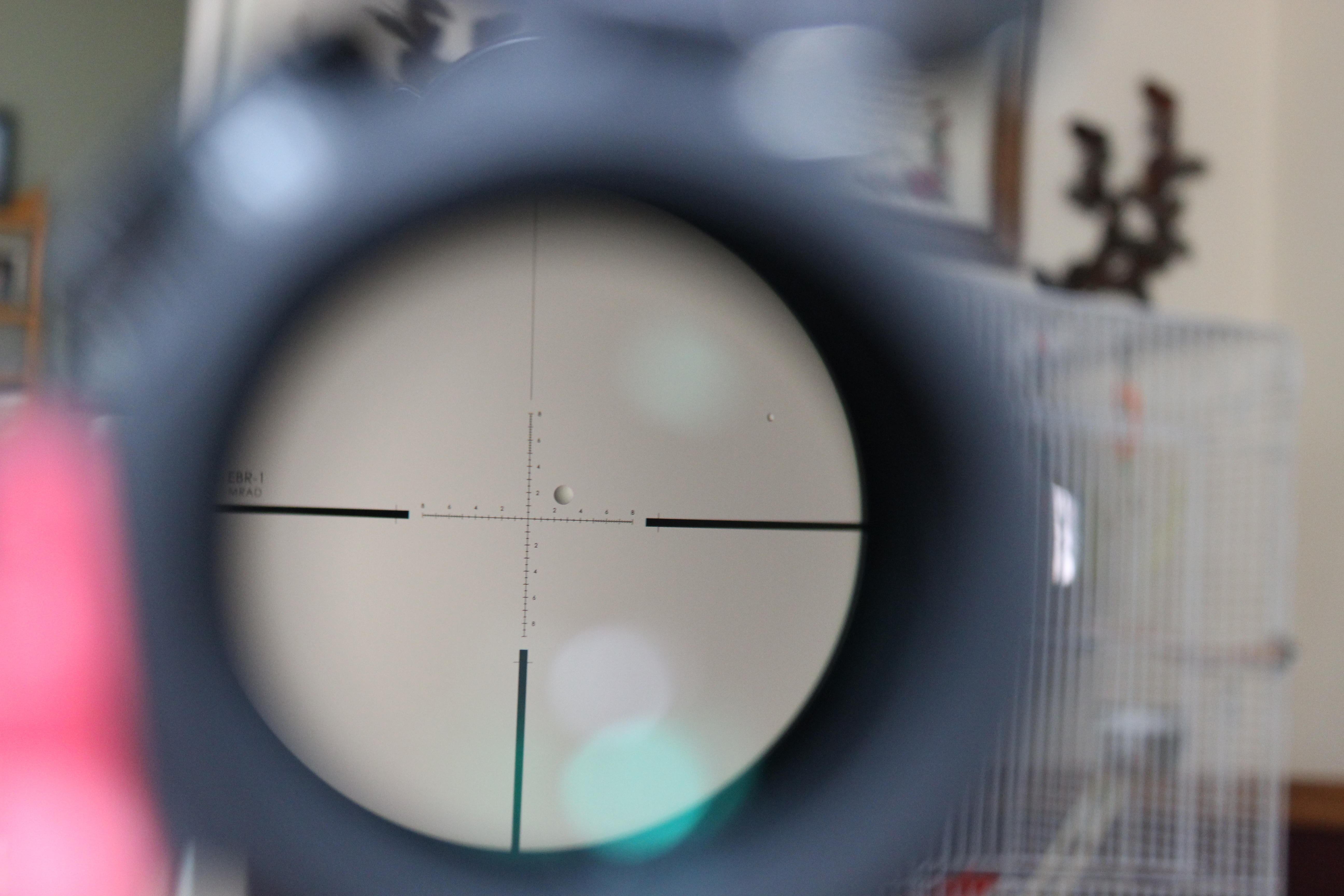

Here are some pictures of the fun.

Well the scope was bought back in July of 2012. Didn't have any issues until July 2013. Unfortunately I haven't been able to do much shooting this past year, but even still this just popped up from normal use. I can say, that both times this happened it was when it was hot and muggy 90*+ with high humidity so their viscous grease statement may make sense. That being said if that is true Ive got to wonder how people in southern states don't have this issue all the time.
I regularly shoot in the desert where it’s typically 80F to 100F and haven’t had an issue with grease making itself present on the reticle. Often times the rifle and scope sit in the car where it bakes in direct sunlight too before use.
I’m just going to chock it up to bad luck, and someone heavy handed on the grease.

That's exactly why I wasn't too thrilled. The scope has NEVER been abused. Never dropped, never bumped, and never splashed, hell, even shot less than I would have liked for this past year.
When I really get to thinking about it, if it is indeed an issue of grease becoming dislodged and splattered onto the lens I really cant call it a "failure". Really at most its just a PITA inconvenience, but I guess I expected smooth sailing from a scope of this price range when I hadn't spent that much on glass before. I don't really see how an issue like this could have been prevented or discovered other than shooting it, but at the same time I've got to wonder how it happened to me shooting it on a .308 in somewhat mild weather conditions. I mean I know there are guys out there running these on much harsher recoiling guns and in way hotter scenarios so I've got to question how it pops up like this when conditions weren't really that bad.
I don't know, its all speculation and and talk is cheap so I guess I'm just left wondering.
My PST 6-24 also had the oil on reticle problem. It was definitely caused by the use of a rather vicious muzzle break on an AR .308. I used the scope with a suppressor, no problems at all. Also no problem with nothing attached. As soon as I put the brake on, the oil splattered everywhere.
I sent it back international post (being in NZ), and it got lost on the way. Vortex sent me a replacement any way! Truly amazing customer service. I'm pleased to say that the lost scope did eventually turn up. But I was totally blown away by them doing that.
It would have been nice not to have to send it in at all of course. But now I know the limitations of these scopes, I'll just put it on my soft recoil, suppressed rifle instead.

Just got home to find my scope. They did in fact give me a new scope altogether. I actually thought they sent me the wrong one whgen I saw how much the box has changed vs. when I bought mine. Video is uploading, I'll link it when its up.
BTW. I'm fairly sure this on has the "metal mag ring" you guys mentioned. IF nothing else it sure looks different from the old knurled one. Anyone care to comment on what the actual difference is with the metal mag ring models or is that just an identifier for a new and improved scope?
I think the metal mag ring is the only stated change, and was basically a mid-2013 change to update the look. I've seen one single post here stating that it also brought improved glass quality on the 4-16x50 model, but I haven't seen that claimed anywhere else.
