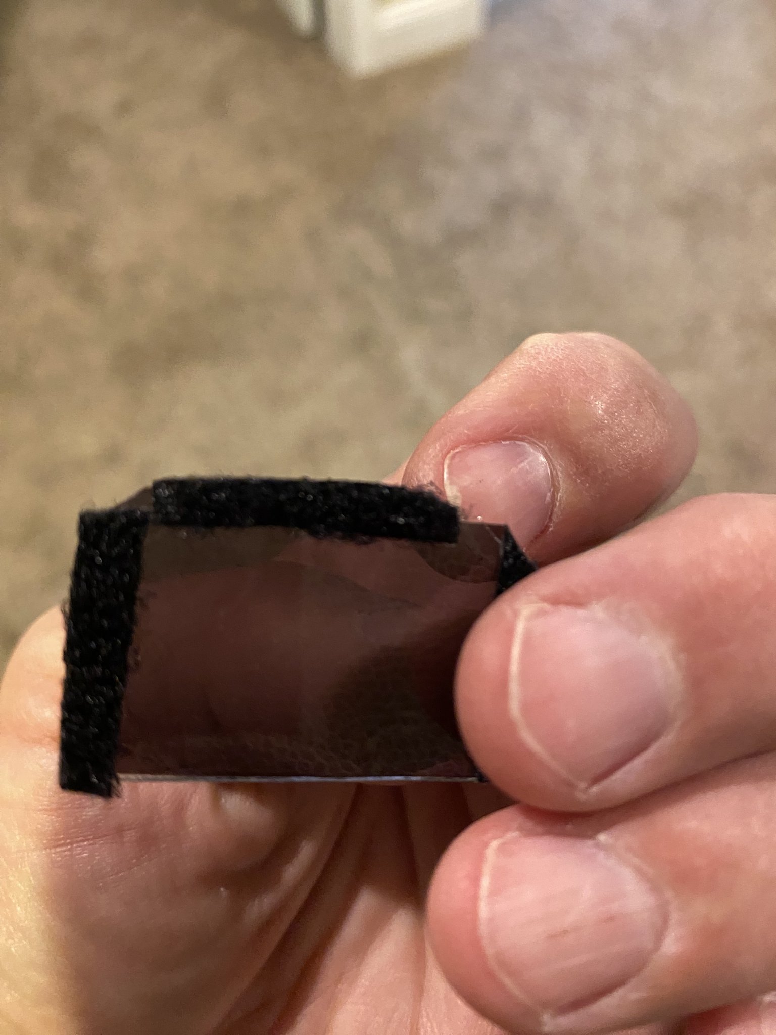

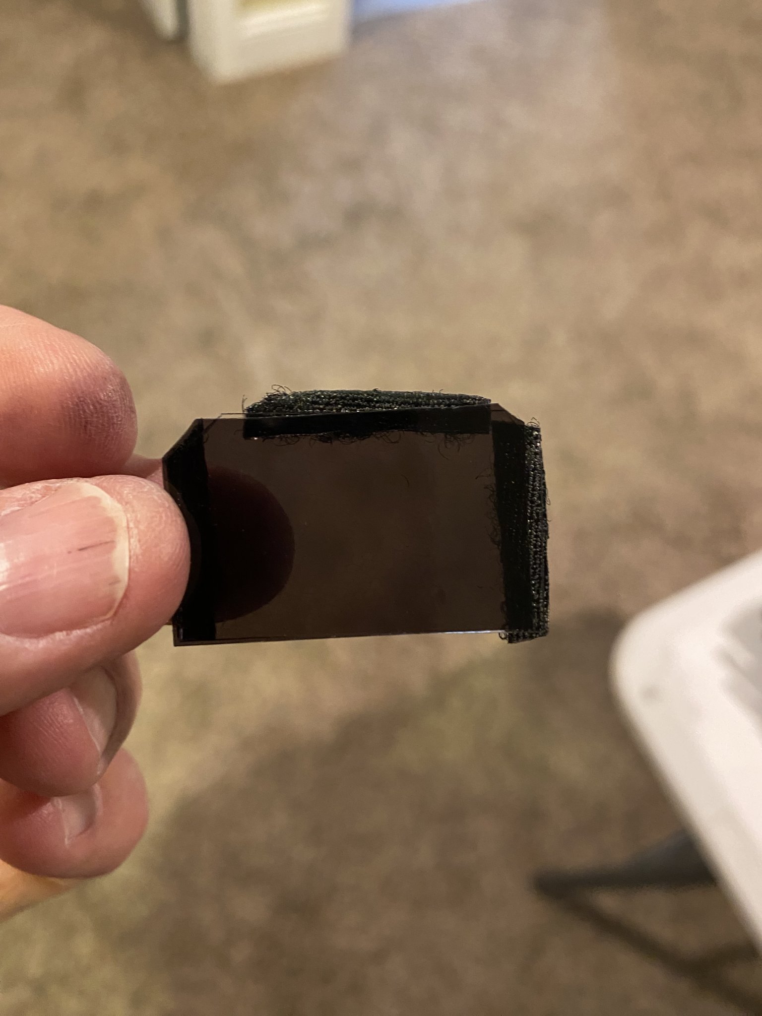

I made some screen filters based on what @fifdynutz used. I had the adhesive Velcro on hand, bought the plexiglass and tint off of Amazon. Takes about 5 minutes to make one. So far using one layer of tint with the brightness turned all the way down works good. Easy to pop off and see it in the daylight.

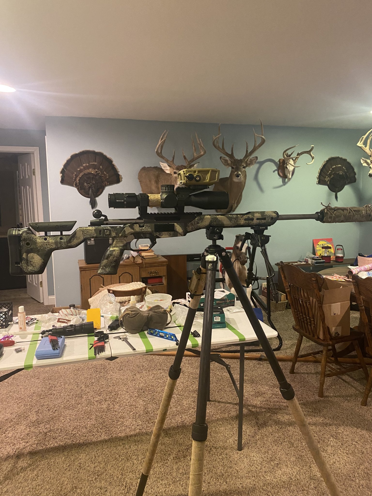

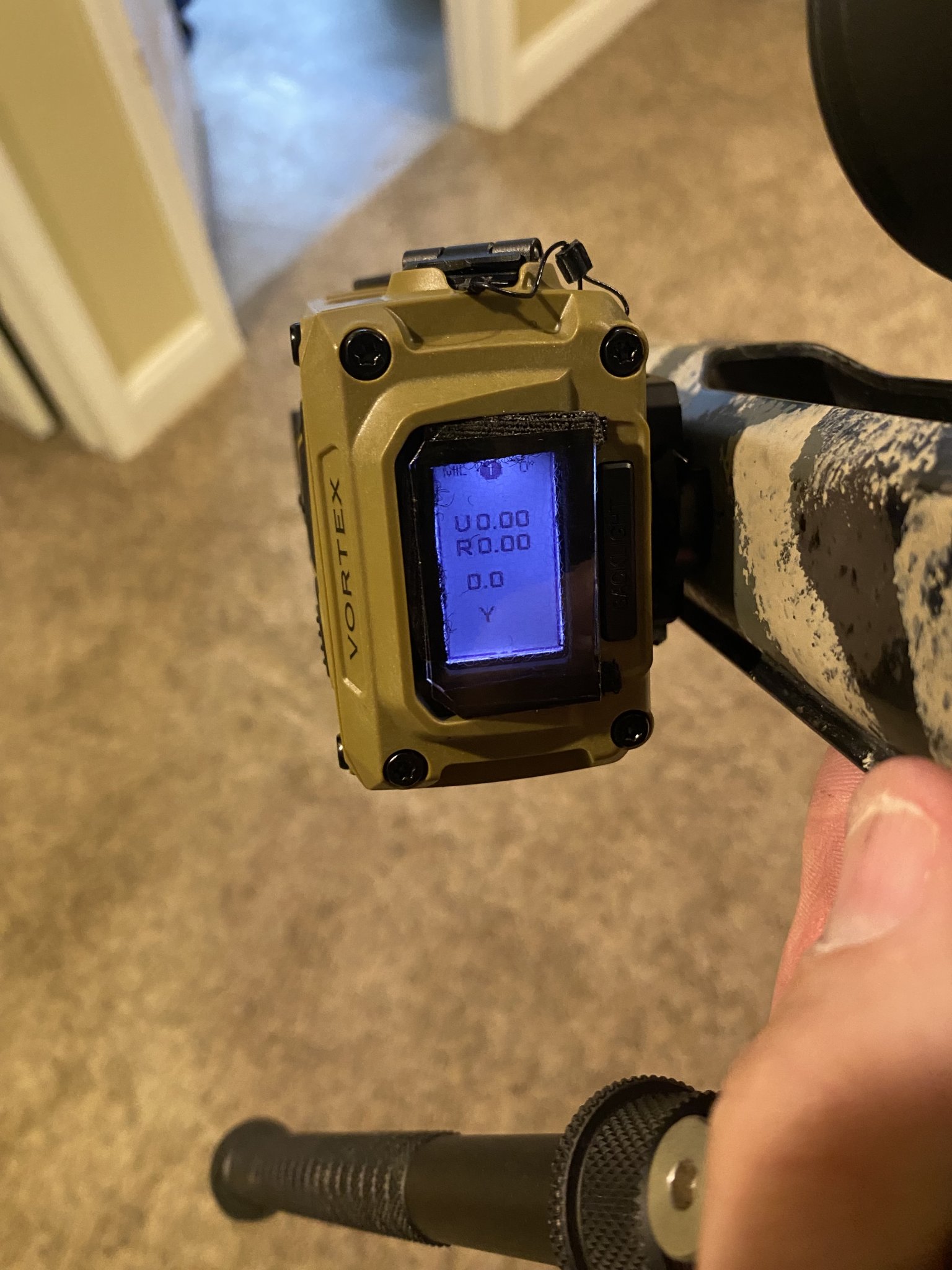

Hmmm. you have me thinking now. the unit worked flawlessly past 2000 yards in october, and have since moved it to as gas gun side saddle config. After zeroing and recalibrating compass; I took it out to 1000+ range. the ranging showed 836 at any distance from 600 to 1300. 3,4,and 500 was spot on money. I leave the scope zeroed and run the reticle for fun(taget shooter). The one difference I never thought of was the ARD. I have some development loads to run, and will stamp out a hundo and try again with and without.

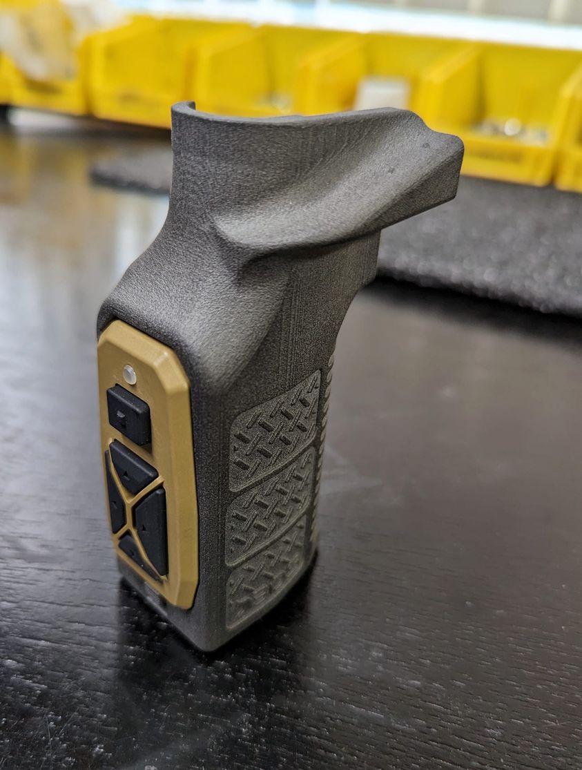

Would like to try one of these, but would much prefer a version that had a slight cant to it (The ERGO deluxe grip that comes with the AI AT-X is perfect).
Vertical grips are uncomfortable as hell to roll around the hills with I think, personal preference.

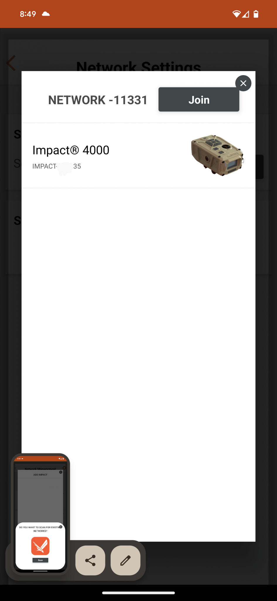

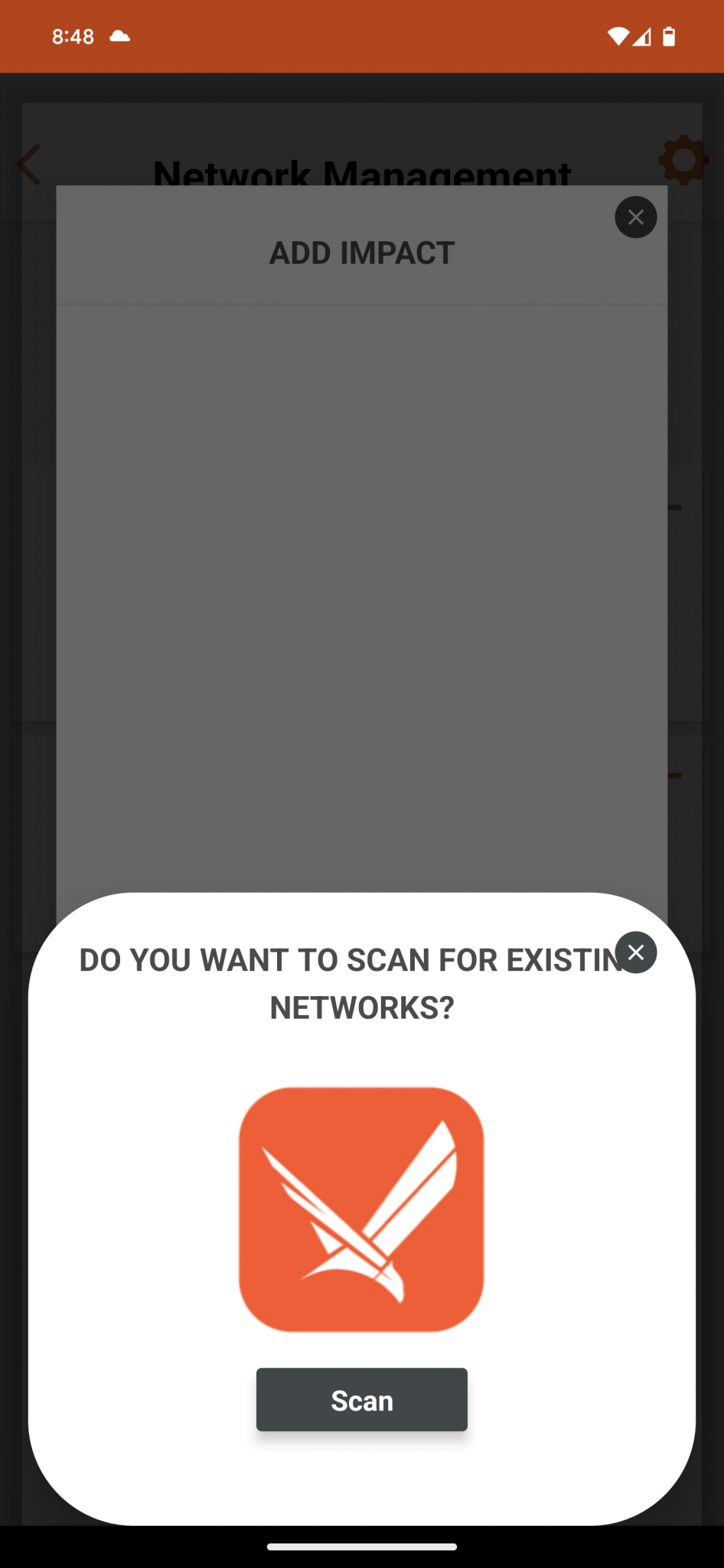

*EDIT: I was able to get the Impact to connect to the iOS app. The trick was that I had to first use "remove" on the impact under devices. Then once that was done it would successfully connect to the iOS app. I haven't had success yet with Android and I'll try again later but for now I'm just happy to be able to have an easier way to setup all my profiles vs. having to use the keypad on the device.
Thanks, I tried clearing data and cache on Android and I just installed the iOS app just to troubleshoot the connection issue so it was a fresh install.
Here's what I'm trying and seeing Everytime I try to connect on either device.
I add Impact and allow it to scan for networks.
It finds my impact and I hit this join button at the top of the screen.
And then I select "Yes" on the impact to allow the app to connect. Then the app shows nothing happened and the profiles aren't synced in the app. No Bluetooth icon next to the impact, data select buttons are all grayed out. The connection doesn't seem to work. I've probably tried 20x and get the same results each time.
I can't get mine to connect to the app on my iPhone 11. Anyone using the app on an iPhone?
FYI, @Scott_at_Vortex , might want to check with the QC to verify that if they check the Bluetooth connection in an inspection that they have in their process to remove the network on the device before repacking it.
I'm just guessing, but I think that's what might have occurred with mine. I couldn't connect until I removed the impact736373839 network on the impact. I think I finally figured out with careful manual reading but the troubleshooting for the connection issue wasn't initially clear to me.
@Scott_at_Vortex got with me and told me the same thing. Got it connected now.
Reactions: TylerN
First two things are to make sure bluetooth and location services are both on and available for the Geo Ballistics app.
Assuming those are on, here is what I have found is the easiest way to reset the network connections and get things connected if you are running into this problem-
Apple-
1) Uninstall and reinstall geoballistics.
2) Go to the connected devices/remove screen on the Impact and remove the Impact itself. The coin should go away.(circle with a number at the top of the Impacts display just left of center)
3) Go to the app and add the Impact. If done correctly The Impact should pop up and you can add it without getting the "allow app to join network" message on impact.
Android-
1) Clear app data. To do this- Go to app info(long press on Geo Bal icon), select storage, select clear data
Note you will also need to press and hold up and down on remote to drop the remote from the old network before you can add remote to the new network with the app and Impact that was just created.
