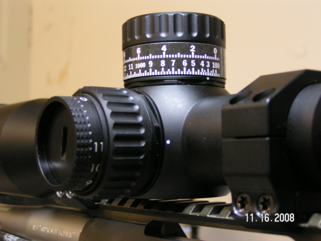

They sent me a refurbished scope really fast; however, when I went to do a traking test, this one was even more messed up than the last. I sent it back as well and Vortex Canada sent it to the States for a detailed inspection:
<div class="ubbcode-block"><div class="ubbcode-header">Quote:</div><div class="ubbcode-body">I got a call from Vortex USA. They say my scope is fine and (from what I understand) I was told that the turrests track in a circle, not a square; so that the amount of available windage adjustment decreases as you bring elevation adjustemnt to the maximum low/high.
Basically, the only time you can get full windage adjustment is when the reticle is centered, and due to my 20MOA base, the problems with my turrets are just design flaws.
I'm not sure if this is right, considering I had the reticle centered and the windage tracked very sloppy, but I'll take this new info and test out my scope when I get it back. If the turrets do track in a circle and they return the same crappy scope to me, I'll sell it no question. Move on to something that I know doesn't have s**tty turrets (Sightron SIII). </div></div>
I then recieved this letter too:
So I must have been wrong, right? Well I've still been having issues, and I've tripple checked. This think simply will not track a 19.0 MRAD box. It will track a 19.0 MRAD 'plus stign' (+) but it cannot reach the corners, basically, <span style="font-weight: bold">it tracks in a circle</span>.
<div class="ubbcode-block"><div class="ubbcode-header">Quote:</div><div class="ubbcode-body">So I just came back from the range today with the scope after it had been sent down to the States. It came with a letter saying there was nothing wrong with the turrets or edge distortion and sent it back to me (express post, much appreciated). The only problem with the whole process other than the turrets (which isn't really a waranty thing) was the fact they didn't return my CRS zero stop shims. I'll have to call them and get some more.
Anyway, like I said, just came back from the range and confirmed my fears; the turrets track in a circle, not a square. Basically, the windage would not track the whole 10 mils in each direction unless the elevation was centered. When I cranked the elevation all the way up and turned the windage, there was little resistance and the reticle did not move. When I turned the elevation down after making the windage adjustment, the reticle moved in a diagonal, following the scope tube I imagine.
Even though I didn't waste my time or money sending rounds down range this time, I'm absolutley 100% sure the turrets do not work as they should and acording to Vortex USA's response, this is normal. Because this is the second PST 6-24x50 MRAD FFP I've had that didn't track properly, I'm convinced this is a design flaw.
I'd love to hear from others with the scope. I know this isn't a problem if you're not using the windage knob as much or making short range shots with the reticle centered, but for me, I'd rather have a scope that tracked properly than FFP which is why I'll be looking for another Sightron, or perhaps upgrading to the S&B ranks. </div></div>
(The edge distortion at extreme elevation adjustments is probably due to the very long sunshade I think.)
So far I cannot find anyone with similar experiences (someone mentioned something about hunting turrets may have been put on by accident). Has anyone here had difficulty tracking a 19.0 MRAD box with their PST? Any help would be appreciated! I'm still planning on mapping exactly what it'll track but I'm on training ti'll March so it'll have to wait.

Obviously you cannot track a square in a circular scope tube; however, the errector tube (on the Premier) is not inside a tube, it is indeed a square:
The space that holds the reticle is bulged out to make a square, which explains why we can track a box.
When you look at a Vortex PST, it looks more like a circle which may explain the issue at hand:
This is why I have high hopes for my Falcon; it seems they have a square-shapped "saddle" as they call it:
Taking a look at the Sightron SIII, I have heard reputable target shooters confirm they track a proper box. Looking at the "saddle", it looks more boxy than the Vortex which may have something to do with it.
