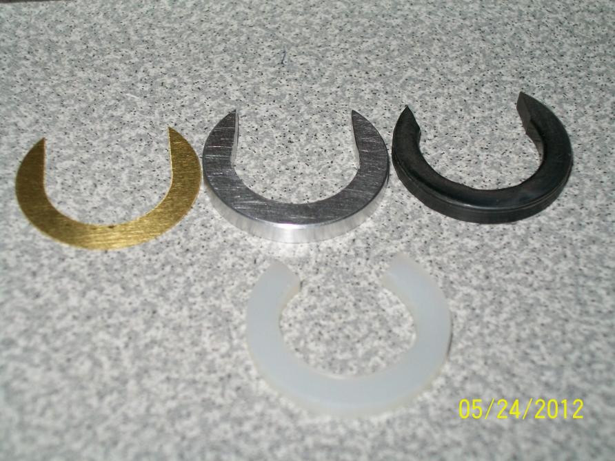

Made some harder shims out of AL, Nylon, and Delrin. Ended up with the delrin shaped like the nylon in the pic. Seems to be a firmer stop.
