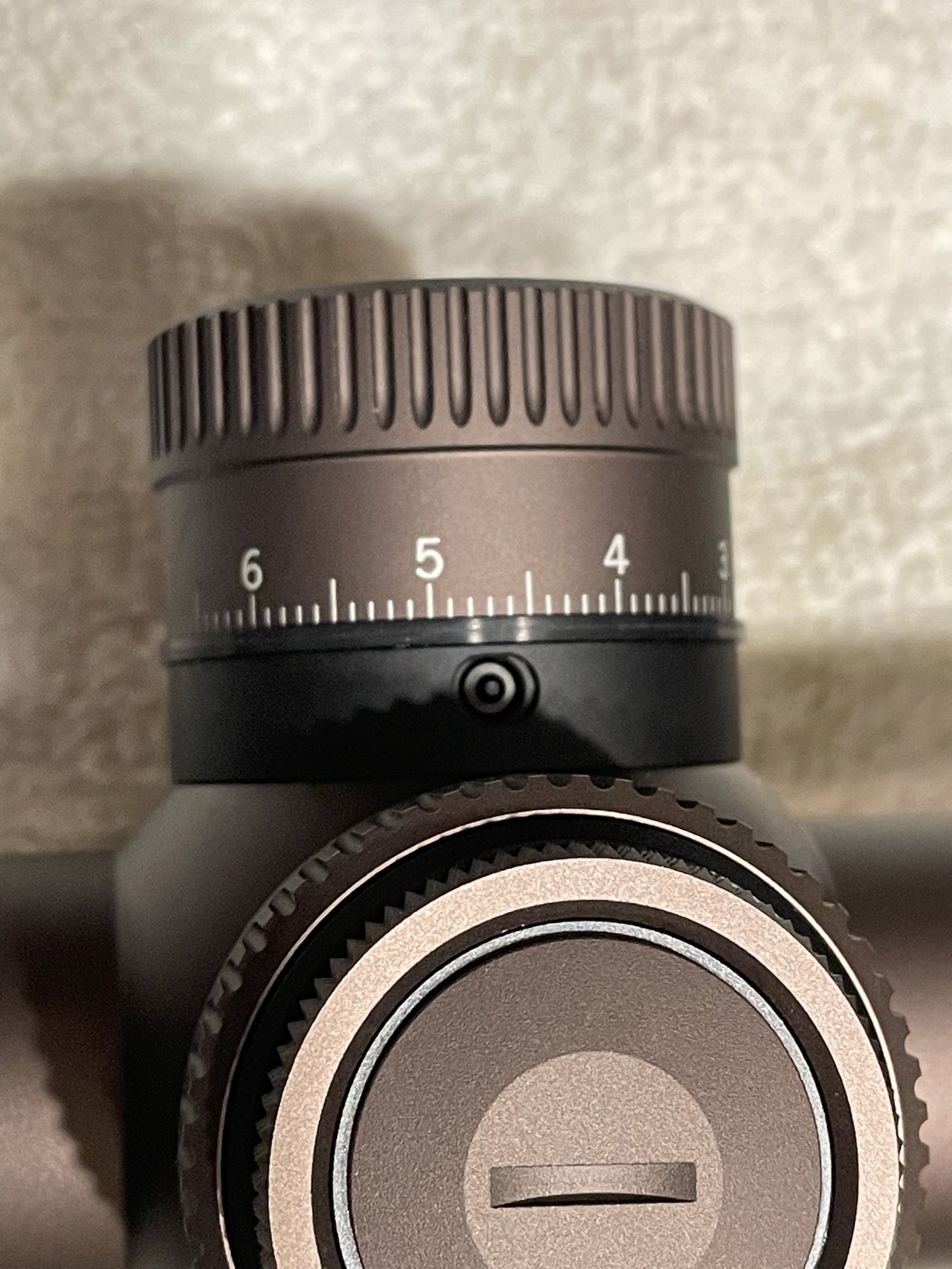

Anyone that can caliper the turret diameter under the pop up turret? The area that this o-ring is occupying? Im looking at polyurethane square o-rings that won't flex.
I measure 0.096"
The square o-ring in this pic is 0.066" and keeps it from locking
I measure 0.096"
Good info, I may have not been totally clear what I was requesting. But the outside diameter of the turret body, under the cap when unlocked. Basically the od of turret body that the o-ring is occupying. Im trying to spec a solid material o-ring/bushing to occupy the same space.
1.588"

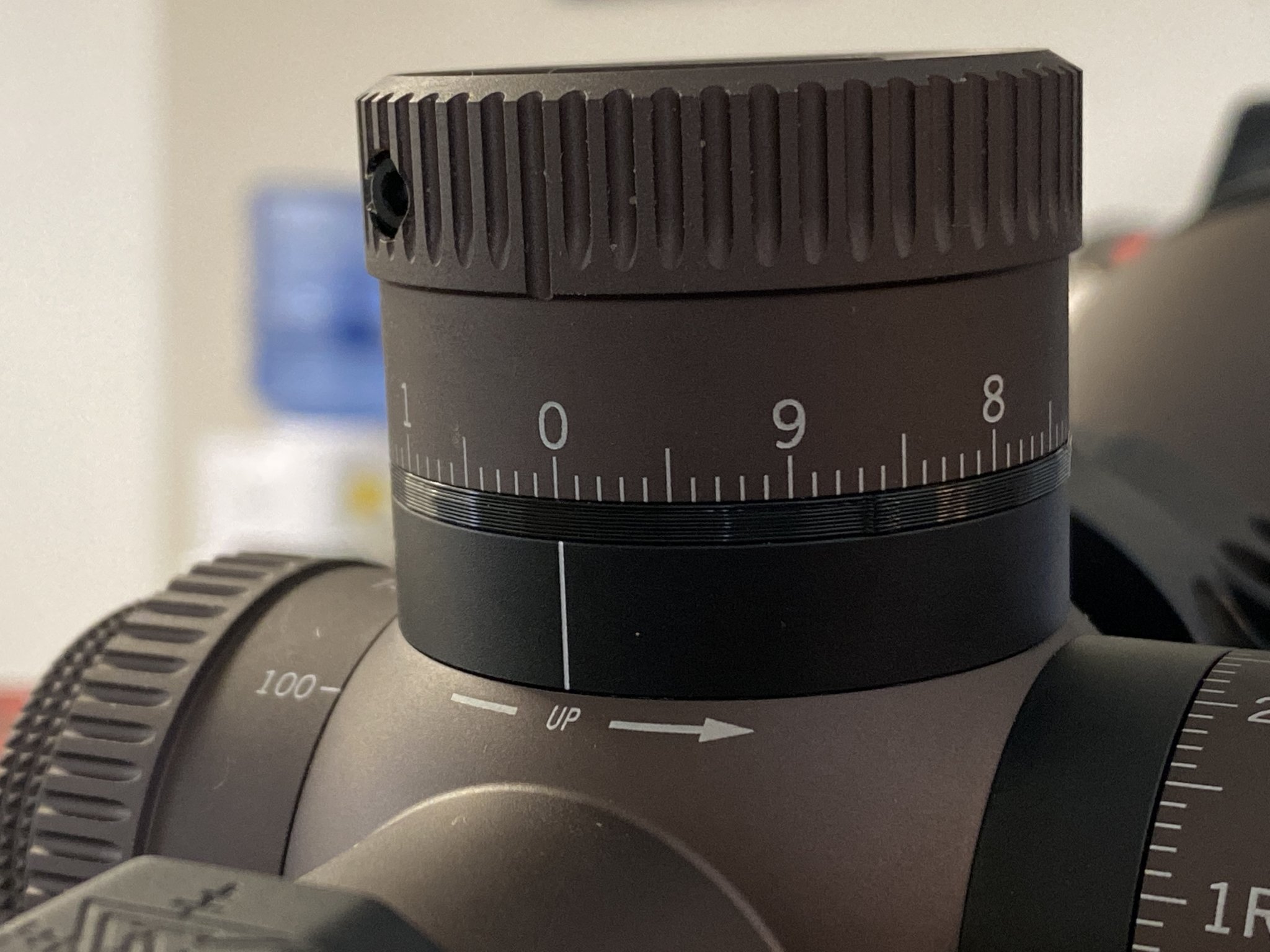

Let us know please. I am not making up this "issue" I have owned locking scopes from Vortex (AMG, G2, G3) ZCO, Bushnell, Athlon and possibly others I'm forgetting. The only one I've had an issue with is this Gen 3. But I'm hoping this won't be the norm and Vortex fixes it. I hope yours is great.
One thing I will say about the Gen III locking mechanism, there is quite a range (up and down) where the turret will still spin, only at the very bottom will the turret lock, so even if you move the turret down slightly it still spins. My turret does not "fall" on it's own, I would have to put downward pressure to get it to lock. Still waiting for my mount and then I can do some turret drills to get a much better idea.
So my particular GenIII does not have any problems with the elevation turret staying unlocked. When I unlock it and then run it through it's entire elevation range, it stays at or near the top without settling back into the locked position. Both my elevation and windage turrets are pretty smooth. The "clicks" are not as audible as the Area419 made it seem but that's most likely due to the microphone. They definitely are not TT level turrets and probably not on the same level as ZCO. The parallax knob is stiffer than I would prefer but that's okay. My magnification ring was really smooth, but I still put the switch view lever on.
