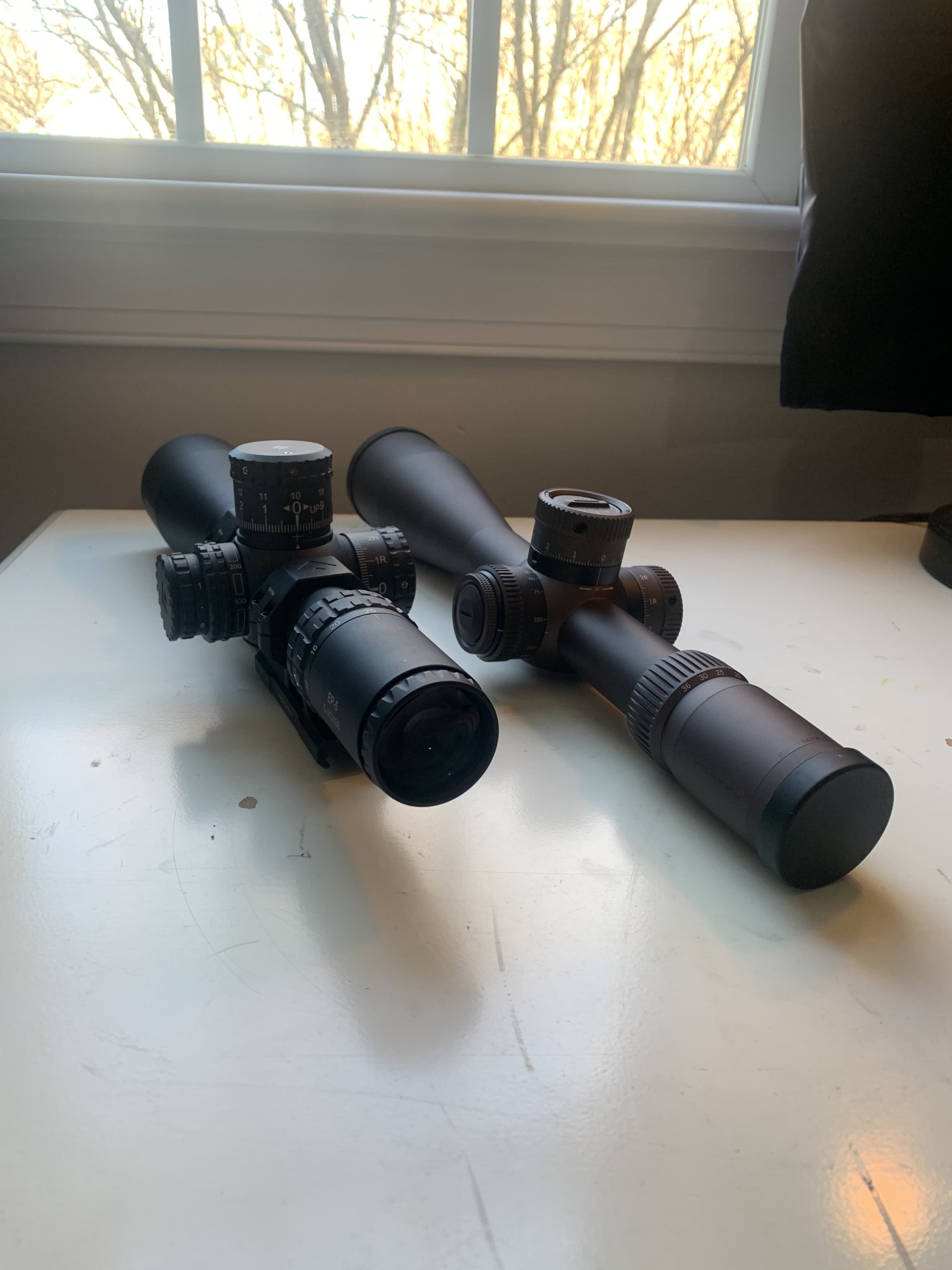

Not scientific, and just a brief unboxing comparing the turret of the Gen III vs the Gen II, and 7-35 and 5-25 ATACR.
The windage turret was much easier after the initial use.
Bro i know you ain’t trimming brass on that fossil back there?
Also your turrets sound better than mine could be the mic though. Towards the end it was extremely similar to my experience.
My locking turret stays up, turrets feel good but muted, dexterity and audibly. I have it out next to an atacr 525 and glass looks very similar. I prefer the NF turrets. Like the reticle, nice and simple, great FOV, setting zero was a snap, huge upgrade from the job to do that on the gen2. Overall its a decent scope, is it a 4k msrp scope? Not at all, is it a street price mid 2k scope? Yes it's that!

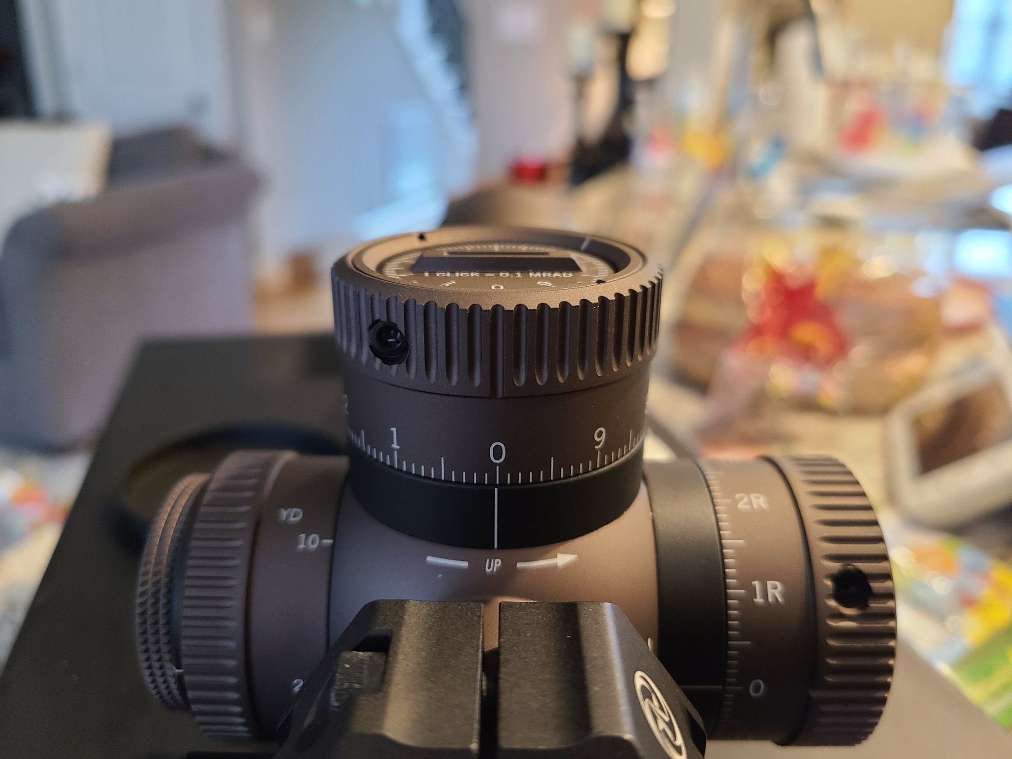

OK... Got mine in and here is my initial comparisons to the Gen 2 and general comments:
1.) Glass looks really good, but I only had a few minutes before sunset to look through it.. I'm going to have to setup and compare side by side to a Gen 2 later.
2.) Turrets are quieter and slightly more "mushy" than my Gen 2s. My Gen 2's have more well defined detents when dialing, and is louder.
3.) There is no detent on the elevation turret like the Gen 2, but mine does not go down when I dial it. As a matter of fact, it takes a decent amount of force to get the turret to go down.
I did some quick and dirty testing by carefully using some weights to see how much I had to use for the turret to go down...somewhere between 8-10lb. So at least on mine you have to really try to mess up while dialing.
4.) So far I'm liking the single screw to change zero... on the Gen 2's it was always a little bit of a pain, and they would loosen up if you didn't really crank them down. TBD on this design, but it looks better at face value.
5.) Turrets are "grippy" enough for me... I don't see that being an issue.
I know this is a 3K optic, but the truth is most people aren't going to pay that...AND I would expect this has Vortex's latest price increase already baked into the price. When we are comparing the prices/features of this to other optics... keep that in mind. Those ZCO's and TT might see a price increase soon, just like everything else... so if you take that into account when making that comparison, it's an even better value for what you are getting.
Overall really happy so far.
