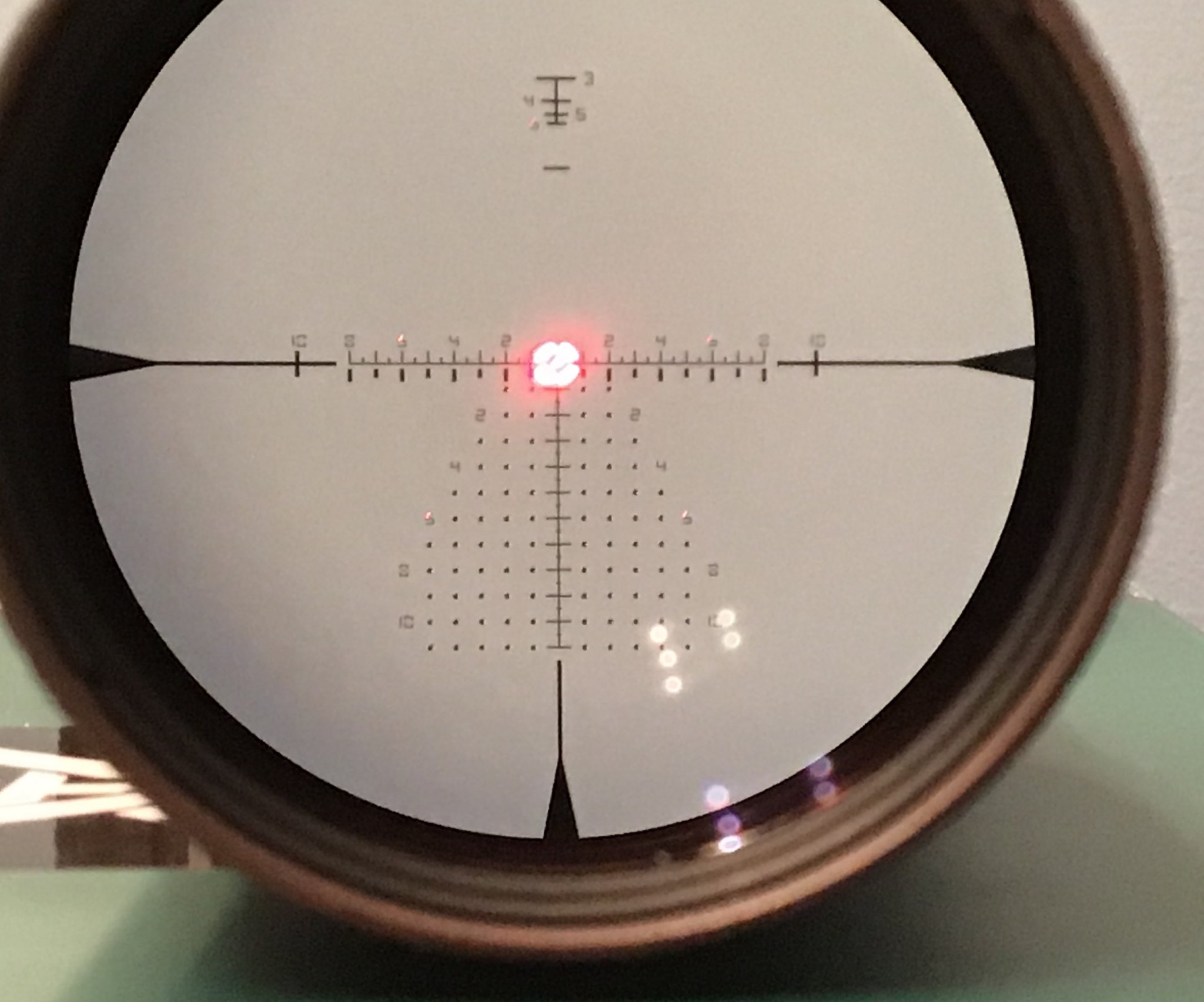

For those that have the scope, are you seeing any anomalies with the illumination on? I am trying to figure out if I got a bad copy.
The one I received shows five bright spots that correspond with the tips of the tails on all the number 6. Visible even at low illumination, throughout the magnification range once the tree is visible.
It wouldn’t be a big deal, except those points are not on any crosshair point but draw the eye to them. I sent an email off to vortex yesterday, but wanted to see if others were seeing it also.
Sorry for the poor pics, it’s the best I could get.

This is normal. There is no avoiding it if you want the true daylight bright reticle. One thing to note is that you will not be able to see those when using the illumination adjusted to the environment you are shooting in. Please let me know if you have any questions.

@Hatari I got around to checking mine. On high illumination on 10x it appears the top tips of all the "6" in the reticle has a small amount of illumination which appears to be dots. When set where illumination power is properly set for my eyes and for conditions and pointing into daylight on a higher illumination around 6 and indoors at lower around 3 it's not noticeable though and that is on 10x. Seems only noticeable in darker conditions with the illumination power turned up higher that would be used and on the higher magnification. I will live with it for everything else the scope has to offer as it's a small imperfection in a great scope.

The one I got to play with at the store had the same issue. I think its probably something you have to live with on these. One of the few weaknesses is the illumination bleed.

I had to look through mine to see what the big deal was about.
Thought I’d clarify the situation for those without one yet.
At 1x where you would use the illumination on nuclear, these “dots” are not visible.
At 10x, where they’re visible, you’d be out of your mind to use the illumination on nuclear. They’re also tiny. There’s no way you could mistake them for an aiming point.
Set it to a normal brightness and they become invisible.
Essentially, it’s a non issue. I’d rather have nuclear with tony dots you’ll never see than sorta bright with whatever else.
Just as side note, This phenomenon is not exclusive to our products. Most riflescopes with an etched reticle and bright enough illumination will exhibit the exact same thing. Whats happening is the illumination is catching the edge of the physical etching of the reticle features.
